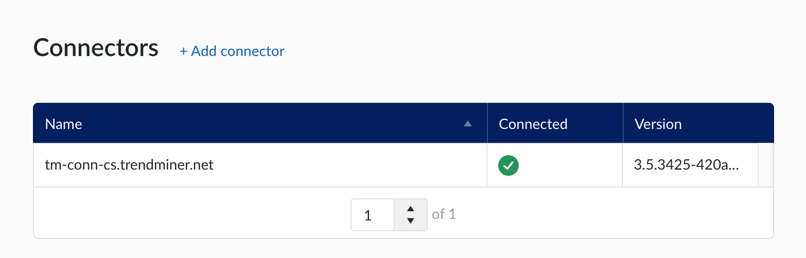

Set up and add your connector to TrendMiner
When this step is done you will have a custom connector up and running and successfully connected to TrendMiner.
You can implement your custom connector with your preferred technology. The standard TrendMiner connector is a .NET application, deployed in Microsoft IIS, but other options can be Java, NodeJS, … deployed standalone or to the cloud e.g. AWS Lambda, Azure functions, …
To get to an MVP (minimal viable product) version of your connector a few REST API endpoints need to be implemented. The first REST endpoint to implement is:
GET /api/version
Example output:
    "version": "1.0.0"
}Which version your connector returns is up to you. You can use the versioning to keep track of your connector updates. TrendMiner only uses this information to display in ConfigHub. After this endpoint is implemented you can add your connector to TrendMiner via ConfigHub (check the user documentation to find out how).
If your connector is added successfully, the version will be shown in ConfigHub and you are ready for the next step.

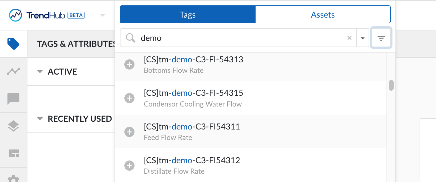

Make tags available in TrendMiner
When this step is implemented your tags will be accessible in TrendHub.
A 'tag' refers to one time series. TrendMiner requires the metadata of all tags to be known before they can be used. All tags in one data source need to be returned in a flat list. The tags query should accept one query parameter which will be passed on to the next endpoint which needs to be implemented for your custom connector:

When this endpoint is implemented, you'll need to make sure your user has access to this data source before you can find the tags from the data source in TrendMiner. This article describes how you can assign the right permissions.
Also make sure to sync the data source to TrendMiner to make sure the tag list is updated.
Once the right permissions are assigned, log in to TrendHub and you should be able to search your tag names and descriptions in the tag browser. If this looks ok, you're ready for the next step.
