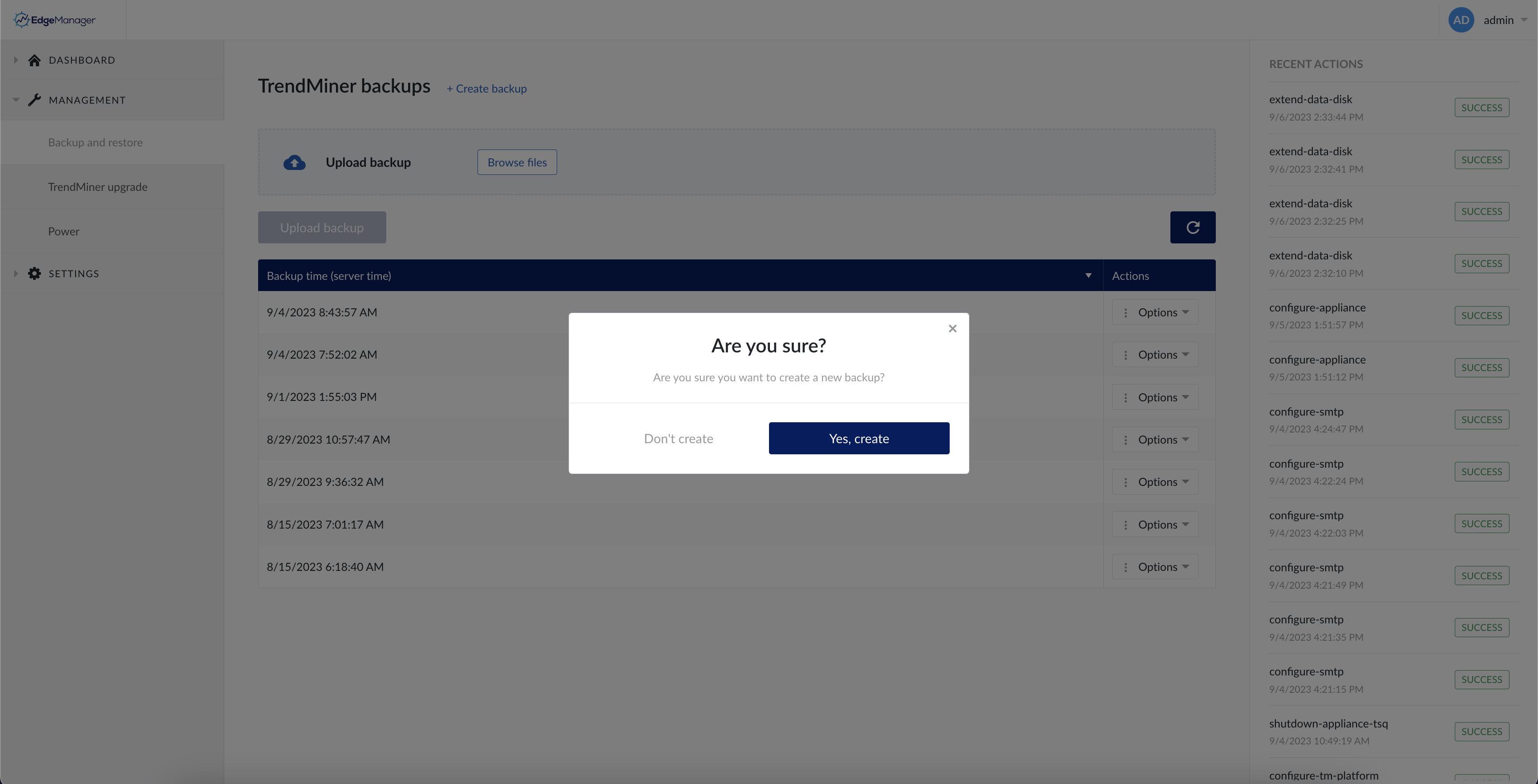

  4. Click on 'Create backup
    edge_manager_create_backup

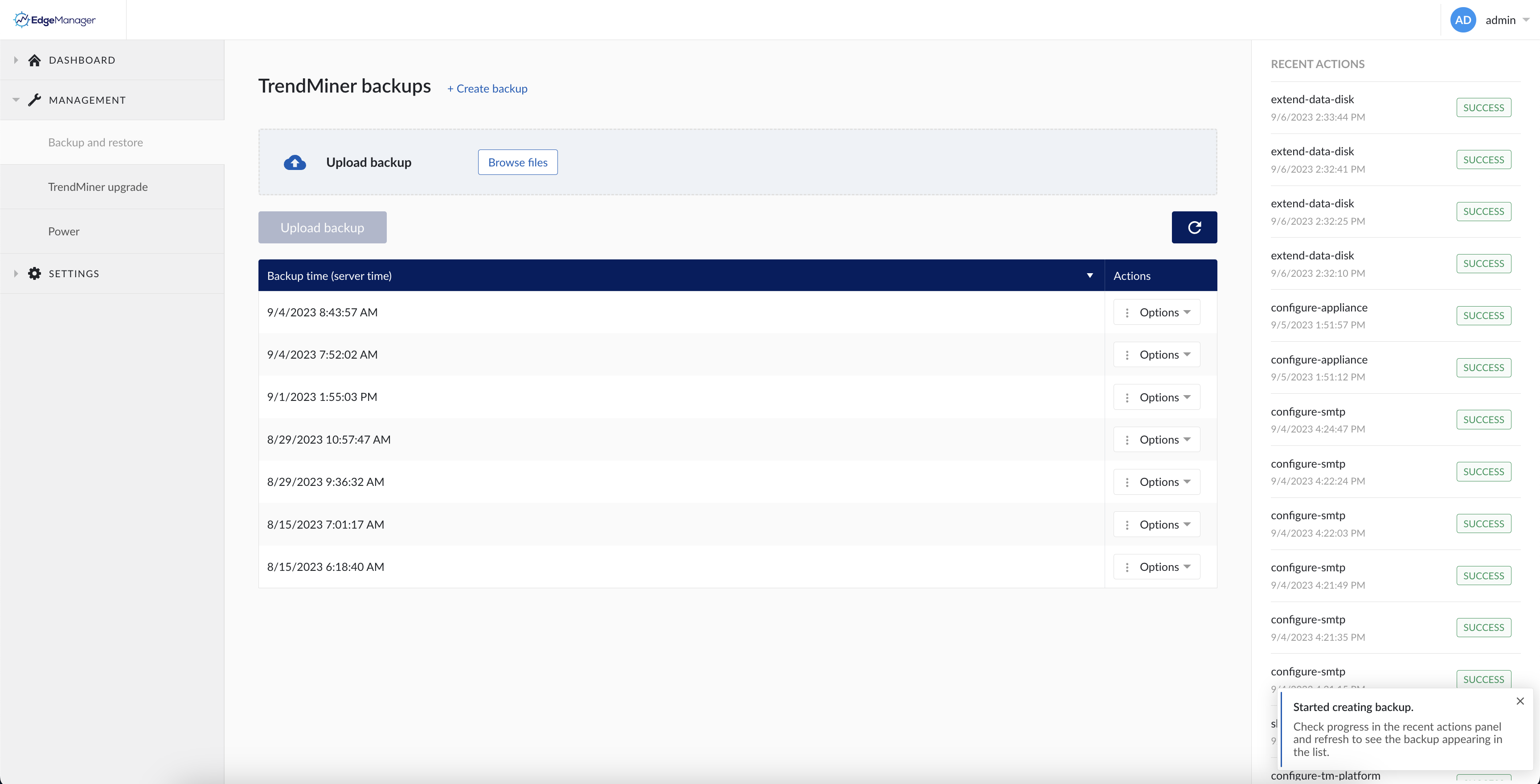

  5. Confirm the backup creation. A notification is shown on the bottom right to confirm that backup creation has started.
    create-backup-confirm-dialog
    edge_manager_create_backup_notification

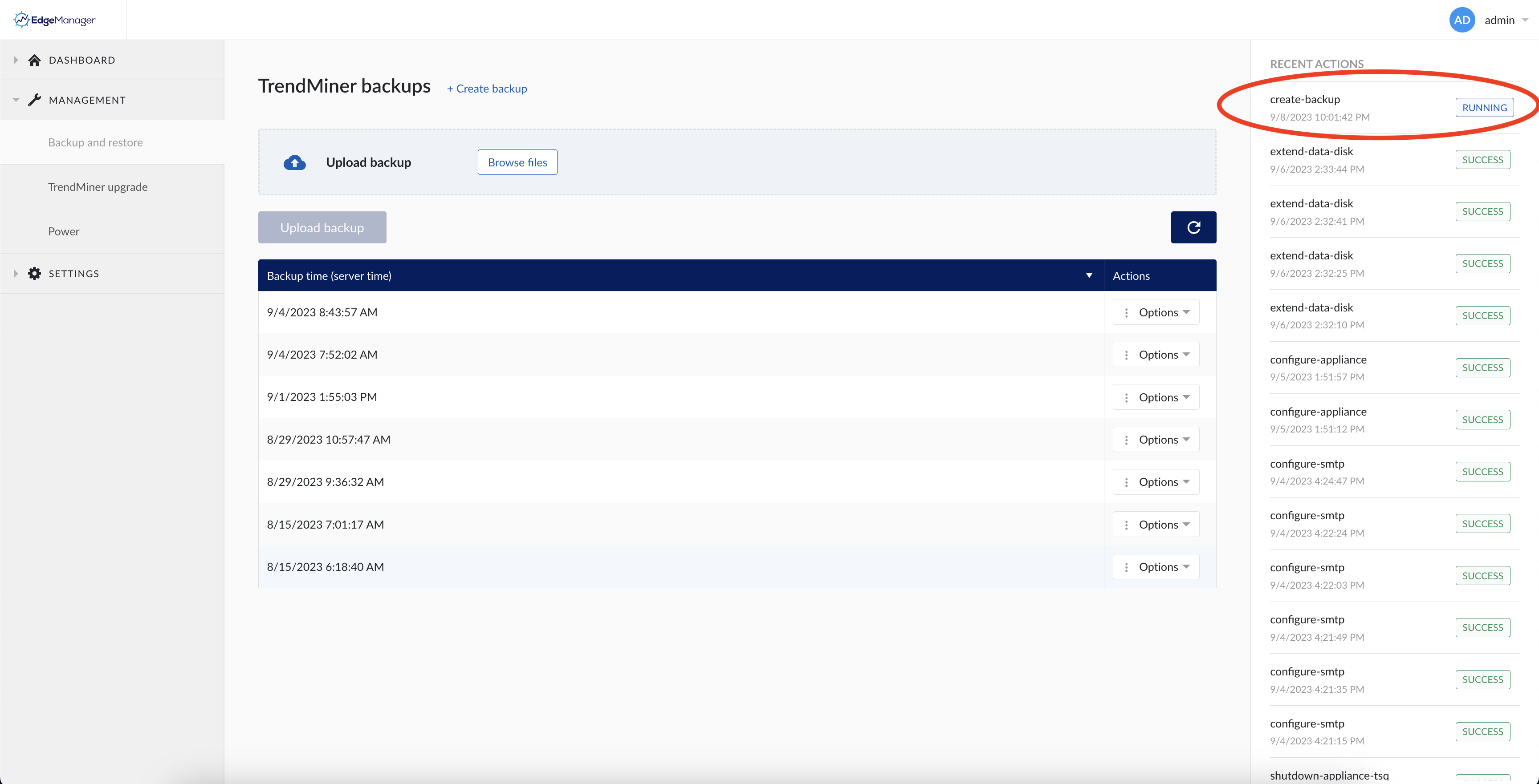

  6. Wait until the backup creation is finished. This can take from a few minutes to an hour or more, depending on the speed of the disk and the amount of data which needs to be backed up.
    create-backup-task-running
  7. When the backup creation is finished and the task is on 'success' refresh the page to show the newly created backup in the list of backups.
