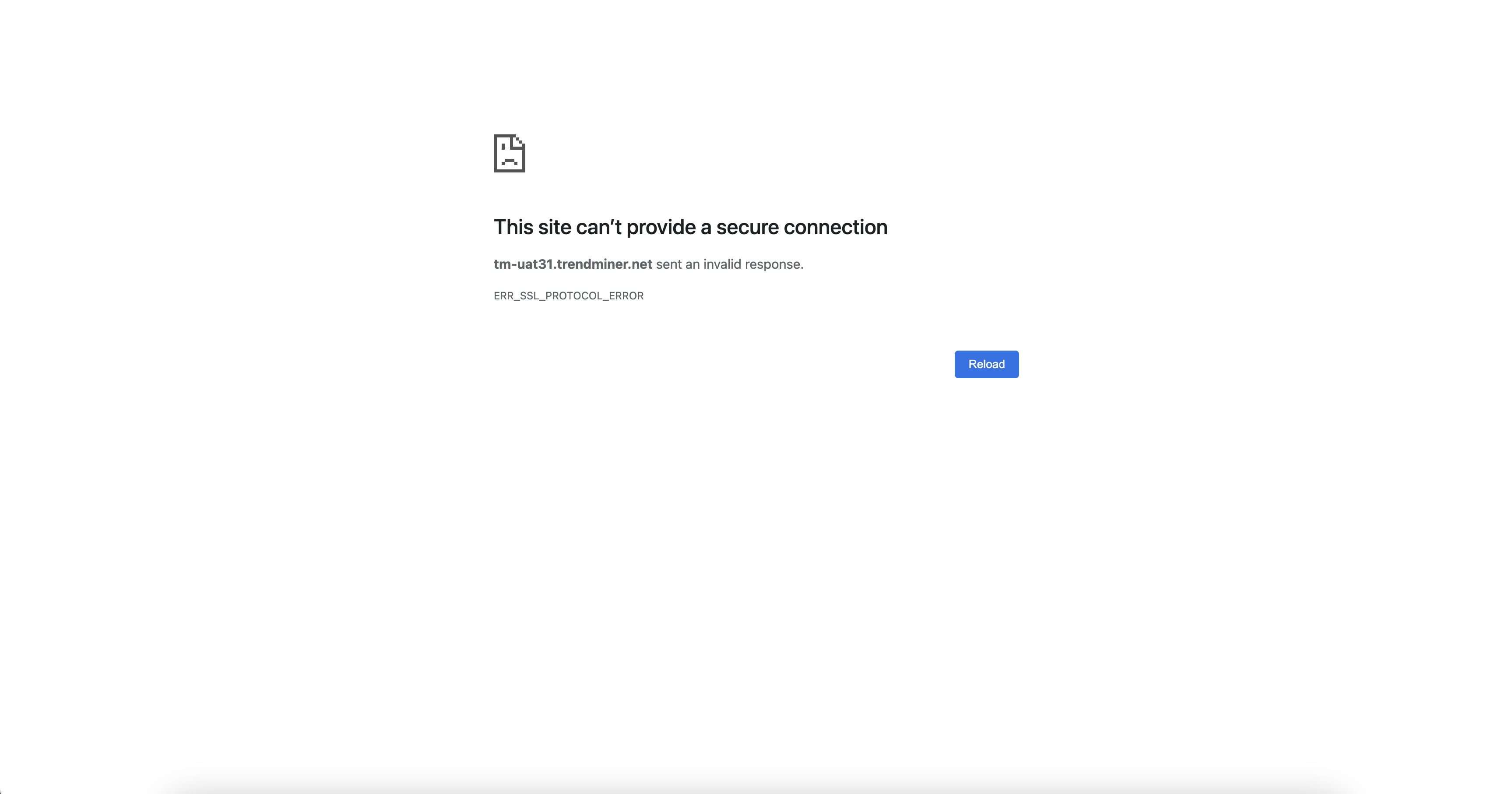

As soon as SSL is enabled your browser will likely redirect you to https://<trendminer_address>:8080, even when you explicitly add http in the navigation bar.
This will result in a page showing ERR_SSL_PROTOCOL_ERROR.
The easiest way to open Edge Manager anyway is to use incognito mode/inprivate browsing. When switching to incognito mode/inprivate browsing make sure to not browse to https links on this domain as all http calls will be redirected to https as of that moment.

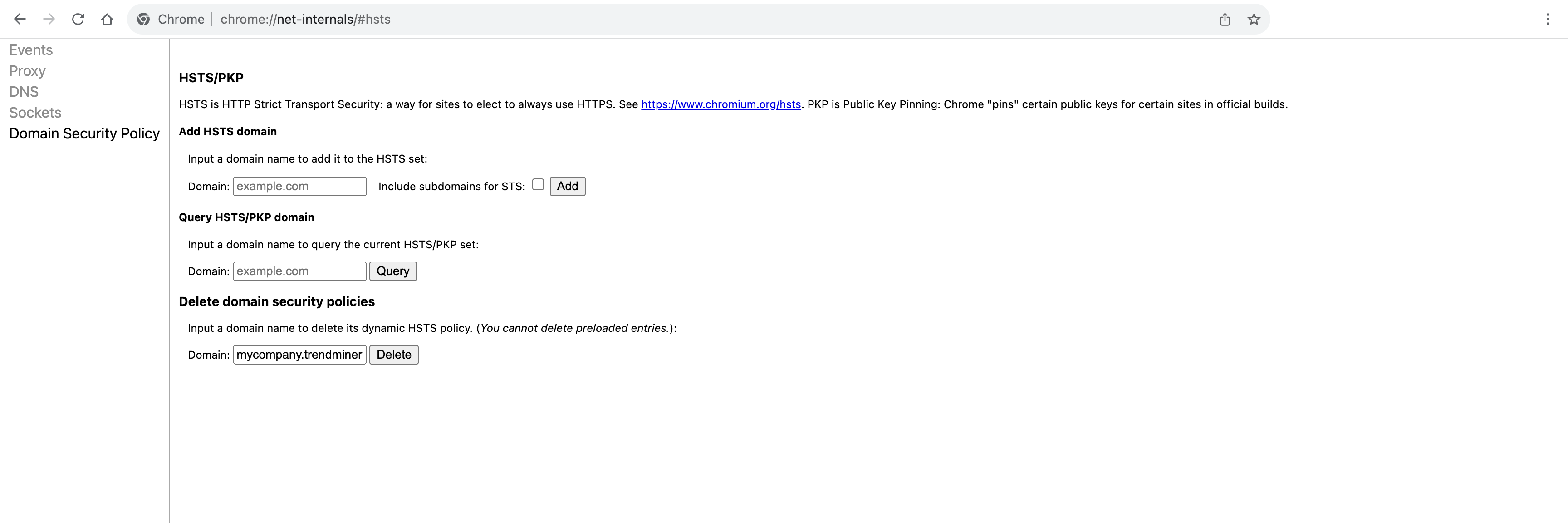

Chrome
  1. In your navigation bar, enter chrome://net-internals/#hsts
  2. Under "Delete domain security policies" enter your TrendMiner domain in the input field (without protocol or port), e.g. "mycompany.trendminer.com"
  3. Click "Delete"
chrome_hsts
Now you should be able to browse to Edge Manager. Note that as soon as you browse to a https page on this domain again, the setting will get lost and you need to repeat the above procedure to access Edge Manager.

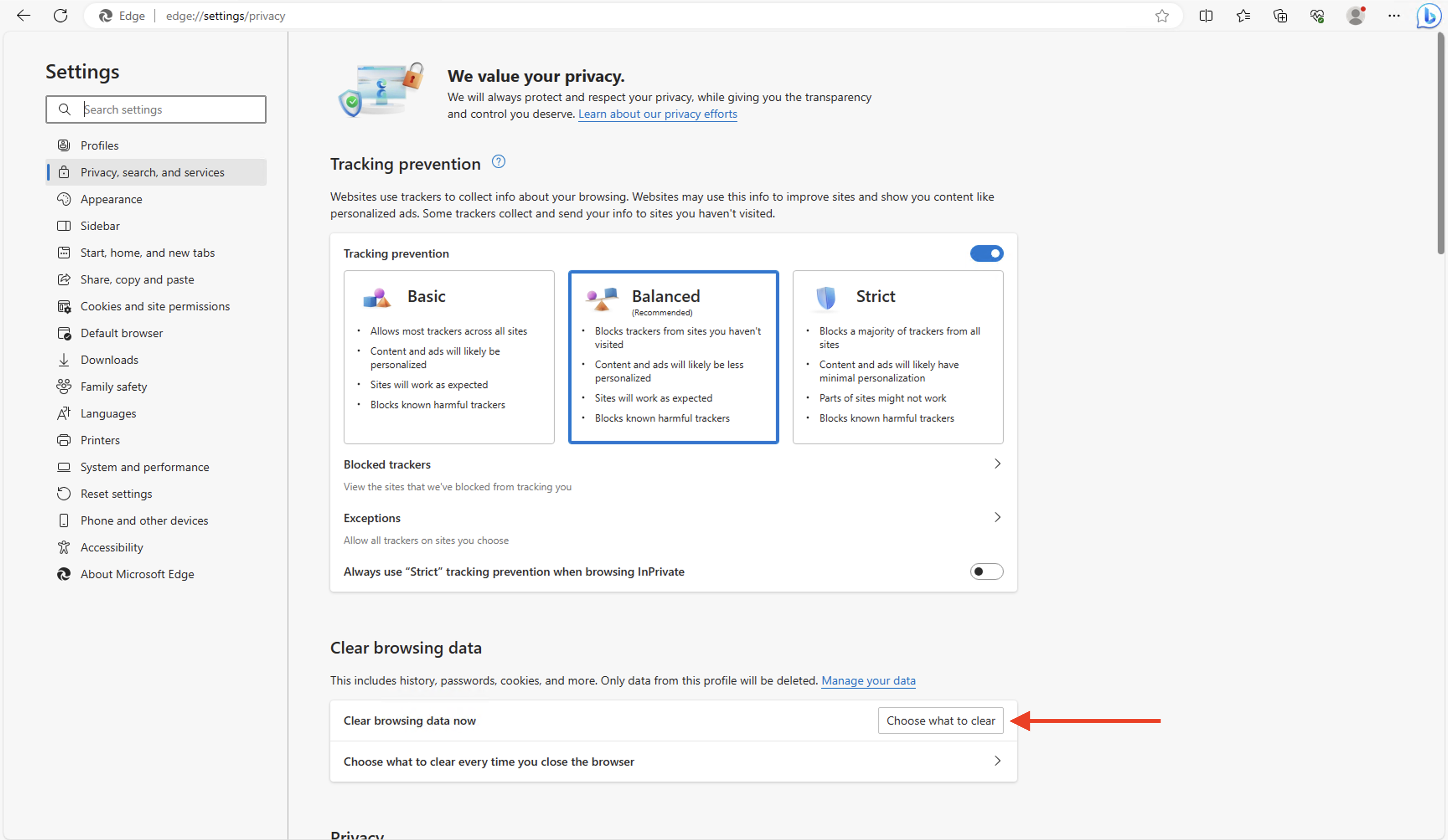

Edge
  1. In your navigation bar, enter edge://settings/privacy
  2. Click on "Choose what to clear"
  3. Check "Cached images and files"
  4. Click "Clear now"
edge_settings_privacy_clear
