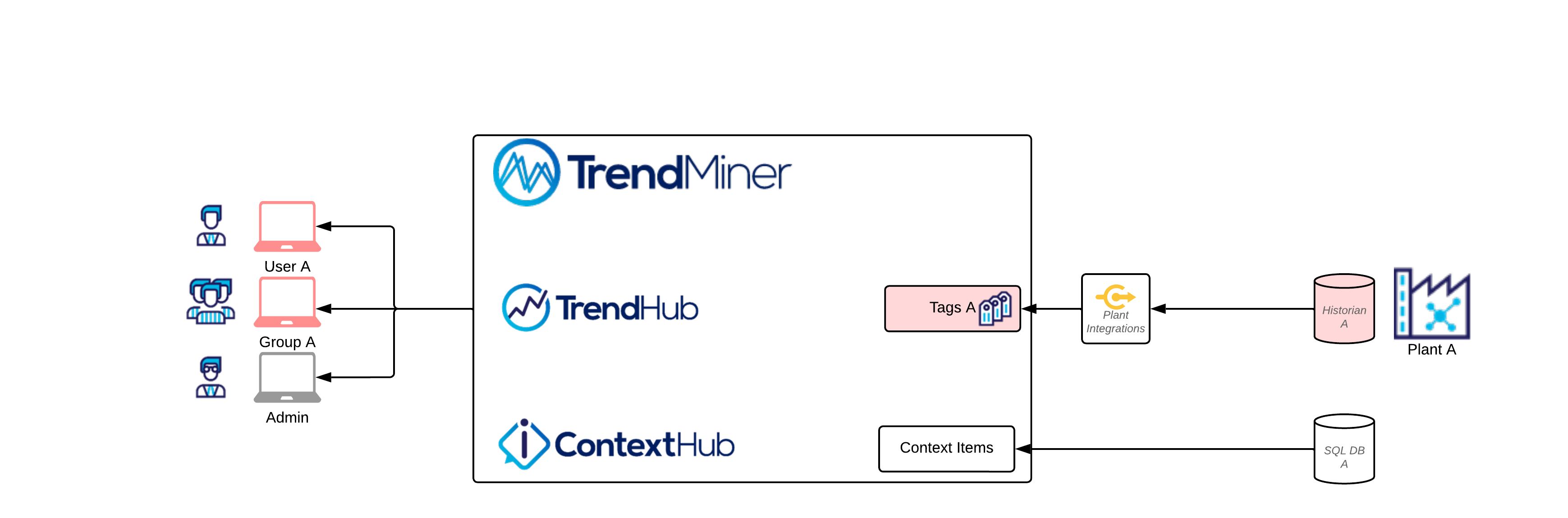

Basic architecture with single data source for 1 plant
Scenario 1 covers the most basic architecture with a single data source for 1 plant. All time-series data is collected from a single historian, shown on the diagram as Historian A. On the TrendMiner side, access to the data source can be granted to users (local users, LDAP users or SAML users) and groups (groups can contain local users, LDAP users or SAML users).
In the example architecture below User A and Group A have access to the data from Plant A (Tags A).
