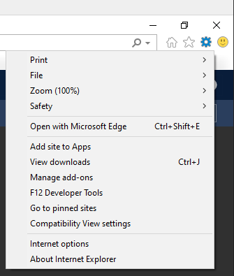

Left-click on the cogwheel in the top right of the browser window and click on 'F12 Developer Tools'.
This will open the developer tools:

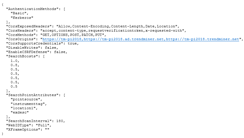

Make sure that the URL exists in the configuration of PI Web API.
To see which URL or 'origin' is allowed, the following link can be visited:
https://PI_SERVER/piwebapi/system/configuration
PI_SERVER should be replaced by the server on which PI is installed. This is the part before '/PIVision' of the URL on which PI Vision can be viewed.
E.g. If http://my-company.something-else.com/PIVision is used to visit PI Vision, the URL for the PI Web API would be https://my-company.something-else.com/PIWebAPI.
Depending on how the server is configured, this might show a screen that says 'Insecure connection'.
When visiting this URL, a response will be shown including the 'CorsOrigins' (see following figure).
The 'CorsOrigins' list should contain the 'origin' on which PI Vision is visited.
E.g. http://tm-pi2018.ad.trendminer.net/PIVision is used, the 'origin' in this case is 'http://tm-pi2018.ad.trendminer.net', which is not in the list of 'CorsOrigins'. However 'https://tm-pi2018.ad.trendminer.net' is in the list of 'CorsOrigins'.
