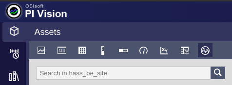

Click on 'New Display' in the top right of the screen.
A new 'symbol' (highlighted in the picture below) has been added.

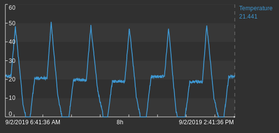

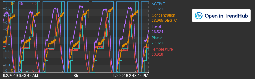

For this example another 'symbol' will be used to provide the data we want to visualize in TrendHub. More specifically the 'Trend symbol' will be used.
Select the 'Trend symbol' in the top bar.

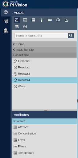

Select in the list below the assets or attributes/tags you want to visualize.
Drag and drop the selected asset or attribute/tag onto the dashboard.
Example asset:
Example attribute/tag:
Repeat step 1-3 if you want to add multiple assets or attributes/tags.
Select the 'TrendMiner Navigation Link symbol'.
Select an asset or attribute/tag.
This can be any random attribute/tag, it will not be included in the attributes/tags that will be visualized in TrendHub. Selecting an attribute/tag in order to be able to drag and drop a symbol on the dashboard is a requirement of PI Vision.
Drag and drop the 'TrendMiner Navigation Link symbol' onto the dashboard.

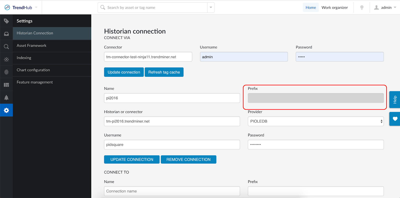

Prefix: Sometimes historian servers in TrendMiner are configured with a prefix. Ask an admin what the configured prefixes for the servers are. If no prefix has been configured, this field can be left empty.
The screen where a configured prefix can be found by an admin.

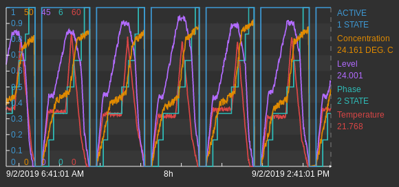

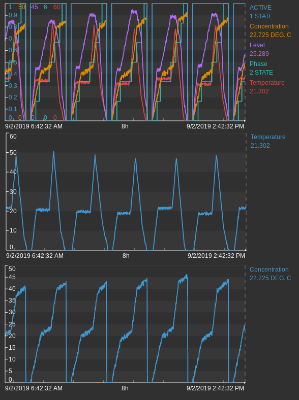

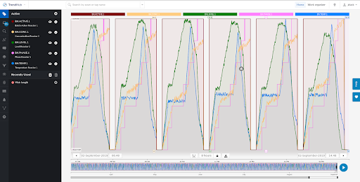

Click the 'Open in TrendHub symbol' on the dashboard. This will open a view in TrendHub, visualizing all the attribute/tags that are configured on the other symbols that are on the dashboard.
Duplicate attributes/tags will be filtered out. In the examples used in this guide 'Temperature' and 'Concentration' are visible twice on the dashboard (step 5), once in the TrendHub visualization.
All attributes/tags (used in steps 3. and 4.) must come from the same 'historian server'. Or in other words, they all need to use the same prefix (as described in step 9b).
