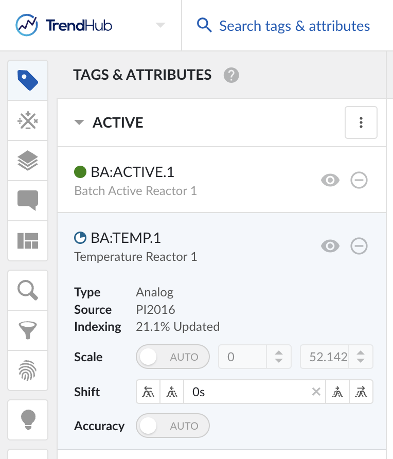

  • Speed/Indexing Check: Add any tag and ensure the indexing status reaches Up-to-date within a reasonable time. It should not take more than 1-2 minutes for TrendMiner to fully index around 5 years of data. This will depend on the tag resolution. If it does take significantly longer to index the tag or you get some error messages, involve TrendMiner technical support so we can troubleshoot.
    2023.R3.0 - tag details

  • Tag Type Verification: Add a tag of each type available in your data source (e.g. Analog, Discrete, etc.) to ensure the tags are properly mapped and displayed in TrendMiner

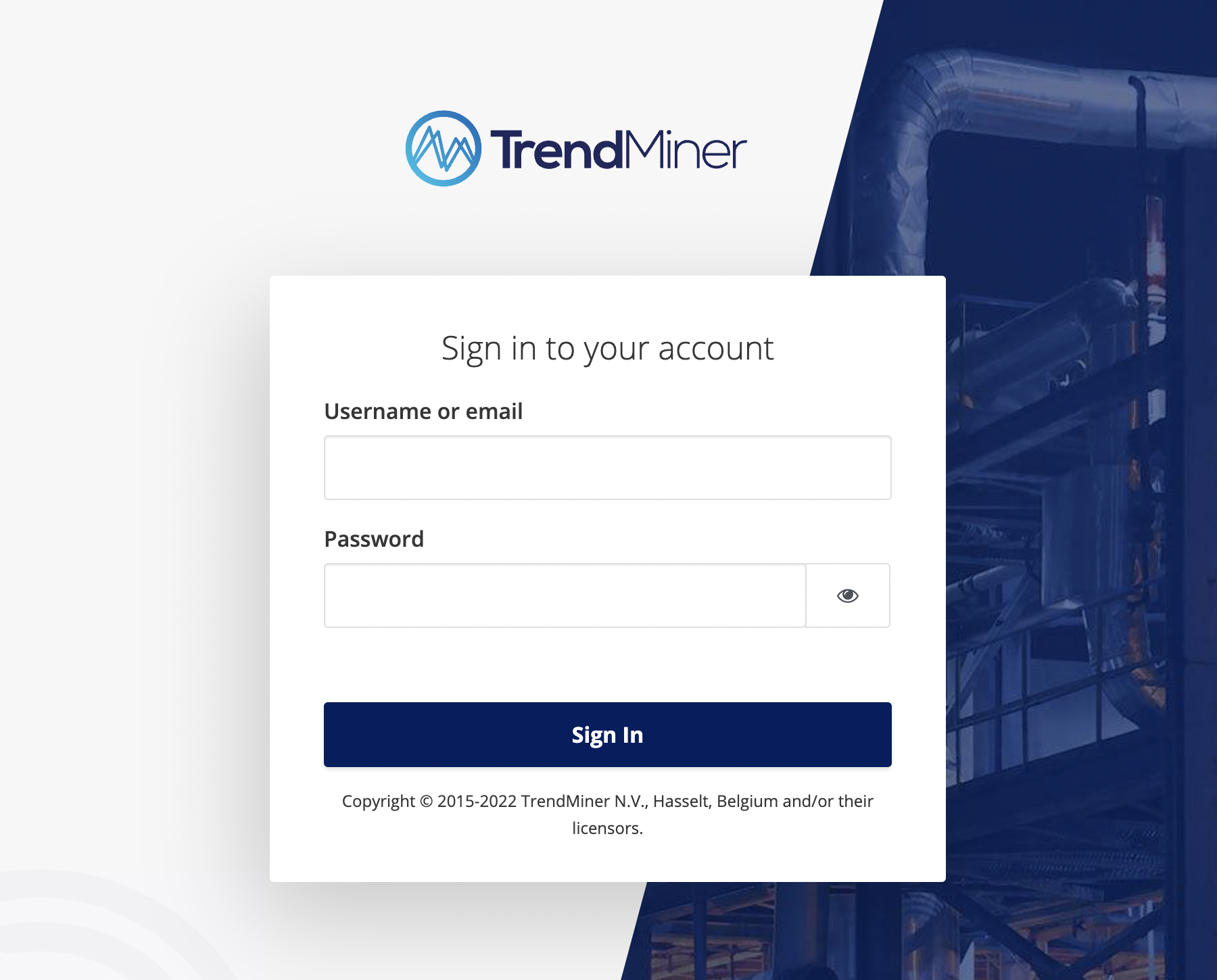

  1. Log in to TrendMiner at http://<trendminer_address>/
    login screen

  4. Start typing a tag name inside of the search box.
  5. Tags that match the input will show up in the dropdown. Click on the plus icon (+) to visualize. TrendMiner displays a trend view of the tag and starts the indexing process.
