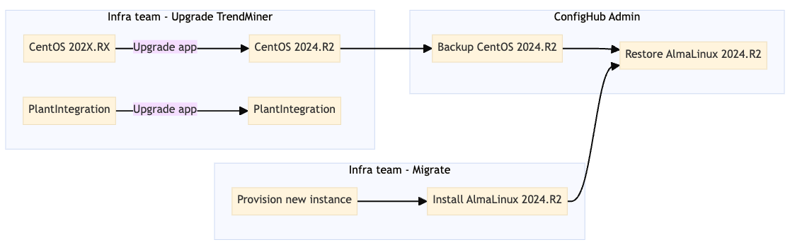

Depending on your current setup there are a number of scenarios that can followed for doing the TrendMiner migration from CentOS to AlmaLinux.
The common steps are:
  1. Upgrade the current TrendMiner application to the 2024.R2.0 version for CentOS
  2. Upgrade the current PlantIntegration application to the latest version
  3. Provision a new instance according to the System requirements for AlmaLinux or RedHat 9
  4. Install the AlmaLinux TrendMiner 2024.R2.0 application
  5. Backup the CentOS TrendMiner application data
  6. Restore the TrendMiner application data on the AlmaLinux instance
