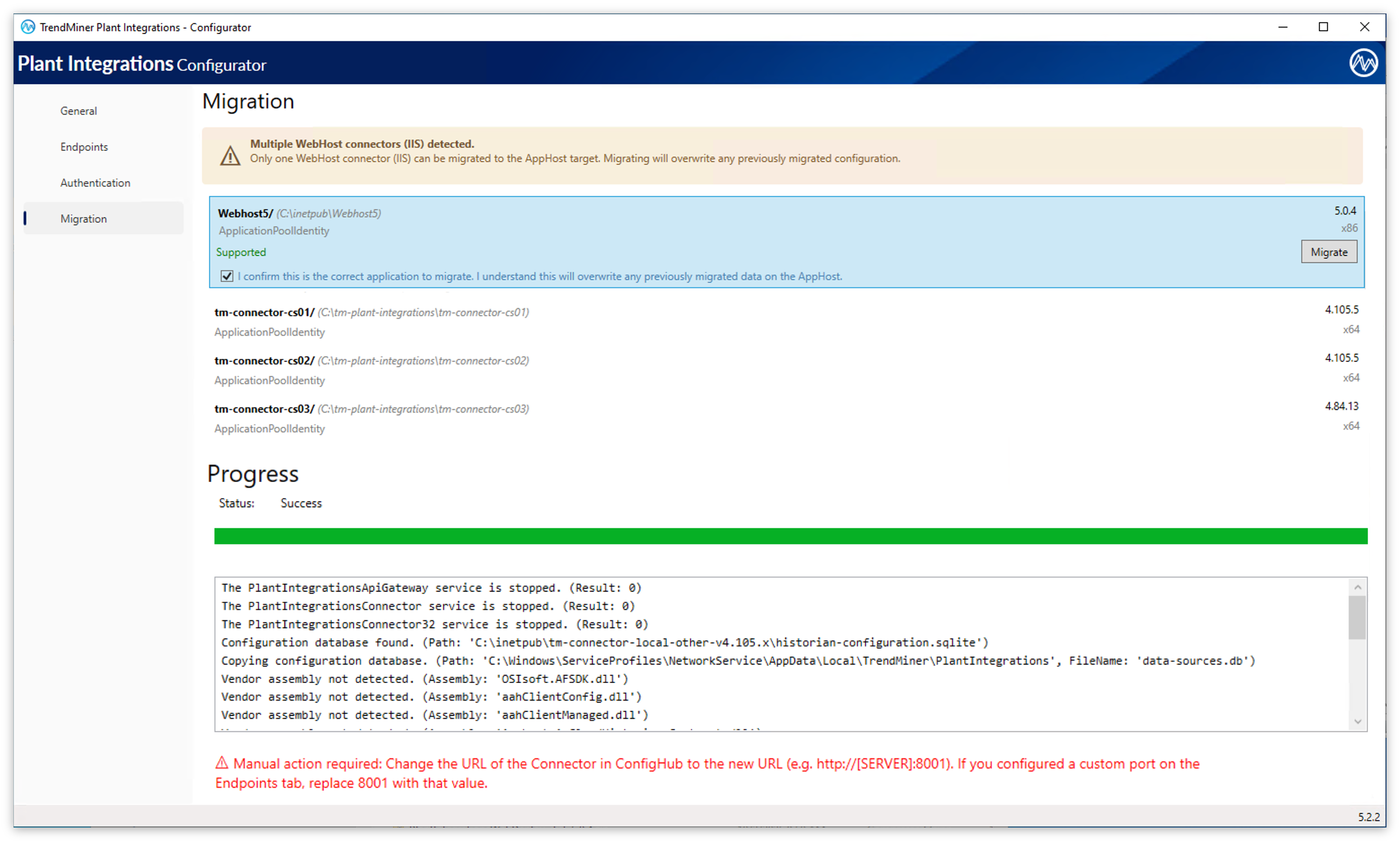

The migration steps described below are performed using the Configurator's Migration module.

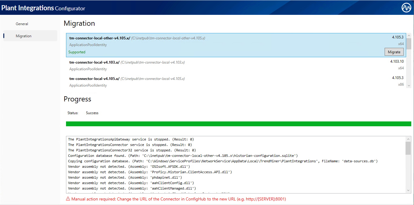

When you clicks on the Migration menu option, the Configurator scans the current system for existing WebHost installations and presents them as available origin applications. Once you select an origin and start the migration, the Configurator will automatically:
  1. Copy application data from the origin to the target application.
  2. Copy vendor assemblies from the origin to the target application.
  3. Start the AppHost services.
  4. Stop the origin WebHost application.

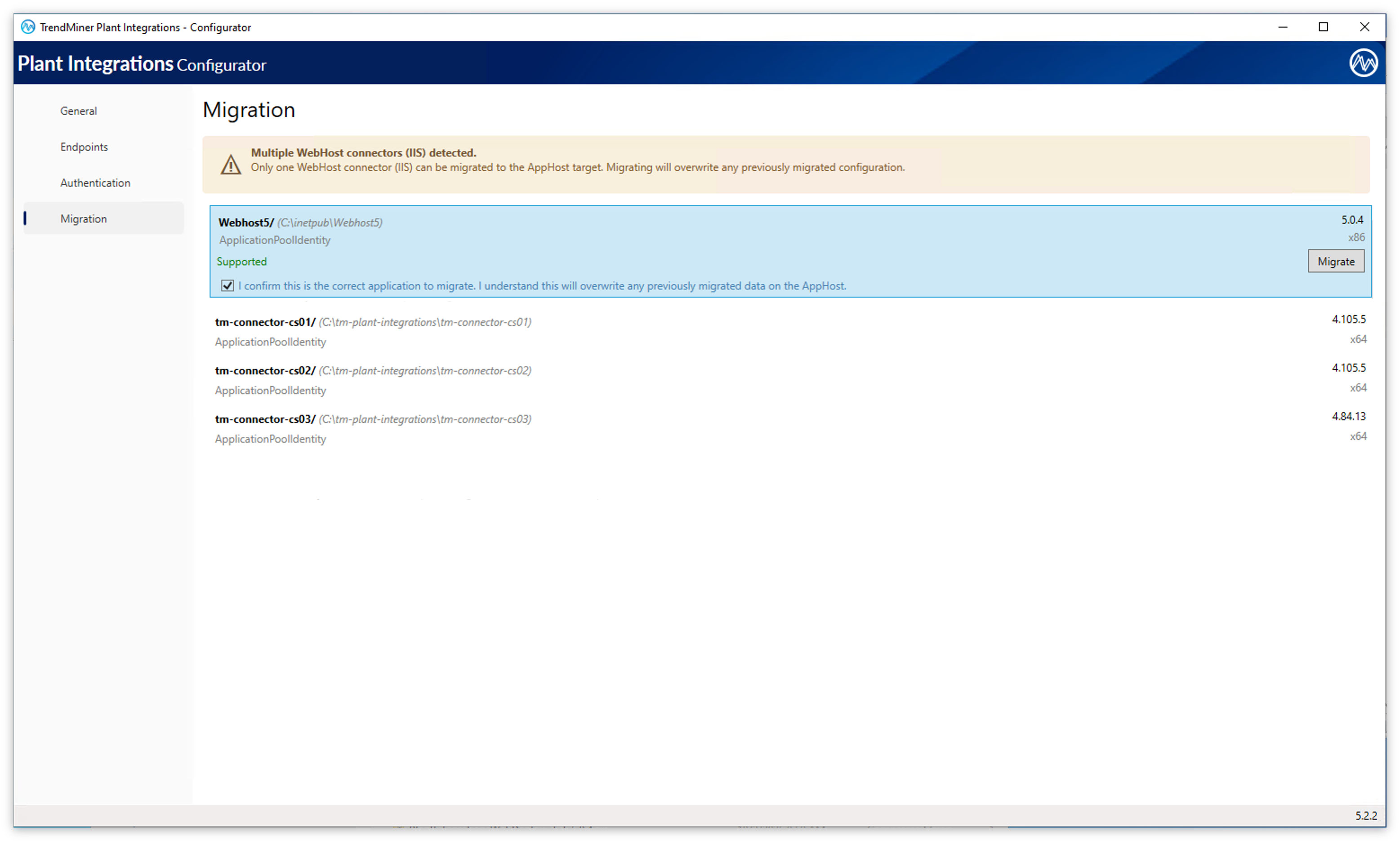

If multiple WebHost (origin) applications are detected during migration, note that only one origin can be migrated automatically to the AppHost target at a time. Migrating a second origin application will overwrite any previously migrated configuration, which may result in data loss.
Ensure you select the correct origin application before proceeding. This limitation will be addressed in the future releases.

To migrate an origin application:

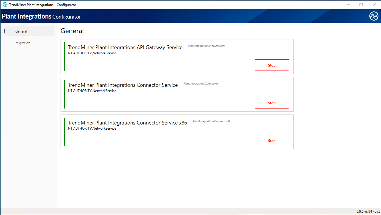

  1. Launch Configurator application

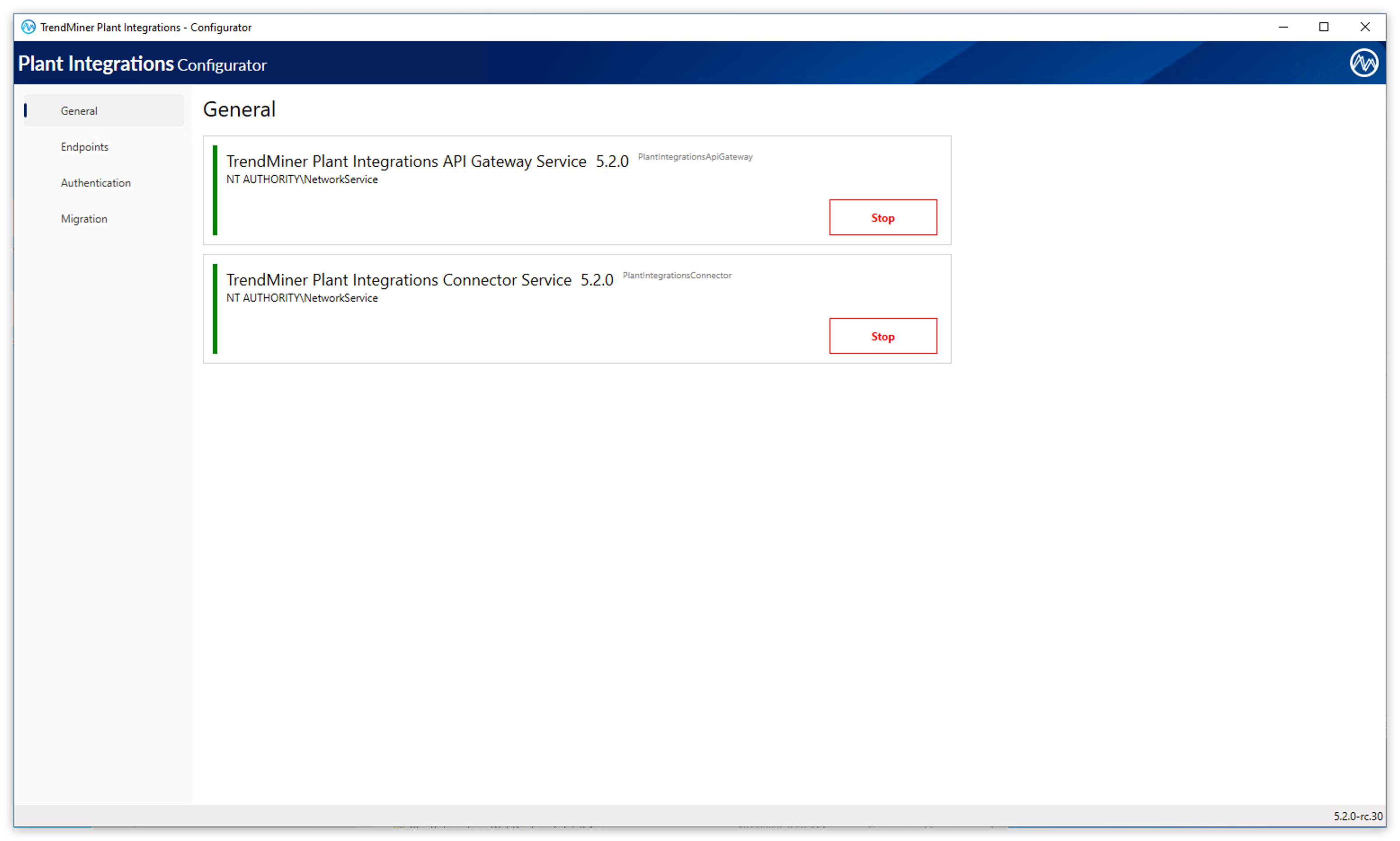

  2. By default, Plant Integrations listens on http://+:8001/. You can change the port and url on the Endpoints configuration screen before running the migration:
    1. Go to the Endpoints configuration screen.
    2. Set the desired URL and Port for the HTTP endpoint.
    3. Click Update to confirm the new endpoint entry.
    4. Click Apply to save the configuration.
    The Configurator will automatically update the URL reservation and the Windows Firewall rule to match the new settings.

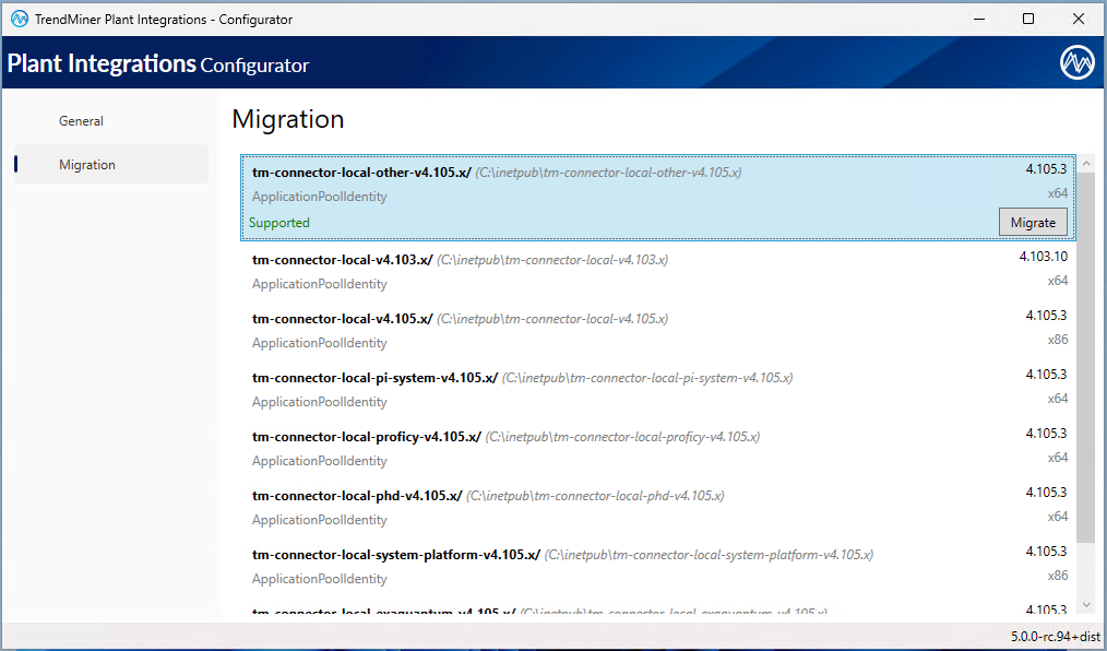

  3. Click Migration in the navigation panel on the left.
4. Select the installation and click the 'Migrate' button to start the migration.
5. Important! Go to ConfigHub and change the URL of the connector to the new URL (e.g. http://[SERVER]:8001). If you configured a custom port on the the endpoints tab, replace 8001 with that value.

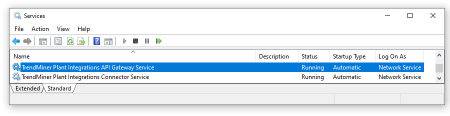

After the migration process successfully finished, open the Services management console (services.msc) and verify that the following services are running:
  • TrendMiner Plant Integrations API Gateway Service
  • TrendMiner Plant Integrations Connector Service
