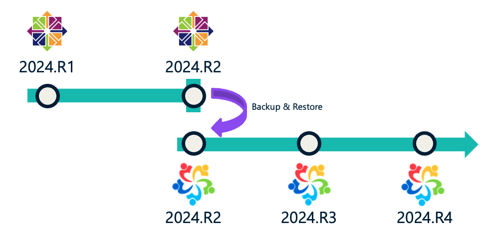

The purpose of this guide is to prepare the local administrators for the 2024.R2 release related to the migration of their TrendMiner appliance from CentOS 7 to AlmaLinux OS 9. and the upgrade to 2024.R2. It provides a high level overview, best practices, and troubleshooting tips to ensure a smooth transition.

  • For the prepackaged virtual appliance, we are moving from CentOS 7 to AlmaLinux OS 9
  • For self-managed servers, support is moving to Red Hat Enterprise Linux 9 (RHEL 9) and AlmaLinux OS 9.
