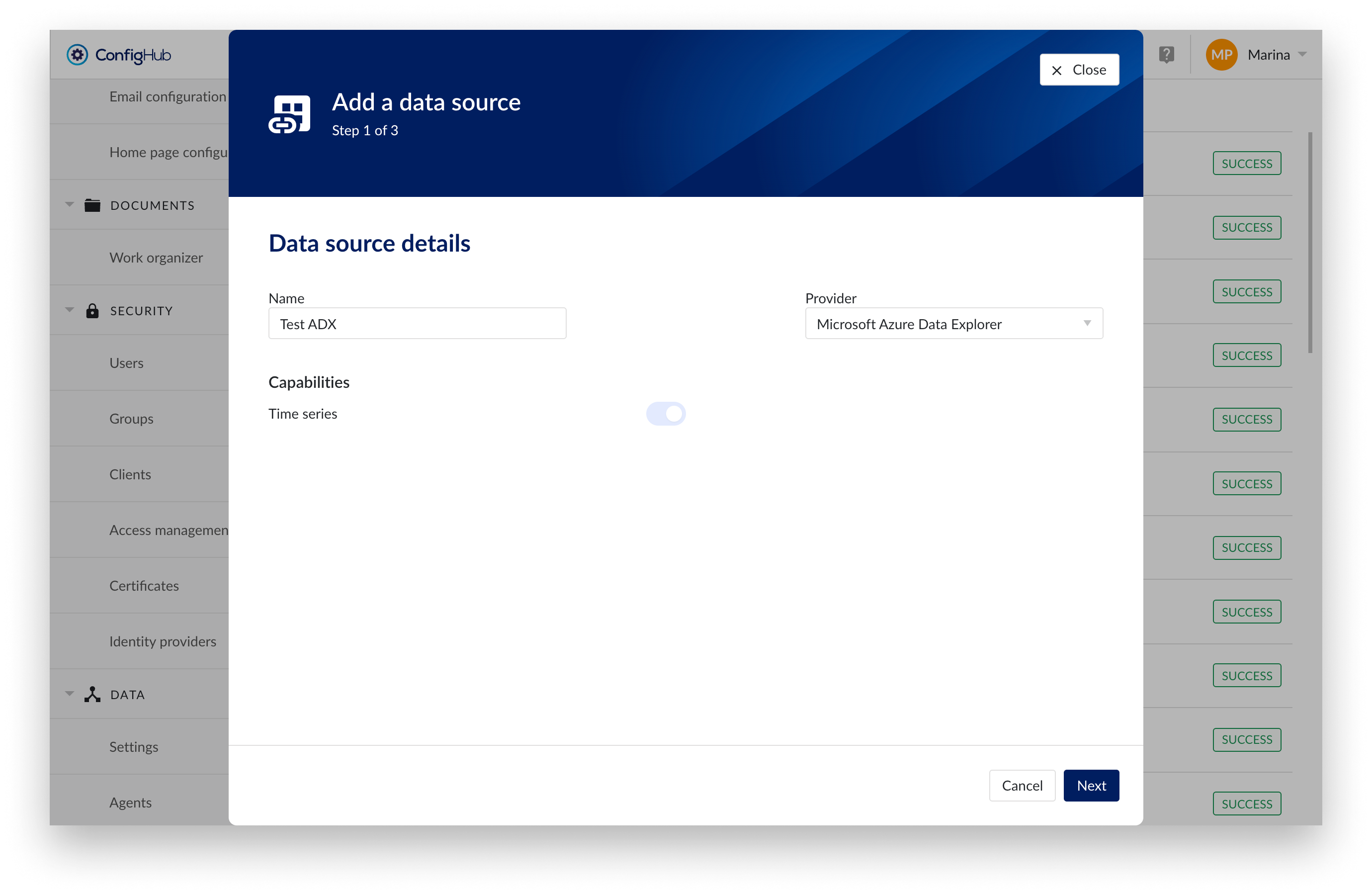

Fill out 'Data source details' on the first step of the datasource creation wizard: type name of a data source, select “Microsoft Azure Data Explorer” from the Provider dropdown.  Time series capability will be checked by default.
Fill out additional properties, grouped in thefollowing sections:
  • Connection details – lists properties related to the configuration of the connection that will be established with Microsoft Azure Data Explorer.
  • Time series details – lists properties relevant for the time series data.
  • “Provider” - select the option Microsoft Azure Data Explorer from the dropdown.
  • “Capabilities” - the only capability supported is the Time series capability. It will be selected by default.

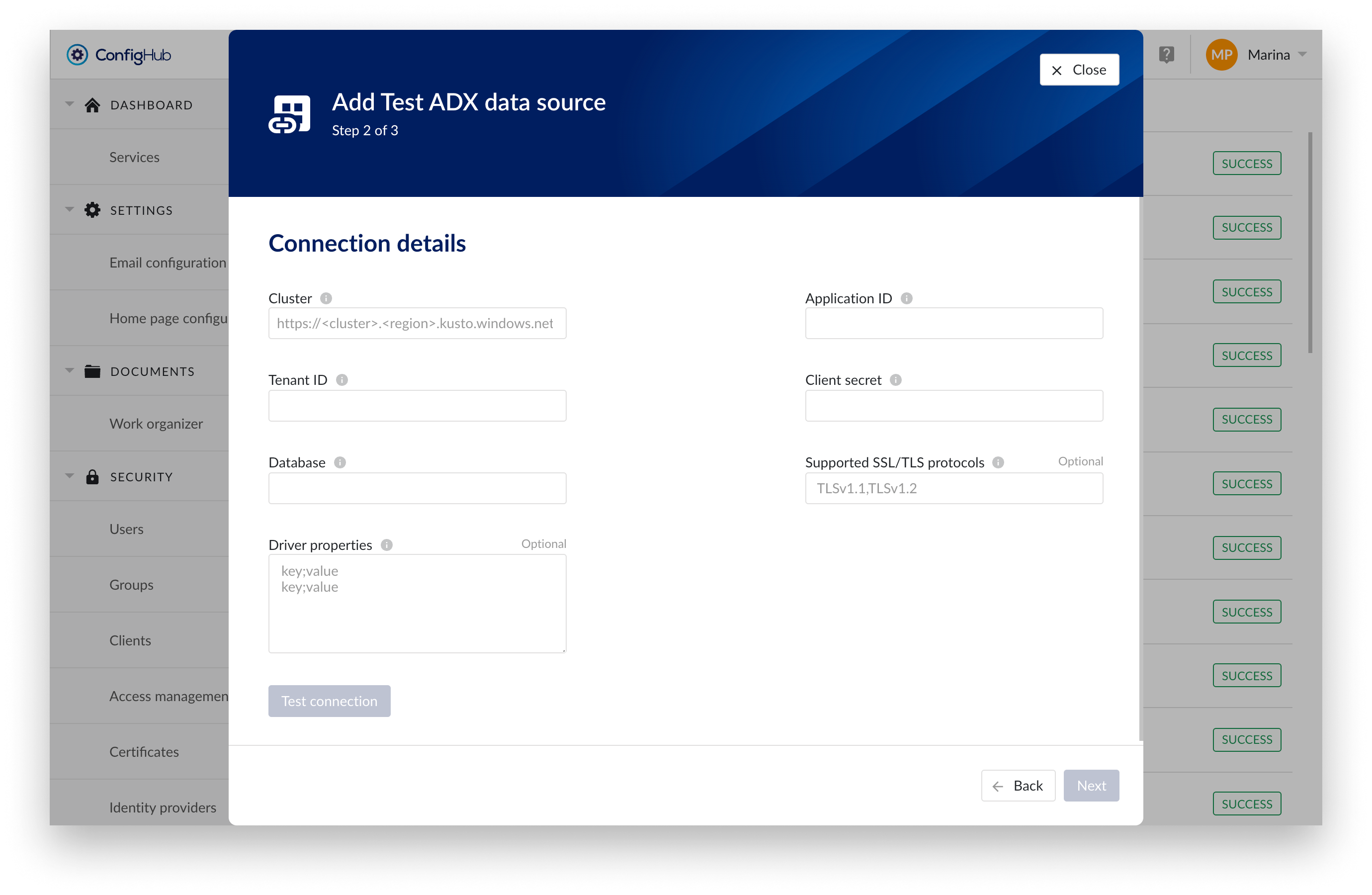

  • "Cluster" - to be mapped with value of the cluster URI https://<cluster>.<region>.kusto.windows.net
  • "Application ID" - a mandatory application id. In Azure a new application “TrendMiner” needs to be registered. After completion of this registration the application id will be available. For more info please refer to Azure Active Directory application registration or consult with the Azure Data Explorer documentation.
  • "Tenant ID" - a mandatory tenant id. In Azure a new application "TrendMiner"needs to be registered. After completion of this registration the tenant id is available.
  • "Client secret" - after registration of the TrendMiner application in Azure a client id and a secret need to be generated in order to get application access. The client secret for this access needs to be entered here.
  • "Database" – to be mapped with the name of the ADX database holding the time series data to be pulled.
  • “Supported SSL/TLS protocols” - an optional, comma-separated list of supported SSL/TLS protocols. For example, specifying TLSv1.2 will disable the use of TLS 1.3, which has issues with ADX connection.
  • "Driver properties" - additional optional driver specific properties can be configured here as key;value, where key is the name of driver specific property and value the desired value for this property.

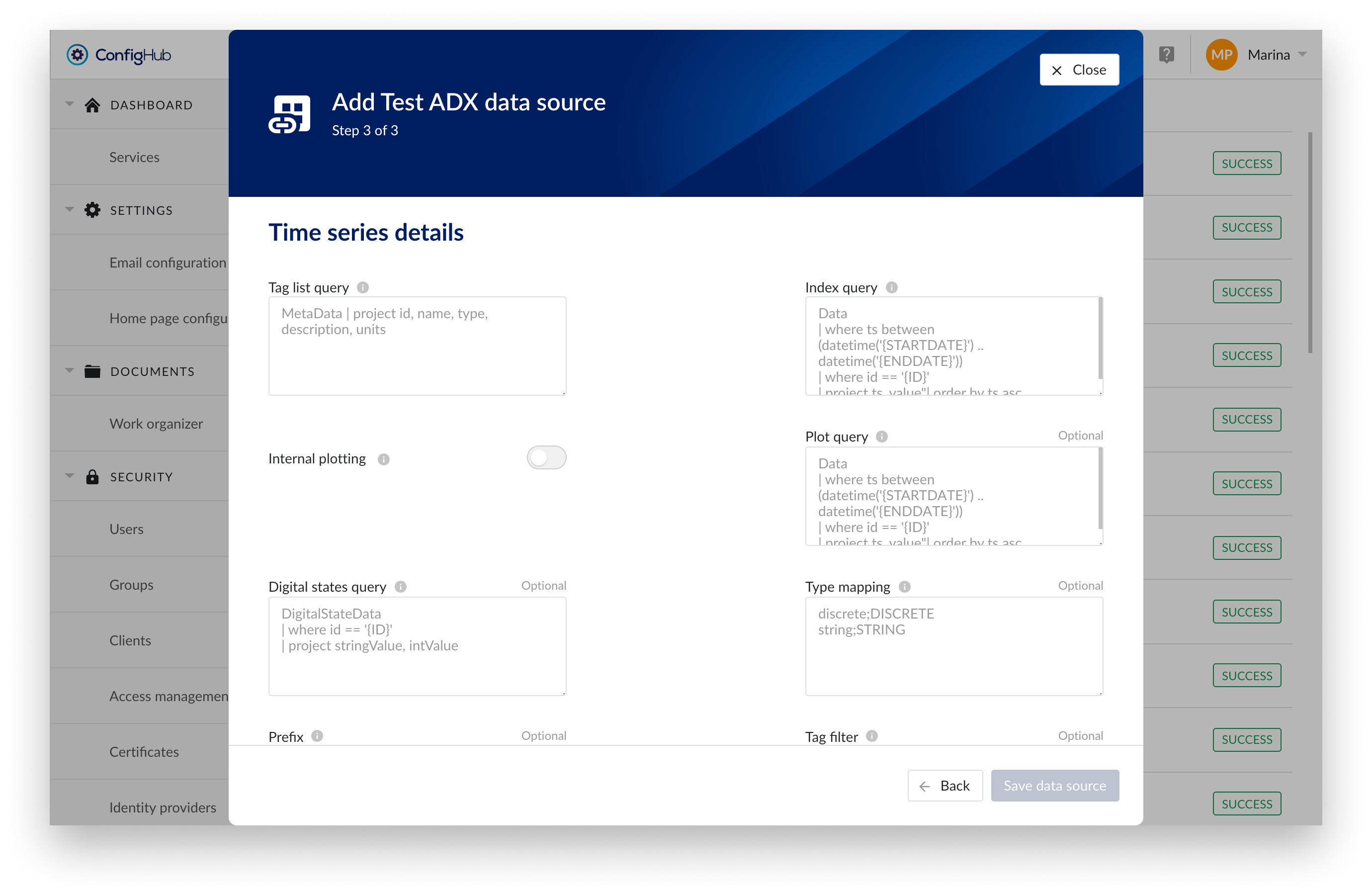

  • “Index query” - a query used by TrendMiner to ingest timeseries data for a specific tag. The query is expected to return a ts (timestamp) and a value. The following variables are available to be used in the WHERE clause of this query. The variables will be substituted at query execution with values. There should not be any NULL values returned by the SELECT statement so including "IS NOT NULL" in the WHERE clause is strongly recommended.
  • “Internal plotting” - When internal plotting is disabled, TrendMiner uses the configured plot query (if provided) to fetch aggregated/interpolated data directly from the data source when zooming in or when index data is unavailable, minimizing server load and network traffic; if no plot query is configured, it falls back to the tag's index data, which implies no tag data can be displayed until the tag is indexed. When internal plotting is enabled, any configured plot query is ignored entirely, and TrendMiner instead uses the index query to aggregate data internally, consuming more server resources and network bandwidth. Internal plotting should only be used when no performant plot query can be provided.
  • “Plot query” – a query used by TrendMiner to plot timeseries data for a specific tag. The query is expected to return a ts (timestamp) and a value. The following variables are available to be used in the WHERE clause of this query. The variables will be substituted at query execution with values. There should not be any NULL values returned by the SELECT statement so including "IS NOT NULL" in the WHERE clause is strongly recommended.
    • {STARTDATE}. TrendMiner will plot data per intervals of time. This denotes the start of such an interval.
    • {ENDDATE}. TrendMiner will plot data per intervals of time. This denotes the end of such an interval.
    1. customTypeA;ANALOG
    2. customTypeB;DIGITAL
    3. customTypeC;DISCRETE
    4. customTypeD;STRING
