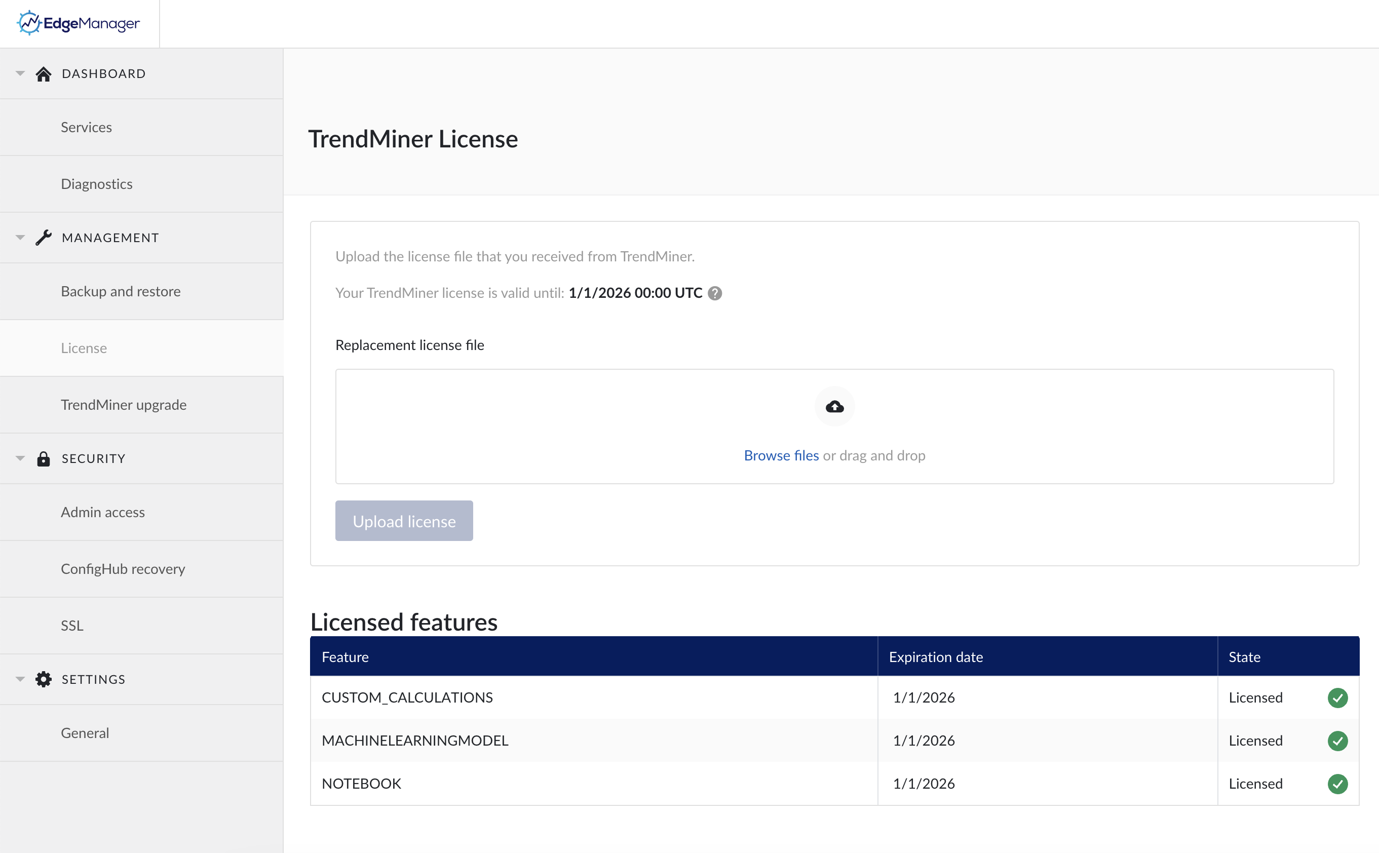

To use custom calculations, make sure the following prerequisites are met:
  • Make sure you installation matches the requirements with MLHub.
  • Reach out to your CSM (for customers) or partners@trendminer.com (for partners) to receive a license which includes Custom calculations and upload that license in Edge Manager.
    Note: No valid notebook or machine learning model licenses are required to use custom calculations.
    license edge manager 2024.R1.1 custom calculations
  • Give access permissions to individual users or groups as explained here.
