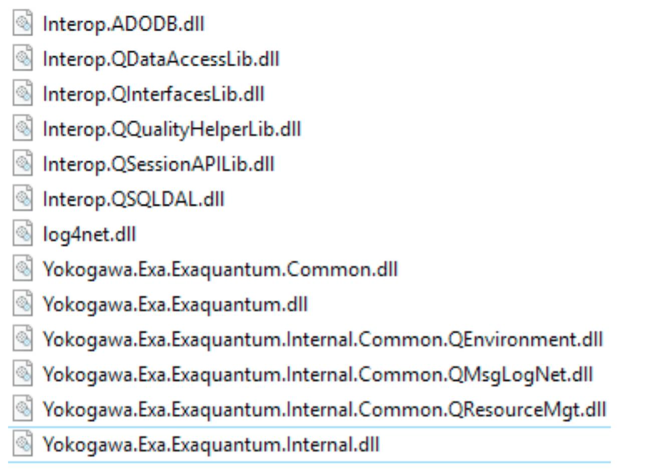

  4. Copy the following .dll files from Yokogawa Exaquantum server (e.g. C:\Program Files (x86)\Yokogawa\Exaquantum PIMS\System) to the Plant Integrations folder:
    • On the AppHost version of the connector: copy to (default location) C:\Program Files\TrendMiner\Plant Integrations\Connector and restart the connector services.
    • On the WebHost (IIS) version of the connector: copy to the Plant Integrations bin folder. The default location would be: C:\inetpub\PlantIntegrations\bin
    AxInterop.QDataSelLib.dll
    AxInterop.VSFlex7U.dll
    Interop.ADODB.dll
    Interop.MXTimeDialogs.dll
    Interop.MXXLDataSelector.dll
    Interop.QClientProxyLib.dll
    Interop.QDataAccessLib.dll
    Interop.QDragDropLib.dll
    Interop.QGeneralSecurityLib.dll
    Interop.QInterfacesLib.dll
    Interop.QItemIDCacheLib.dll
    Interop.QOPCAEPump.dll
    Interop.QOPCDAMgr.dll
    Interop.QQualityHelperLib.dll
    Interop.QRecalcEngine.dll
    Interop.QServerAccess.dll
    Interop.QServerSecurityLib.dll
    Interop.QSessionAPILib.dll
    Interop.QSQLDAL.dll
    Interop.QuantumAutomationLib.dll
    Interop.QuantumLib.dll
    Interop.QWebSecurityLib.dll
    Interop.QZOPCAECatchup.dll
    Interop.QZOPCDACatchup.dll
    Interop.SQLDMO.dll
    Interop.SSActiveTreeView.dll
    Interop.StdType.dll
    Interop.TeeChart.dll
    Interop.VBA.dll
    Interop.WEBAuthoring.dll
    log4net.dll
    Yokogawa.Exa.Exaquantum.Common.dll
    Yokogawa.Exa.Exaquantum.Common.xml
    Yokogawa.Exa.Exaquantum.dll
    Yokogawa.Exa.Exaquantum.Internal.Common.QEnvironment.dll
    Yokogawa.Exa.Exaquantum.Internal.Common.QMsgLogNet.dll
    Yokogawa.Exa.Exaquantum.Internal.Common.QResourceMgt.dll
    Yokogawa.Exa.Exaquantum.Internal.Common.QSettingInitialize.exe
    Yokogawa.Exa.Exaquantum.Internal.dll
    Yokogawa.Exa.Exaquantum.xml
    Yokogawa.Exaquantum.CommonControls.dll
    Yokogawa.Exaquantum.Security.dll
    Yokogawa.Framework.Extensibility.Licensing.dll
    Yokogawa.Framework.Extensibility.Security.dll
