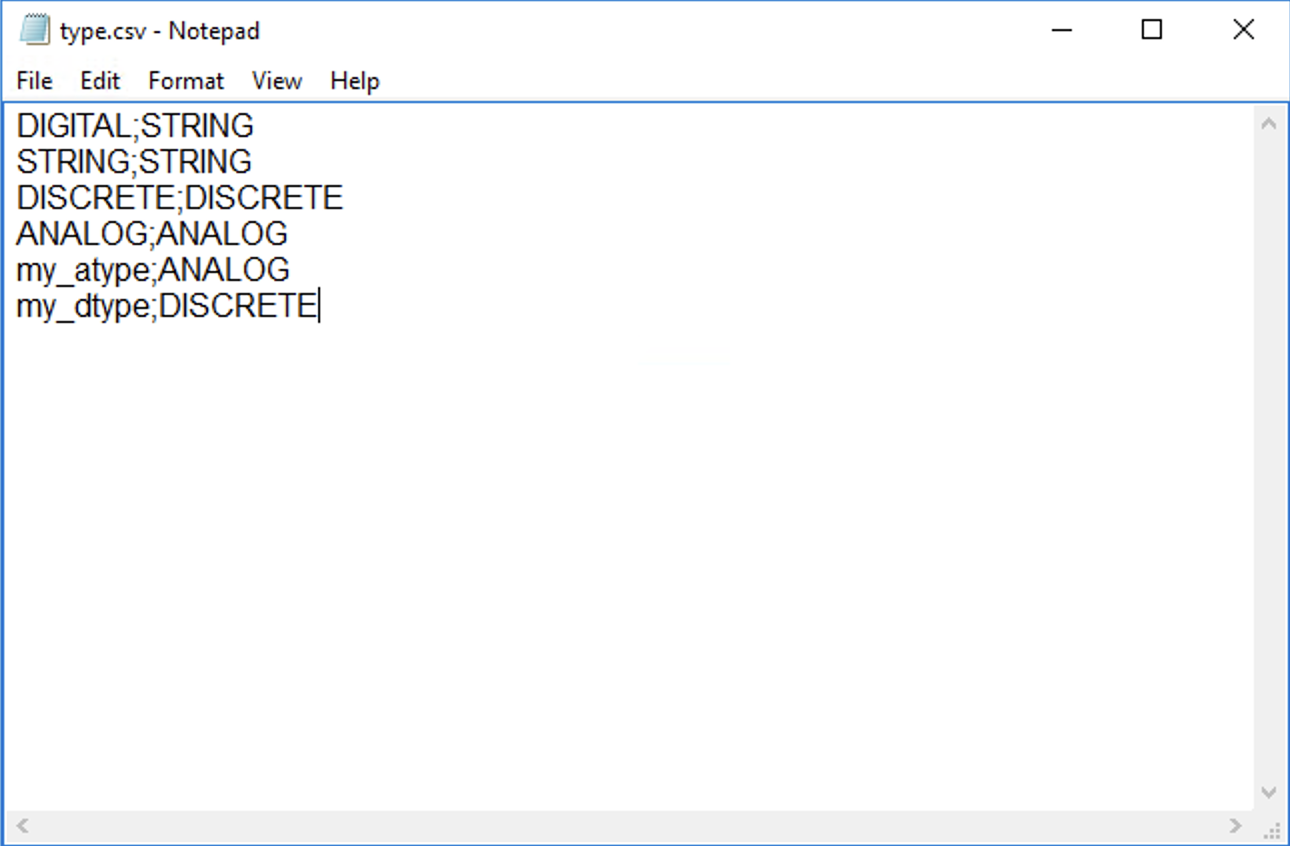

type.csv mapping
In the type.csv file, create one line per data type, with the output of the list.sql types as the first value, followed by a semicolon (";"), followed by one of the supported datatypes in TrendMiner. The example below ensures the results are returned in the right case, and a string result is explicitly returned as a DIGITAL result.

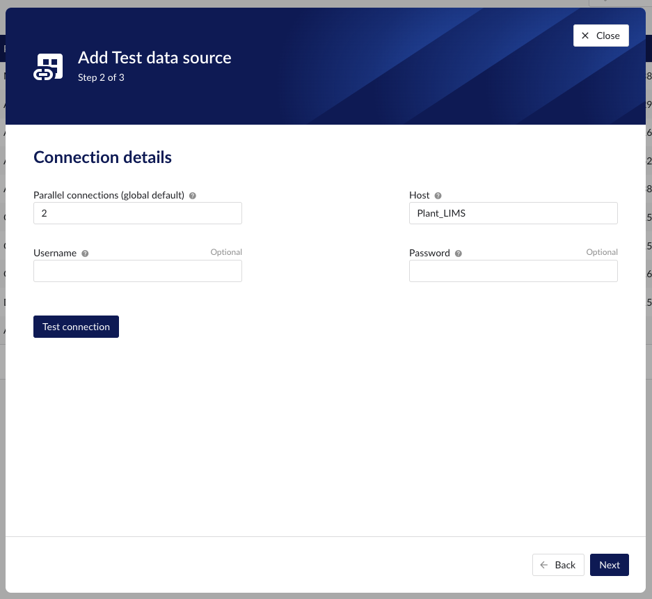

  • The “Host” name will be the name of the folder previously created containing all the configuration files as in the example below. The data source name is free to choose.
  • TrendMiner will consider the username and password provided in the “connection.txt” file and not the one provided through the interface. You do not need to provide the username and password here.
