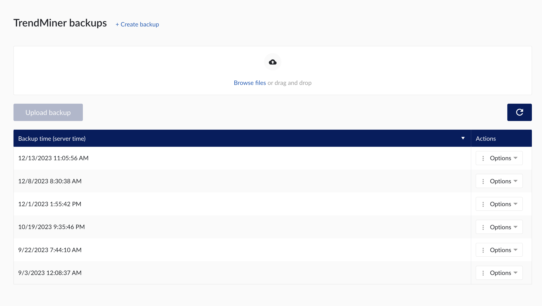

Backup
The TrendMiner Appliance automatically creates a backup before an update. However, we always advise to take a backup manually when changing important configuration such as the configuration of an external identity provider.
It is also advised to periodically create and download a backup manually in case major system failures render the system unusable.
With the "+ Create backup" link located at the top, a manual backup can be created. Backups that are created, are stored on the system until they are removed (available as "Delete backup" under the options menu of that backup). Backups can be downloaded with "Download backup" in the options menu of the backup.
Restore
To restore a backup, click ‘Restore backup'. Old backups can be uploaded to the TrendMiner Appliance by clicking the ‘Upload’ button having selected the backup to upload.
Uploading a backup does not restore that backup immediately. To restore a backup, click ‘Restore backup’ in the options menu.
Warning
Always check the available disk space when uploading or restoring a backup. Restoring a backup will fail when there is insufficient disk space left. The available disk space must be at least the size of the backup after extraction. We recommend having at least the same disk size as the installation the backup originates from in case of doubt.
The original backup date/time is not part of the backup itself. The date and time of the upload will be used to identify the backup.
The time displayed for the backup is always server time.
