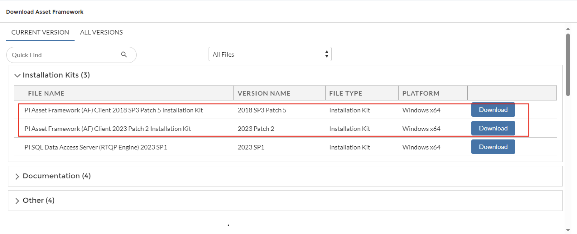

Where to download the Aveva PI AF SDK?
  • Log into the OSIsoft Customer Portal Products page with your credentials.
  • Navigate to the Products tab
  • Find the entry for Asset Framework and select the Download Installation Kits and Documentation icon
  • A list of installation kits appears. Find the installation kit for PI Asset Framework (AF) Client. If you want an older version of the installation kit, first click All Versions. When you find the correct version, click Download.
  • The licensing agreement appears. Click I agree on the licensing agreement and click Download.
  • When prompted to run or save the executable setup file, click Save and click OK.
