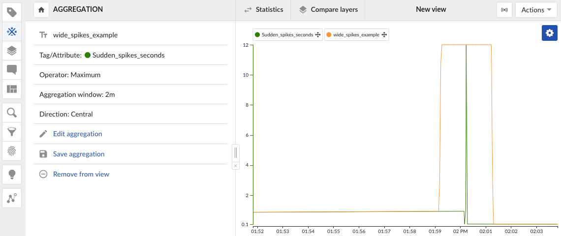

Create a maximum aggregation of the original tag with a central aggregation window that equals to two times the index resolution. This effectively creates a tag that creates a spike of at least two times the index resolution, even if the original event was only very short.
Perform a value-based search on the new aggregation tag being above the threshold. Using the default minimal duration of two times the index resolution should now yield all instances where the original tag exceeded the threshold, no matter how short.
