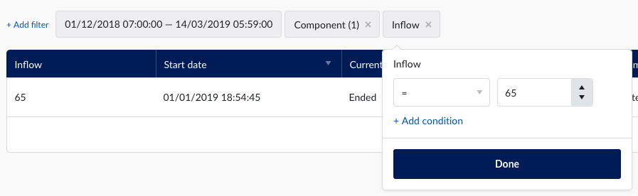

The newly made custom items can be added to the item view tables in the form of columns. If a number type custom field is added to a table, it will be possible to filter your new context type down to numerical ranges, data allowing.

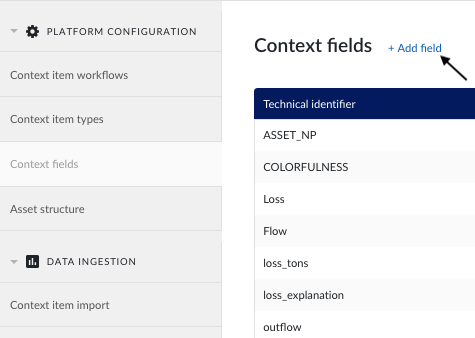

Select the gear icon located in the top bar of ContextHub.
Go to the PLATFORM CONFIGURATION menu.
Select "Context fields".
Click "Add field".

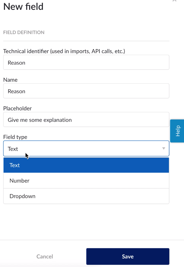

A side panel appears from the right called, "New field".
Fill in the fields provided in the side panel.
Click "Save".

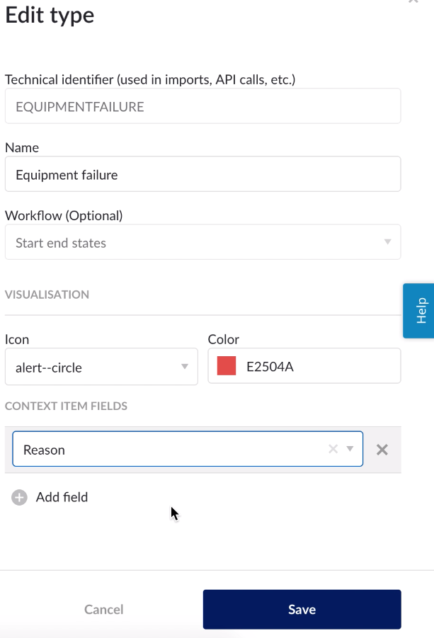

In the example above (left), a new field called "Reason" has been created. Now when you edit or create a new context item type (above right) you can add your new field. In this example, the context type "Equipment failure" is being edited so that a new field is required for completion. The new field added, is "Reason".
Click on "CONTEXT ITEM FIELDS" to search for and select your new field.

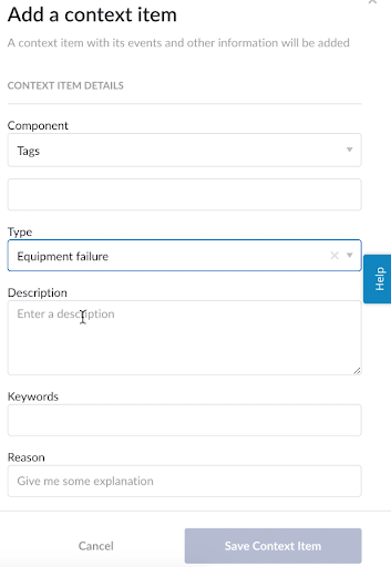

When you now add a new context item and you select the type "Equipment Failure" the new field "Reason" automatically appears as a necessary field.
