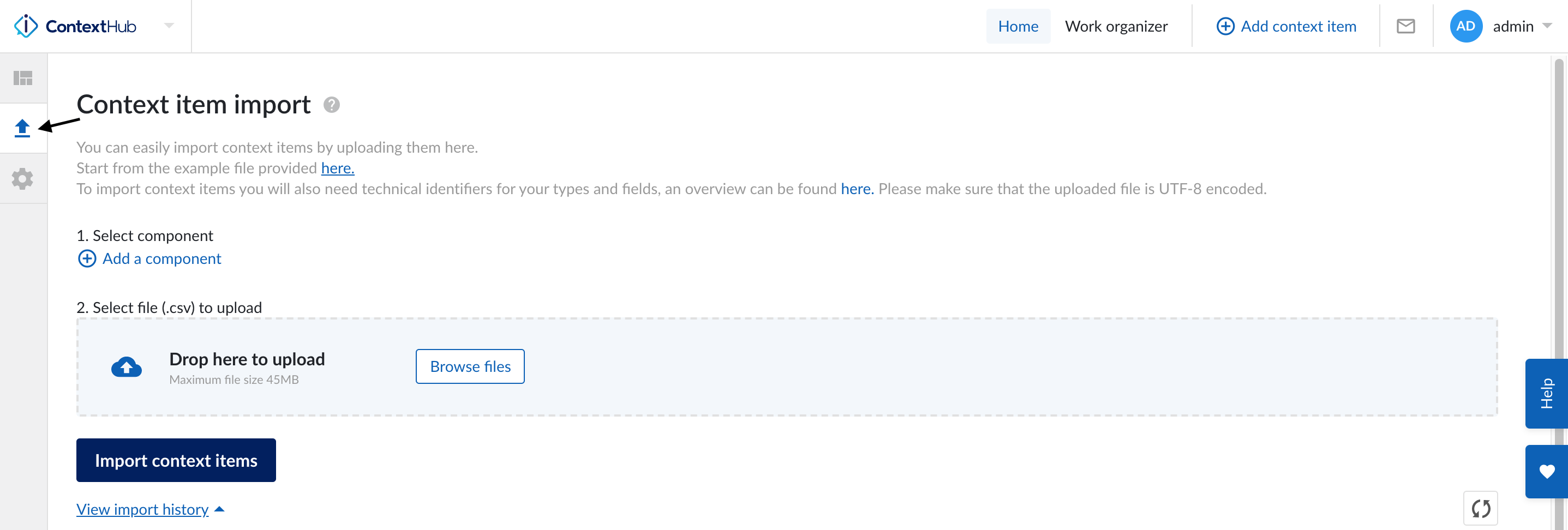

Import Screen
For quick ingestion of context data without plugging in an integration through APIs, there is a context item import available, where CSV files containing your data can be uploaded. For example, to do a quick import of a file with lab sample measurements.
This feature enables you to import historical and ad-hoc context data from an external platform.
In ContextHub click on the upload icon situated on the left side panel.
Click on "Add component" and populate the fields. In the right-hand side panel, the appears.
Select your file to import, and either drag and drop your file or upload via the browse files option.
Select the "View import history" button to list previous importations.
