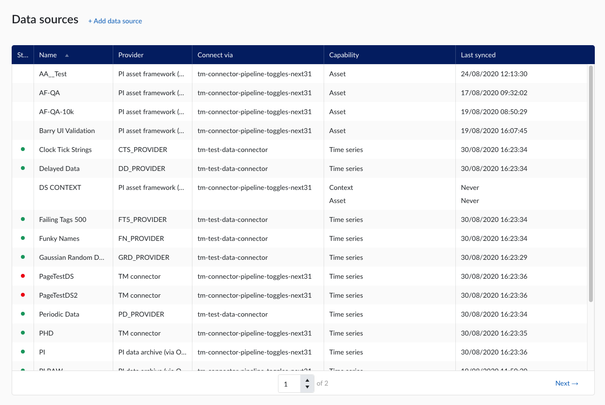

When clicking on the Data sources option, the data source menu appears:

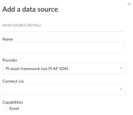

Add a new data source by clicking the (+ Add data source) label next to the title. An "Add data source" side panel will appear from the right of the screen:
Data source details

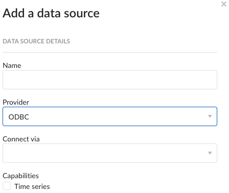

Populate the fields in the "Add data source" side panel:
Name: you are free to choose data source names but they are mandatory, case insensitive and unique. The name of a data source identifies the data source.
Provider: TrendMiner provides some out of the box connectivity to data sources via specific vendor implementations (e.g. OSIsoft PI, Honeywell PHD, ...) and via more generic alternatives (e.g. ODBC, OleDB, ...).The provider 'TM connector' enables the connection of data sources via a connector to connector setup. To connect a data source via multiple connectors, extra configuration is needed via the TrendMiner Connector API.
Connect via: this mandatory field is used to select the connector which is used to connect to the data source. All data sources need to be connected via a connector. To add a data source at least 1 connector needs to be added first.
Duplicate tag names are not supported. If 2 tags with exactly the same name are synced to TrendMiner, analytics, calculations and indexing on/for these tags might fail. Use data source prefixes to avoid possible duplicate tag name issues.

When you click on the Time series check box, further fields display for completion.
Connection details:
Host: the hostname of the data source, e.g. myhistorian.mycompany.com
Username and password: username and password of the account configured in the data source.
Password
Prefix: you are free to choose prefixes. They are case insensitive but unique strings and have a maximum length of 5 characters. When synchronising a data source, all tag names of that data source will be prepended with the prefix to ensure tag name uniqueness in TrendMiner. Prefixes are optional but we highly recommend the provision of a prefix when connecting a data source to avoid duplicate tag names.

Asset data
The process when dealing with asset data sources, is somewhat similar to the time series details, but much fewer fields are required for completion.
It is not permitted to add the same connection multiple times with asset capabilities enabled on both instances! Asset tree permissions need to be managed in the asset permission section (ContextHub).

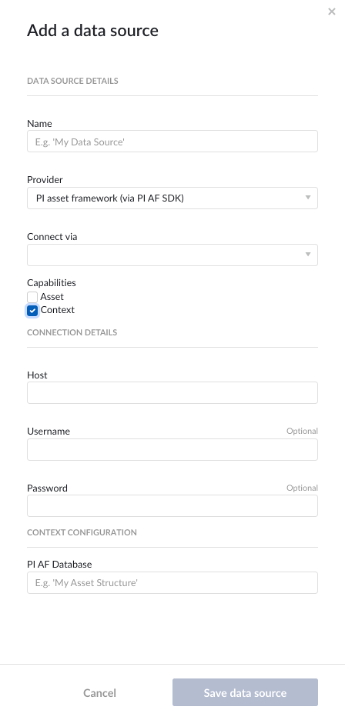

Context data
Context data sources are managed the same way as asset data sources. When a data source is context capable, the context capability checkbox can be checked, after which the correct database for context data needs to be specified.
Context data synchronized from a data source in OSISoft PI will be related to asset data in TrendMiner based on the "referenced elements" on the PI event frames. The system will always attempt to relate the context item to the asset corresponding to the primary referenced element in PI (if it exists). Otherwise it will default to the first referenced element for which a corresponding asset is known in TrendMiner.
It is not permitted to add the same connection multiple times with context capabilities enabled on both instances! This will result in the creation of duplicate context items.
Data source menu
As soon as a new data source is successfully added it will start syncing all the tags from the data source, and can be found in the Data source menu.

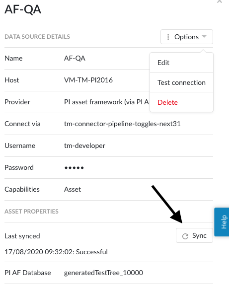

To manually synchronise the data source, simply:
Click on the data source of choice within the data source menu. A side panel will appear from the right.
Click on the sync button.

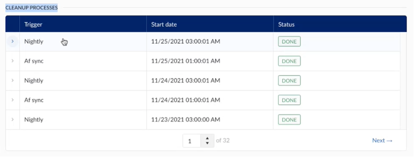

Cleanup Processes
There are two triggers for cleanup processes available, the nightly cleanup process triggered each night at a pre-set time, and an automatic resync of items without a component.
The automatic resyncs are monitored and managed exclusively by ConfigHub administrators, in the "Data source" under the "Settings" option in ConfigHub. Look to the "Data Source" section above.
Nightly sync
The automatic nightly resync of open items will appear in the diagnostics screen as an active job, once it starts. This sync is scheduled in Settings under the Data Section of ConfigHub.
Every night the system will check if there are context items open for more than 24 hours. This means that the context items have a start date present but no end time/date indicated. This implies the context items are still open.
Items open longer than 24 hours may be an indication, that the start event was good, but something went wrong during the closing event, preventing the closure of the context item.
Context items due to be closed will be properly updated as part of the nightly cleanup. If not, the context items will remain open until an end event appears from the source.
