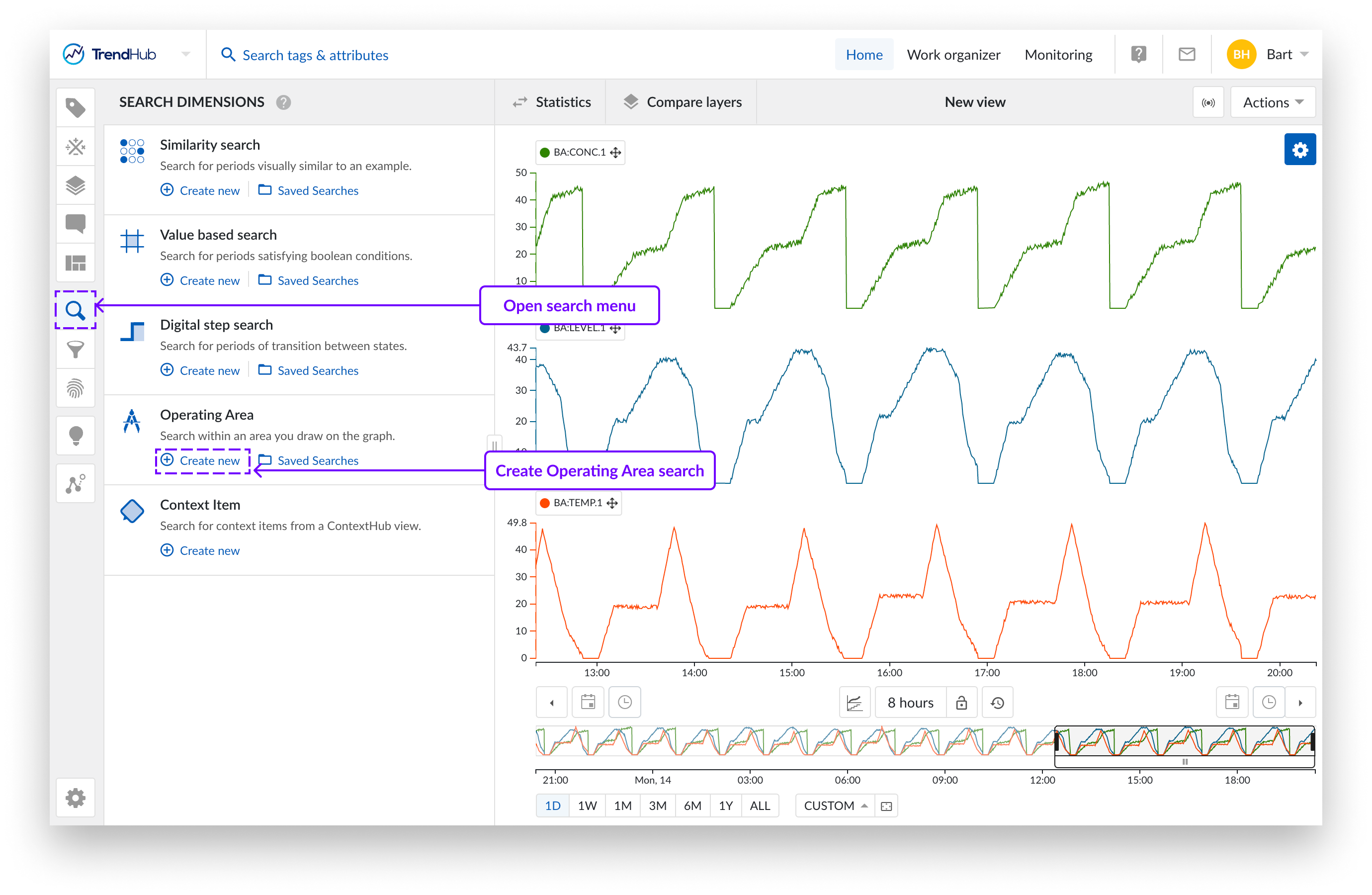

In TrendHub, open the search menu.
Make sure that you have at least two visible tags present on your chart.
Within the search menu, click "Create new" under the Operation Area search option.

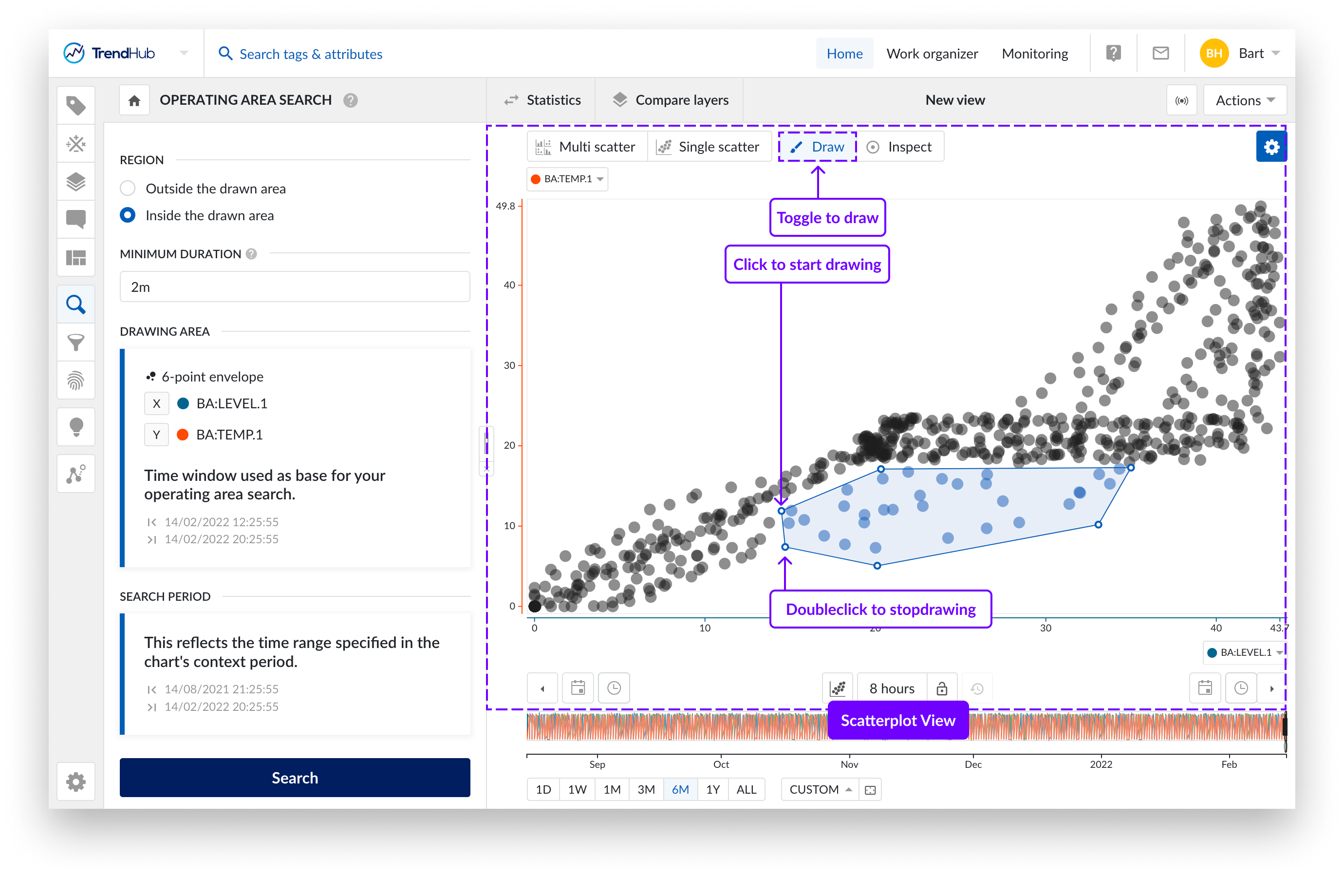

To draw a new area: Click the "draw" button on top of the single scatter plot and click inside the chart to start drawing and double click to end drawing. More details on scatterplots and how to draw an area can be read here on the scatter plot article.
Click the "Search" Button.

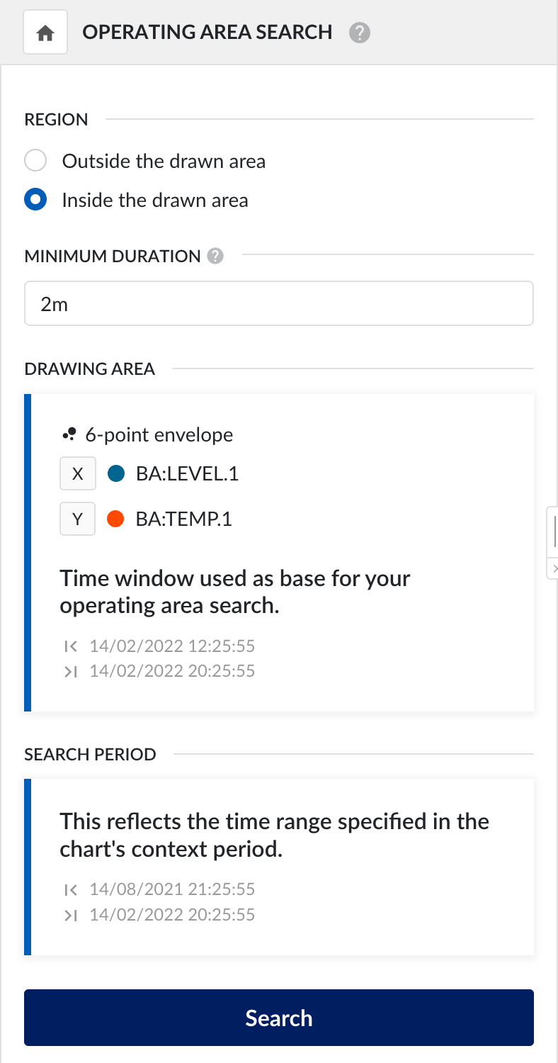

Region: Choose whether you want to look for periods where datapoints lie inside or outside your drawn area.
Minimum Duration: This is the minimum duration that the search conditions need to be true before they are returned as result.

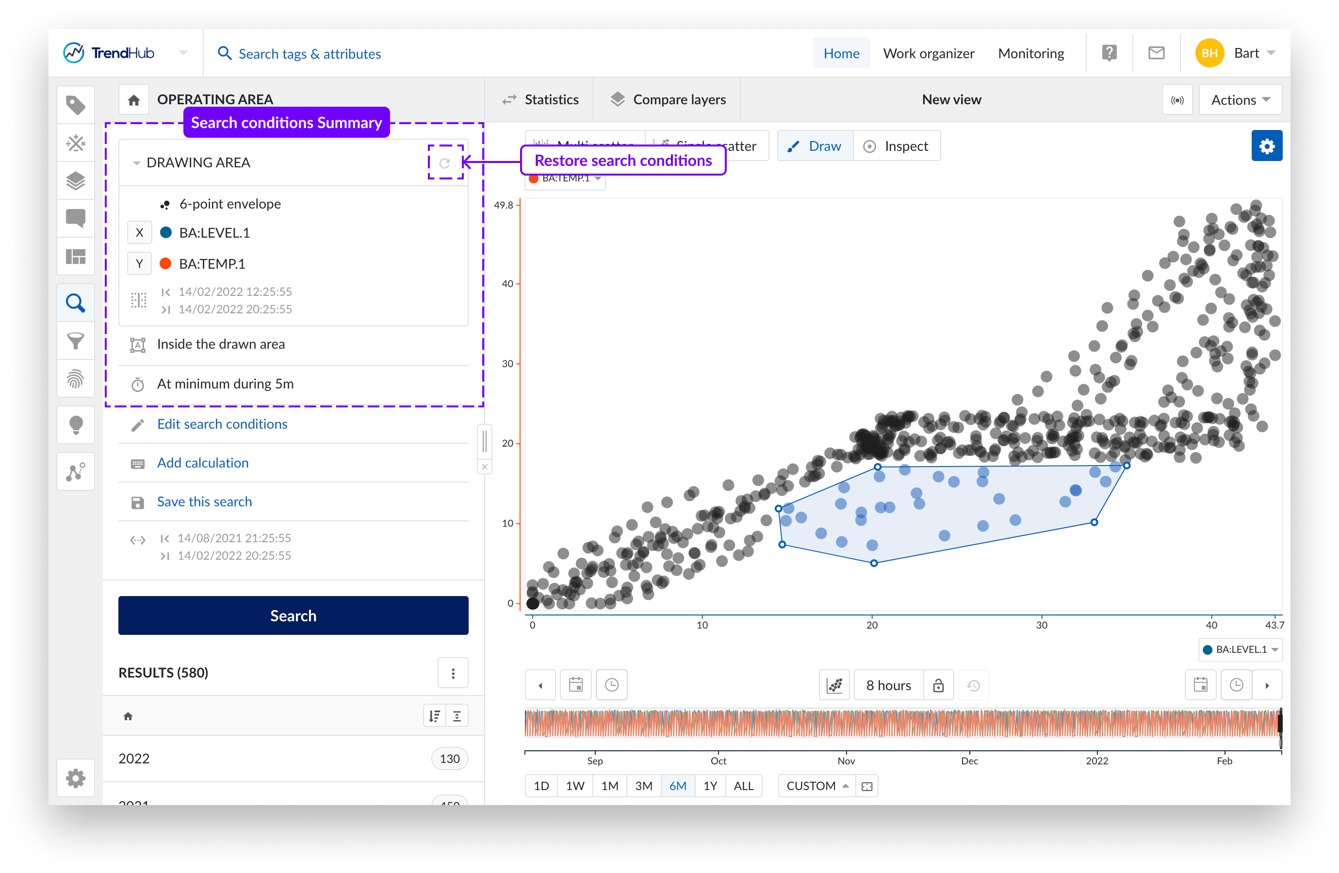

Drawing Area: This component shows the details of your drawn area (or envelope) on the scatterplot. The information shown includes:
The number of nodes that the drawn area/envelope contains.
The tags/attributes used on the X- and Y-axis.
The Focus Chart period range used to draw the area
The component will ask the user to draw an area if no active drawing can be detected.
Search Period: The period listed here reflects the time range specified in the chart's context period. Only search results between this start- and end-date will be returned. This value can be adjusted with the context period selector at the bottom of the chart.
A summary of your search results is shown at the top of the results menu. You can restore the initial search conditions by clicking the refresh icon. After clicking the restore-button:
The restore button is only available when a change has been detected in the drawn area and/or the reference period. You can restore the initial search conditions by clicking the refresh icon.
You may have to adjust your active tag list again if the used tags are no longer present in the active tag list, and have reached the maximum number of visible tags before you can restore your search conditions again.
The focus chart will be set to the listed period.
The listed tags will be loaded on the chart.
The drawn area will be drawn identical as from starting the initial search.
