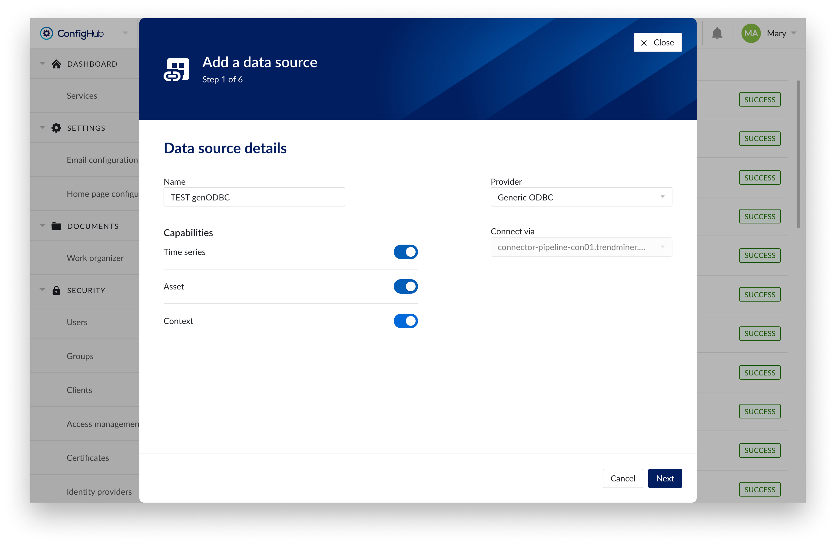

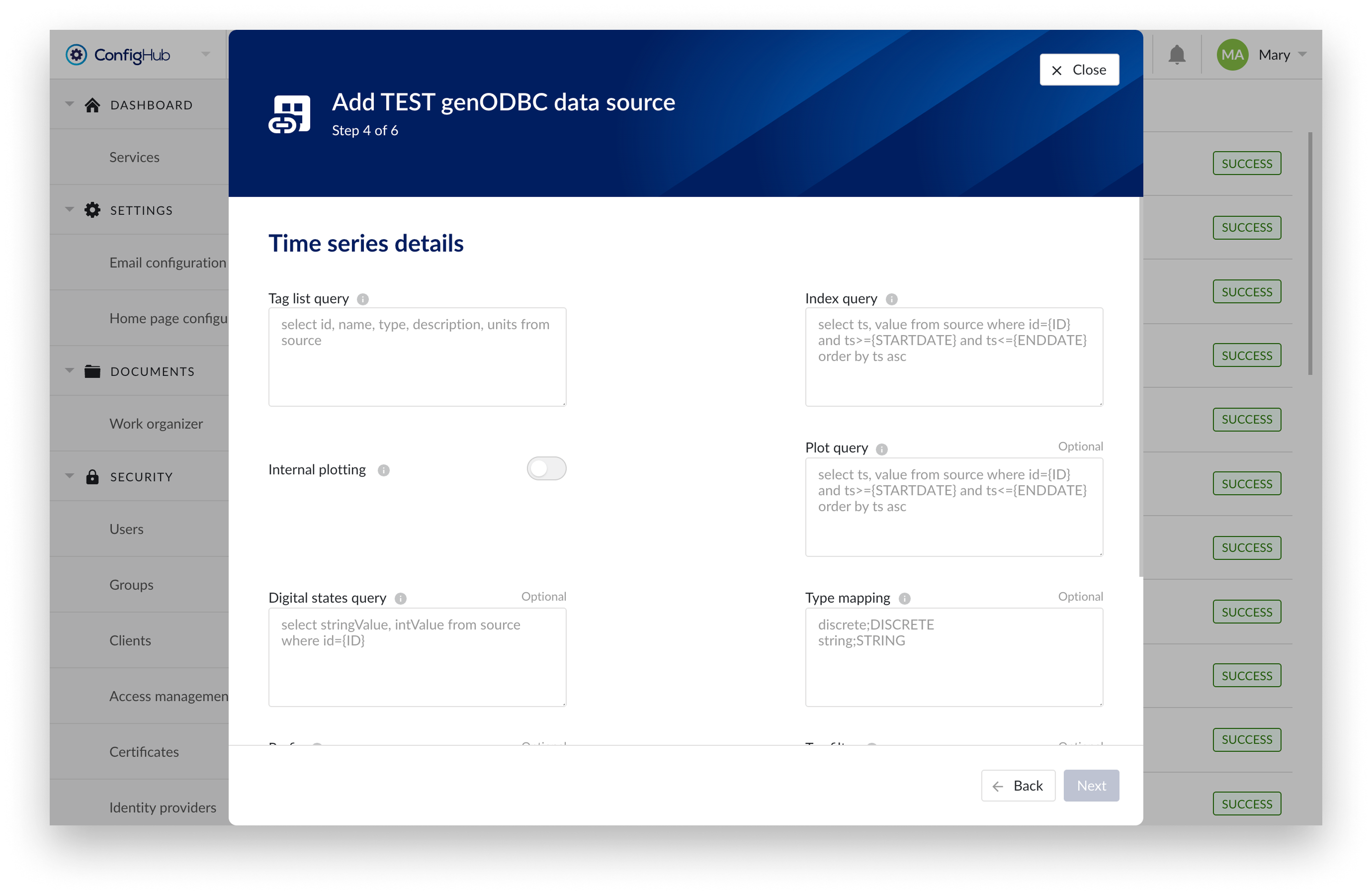

Creating a Generic ODBC data source in ConfigHub
To integrate with and ingest data from a database that supports ODBC, a data source of provider type “Generic ODBC” can be added and configured in ConfigHub.
To do so, navigate to Data > Data Sources in the left side menu. Choose the "+ Add data source" option, which will open a wizard. In the first step, choose a name and select “Generic ODBC” from the Provider dropdown.  This will add two new options to fill in:
  1. Capabilities: tick the box for each capability you intend to activate
  2. Connect via: which Plant Integrations you will use to connect to the database
Selecting the capabilities for the data source with the given checkboxes will define the additional steps in the wizard to complete, grouped in the following sections:

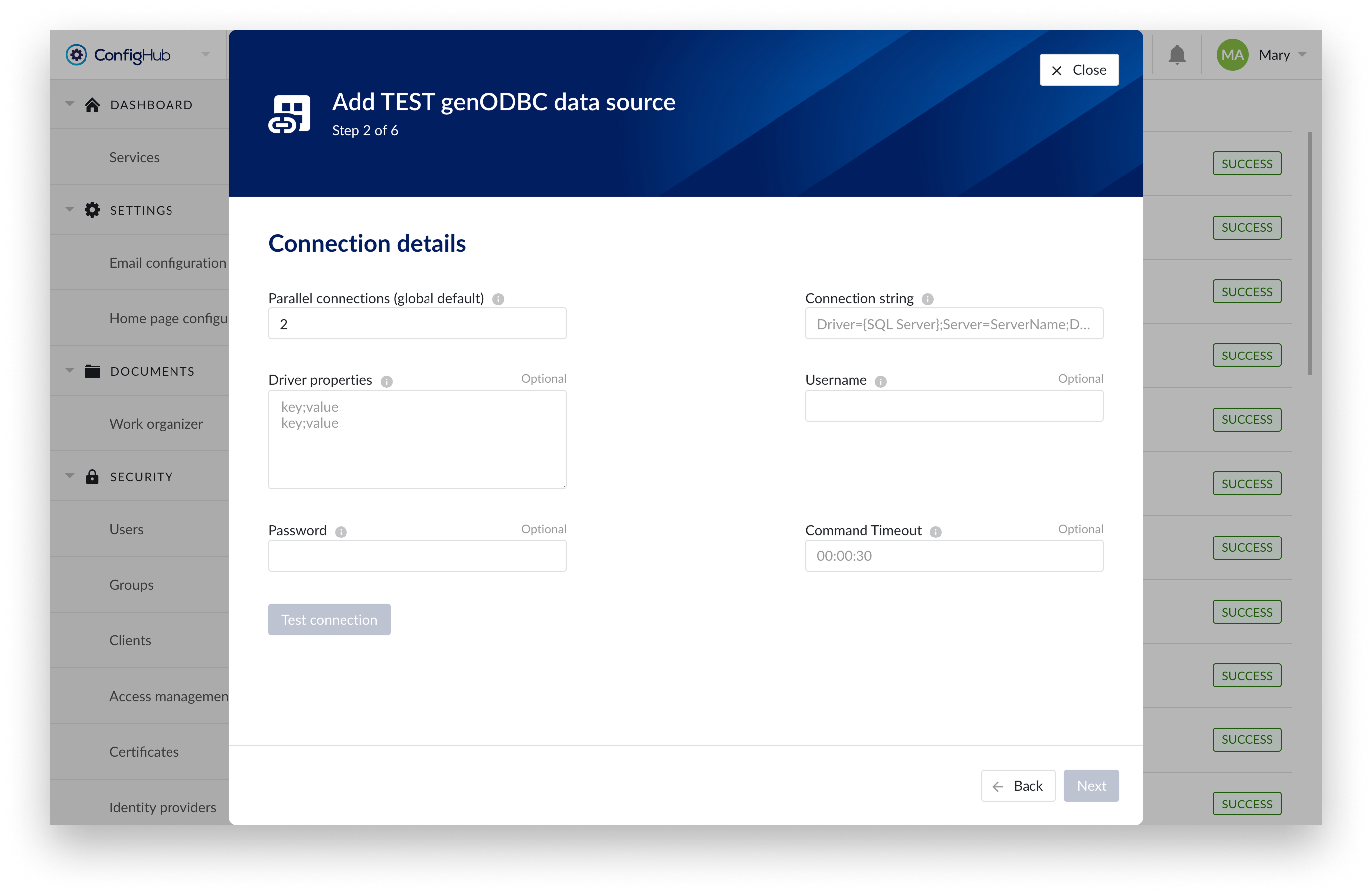

  • Connection details -  configure all properties related to the connection that will be established with the data source

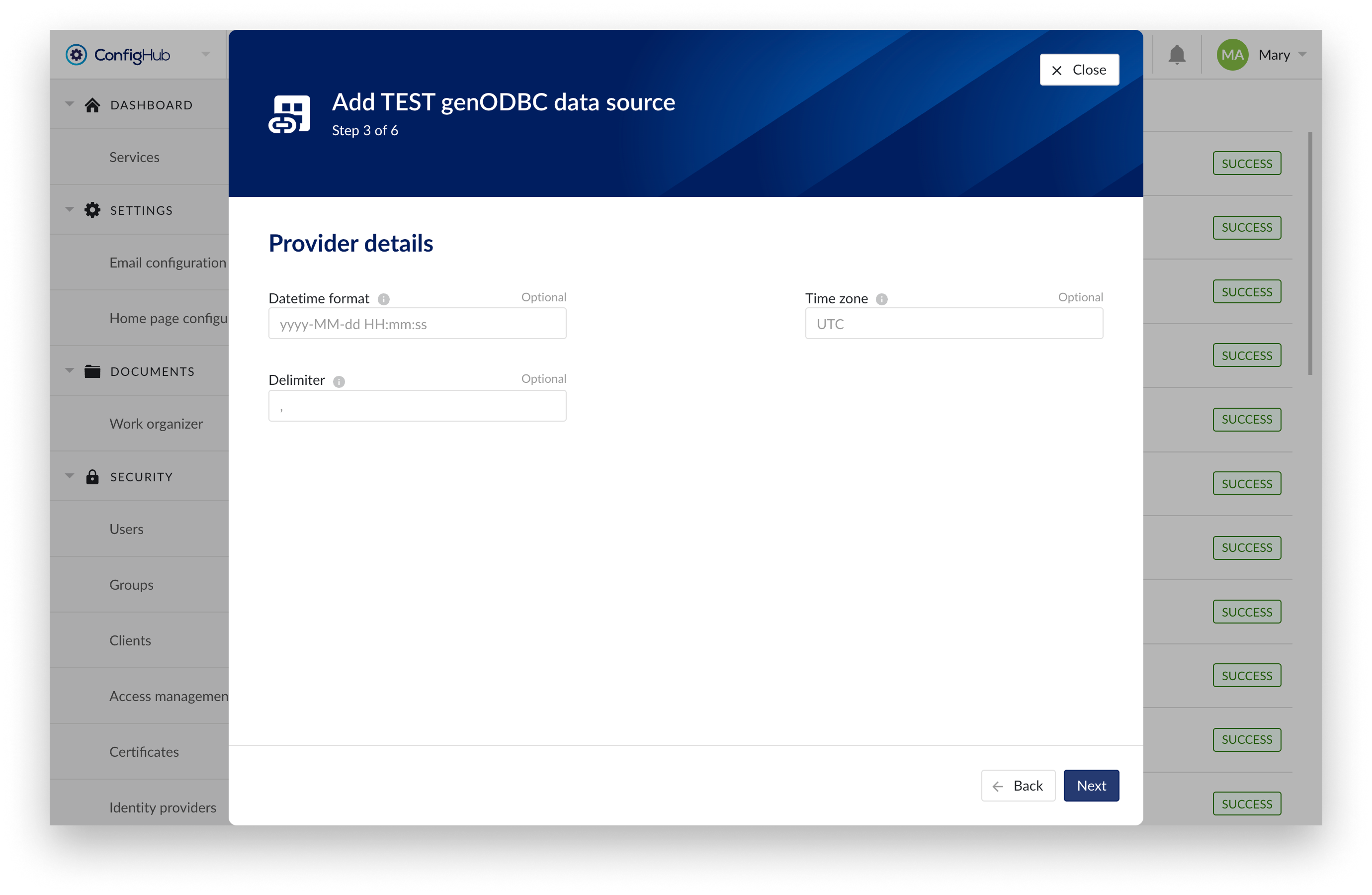

  • Provider details - configure properties that are shared by more than one capability
  • Time series details – configure properties relevant to time series data

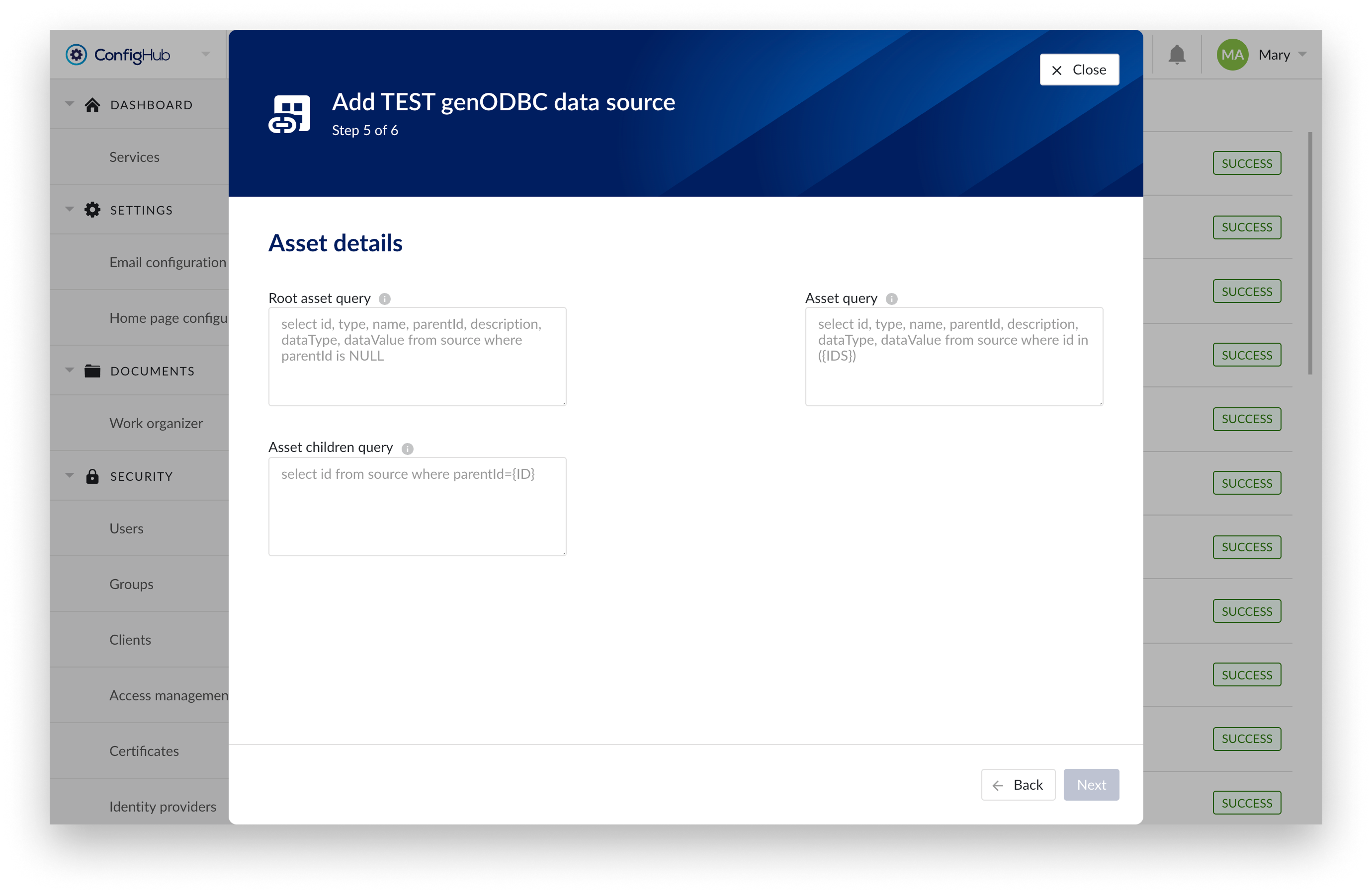

  • Asset details - configure properties relevant to asset data

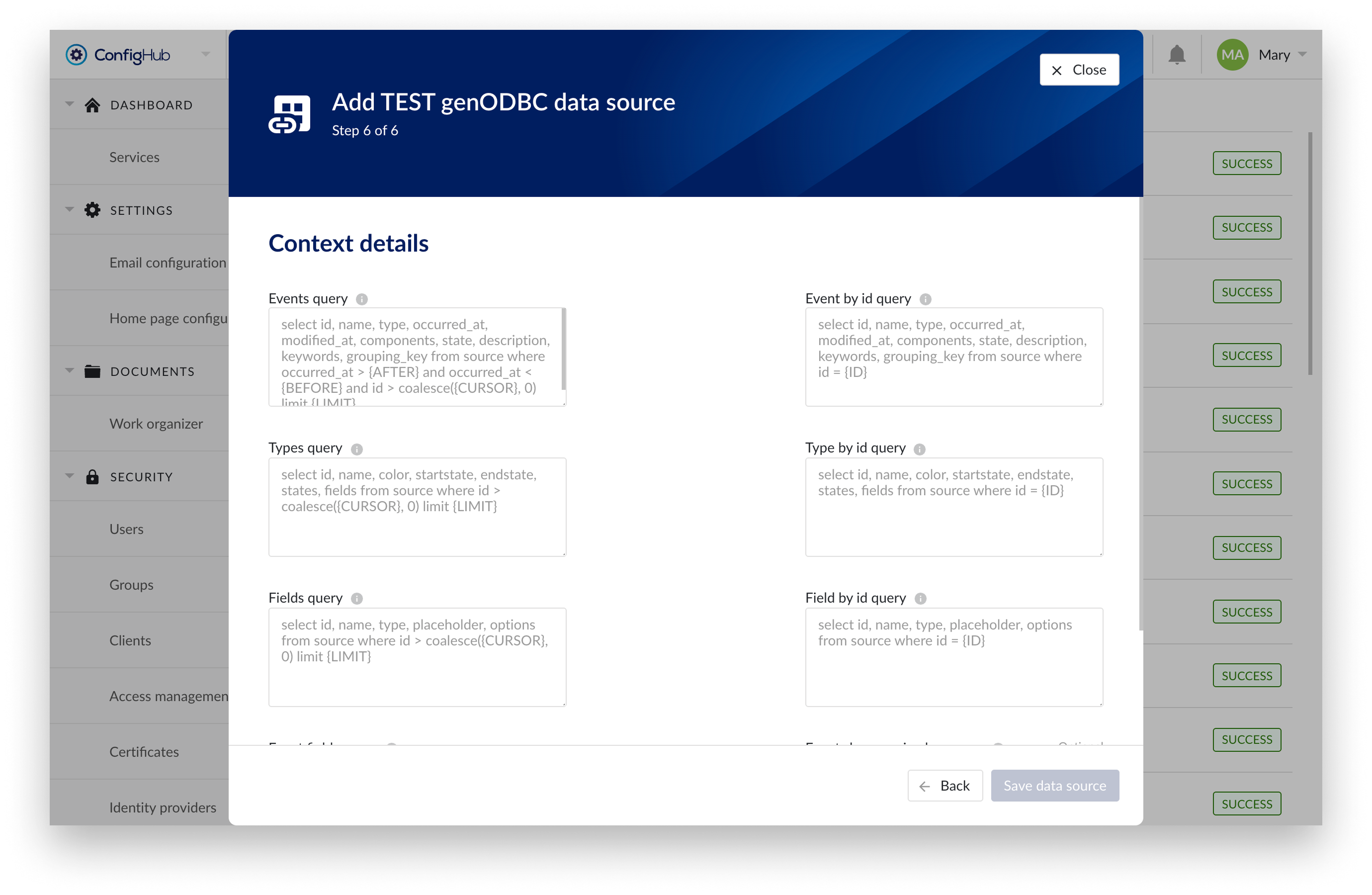

  • Context details - configure properties relevant to context data

Connection details
The Generic ODBC provider uses provider properties to configure every aspect of the provider, this includes queries, credentials and date formats.
Table 7. Connection details
Property
Required
Capability
Remarks
Connection string
yes
Time series
Asset
Event
Connection string used to connect to the underlying data source. When the same keywords are used in the connection string and the driver properties, the values from the driver properties are overwritten by the values from the connection string.
Same logic applies for credentials: Username (UID) and passwords (PWD) from driver properties are overwritten by username and password from connection string and theses are overwritten by the username and password provider properties.
Notice
Advanced: When the Odbc driver does not support the UID or PWD keywords, but use Username and Password instead, you can specify these as dummy keywords in the driver properties and those will then be overwritten by the username and password provider properties specified in ConfigHub.
Driver properties
no
Time series
Asset
Event
Driver properties are used as an additional way to add keywords and their values to the connection string. Driver properties are seen as more general properties and will be overwritten by values specified in the connection string.
Username
no
Time series
Asset
Event
A convenience field to enter the username used to establish a connection to the database. This information can also be specified in the connection string and driver properties.
Password
no
Time series
Asset
Event
A convenience field to enter the password used to establish a connection to the database. This information can also be specified in the connection string and driver properties.
Warning
Driver properties and Connection string are not encrypted, password however is encrypted.
Parallel connections
yes
Time series
Each data source has 2 queues: one interactive - plot calls, one non-interactive - index calls, batch calls etc. Parallel connections determine how many connections each queue has to the connector. By default there are 2 parallel connections to the connector.
Command Timeout
no
Time series
Asset
Event
Predefined time limit in which a command needs to be executed before terminating and generating a error.
By default the interval is 30 seconds. A custom time can be set using the format “hh:mm:ss“ (hours, minutes, seconds). E.g. “00:01:30“.
Not all data sources support command timeout
Provider properties
Table 8. Provider (shared) details
Property
Required
Capability
Remarks
Datetime format
no
Time series
Event
An optional format your time series data is stored in.
Daylight Saving and Local timestamps
When the datetimes are stored as a date time in your local time zone, you SHOULD include the offset (which changes during daylight saving transitions) in the string representation of the timestamp, specify the DateTimeFormat as yyyy-MM-dd HH:mm:ss zzz and set the Timezone to your local time zone. This will insure that the daylight savings transition rules are respected, and that your datetimes will be parsed correctly.
There will be a validation error shown when you specify a DateTimeFormat without the offset specifier (zzz) and a Timezone other than UTC.
ISO8601
If the source system expects/returns the datetime values as ISO8601 UTC, you should use yyyy-MM-ddTHH:mm:ss'Z'as DateTimeFormat and UTC as Timezone.
e.g.2024-01-01T08:00:00Z

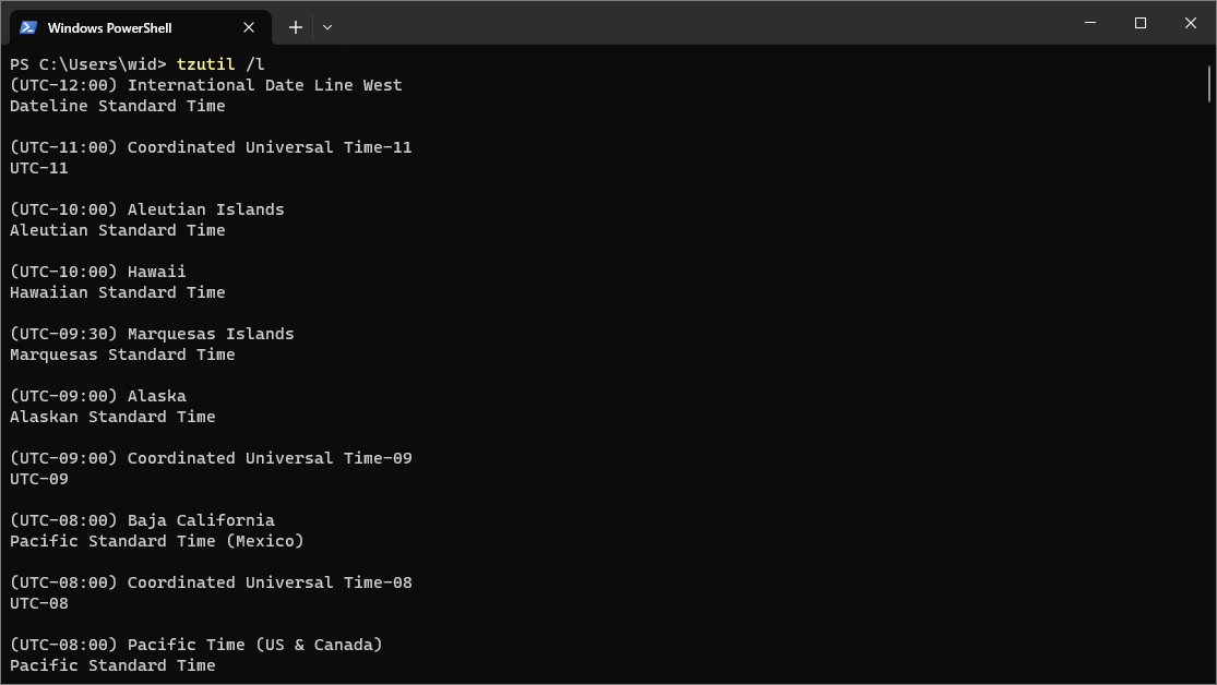

Timezone
no
Time series
Event
An optional timezone your time series data is stored in. Default is UTC.
The list of supported values are defined by the operating system of Plant Integrations. To get this list you can use the following command:
Notice
The second line for each time zone is the identifier that can be used, e.g. “Pacific Standard Time“
Delimiter
no
Asset
Event
Delimiter used to separate a multi string column/ field in the provider. The default is comma (,)
Asset Capability

Time series details
Caution
Because the id of the tag is missing from the contract between tm-datasource and tm-plant-integrations. The name column is used for {ID} variable.
Table 9. Time series capability properties
Property
Required
Remarks
Tag list query
yes
A query used by TrendMiner to create tags. A query needs to be provided that will, given your database schema and tables.
Example:
Columns:
  • id (string)
    • Unique identifier for each row returned by the query, like a primary key in a database table
    • Mandatory
  • name  (string)
    • Name of the tag
    • Mandatory
  • type (string)
    • Type of a tag. Without additional mapping, type must be one of the following tag types:
      • ANALOG
      • DIGITAL
      • DISCRETE
      • STRING
    • Optional, if the column is not in the query, the default type ANALOG is used
    • Custom types can be returned here but then a type mapping must be added as well.
  • description (string)
    • Description of a tag
    • Optional, can be empty or null value
  • units (string)
    • Unit of measurement for the tag
Index query
yes
A query used by TrendMiner to ingest time series data for a specific tag. The query is expected to return a ts (timestamp), value and optionally an offset.
The results should be sorted ascending on timestamp, if not they will be sorted by the provider.
Variables:

Digital states query
no
If tags of type DIGITAL are returned by the tag list query, TrendMiner will use this query to ask for the stringValue, intValue pairs for a specific tag to match a label with a number.
Variables:
  • {ID}  (string)
    • The Name as returned by the tag list query for tags with type DIGITAL.
Example:
select stringValue, intValue from source where id={ID}
Columns:
  • stringValue (string)
    • Possible value of a digital tag
  • intValue (numeric)
    • Numeric representation of a possible value of a digital tag
Type mapping
no
If types differ from what TrendMiner uses and one wants to avoid to overcomplicate the query, a type mapping can be entered here. It can contain multiple lines and expect per line the value
to be representing a custom type followed by a ; and a TrendMiner type. During the execution of the tag list query TrendMiner will then use this mapping to map the custom values returned in
the query to TrendMiner tag types.
customTypeA;ANALOG
customTypeB;DIGITAL
customTypeC;DISCRETE
customTypeD;STRING

Asset details
Table 10. Asset capability properties
Property
Required
Remarks
Root asset query
yes
 This query is responsible for returning all top level elements from the asset tree structure.

Asset query
yes
This query needs to return details for a specific asset record.

Asset children query
yes
This query needs to return the ids of the direct descendants of this asset.

Context details
Table 11. Event capability properties
Property
Required
Remarks
Events query
yes
This query is responsible for returning events from the source database. Context items will be generated based on these events.

Event by id query
yes
This query is responsible for returning a specific event from the source database.

Types query
yes
This query is responsible for returning a list of possible event types from the source database.

Type by id query
yes
This query is responsible for returning an event type from the source database.

Events by grouping key query
yes
This query is responsible for returning event(s) from the source database that are within the same group.
Variables:
  • {CURSOR} (string | numeric)
    • A unique and sorted value that is used in the cursor based pagination implementation.
  • {LIMIT} (numeric)
    • The maximum number of records the query should return.
  • {GROUPINGKEY} (string)
    • The key that represents grouped events.
Example:
select id, name, type, occurred_at, modified_at, components, state, description, keywords, grouping_key from source where grouping_key = {GROUPINGKEY} and id > coalesce({CURSOR}, 0) limit {LIMIT}
Columns
  • id (string)
    • A unique identifier for each row returned by the query, like a primary key in a database table
    • Mandatory
  • name (string)
    • Name of the event
    • Mandatory
  • type (string)
    • The identifier of the type of the event (as specified in the type/types query)
    • Mandatory
  • occurred_at (string | DateTime | long)
    • The timestamp when the event occurred
    • Parsed using the format specified in the DateTime format provider property
  • modified_at (string | DateTime | long)
    • The timestamp when the event was modified
  • components (string)
    • A list of component (asset) identifiers separated by the Delimiter (',' by default)
      Notice
      It is not possible to link events directly to tags using the generic ODBC provider. Create an asset structure before syncing events.
  • state (string)
    • The state for this event record
    • Description of the event
  • keywords (string)
    • A list of keywords associated with the events, separated by the Delimiter (',' by default)
  • grouping_key (string)
    • The identifier of the object which raised the event, all events of the same object should have the same grouping_key
Example queries (Sqlite)
Below we provide some example queries that can be used in the Generic ODBC provider for the sqlite odbc drivers.
TIME SERIES CAPABILITY
Tag list query
Index query
select ts, value from source where id={ID} and ts >= {STARTDATE} and ts <= {ENDDATE} order by ts asc
Plot query
select ts, value from source where id={ID} and ts >= {STARTDATE} and ts <= {ENDDATE} order by ts ascselect ts, value from source where id={ID} and ts>={STARTDATE} and ts<={ENDDATE} order  by ts asc
Digital state query
ASSET CAPABILITY
Root asset query
Asset query
select id, type, name, parentId, description, dataType, dataValue from source where id in ({IDS})
select id from source where parentId={ID}
EVENT CAPABILITY
Events query
select id, name, type, occurred_at, modified_at, components, state, description, keywords, grouping_key from source where occurred_at > {AFTER} and occurred_at < {BEFORE} and id > coalesce({CURSOR}, 0) limit {LIMIT}
Event by id query
select id, name, type, occurred_at, modified_at, components, state, description, keywords, grouping_key from source where Id = {ID}
Types query
select id, name, color, startstate, endstate, states, fields from source where Id > coalesce({CURSOR}, 0) limit {LIMIT}
Type by id query
select id, name, color, startstate, endstate, states, fields from source where id = {ID}
Fields query
select id, name, type, placeholder, options from source where Id > coalesce({CURSOR}, 0) limit {LIMIT}
Field by id query
select id, name, type, placeholder, options from source where Id = {ID}
Event fields query
