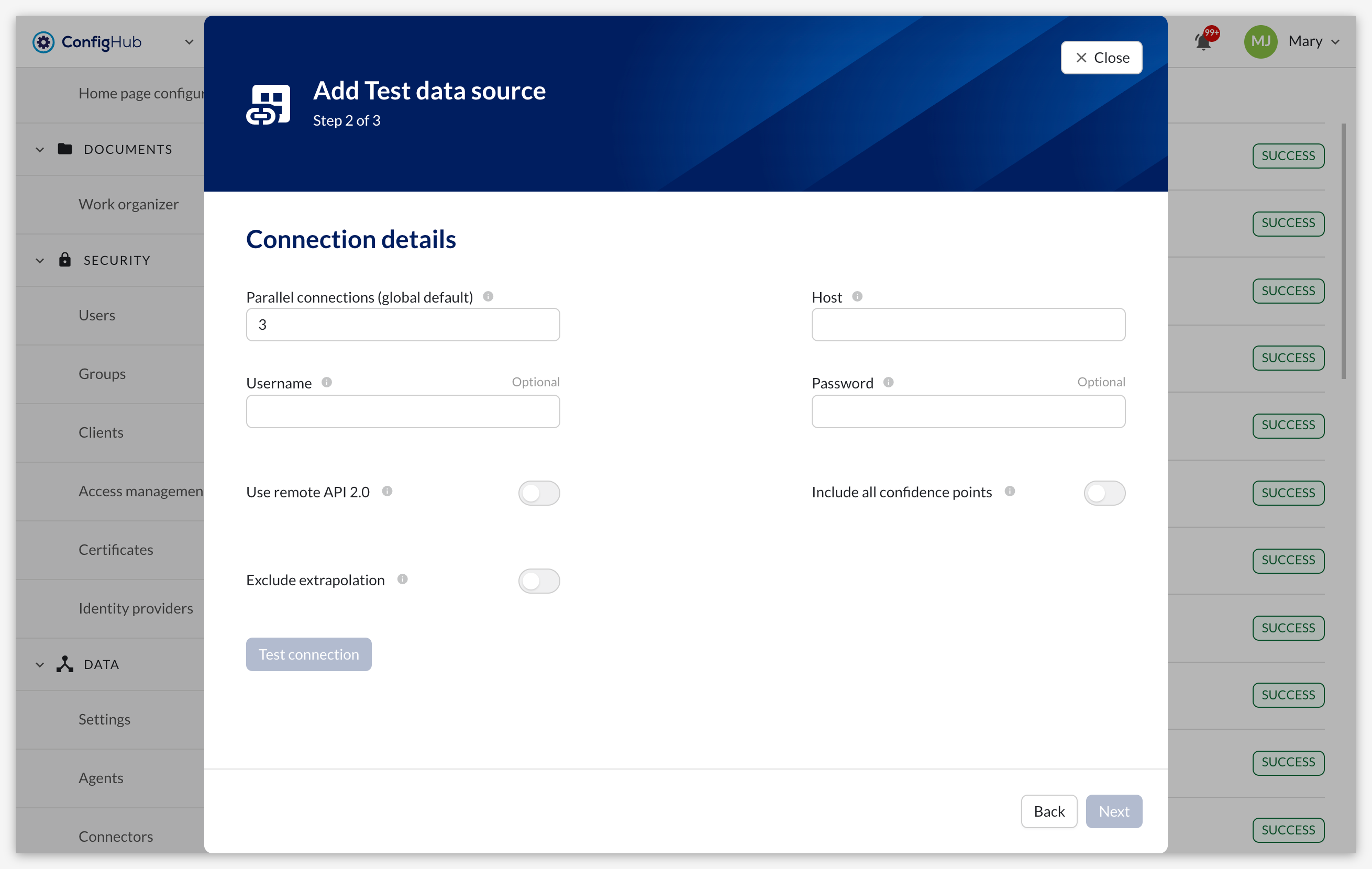

  5. Configure the PHD-specific connection properties as described below.
When configuring the connection details, the following PHD-specific properties are available:
  • Use remote API 2.0: Controls which API version is used when establishing a connection to the PHD historian. When set to false (default), the connector uses default PHD API. When set to true, the connector uses the Remote API 2.0  (RAPI200).
    Enable this option if your environment requires communication over the Remote API 2.0 interface for the connector to successfully establish a connection.
  • Include all confidence points: Defines whether the provider should include data points with a confidence level below 100. The default value is false.
    Enable this option if you want TrendMiner to retrieve and display data points that the PHD server has flagged with a confidence level lower than 100, for example uncertain or estimated values.
  • Exclude extrapolation: When enabled, the system will filter out any data points from the main result set that are newer than the most recent actual value, to avoid extrapolated results. The default value is false.
    Enable this option to ensure that only actual, non-extrapolated values are returned. This is recommended for tags that update less frequently or irregularly. More details in PHD extrapolation article.
