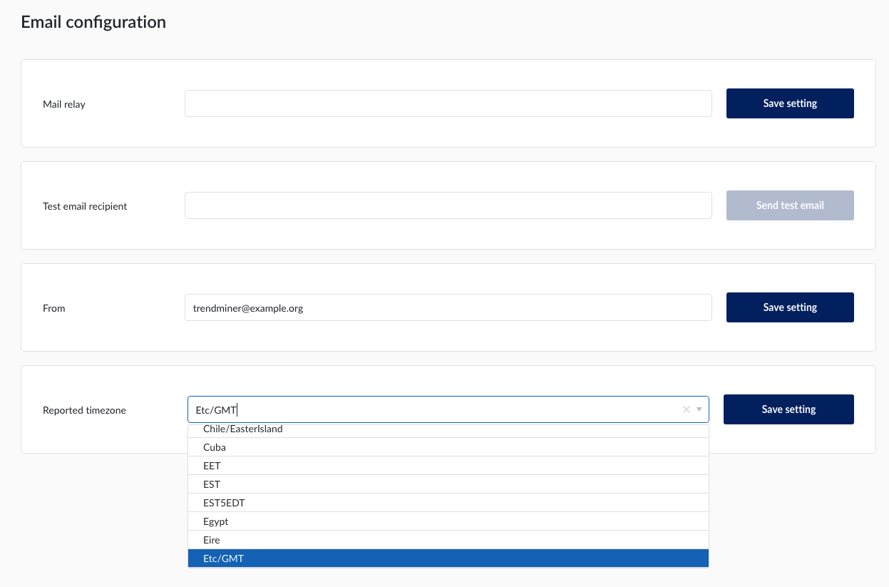

This email configuration is not available for TrendMiner SAAS
  • Mail relay: the IP address or hostname of the mail relay server, used for sending e.g. TrendMiner monitoring mails.
  • Test email recipient: fill in your email address and press the "Send test email" to verify your mail relay is configured correctly.
  • From: email address used as the "From" field for TrendMiner email.
  • Reported timezone: Starting time stamp is default at UTC. The timezone can be adjusted and set as necessary.

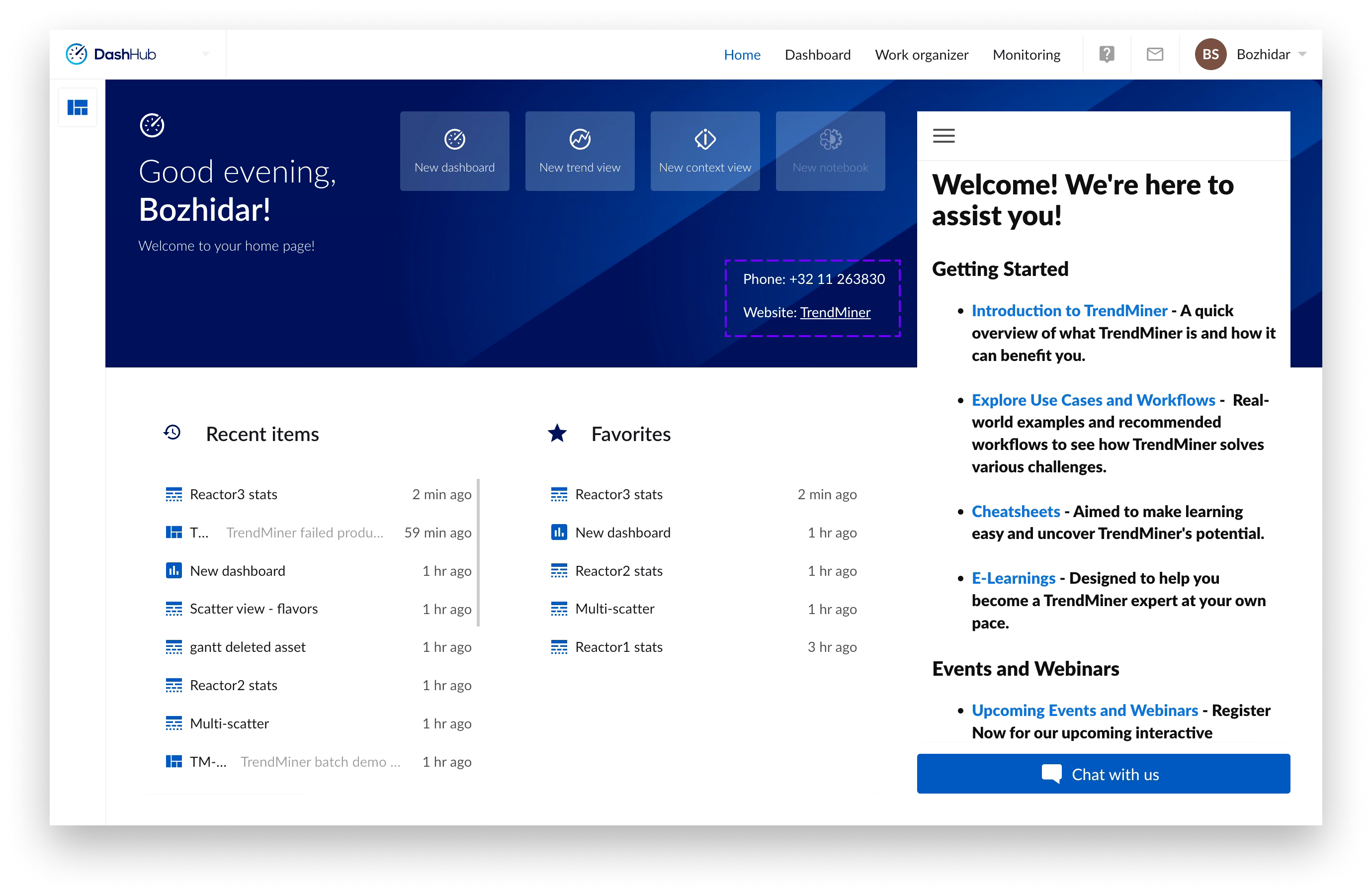

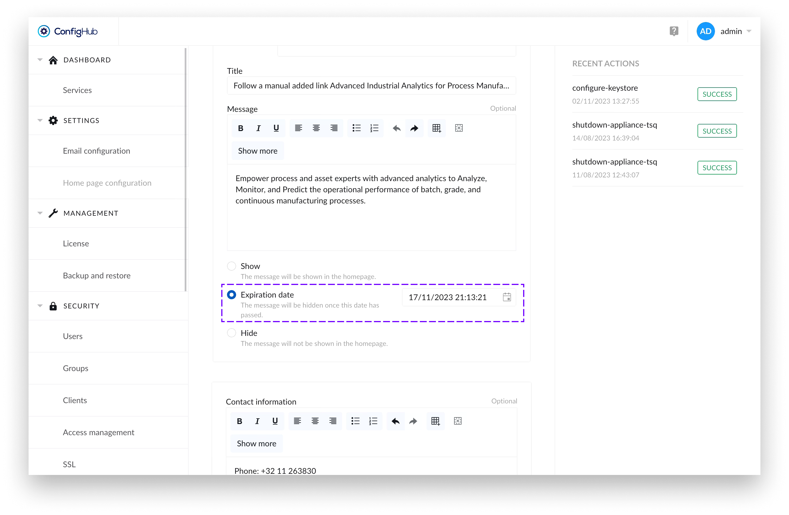

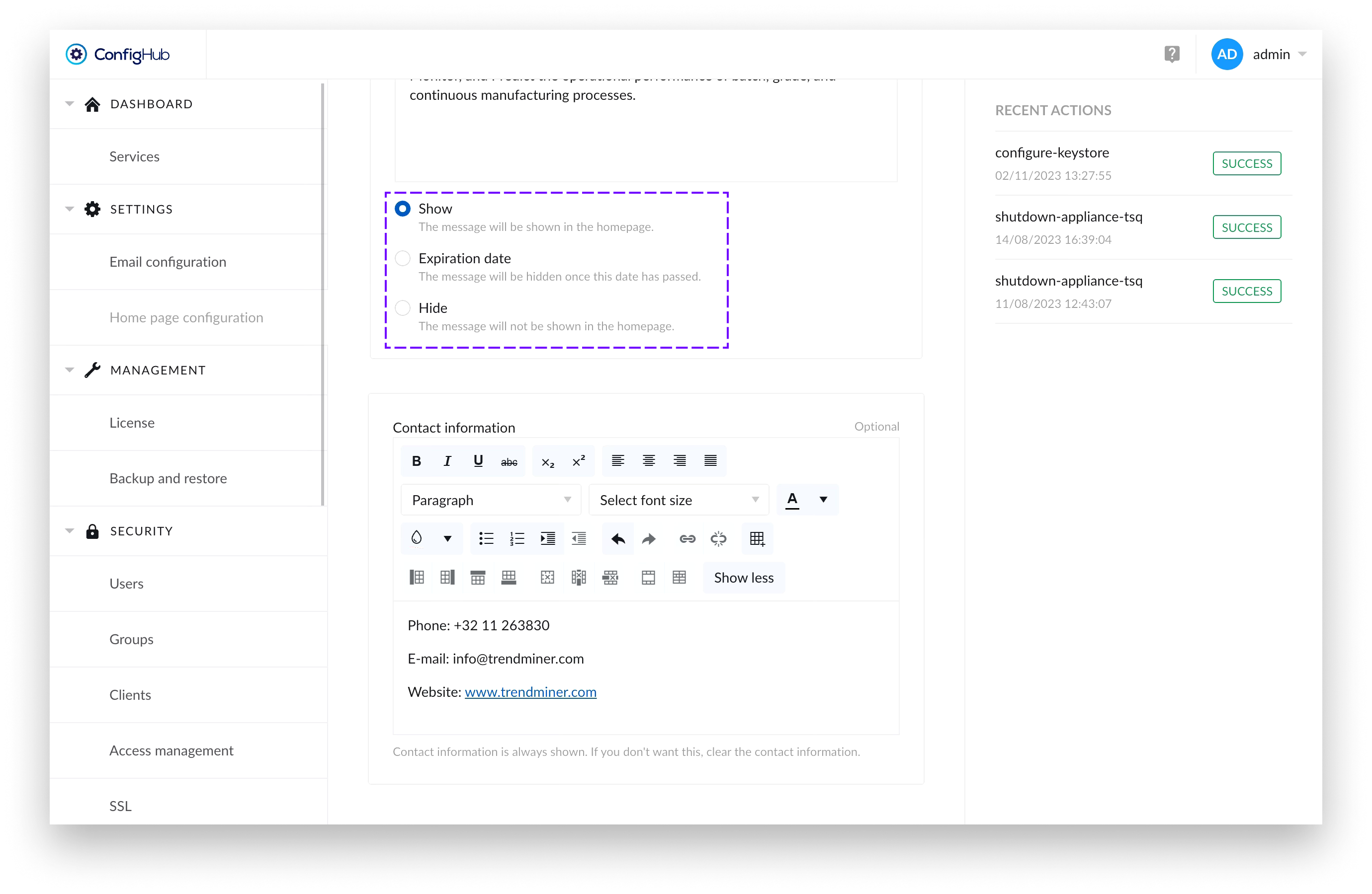

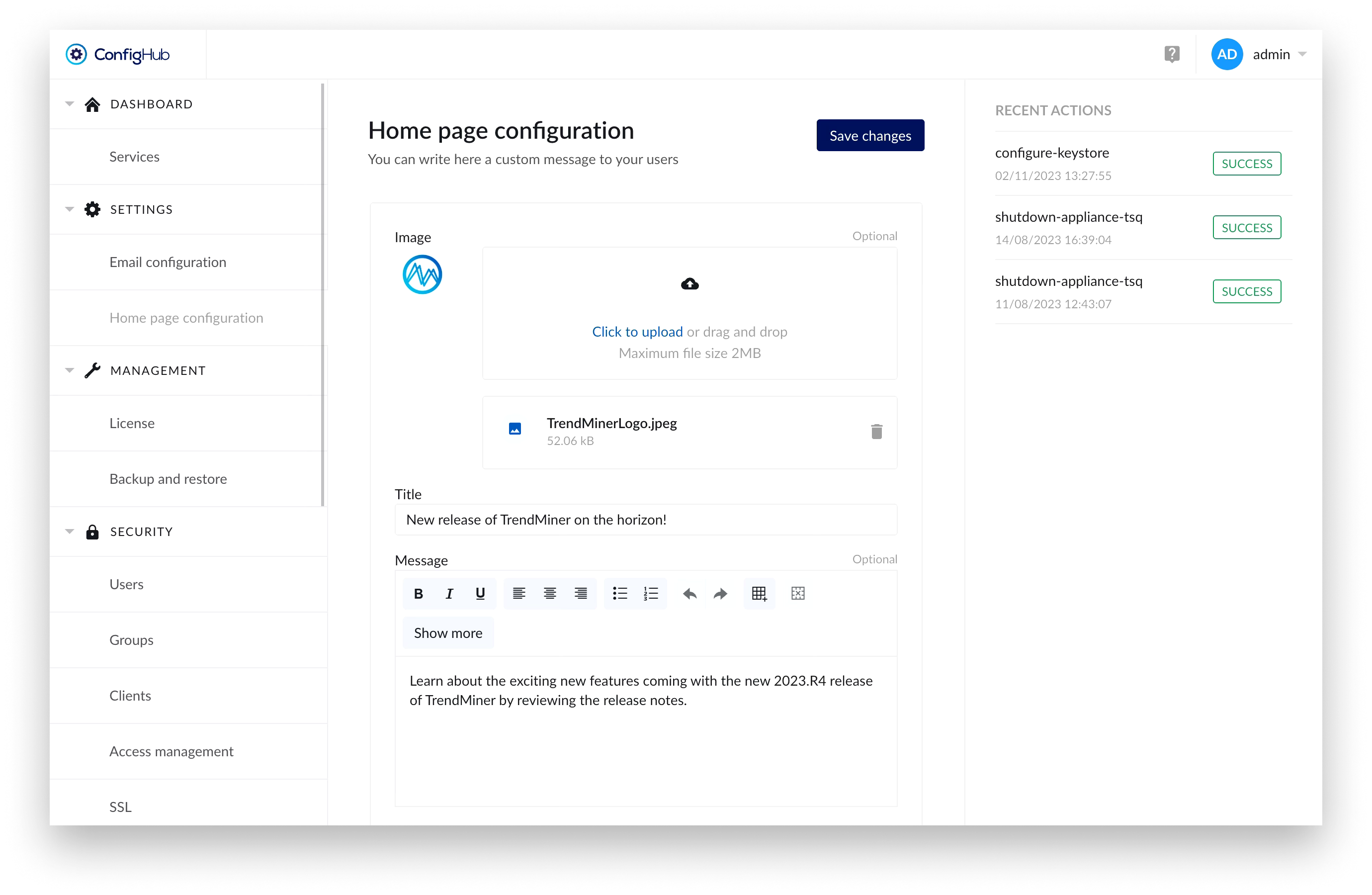

Admin Message Tile Configuration
Administrators can configure the admin message tile through the Homepage Configuration page in ConfigHub. The configuration itself consist of three parts for configuring the title, message and contact information.
There’s a radio button which allows administrators to control whether the message tile is displayed to users on the Home Page or not.
Additionally, there’s an option to set an expiration date for the message part of the tile. If an expiration date has been set, once the date has passed – the message part of the tile and the logo would disappear, but if filled in – the contact information would remain visible.
If only the contact information is filled, the message is set to “Hide” or there has been an expiry date set for the message that has passed - the information provided in the contact information form would still be visible to users.

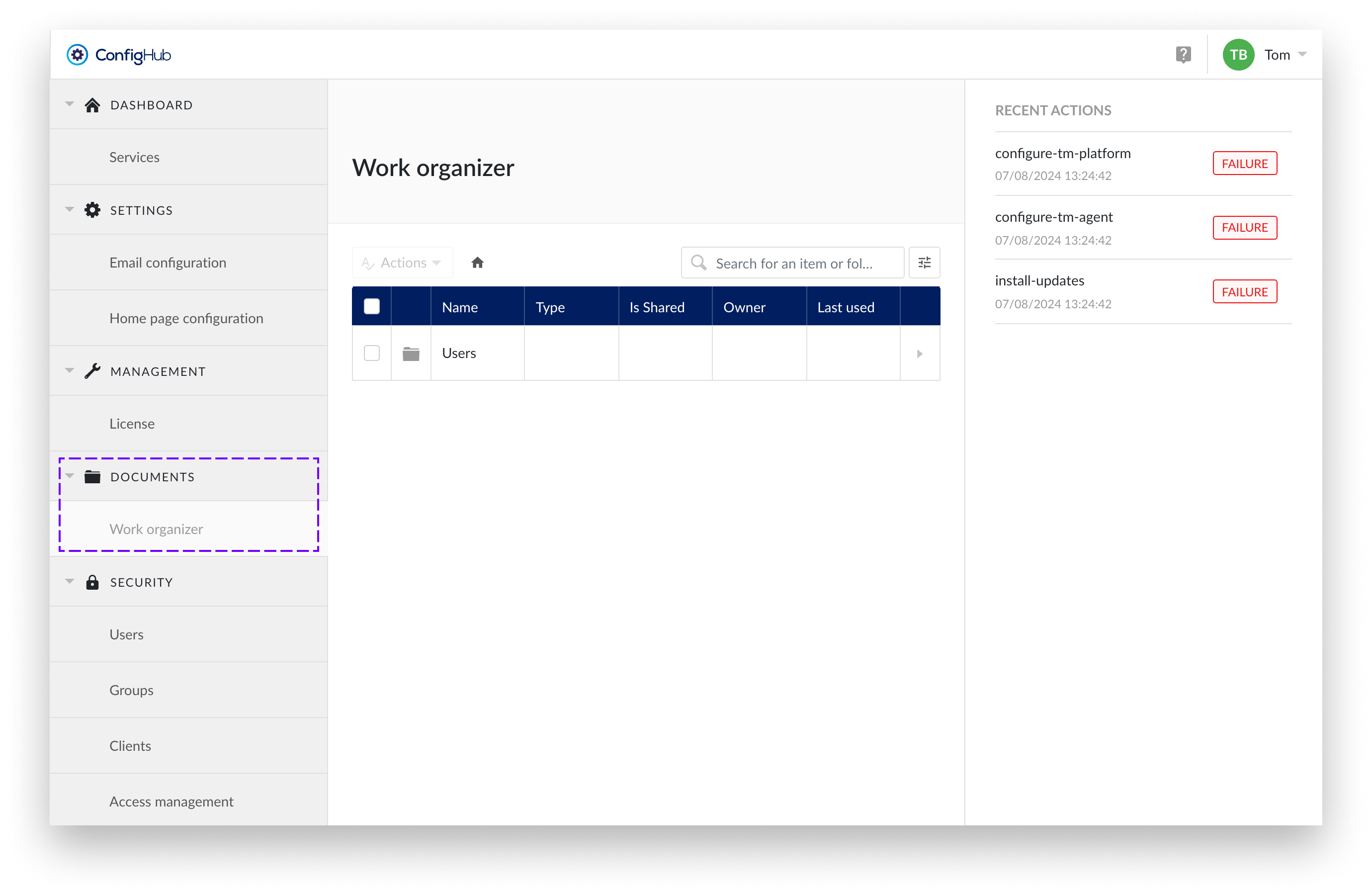

The section 'documents' in ConfigHub allows users with the system administrator role to manage work items of other users.
Work organizer
Work Organizer in ConfigHub gives you control over the entire Work Organizer structure. As a System Administrator, you essentially have access from the root, which is why it is also referred to as the Top Level Work Organizer (TLWO).
This access enables the management of users' home folders. It supports standard actions such as renaming, making copies, sharing items, moving items to a folder, deleting items, and creating subfolders within the same home folder.
You also have the option to transfer the entire contents of one home folder, along with all items shared with the home folder's owner, to another user's home folder.
Additionally, there is the option to delete home folders that are no longer active.

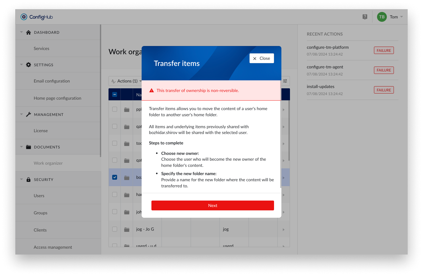

Transfer ownership
Caution
Transfer is not reversible!
Use this functionality carefully. The transfer applies to all items and shared items; it is not possible to transfer only a subfolder or a selection of a home folder.

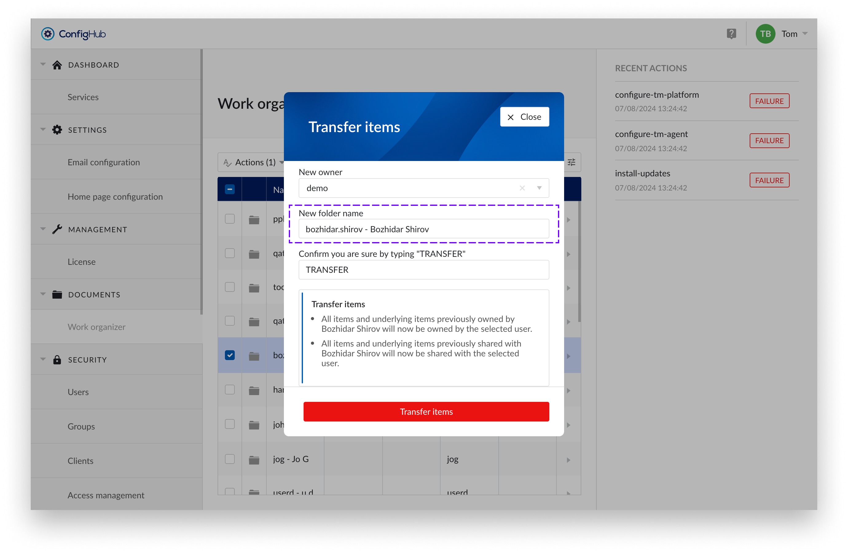

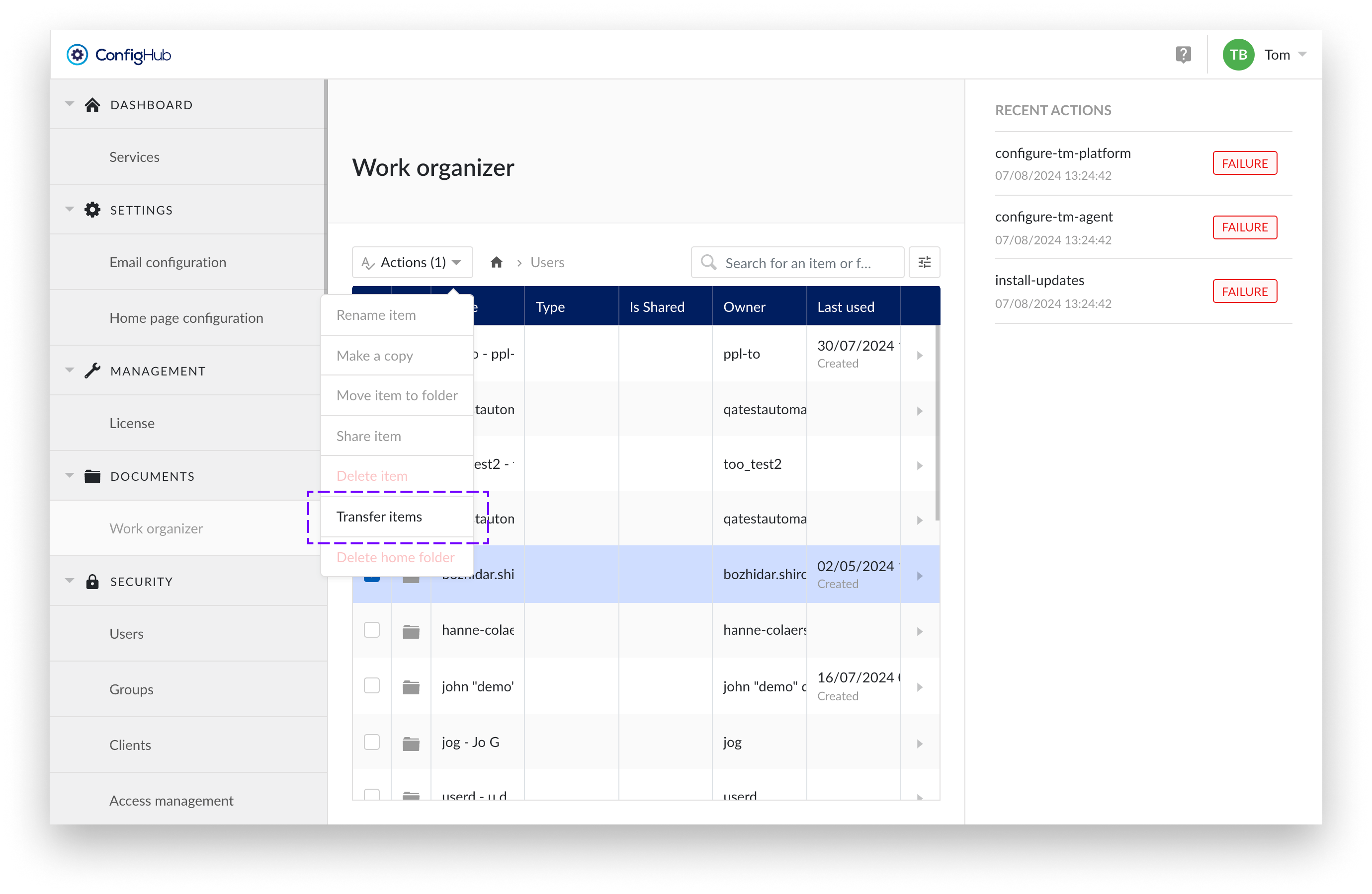

The "Transfer Items" option under the Top Level Work Organizer unlocks the potential to transfer items between users. This ensures that items from users who are no longer active or have moved on to another role are not lost but can be passed on to other users. This way, acquired insights can be preserved.
Transfer items allows you to move the entire contents of a user's home folder to another user's home folder. Additionally, all items and underlying items previously shared with the owner of the selected home folder will be shared with the new selected user.
All items and underlying items previously owned by the user of the selected home folder will now be owned by the selected user.
All items and underlying items previously shared with the user of the selected home folder will now be shared with the selected user.
To transfer items from one user to another follow the steps below:
  1. Select the home Folder
    Choose the home folder you want to transfer
  2. Choose "Transfer items" from the actions dropdown
    Select the option “Transfer items”.
  3. Notification pane
    You will get an overview of the actions that will be performed. Review these carefully. Transfer of ownership is non-reversible without transferring the entire content of a home folder plus all items shared with the owner of the home folder.
  4. New owner
    Select the user who will become the new owner.
  5. New folder Name
    Provide a clear and descriptive name for the folder. As a suggestion, we prefill the name with the username of the selected folder, but you are free to enter any other name you prefer. This folder will be created in the root of the home folder of the receiving user.
  6. Confirm you are sure by typing "TRANSFER"
    Double-check all input fields and the accompanying text. By typing "TRANSFER" in the input field, you agree to the actions that will follow.

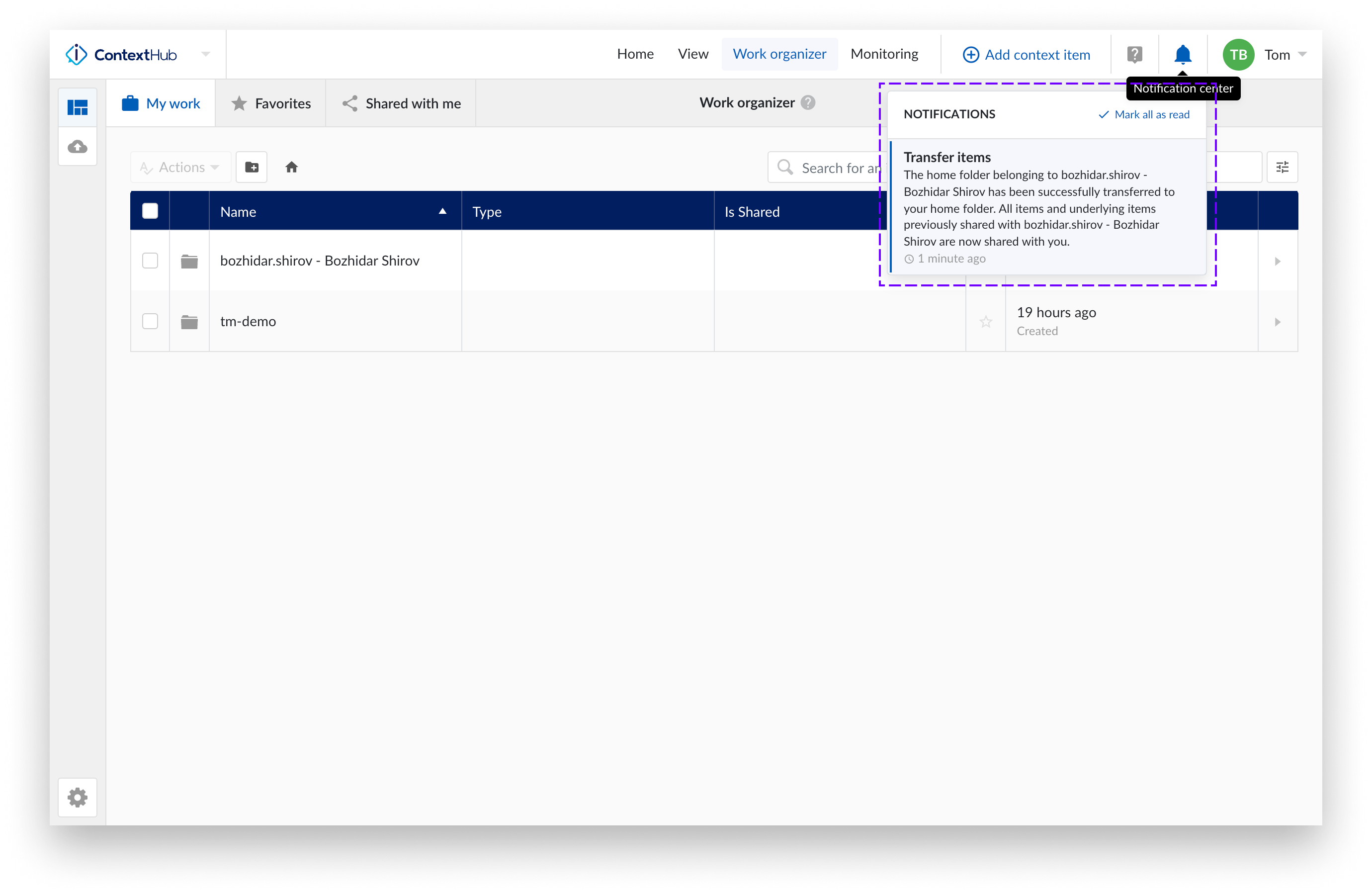

  7. Notifications
    After the transfer, the following notifications will be sent.
    Transfer successful
    • Confirmation in ConfigHub:
    • Confirmation original owner:
    • Confirmation transferee:

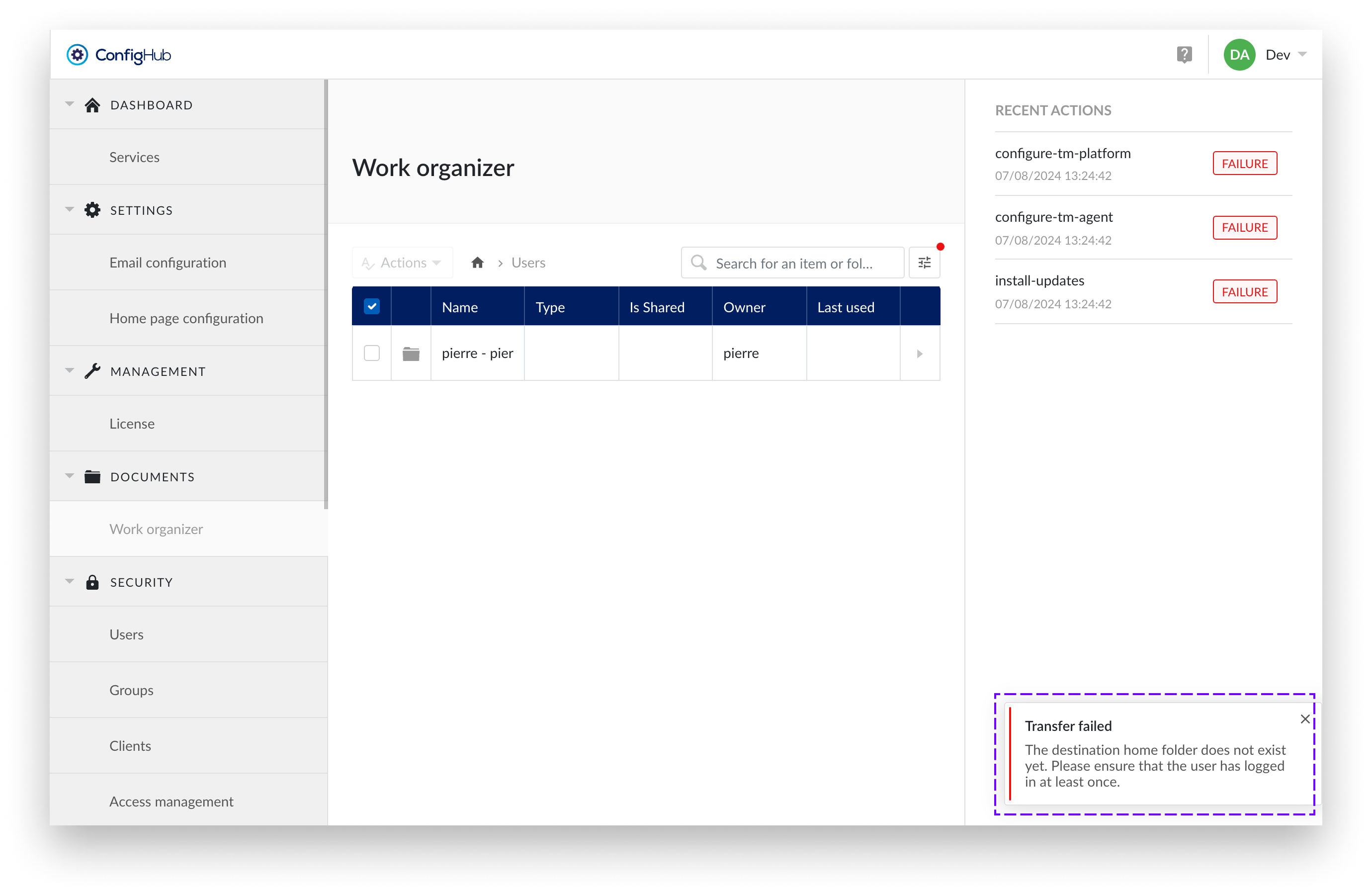

    Transfer failed
    If you attempt a transfer to a user who has not logged in before, it will fail because the home folder for this user has not yet been created.

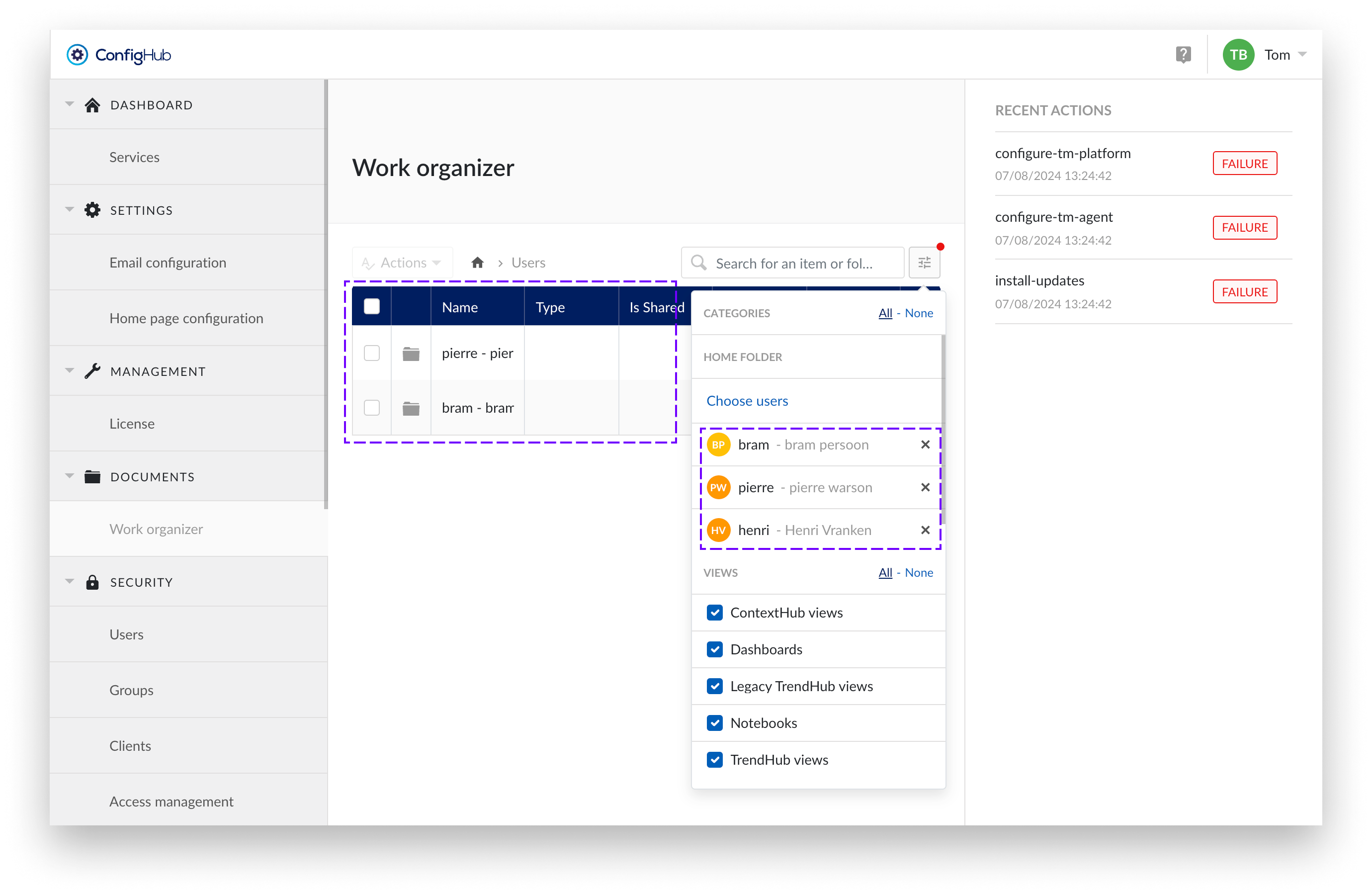

Home folder filter
A new filter has been added which is only available in the Top Level Work Organizer. This filter allows you to specifically search for a user's home folder.
The filter was added because the home folder list is not sortable or alphabetically arranged by the user's name. This is because TrendMiner separates personal data from the application and does not store it in the Work Organizer. To avoid scrolling through long lists of unsorted home folders, the home folder filter has been added.
The home folder filter is only applied at the level of Root > Users to avoid interfering with the behavior of the standard filters.
Steps:
  1. Open the filters and "Choose users"
    Access the filter options and select "Choose users" under HOME FOLDER.
  2. Search for Users
    Search for users. Both active and deleted users will be displayed. This helps you find the home folders of deleted users and transfer their contents to active users.
  3. Confirm
    Confirm your filter selection.
  4. Filter is applied
    Under the Users directory, only home folders that meet the filter criteria are displayed.

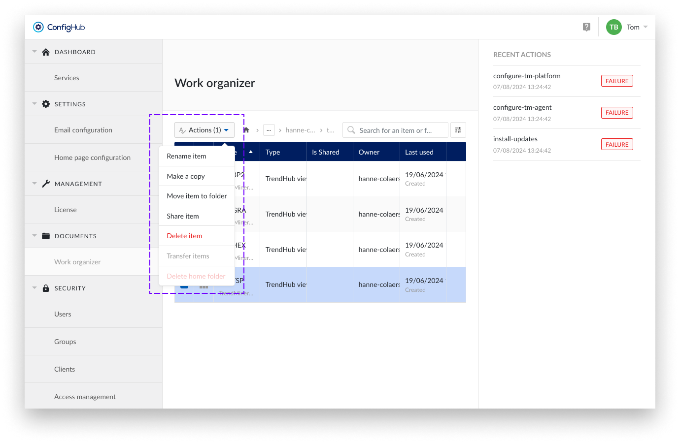

Manage home folders
As a TM System Administrator, you can manage the home folders of all users within the Top Level Work Organizer (TLWO). Follow the instructions below to perform various actions on items and folders.
Notice
Search is possible for items and folders and works like the standard Work Organizer. However, the search results do not include home folders. This is because, for privacy reasons, we do not store personal user data in the Work Organizer. To still easily navigate to the desired home folder, the home folder filter has been added.
Available Actions :
To perform any of these actions, check an item or folder and then select the desired action from the Actions dropdown menu.
  • Rename item: rename an item or folder.
    Only one resource (item or folder) can be selected at a time.
    Steps:
    • Check the item or folder you want to rename.
    • Select Rename from the Actions dropdown.
    • Enter the new name and confirm with “Rename item”.

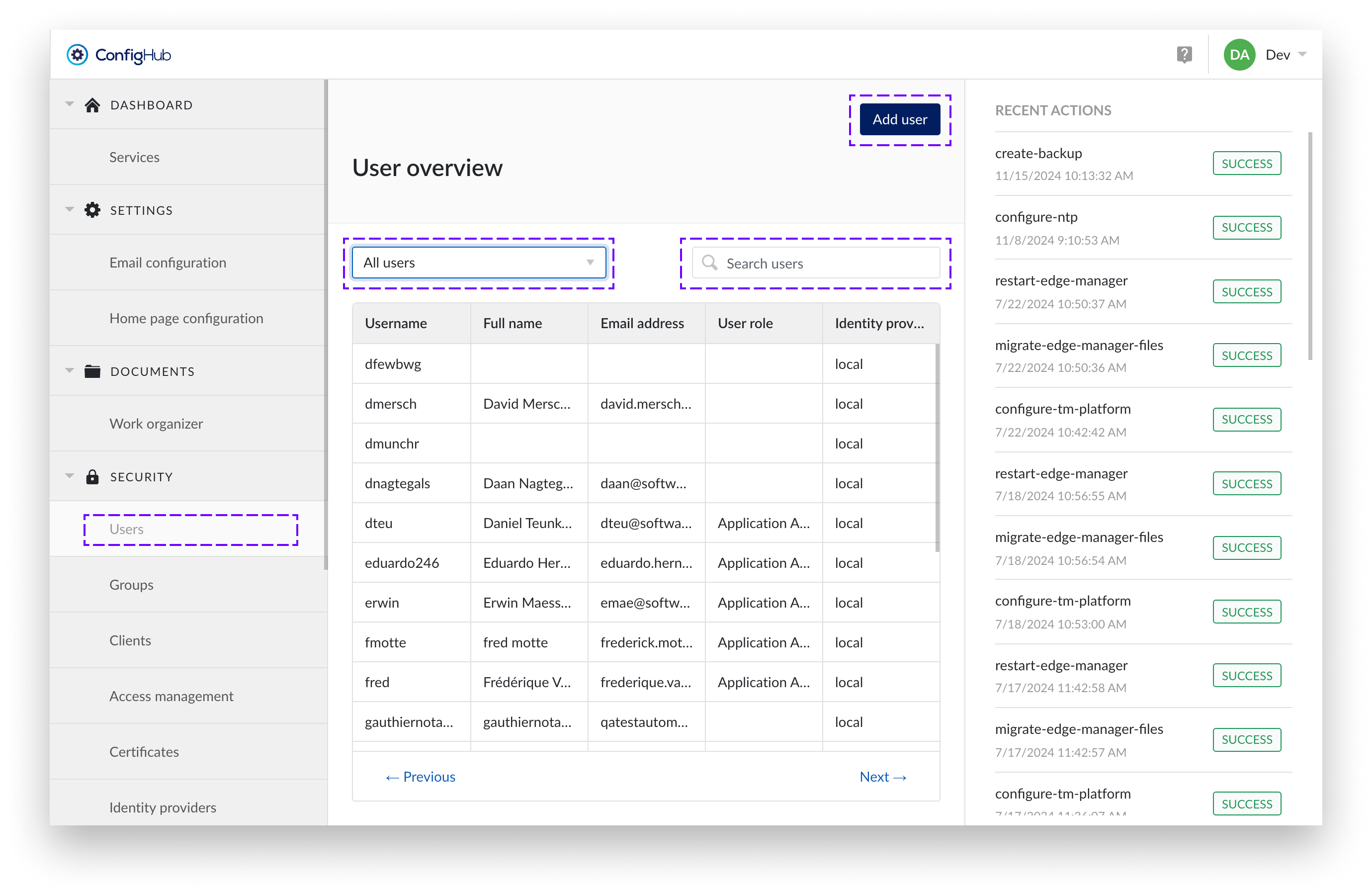

Users
TrendMiner users can either exist locally or via an external Identity Provider. An overview of all users can be found under the "Security" section in ConfigHub.
The user overview displays the username, full name, email address, and identity provider for each user. To find specific users, you can use the search bar. There is also a User Role dropdown filter for narrowing down the list based on roles. It is important to note that you cannot use the search bar and the dropdown filter at the same time.

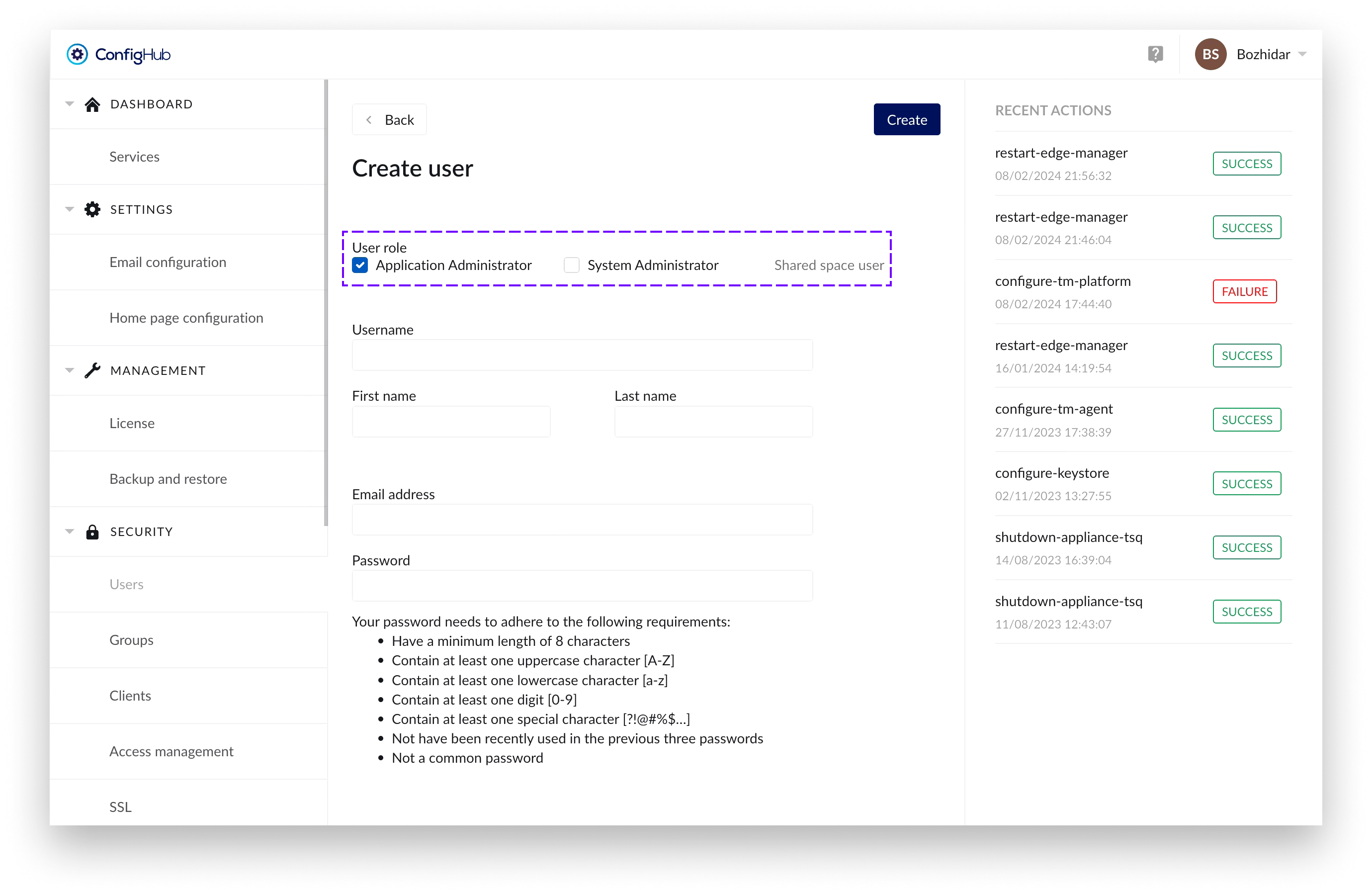

Creating users
You can review a list of user roles to each specific user using the “User role” column in the table.
Usernames need to be unique and cannot be changed afterwards.
User details
From the user overview a user can be clicked to open the user details. In the user details view more options can be performed such as:
  • Change password (local users only)
  • Delete the user account (local users only).

User roles
3 roles are available:
  • Application Administrator: can perform application administrator tasks such as deleting tag indexes or configure asset permissions in ContextHub.
  • System Administrator: has all permissions an application admin has + can access ConfigHub

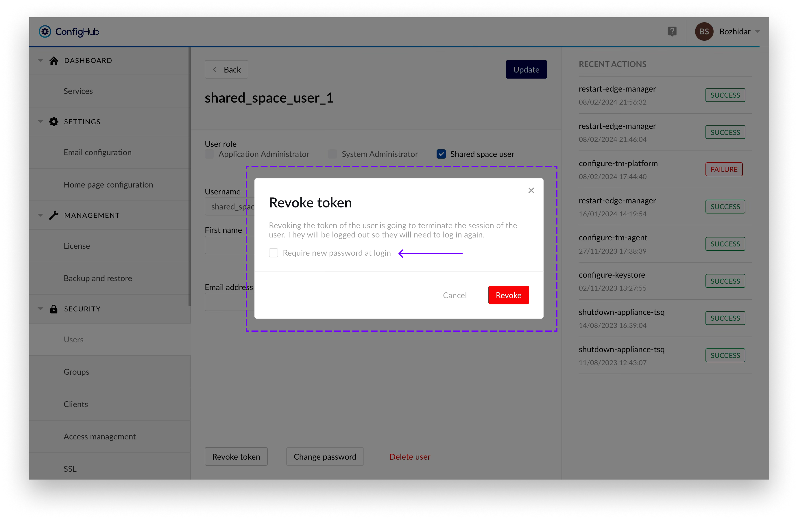

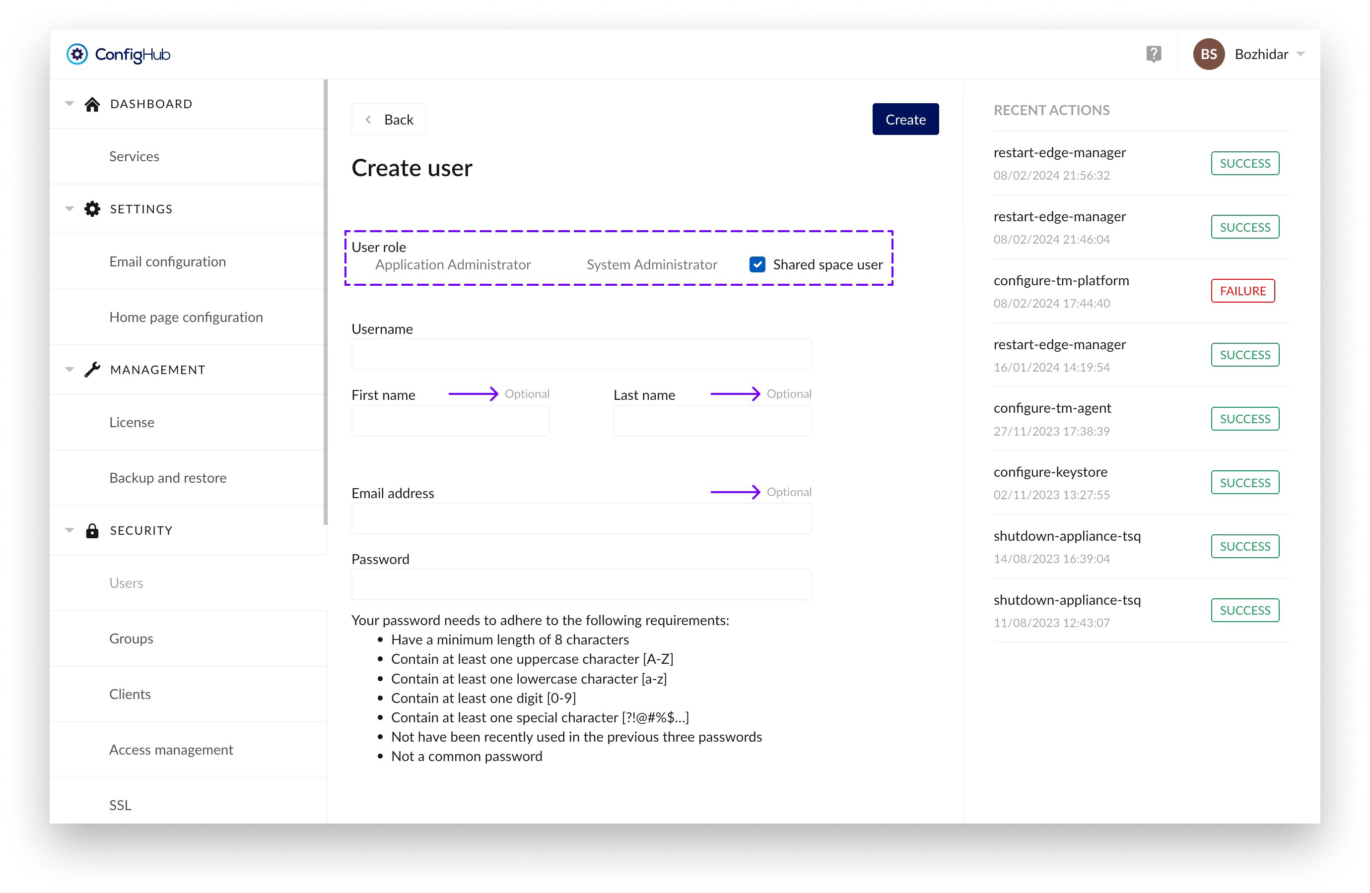

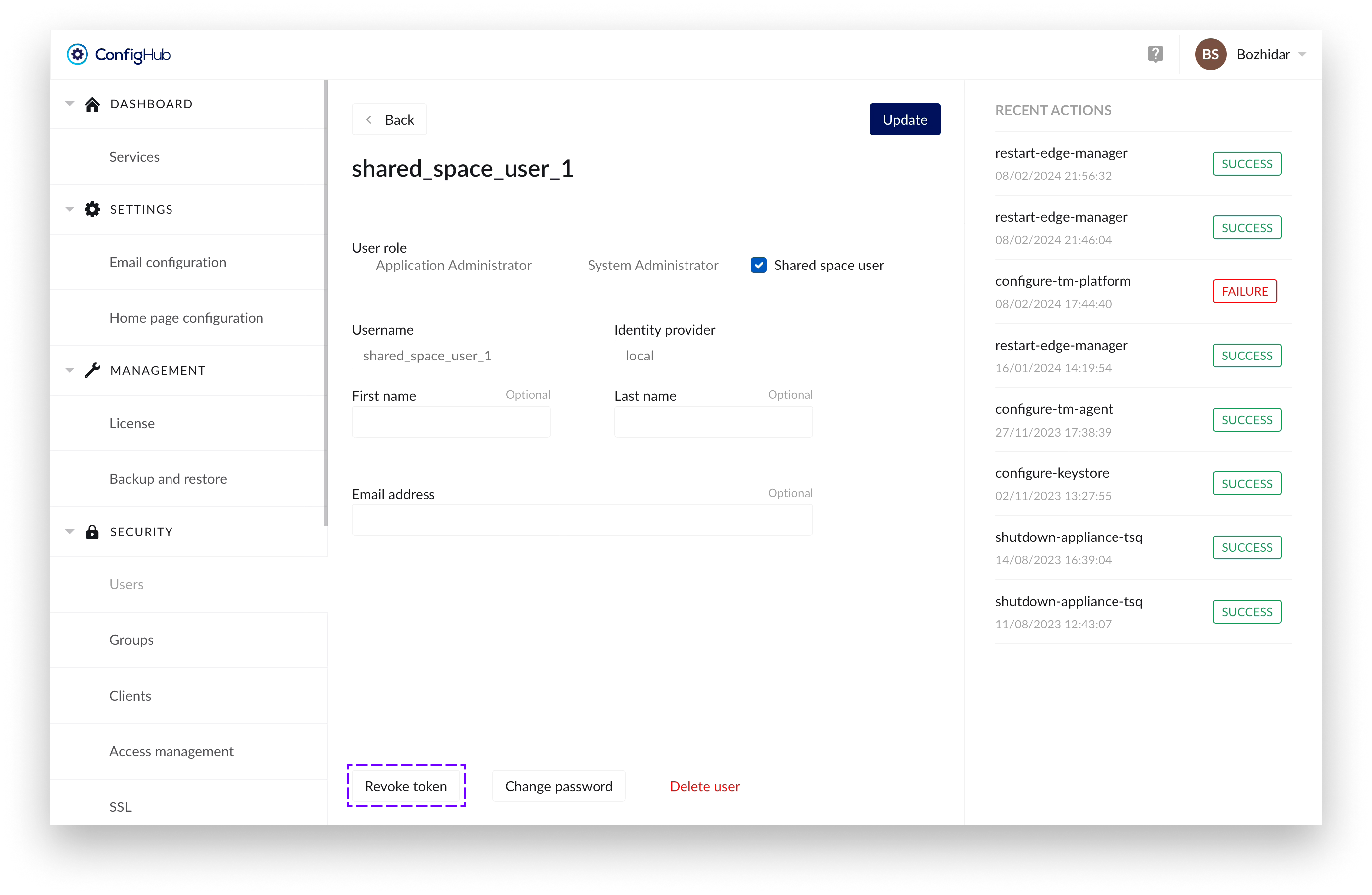

  • Shared space user:
    • User with an extended login timeout of 1 year to ensure their usability in shared spaces for displaying dashboards and other content for prolonged periods of time.
    • Users with this role have the following fields as optional: “First name”, “Last name” and “Email address”.
    • For security reasons - assigning “Shared space user” role to a specific user would prevent you of assigning any administration role in combination with it.
    • A forceful logout of such users can be initiated by clicking on the “Revoke token” in the “User edit” screen (to which you can navigate by clicking on an already created user in the table):
      Once that's done a confirmation dialogue would appear, from where you can also select for the user to have to update his password on next login:
      The user can remain logged in for a maximum of 5 minutes after the process has been initiated, after which he will be forcefully logged out.

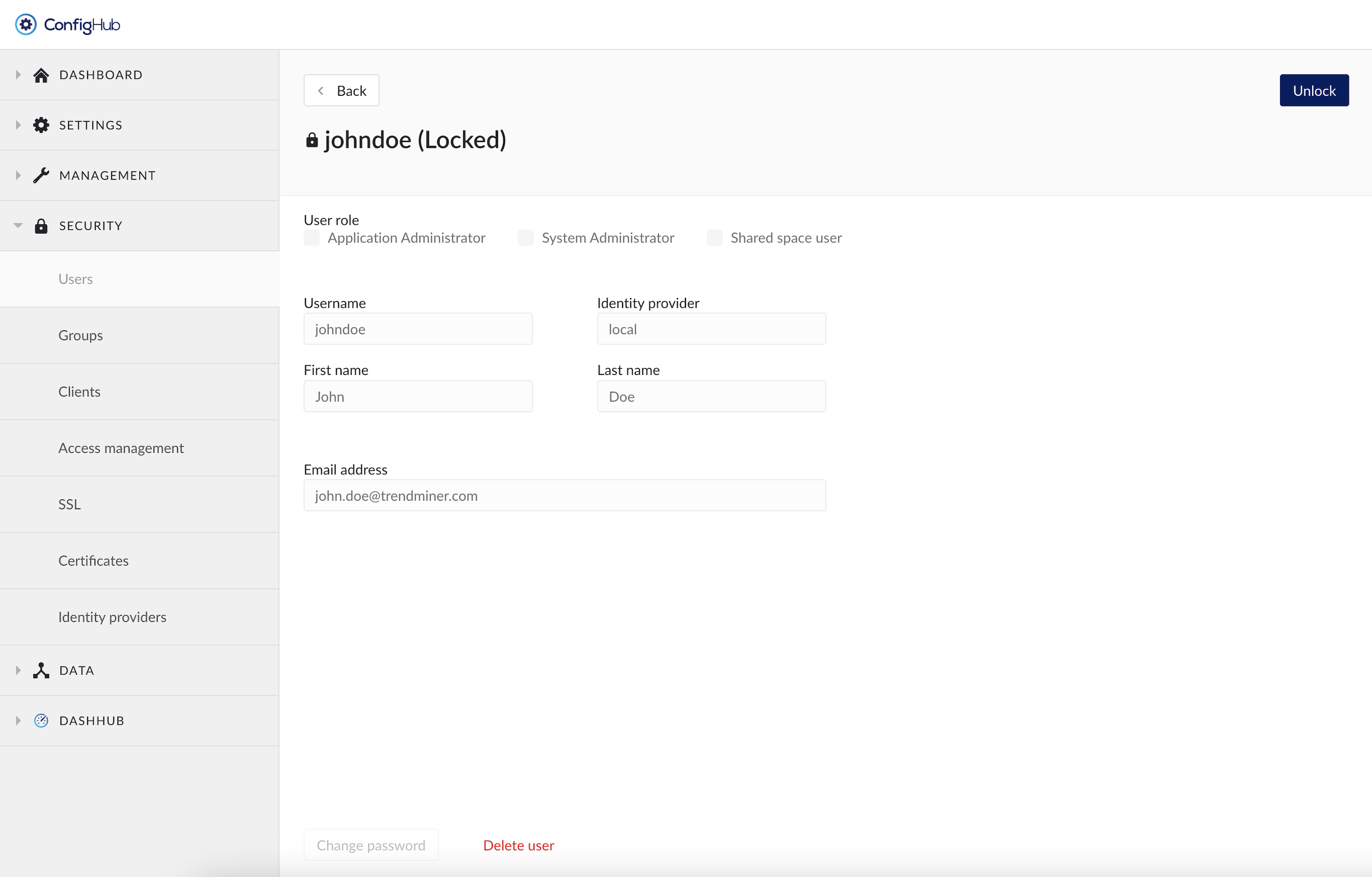

Unlock user account
A user account is automatically temporarily locked after 3 login attempts using the wrong password (both for local accounts as for LDAP accounts). The user itself will not be able to see the difference between entering a wrong password or the access being denied because of a locked account. In both cases a generic error message is shown on the login page: "Invalid username, password or locked account". This is by design for security reasons.
Only users with the system administrator role can access ConfigHub and look up the user account to check if the account is indeed locked. A locked account can be recognized as follows:
  • A little lock icon in front and the word "Locked" behind the username
  • An "Unlock" button in the top right
  • No option to edit the user details or change the password as long as the account is locked
confighub users user details locked 2024.R1.0
To unlock a user account:
  • Click the "Unlock" button on the top right in the user detail screen in ConfigHub.
  • All locked accounts get automatically unlocked when the tm-keycloak security service gets restarted.
  • Accounts get automatically unlocked after 1 hour. This lock time increases exponentially with the number of failed login attempts (the more failed logins, the longer the accounts remains locked).

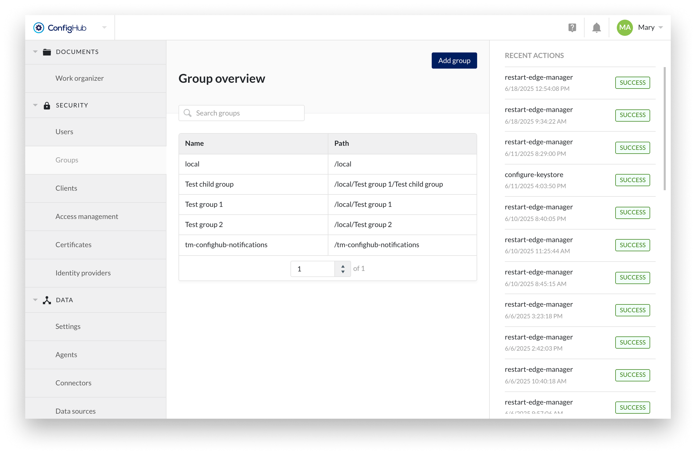

From the group overview a group can be clicked to see more details in the side-panel. Here more options can be performed such as:
  • Edit the name of a group
  • Delete the group
These actions can only be done for local groups. Groups synced from an external IdP are non-editable and should be managed from the IdP itself.
Warning
Deleting a group will also delete all subgroups. A modal will be shown when this is the case. In case you want to keep the subgroups you will need to remove them first from the member list.

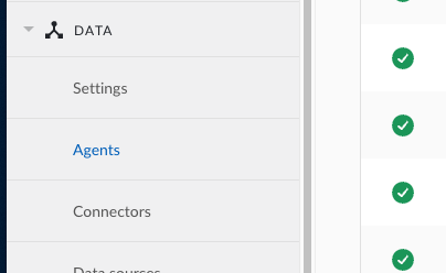

Agents
Notice
The "Agents" menu item in ConfigHub is only available to AWS SaaS customers (<mycompany>.trendminer.io domains)

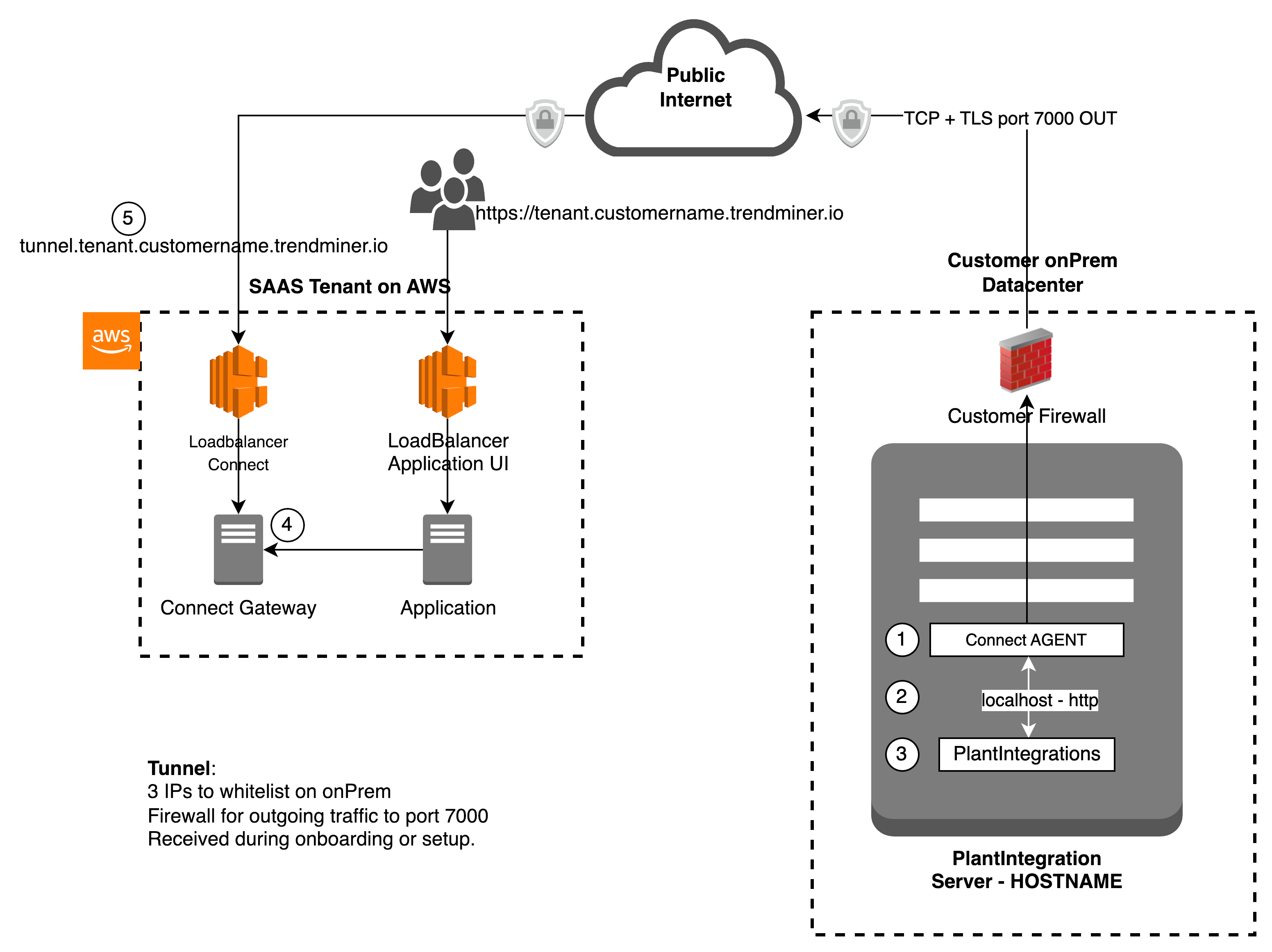

This tutorial will explain how to setup the TrendMiner Connect Agent.
This agent is used for the communication between TrendMiner SAAS solution and the on-prem PlantIntegration server in a secure way, without the need to open incoming ports on the public facing Firewall at your datacenters.
As plant integration server is only running on windows, the tutorial will explain how to make it work on windows only.
Table of Contents
Prerequisites
  • Have a look at the simplified view below on the network communication flows
  • You use a supported windows version. See below on supported OS versions
  • You need to have administrator access to the windows machine that is running the plant integration server (or on the plant integration server itself)
  • You need to be able to upload files to the server or ability to download files from a public file server. (e.g. using RDP copy past, or others)
  • Make sure your anti-virus software does not block/delete the programs included in the installer Agent zip file (tm-connect.exe, tm-connect-wrapper.exe, frpc.exe, ...).
    More info on why anti-virus software might flag and quarantine the TM Connect Agent can be found here: TM Connect Agent is flagged and quarantined by antivirus
  • TCP ports 7000 and 443 need to be open for outgoing connections to the internet.
    Since the TrendMiner Agent needs to be able to connect to the appliance's dynamic IPs it is not possible to limit the list of allowed IP addresses and all outgoing connections on port 7000 and 443 need to be allowed.

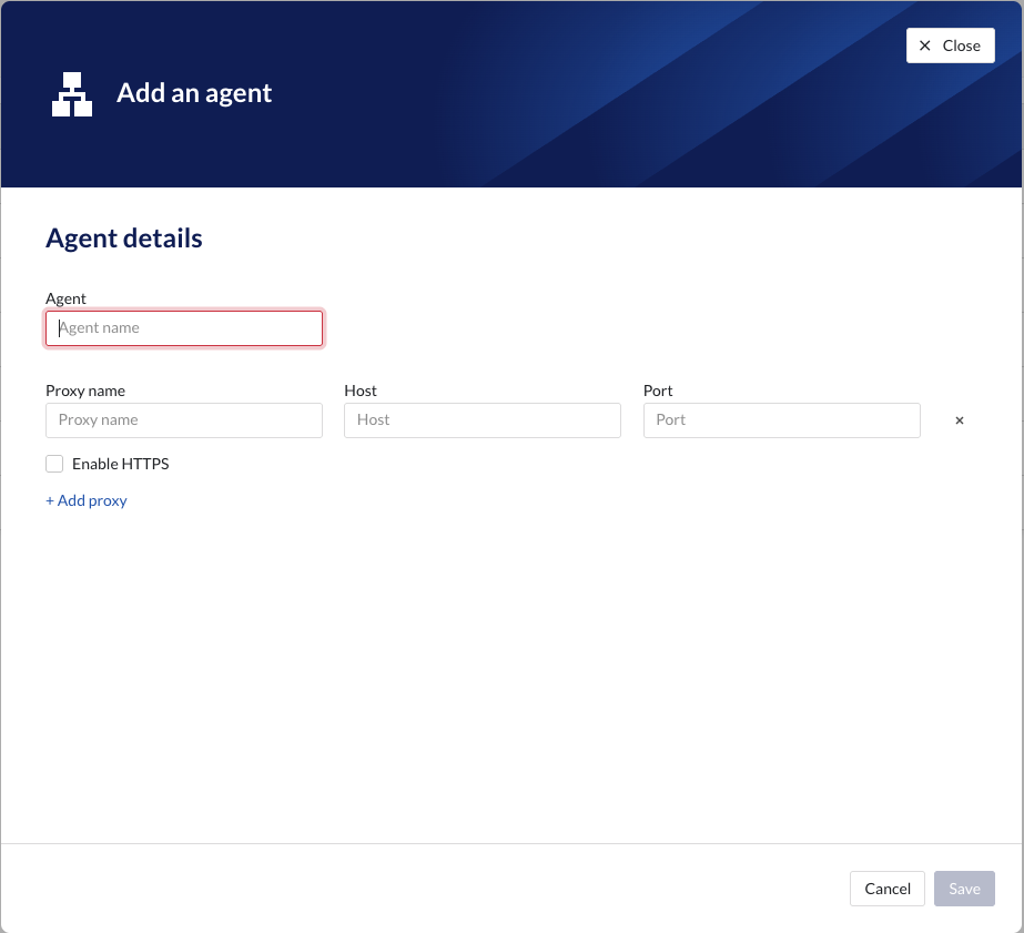

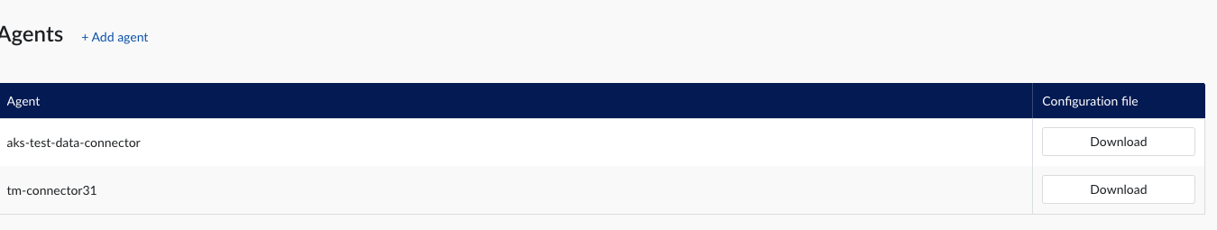

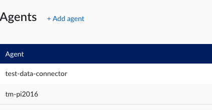

  • Click on “+ Add agent”
In this screen you need to specify the parameters required to access the plant-integration server(s) or other external datasources
This is a overview of the parameters and their values/limits:
  • Agent: it's the name of the agent. The name should be a valid DNS name. This is used when setting up the connector itself.
  • Proxy Name: This is the name that will be used when creating the connector. If the agent is running on the same server then the plant integration server, it's advised to use the same name. If not, you could specify the hostname of the server running the plant-integration.
  • Host: please specify IP or hostname of the server hosting PlantIntegration or the external datasource.
  • Port: please specify the port where the plant integration or other external datasource will be reachable on.
  • Enable HTTPS: in case you want to have the connection towards the server done over HTTPS please check this option

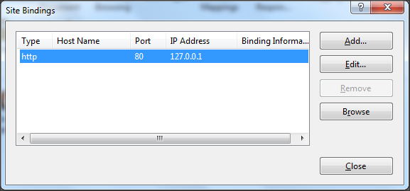

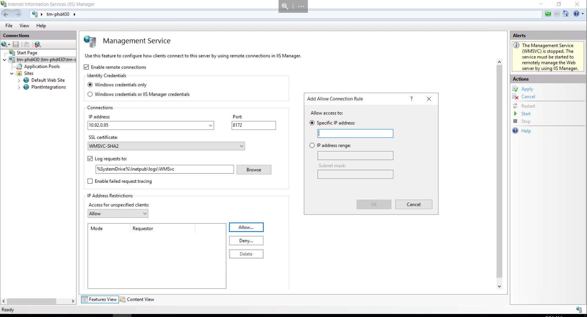

Setup your IIS server
  • Authentication on Plant Integration sites in IIS should be disabled (the connect tunnel already uses mTLS for authenticating requests)
  • Plant integrations sites in IIS can be configured to use HTTP or HTTPS (connect agent will also encrypt all traffic going out using TLS)
  • Configure IIS to only accept traffic from 127.0.0.1, so only processes running on the same server can connect. This can be configured as follows:
    • Open IIS Manager.
    • In the Connections pane, expand your server and select the target website.
    • In the Actions pane, click Bindings.
    • Edit the existing binding (or add a new one) and set the IP address to 127.0.0.1 instead of “All Unassigned”.
    • Click OK to save.
    As an alternative, configure the connector server to only allow connections from specific IPs:
  • if needed use hostnames to run multiple plant integration servers. they all should listen only on 127.0.0.1

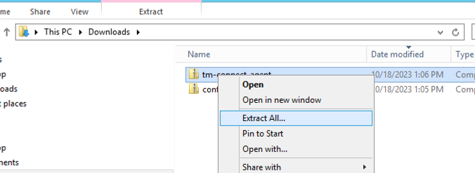

  • Login to the Windows host in question

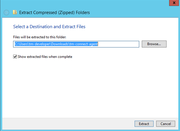

  • Download the config.zip and tm-connect-agent.zip and place it in easy to access folder, e.g. downloads
  • Extract tm-connect-agent.zip by right clicking on the zip file and clicking on “Extract All”
  • Click on Extract

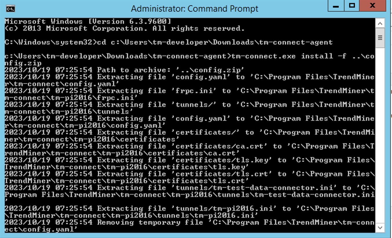

  • Open a command prompt as administrator
  • Change your directory to the directory where you have unzipped the files from tm-config-agent.zip
  • Run the following command to install the agent, with the received config.zip file
    tm-connect.exe install -f ..\config.zip
Ones everything is successfully installed, you will see the service running when you check running services (services.msc).

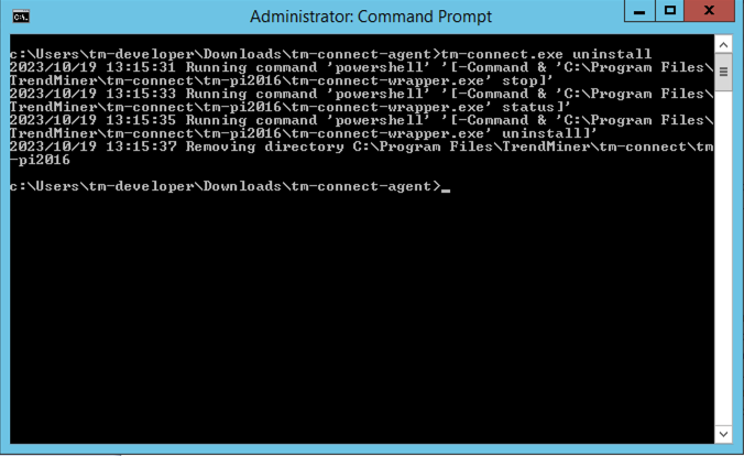

Uninstalling an Agent
Same procedure as a above except use the following command to uninstall the agent:
tm-connect uninstall

Simplified view of TM Connect communication flow (connection setup)
(1) Connect Agent service running on Windows server, and can be accessed by (3) plant integration service over a local port (2)
(1) Connect Agent initiates the connection to (4) Connect gateway to setup a bidirectional secure encrypted tunnel using (5) the url tunnel.tenant.customername.trendminer.io on port 7000
Security Advice
To have a better security for your plant integration server, its advised to close all incoming ports on the PlantIntegrations local Windows firewall.

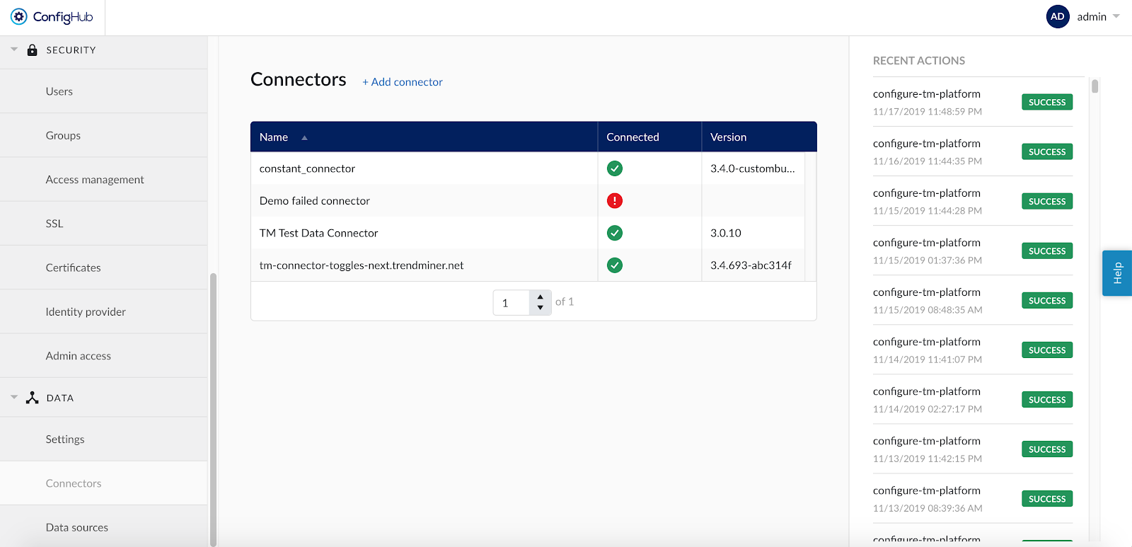

Add a new connector by clicking the (+ Add connector) label next to the title and fill connector details in the corresponding fields:
  • Name: free to choose name. The only restriction is that each connector name should be unique.
  • Host: hostname of the connector.
  • Username and Password: should only be filled in when they are configured on the connector installation.

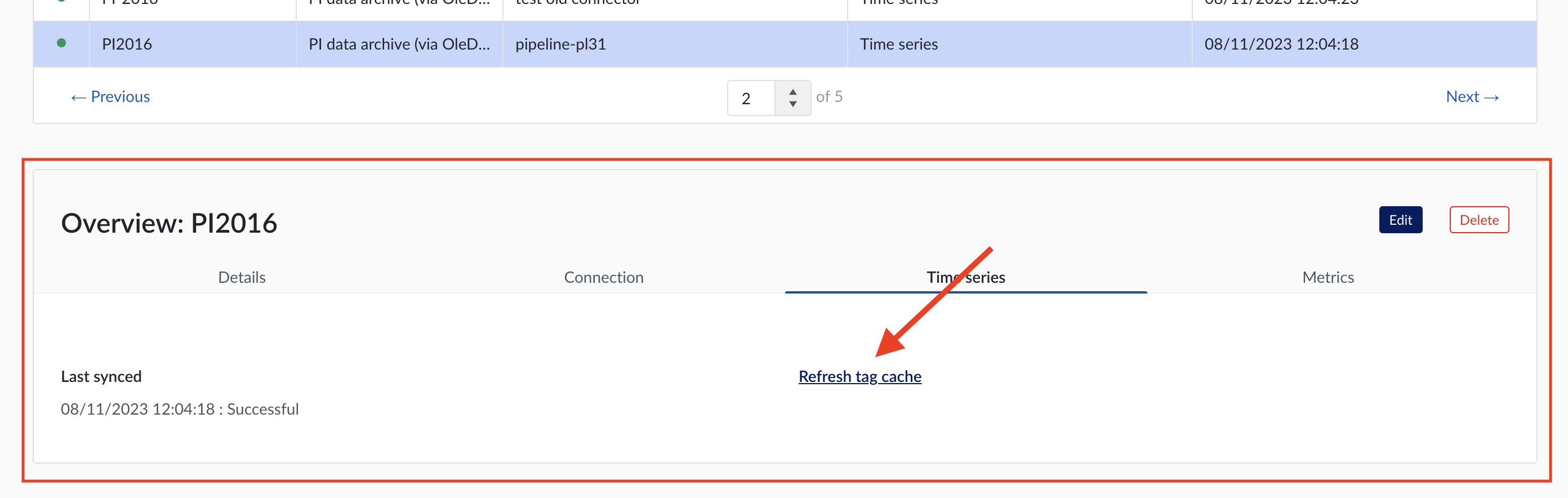

As soon as a new connector is successfully added, it will start syncing all the data sources which are configured to the connector.
If the connector cannot be synced, it will show a red exclamation mark in the connector list. To learn more about the cause of the failure, open the connector details  side panel by clicking on the connector name. The error feedback will be shown under 'Last sync'.
For successfully connected connectors the 'Last sync' field in the connector details will show the last sync date and time and status ''Successful". The last sync date and time will be updated when a manual sync is triggered or when TrendMiner synchronises the tag cache for that connector, typically during a nightly tag cache refresh.
A green checkmark in the connector list indicates that TrendMiner is connected successfully to the connector, but it does not indicate if there are syncing issues between the connector and the data source. The health status for connected data sources should be consulted in the 'Data sources' menu. Also note that the status will not automatically update after the page is loaded. Refresh the page or choose the 'Test connection' option to update the connection status of a connector.
The version of each connector is listed in the Connectors overview table. This information is important in case a newer connector version supports new features or improvements for a specific data source.
To edit the details of a connector click on its name to open the details side panel and then click on 'Options' and select 'Edit' in the dropdown menu.

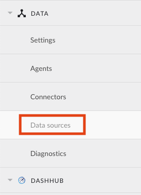

Data sources

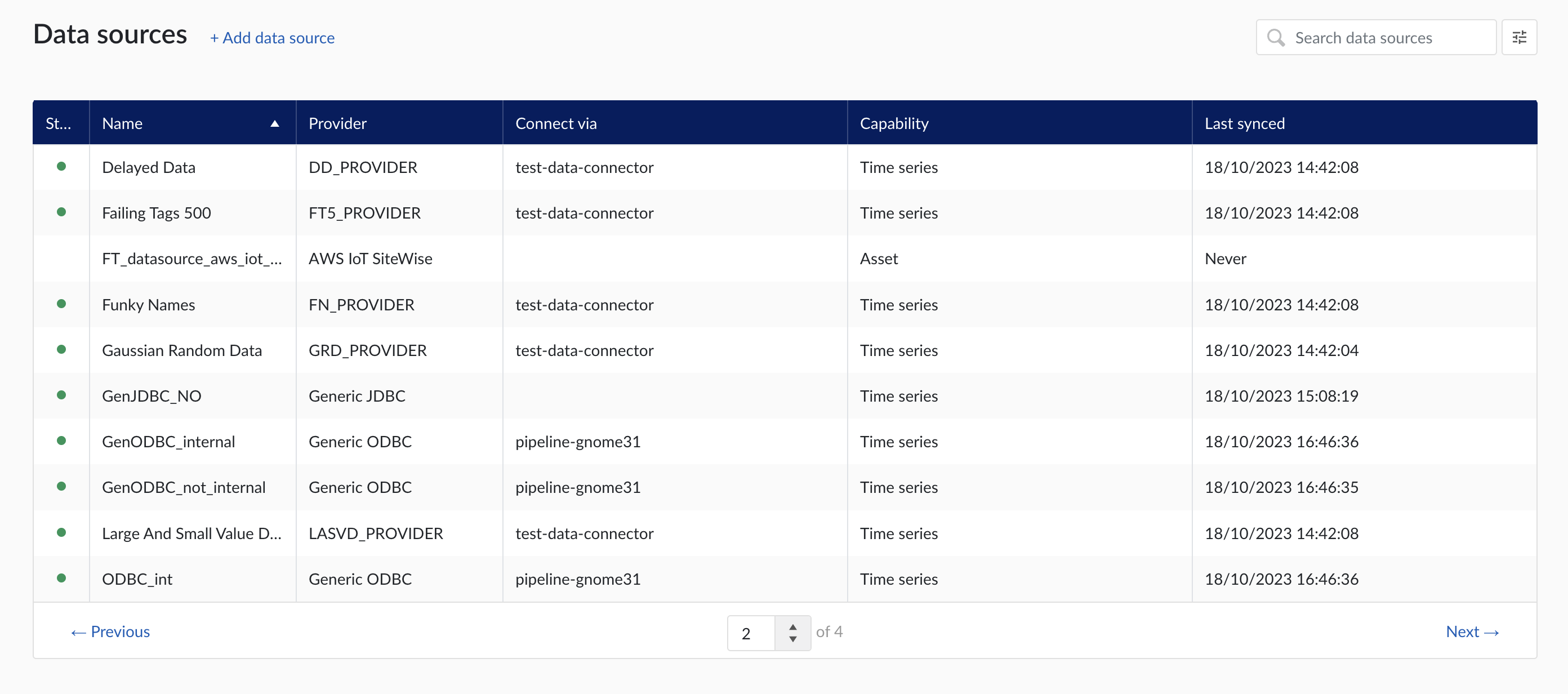

When clicking on the Data sources menu option, the data sources overview is shown :
Data sources overview

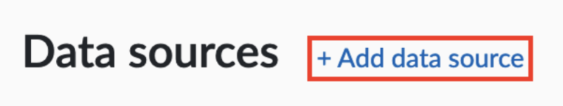

Add a new data source by clicking the (+ Add data source) label next to the title. An "Add a data source" modal will appear.

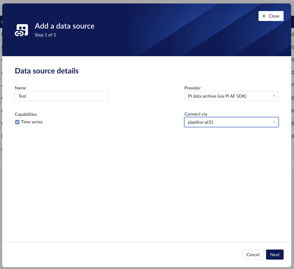

Populate the fields on the Data source details step:

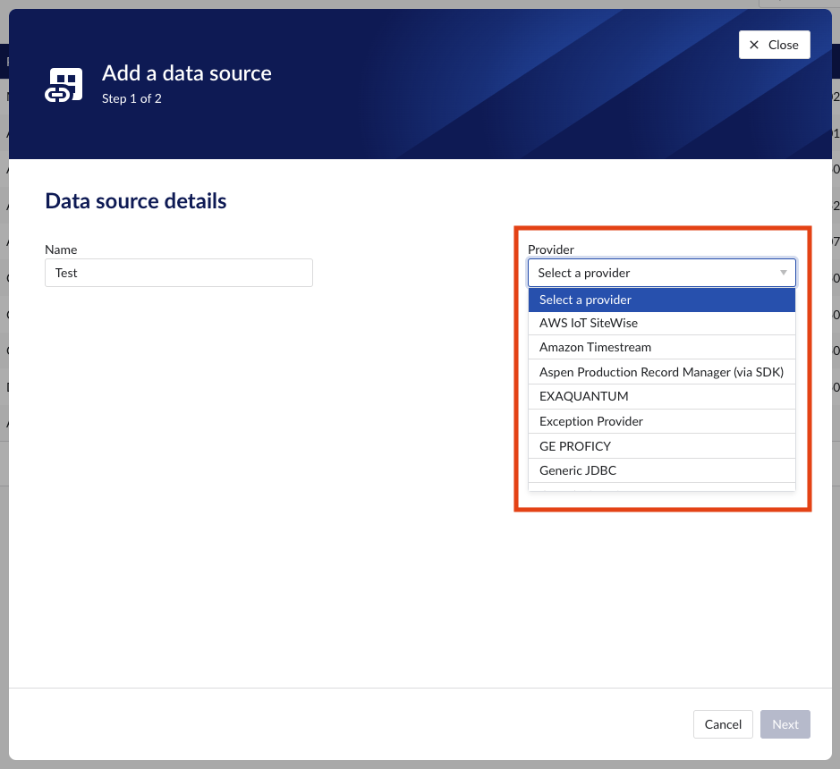

  • Name: you are free to choose data source names but they are mandatory, case insensitive and unique. The name of a data source identifies the data source. We strongly advise to only use alphanumerical and '-' or '_' in data source names as other characters are not supported in the access management so using special characters in a data source name might give issues when you want to assign access permission to the data source later on.
  • Provider: TrendMiner provides some out of the box connectivity to data sources via specific vendor implementations (e.g. OSIsoft PI, Honeywell PHD,...) and via more generic alternatives (e.g. Generic JDBC, ODBC, OleDB, ...). The provider 'TM connector' enables the  connection of data sources via a connector to connector setup. To connect a data source via multiple connectors, extra configuration is needed via the TrendMiner Connector API.
  • Connect via: this dropdown is used to select a connector which is used to connect to the data source. The dropdown is displayed based on the selected provider: some data sources need to be connected via a connector (e.g. OSIsoft PI, Generic ODBC, Wonderware, ...), while others don't need any connector (e.g. Amazon Timestream, Generic JDBC, AWS IoT SiteWise, ...). To add a data source that needs a connector,  the connector needs to be added first.
  • Capabilities: Capabilities depend on provider implementation. Some datasources have only one capability (e.g.  Amazon Timestream has Time series capability only), others have all 3 capabilities (e.g. AWS IoT SiteWise). Selecting the capabilities for the data source with the given checkboxes will open additional properties to enter, grouped in following sections:
    • Connection details - lists properties related to the configuration of the connection that will be established with datasource

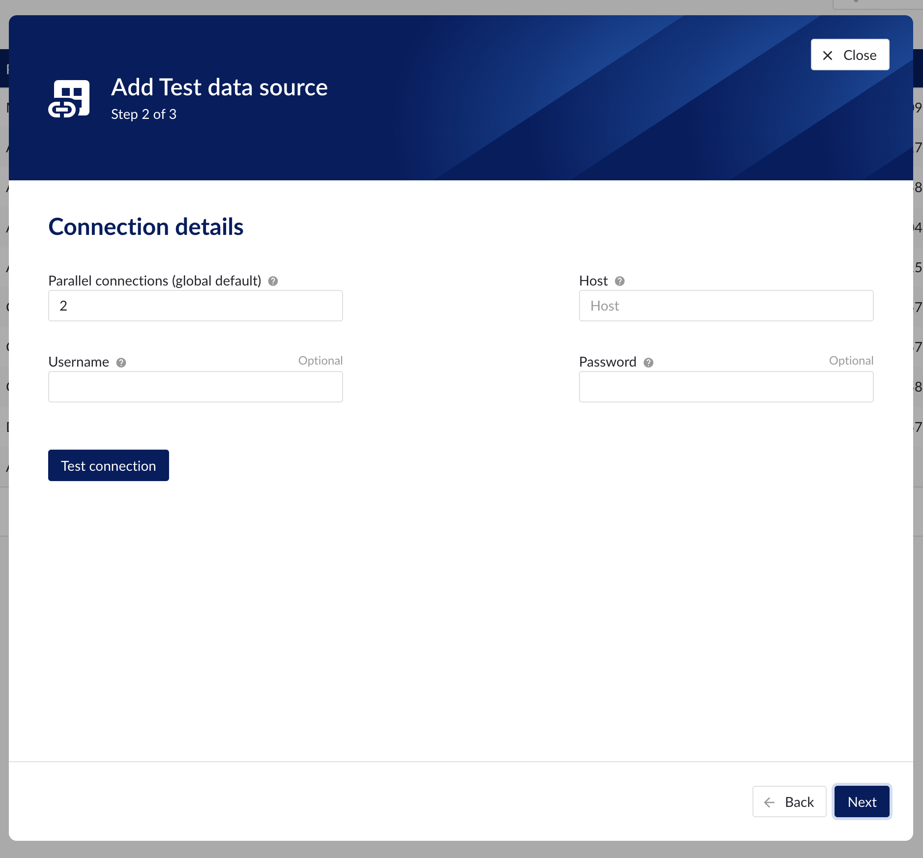

Populate the fields on the Connection details step:
  • Parallel connections (if any): Each data source has 2 queues: one interactive - plot calls, one non-interactive - index calls, batch calls etc. Parallel connections determine how many connections each queue has to the connector. By default there are 2 parallel connections to the connector.
  • Host: the host name of the data source, e.g. myhistorian.mycompany.com
  • Username: username of the account configured in the data source.
  • Password: password of the account configured in the data source.
Once all mandatory fields are filled in, 'Test connection' button becomes enabled. By clicking on the button, user can verify the connection to the datasource.

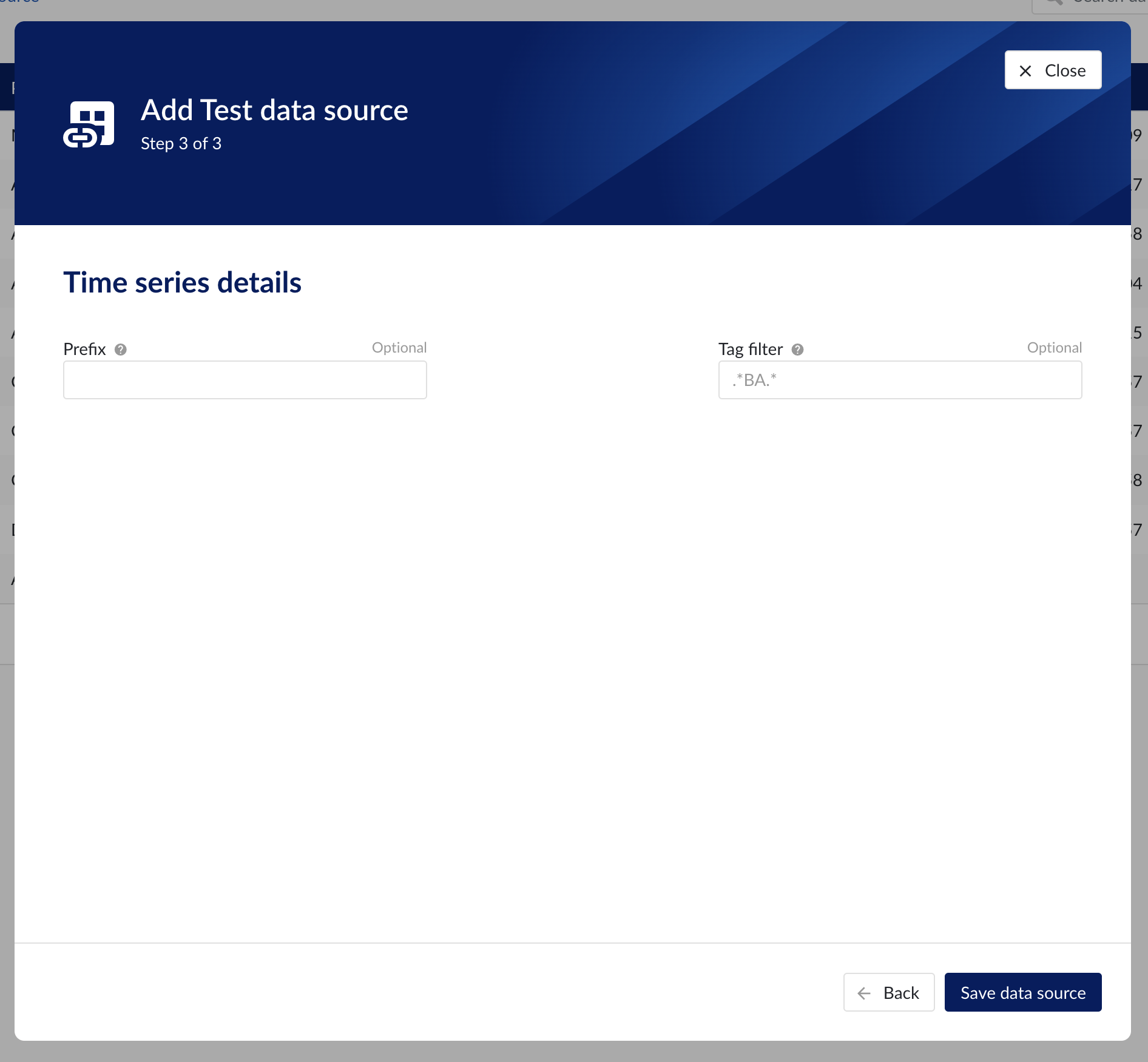

Time series details
Populate the fields on the Time series details step:
  • Prefix: you are free to choose prefixes. They are case insensitive but unique strings and have a maximum length of 5 characters. When synchronising a data source, all tag names of that data source will be prepended with the prefix to ensure tag name uniqueness in TrendMiner. Prefixes are optional but we highly recommend the provision of a prefix when connecting a data source to avoid duplicate tag names.
  • Tag filter: regular expression to be entered. Only tags with names that match this regular expression will be retained when creating tags (using the tag list query).
    Examples:
    Tag filter
    Result
    LINE.[1]+
    Will make tags with 'LINE.1' in the name available but will exclude tags with 'LINE.3' in the tag name.
    ^(?:(?!BA:TEMP).).*$
    Only excludes tag STARTING with BA:TEMP (so still keep test_BA:TEMP.1)
    ^\[pref\]PI.*$
    Only syncs tags from a data source with prefix 'pref' and which start with 'PI'
Time series details step in the datasource creation wizard

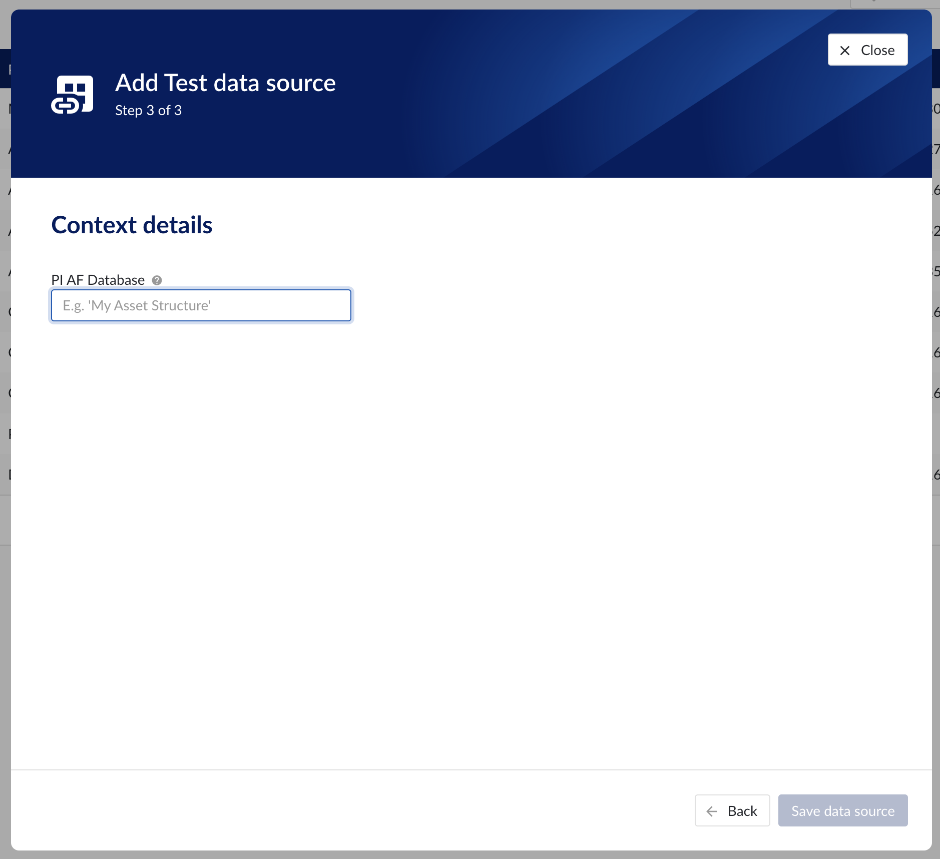

Asset details
The process of creating asset data source, is somewhat similar to the creation of time series data source, but fewer fields are required to fill in.

Asset details step in the datasource creation wizard
Context data
Context data sources are managed the same way as asset data sources. When a data source is context capable, the context capability checkbox can be checked, after which the correct database for context data needs to be specified.
Notice
Context data synchronised from a data source in OSISoft PI will be related to asset data in TrendMiner based on the "referenced elements" on the PI event frames. The system will always attempt to relate the context item to the asset corresponding to the primary referenced element in PI (if it exists). Otherwise it will default to the first referenced element for which a corresponding asset is known in TrendMiner.
It is not permitted to add the same connection multiple times with context capabilities enabled on both instances! This will result in the creation of duplicate context items.
Context details step in the datasource creation wizard
Data source menu
As soon as a new data source (with time series capability) is successfully added, it will start syncing all the tags from the data source, and can be found in the Data source overview.
To manually synchronize the data source, simply:
  1. Click on the data source of your choice within the data source overview table. Datasource details will open below the datasources overview table.
  2. Click on Time series tab.
  3. Click on "Refresh tag cache" button.
    If a data source cannot be synced, the error feedback will be shown under 'Last synced' field.
    For data sources which are successfully connected the 'Last synced' field in the data source details will show the last synced date and time and status 'Successful'. The last sync date and time will be updated when a manual sync is triggered or when TrendMiner synchronizes the tag cache for that data source, which happens automatically every 24 hours since the last refresh or service restart.
    To edit the details of a data source, click on its name to open the datasource details tile below the overview table  and then click on 'Edit' button. Datasource edit modal will appear.
    It is prohibited to edit the prefix of an existing data source because it would break existing views, formulas, etc. All other fields can be updated after which the data source is synced again.
    Other options available are:
    • Test connection (on Connection tab): this option will test the connection to the data source without triggering a sync and update the health status of the data source.
    • Delete: this option will remove the data source and all tags from this data source until it is connected again via a correctly configured connector.
    When a data source is deleted, all tags from that data source will become unavailable immediately, as well as breaking views and calculations which depend on these tags. It is possible to restore these tags and dependent views and formulas by adding the data source again, using the exact same name and prefix via the same or alternate connector.

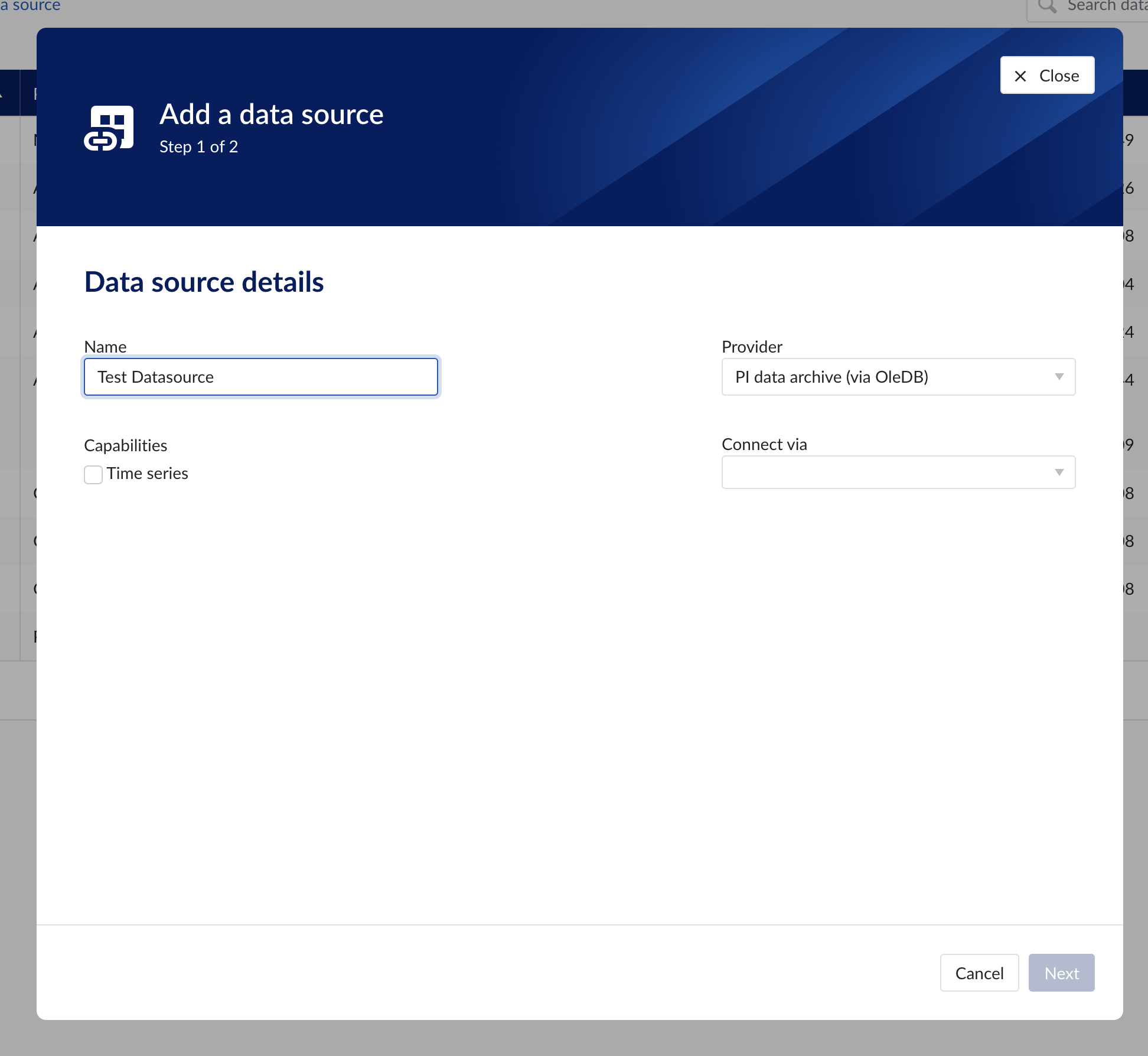

How to connect to time series data sources?
  1. Install a connector.  If your connector is already connected, this step can be skipped.
    1. In ConfigHub select the tab "Connectors".
    2. Click "+ Add connector" and fill in the details of the connector.
  2. In ConfigHub select the tab "Data sources".
  3. Click  "+ Add data source". Datasource creation modal will appear.
  4. Fill out 'Data source details' step:
    1. Name the data source.
    2. Select the provider you would like to use. If the provider of your choice is not listed, this implies none of the connected connectors supports this data source type and you have to add a connector which does, or check your implementation in case you implemented your own custom connector.
      A list of providers which TrendMiner supports out of the box can be found here.
    3. Select the connector you want to use for connecting the data source via 'Connect via' dropdown (if the provider of your choice requires a connector). If the connector of your choice is not listed, this implies this connector does not support this provider and you have to select a different connector or check your implementation in case you implemented your own custom connector.
    4. Make sure to select the "Time series" capability checkbox. If this checkbox is not visible, it means this provider does not support time series data. You can check which connectivity options TrendMiner supports out of the box here.
  5. Each data source with time series capability has some basic configuration options like "Host", "Username", "Password", "Parallel connections" etc. More information about these parameters can be found in our user documentation.
    Besides the basic configuration each data source can have some historian specific configuration and installation requirements which can be found via the links on the connectivity overview pages.

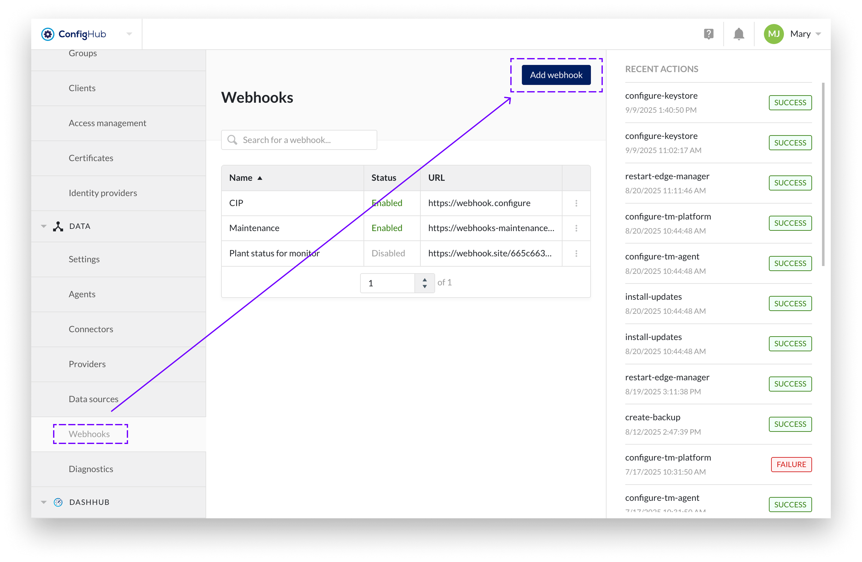

Registering a webhook
  1. Go to ConfigHub > Data > Webhooks
  2. Click Add webhook
3. Enter webhook details and select authentication method.
Each webhook must have a unique target URL. This prevents conflicts and ensures that data is delivered to the correct destination without duplication or unintended behavior.
4. Toggle ‘Enable webhook’ to start sending data to the external system once the webhook is saved.

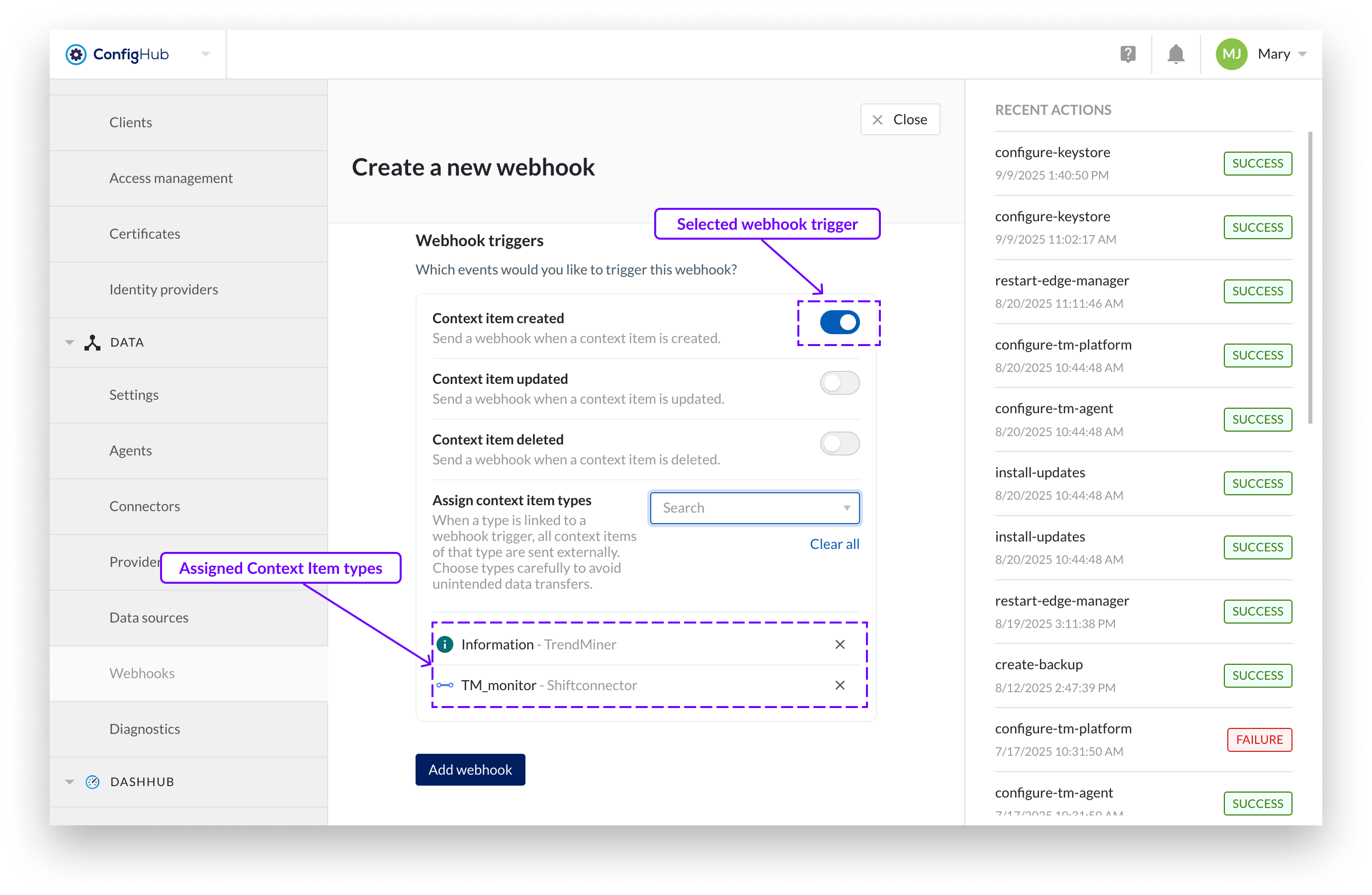

5. Select the webhook triggers and context item types
Once a webhook trigger is selected (e.g., Context Item created, updated, or deleted), a context item type filter section becomes visible. This section allows users to assign one or more context item types to the webhook. Only context items matching both the selected webhook trigger type and context type will be pushed to the external system.
Behavior & Rules
  • The context item type filter applies to the entire group of context item-related triggers.
  • It is mandatory to select at least one context item type to proceed.
A maximum of 20 webhooks can be configured per environment. If the limit is reached, you’ll need to delete existing unused or outdated webhooks before adding new ones.

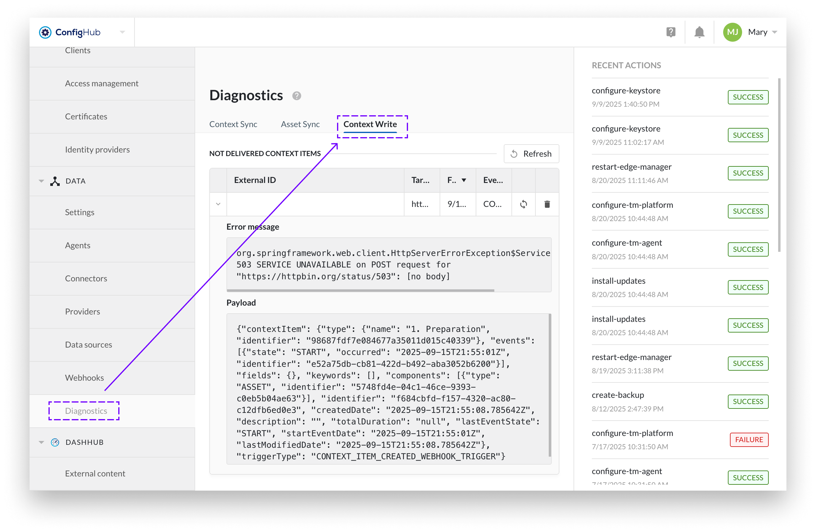

Error handling and diagnostics
When a webhook delivery fails - either due to repeated retry attempts or an immediate client-side exception - TrendMiner will take the following actions to ensure traceability and prevent further disruption:
  1. Offload the failed event: The event is offloaded to the NOT DELIVERED CONTEXT ITEMS table for inspection and troubleshooting.
  2. Disable webhook delivery: The affected webhook definition is automatically disabled to prevent additional failed attempts.
  3. Notify administrators: Admin users receive an in-app notification and an email alert (an email is being sent to all admin users that are part of tm-confighub-notifications group), prompting investigation and corrective action.
Retry logic
To improve reliability, failed webhook delivery supports retry attempts for up to 8 hours when an endpoint is temporarily unavailable. If all retries fail:
  • The event is marked as failed. As a result, the webhook definition is automatically disabled.
  • Manual intervention is required to either retry or purge the failed event.
  • Once the issue is resolved, webhook delivery will automatically resume.

Managing failed webhooks
Admin users can review and manage failed webhook events via ConfigHub → Diagnostics → Context Write. Available actions:
  • Retry: resend the event after resolving the issue (e.g., restoring system availability).
  • Purge: permanently remove the failed event and all records from the queue for the affected web hook (e.g., due to misconfigured fields or unresolvable errors).

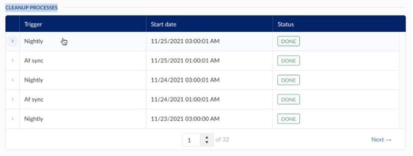

Cleanup processes maintain the quality of synchronized context items. They check whether open items are still present and up to date in the source system, and resolve items that could not be fully processed during a previous sync.
The cleanup processes share a thread pool with excessive interval sync. The number of available threads scales with the number of enabled data sources (see Excessive Interval Sync above).
Nightly sync
The automatic nightly resync of open items appears as an active job on the diagnostics screen once it starts. Every night, the system checks for context items that have been open for more than 24 hours, meaning they have a start date but no end time, indicating they are still open.
Items open longer than 24 hours may suggest the start event was successful, but an issue occurred during the closing event, preventing the context item from closing properly.
During the nightly cleanup, context items that should be closed will be updated. If they are not closed, they will remain open until an end event is received from the source.
Nightly syncs run automatically by default. If needed, you can trigger a manual cleanup from the data source settings in ConfigHub. For more details, refer to the "Data Source" section above.
