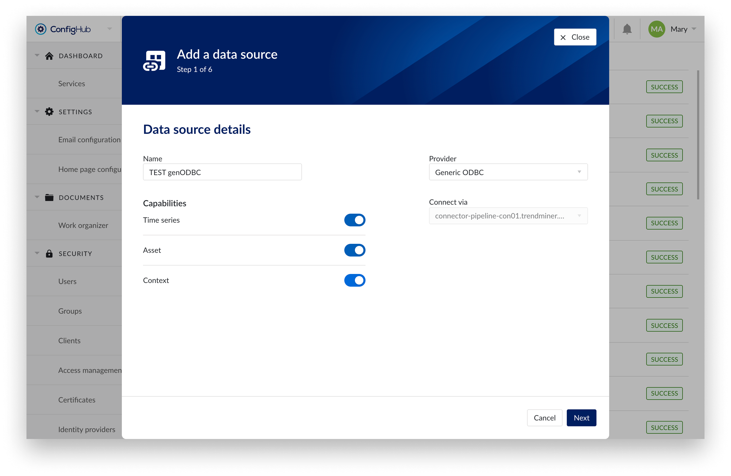

Creating a Generic ODBC data source in ConfigHub
To integrate with and ingest data from a database that supports ODBC, a data source of provider type “Generic ODBC” can be added and configured in ConfigHub.
To do so, navigate to Data > Data Sources in the left side menu. Choose the "+ Add data source" option, which will open a wizard. In the first step, choose a name and select “Generic ODBC” from the Provider dropdown. This will add two new options to fill in:
Capabilities: tick the box for each capability you intend to activate
Connect via: which Plant Integrations you will use to connect to the database
Selecting the capabilities for the data source with the given checkboxes will define the additional steps in the wizard to complete, grouped in the following sections:

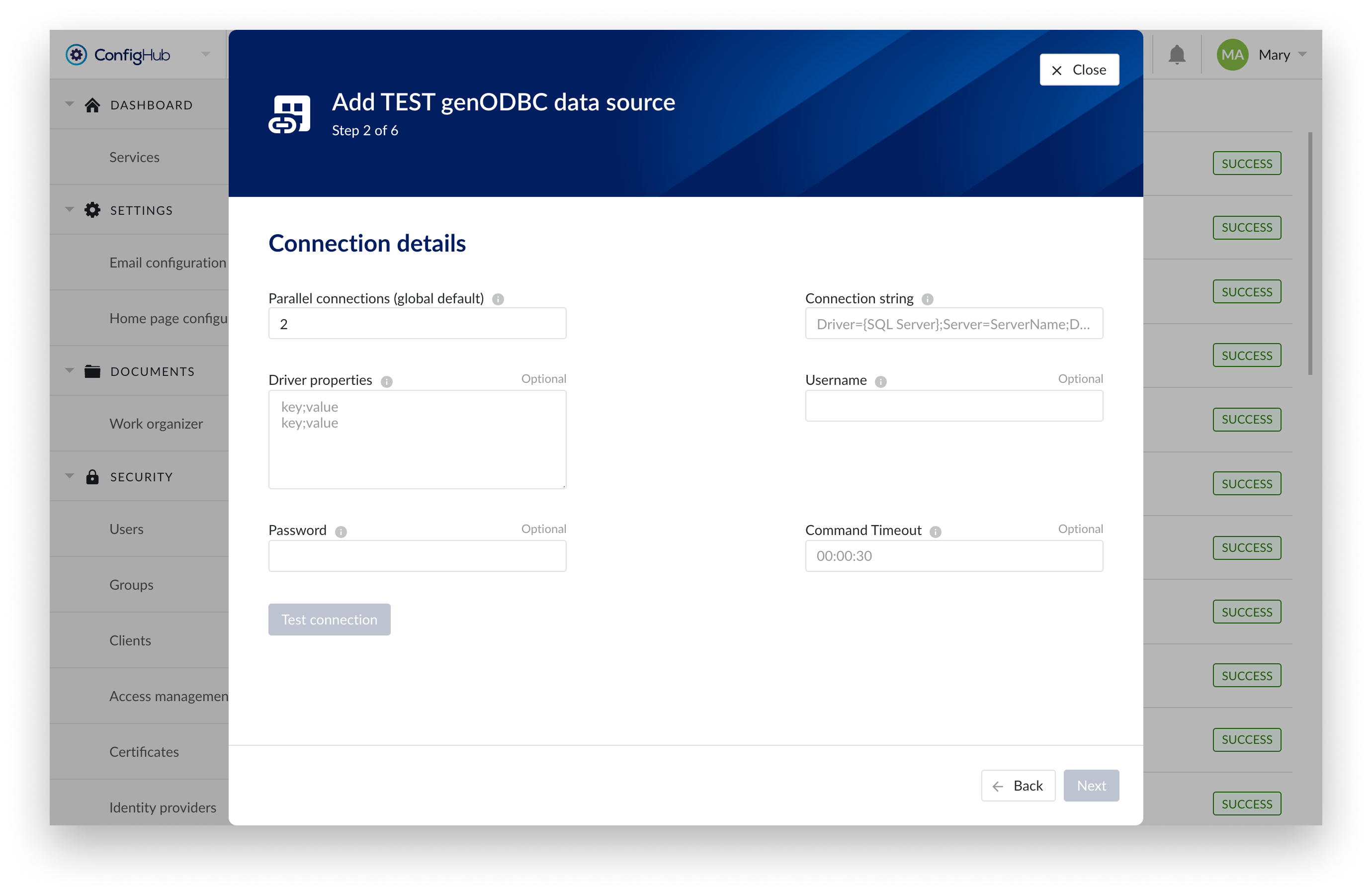

Connection details
The Generic ODBC provider uses provider properties to configure every aspect of the provider, this includes queries, credentials and date formats.
Property | Required | Capability | Remarks |
Connection string | yes | Time series Asset Event | Connection string used to connect to the underlying data source. When the same keywords are used in the connection string and the driver properties, the values from the driver properties are overwritten by the values from the connection string. Same logic applies for credentials: Username (UID) and passwords (PWD) from driver properties are overwritten by username and password from connection string and theses are overwritten by the username and password provider properties. NoticeAdvanced: When the Odbc driver does not support the UID or PWD keywords, but use Username and Password instead, you can specify these as dummy keywords in the driver properties and those will then be overwritten by the username and password provider properties specified in ConfigHub. |
Driver properties | no | Time series Asset Event | Driver properties are used as an additional way to add keywords and their values to the connection string. Driver properties are seen as more general properties and will be overwritten by values specified in the connection string. |
Username | no | Time series Asset Event | A convenience field to enter the username used to establish a connection to the database. This information can also be specified in the connection string and driver properties. |
Password | no | Time series Asset Event | A convenience field to enter the password used to establish a connection to the database. This information can also be specified in the connection string and driver properties. WarningDriver properties and Connection string are not encrypted, password however is encrypted. |
Parallel connections | yes | Time series | Each data source has 2 queues: one interactive - plot calls, one non-interactive - index calls, batch calls etc. Parallel connections determine how many connections each queue has to the connector. By default there are 2 parallel connections to the connector. |
Command Timeout | no | Time series Asset Event | Predefined time limit in which a command needs to be executed before terminating and generating a error. By default the interval is 30 seconds. A custom time can be set using the format “hh:mm:ss“ (hours, minutes, seconds). E.g. “00:01:30“. NoteNot all data sources support command timeout |

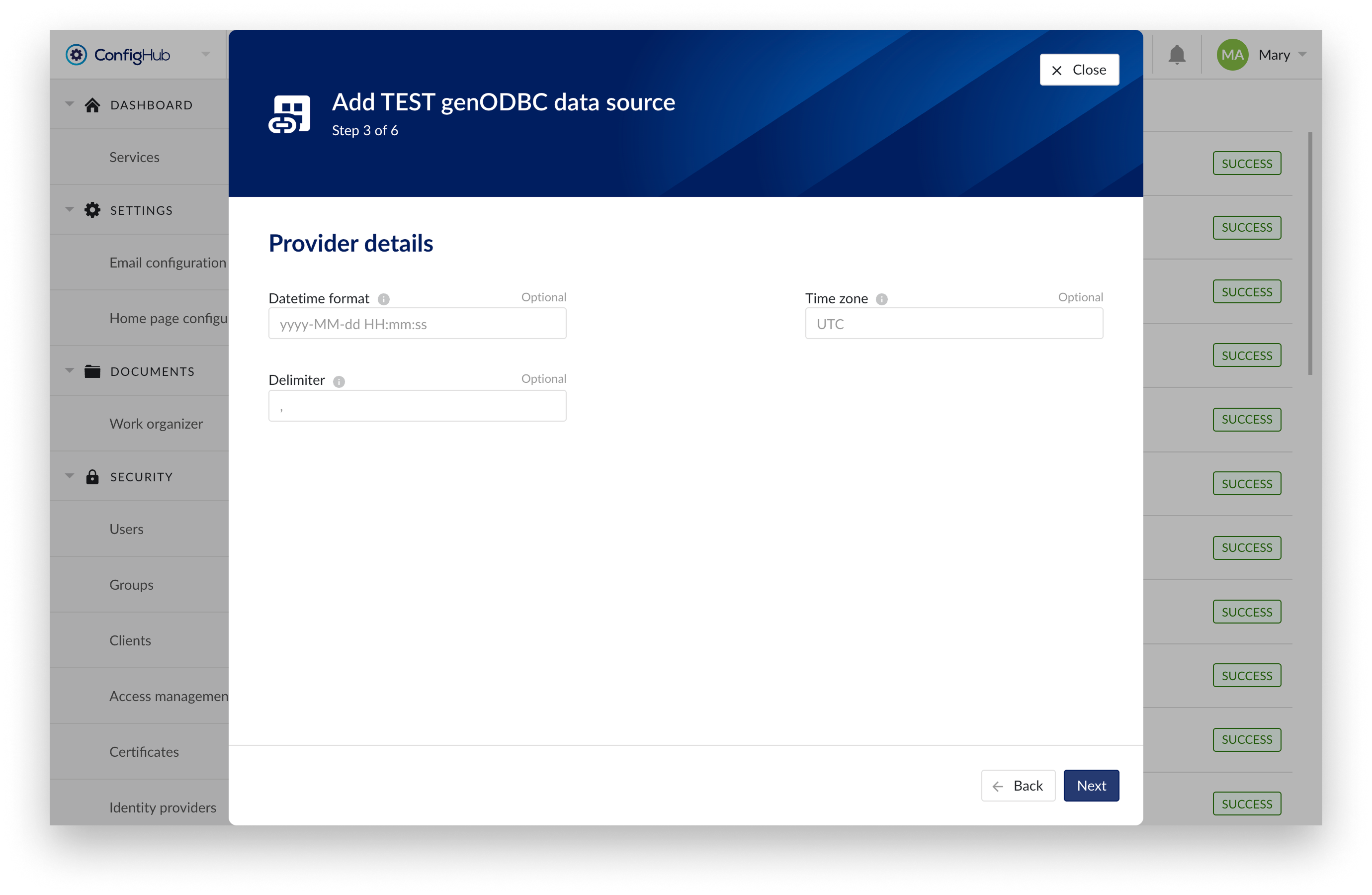

Provider properties
Datetime format | no | Time series Event | An optional format your time series data is stored in. Daylight Saving and Local timestamps When the datetimes are stored as a date time in your local time zone, you SHOULD include the offset (which changes during daylight saving transitions) in the string representation of the timestamp, specify the DateTimeFormat as There will be a validation error shown when you specify a DateTimeFormat without the offset specifier (zzz) and a Timezone other than UTC. ISO8601 If the source system expects/returns the datetime values as ISO8601 UTC, you should use e.g. |

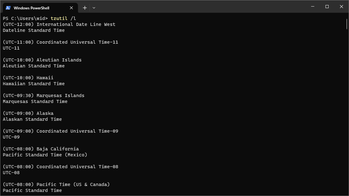

Timezone | no | Time series Event | An optional timezone your time series data is stored in. Default is UTC. The list of supported values are defined by the operating system of Plant Integrations. To get this list you can use the following command: ![]() NoticeThe second line for each time zone is the identifier that can be used, e.g. “Pacific Standard Time“ |
Delimiter | no | Asset Event | Delimiter used to separate a multi string column/ field in the provider. The default is comma (,) Asset Capability

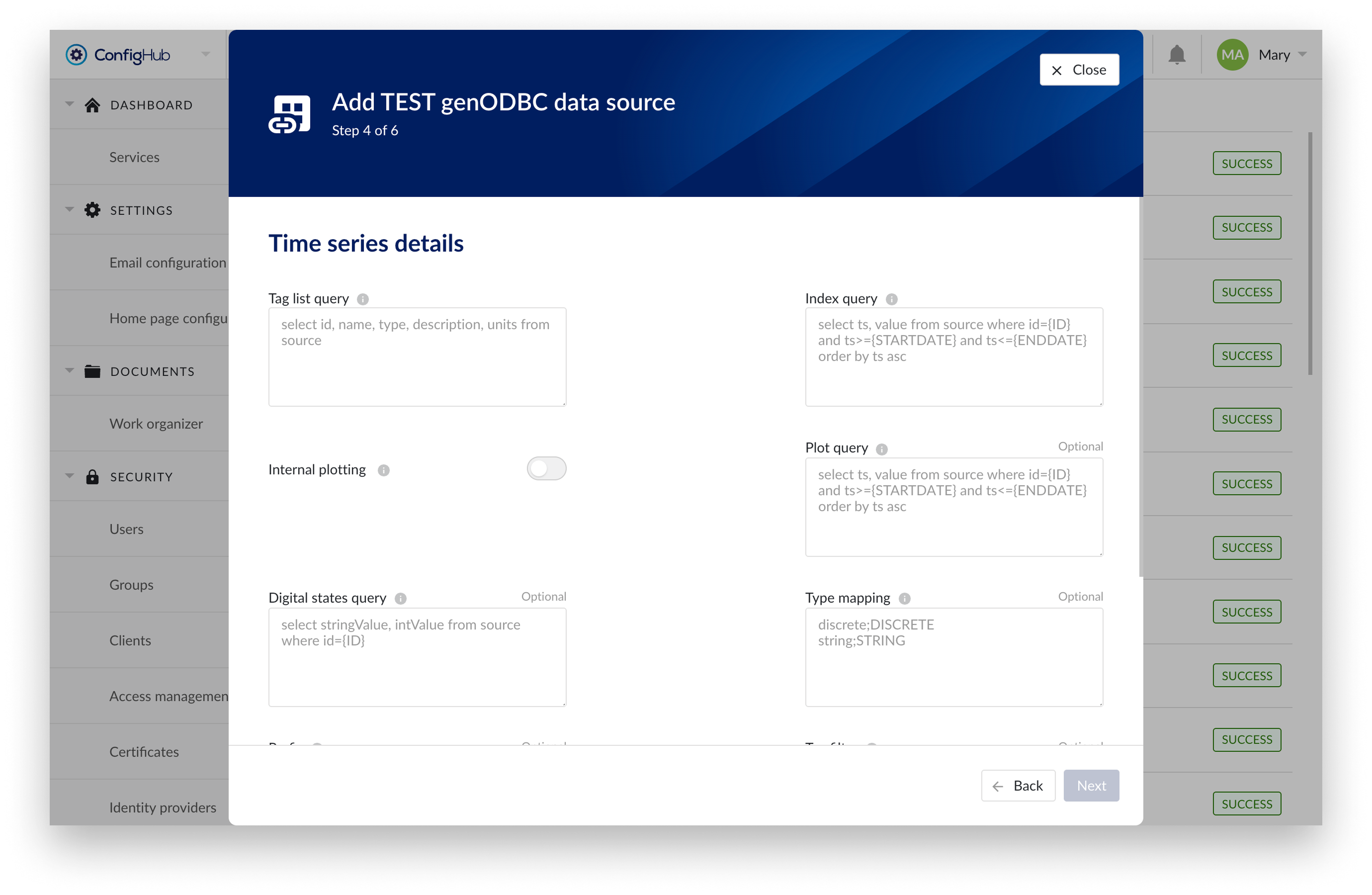

Time series details
Caution
Because the id of the tag is missing from the contract between tm-datasource and tm-plant-integrations. The name column is used for {ID} variable.
Property | Required | Remarks |
Tag list query | yes | A query used by TrendMiner to create tags. A query needs to be provided that will, given your database schema and tables. Example: select id, name, type, description, units from source Columns:
Index query | yes | A query used by TrendMiner to ingest time series data for a specific tag. The query is expected to return a ts (timestamp), value and optionally an offset. ImportantThe results should be sorted ascending on timestamp, if not they will be sorted by the provider. Variables:
Example: select ts, value from source where id={ID} and ts>={STARTDATE} and ts<={ENDDATE} order by ts asc
or
select ts, value, offset from source where id={ID} and ts>={STARTDATE} and ts<={ENDDATE} and offset>={STARTDATE:ToOffsetInMinutes} and offset<={EndDate:ToOffsetInMinutes} order by ts ascColumns:
Internal plotting | no | If this option is selected TrendMiner will use interpolation if needed to plot the tag on the chart on specific time ranges. If this value is not selected and no plot query is provided, TrendMiner will plot directly from the index. |
Plot query | no | A query used by TrendMiner to plot time series data for a specific tag. The query is expected to return a ts (timestamp) and a value. ImportantThe results should be sorted ascending on timestamp, if not they will be sorted by the provider. Variables:
or
Digital states query | no | If tags of type DIGITAL are returned by the tag list query, TrendMiner will use this query to ask for the stringValue, intValue pairs for a specific tag to match a label with a number. Variables:
Example: select stringValue, intValue from source where id={ID}Columns:
Type mapping | no | If types differ from what TrendMiner uses and one wants to avoid to overcomplicate the query, a type mapping can be entered here. It can contain multiple lines and expect per line the value to be representing a custom type followed by a ; and a TrendMiner type. During the execution of the tag list query TrendMiner will then use this mapping to map the custom values returned in the query to TrendMiner tag types. customTypeA;ANALOG customTypeB;DIGITAL customTypeC;DISCRETE customTypeD;STRING |
Prefix | no | An optional text can be entered here that will be used to prefix the tag names in TrendMiner. WarningValue cannot be changed. |
Tag filter | no | An optional regular expression to be entered. Only tags with names that match this regex will be retained when creating tags (using the tag list query). |
Aggregation type | no | The providers support aggregating data from the data source before sending it to the TrendMiner appliance. If the historian does not support data aggregation, the aggregation can be enabled here. Aggregation type defines an aggregation algorithm to optimize index data for analysis. Options include:

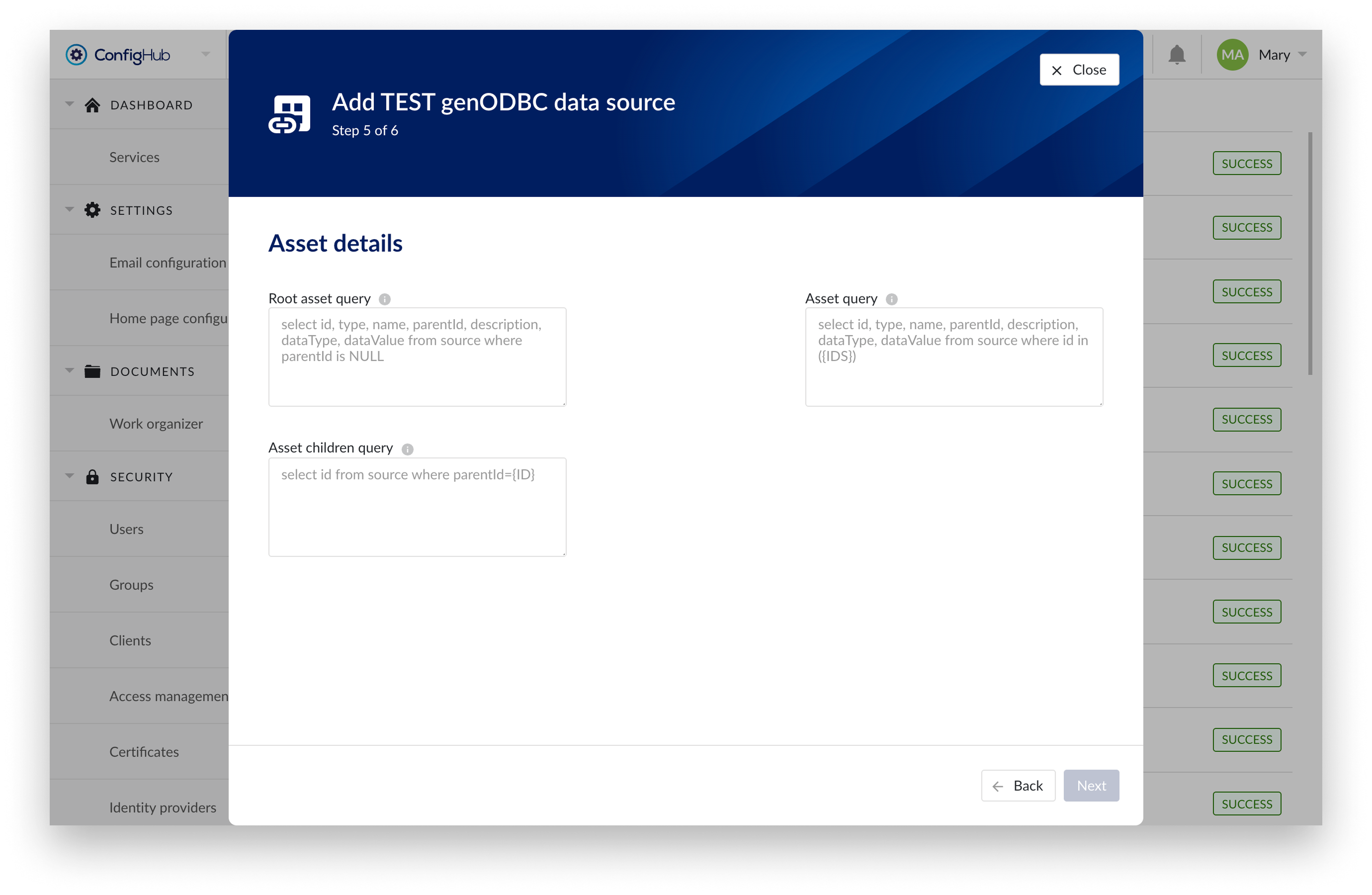

Asset details
Root asset query | yes | This query is responsible for returning all top level elements from the asset tree structure. Example: select id, type, name, parentId, description, dataType, dataValue from source where parentId is NULL Columns:
Asset query | yes | This query needs to return details for a specific asset record. Variables:
Example: select id, type, name, parentId, description, dataType, dataValue from source where id in ({IDS})Columns:
Asset children query | yes | This query needs to return the ids of the direct descendants of this asset. Variables:
Example: select id from source where parentId={ID}Columns:

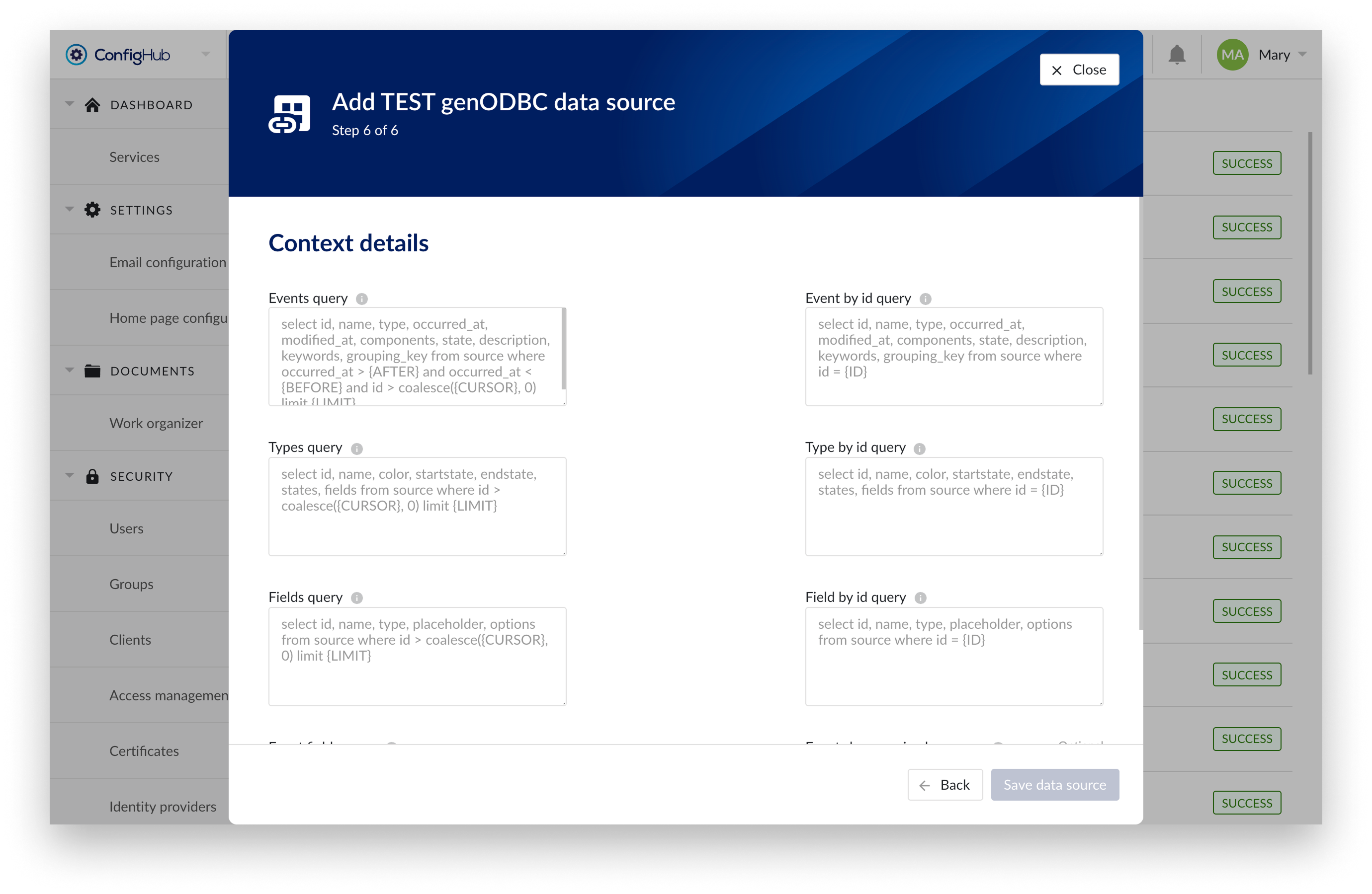

Context details
Events query | yes | This query is responsible for returning events from the source database. Context items will be generated based on these events. Variables:
Example: select
id, name, type, occurred_at, modified_at, components, state, description, keywords, grouping_key
from
Event
where
occurred_at > {AFTER}
and
occurred_at < {BEFORE}
and
id > coalesce({CURSOR}, 0)
limit
{LIMIT}Columns:
Event by id query | yes | This query is responsible for returning a specific event from the source database. Variables:
Example: select id, name, type, occurred_at, modified_at, components, state, description, keywords, grouping_key from Event where Id = {ID}Columns:
Types query | yes | This query is responsible for returning a list of possible event types from the source database. Variables:
Example: select id, name, color, startstate, endstate, states, fields from eventtype where Id > coalesce({CURSOR}, 0) limit {LIMIT}Columns:
Type by id query | yes | This query is responsible for returning an event type from the source database. Variables:
Examples: select id, name, color, startstate, endstate, states, fields from Type where id = {ID}Columns:
Fields query | yes | This query is responsible for returning a list of possible custom fields from the source database. Variables:
Example: select id, name, type, placeholder, options from Field where Id > coalesce({CURSOR}, 0) limit {LIMIT}Columns:
Field by id query | yes | This query is responsible for returning a custom field from the source database. Variables:
Example: select id, name, type, placeholder, options from Field where Id = {ID}Columns:
Event fields query | yes | This query is responsible for returning custom field values for specific event. Variables:
Example: select fieldId, value from source where eventId = {ID}Columns:
Events by grouping key query | yes | This query is responsible for returning event(s) from the source database that are within the same group. Variables:
Example: select id, name, type, occurred_at, modified_at, components, state, description, keywords, grouping_key from source where grouping_key = {GROUPINGKEY} and id > coalesce({CURSOR}, 0) limit {LIMIT}Columns
