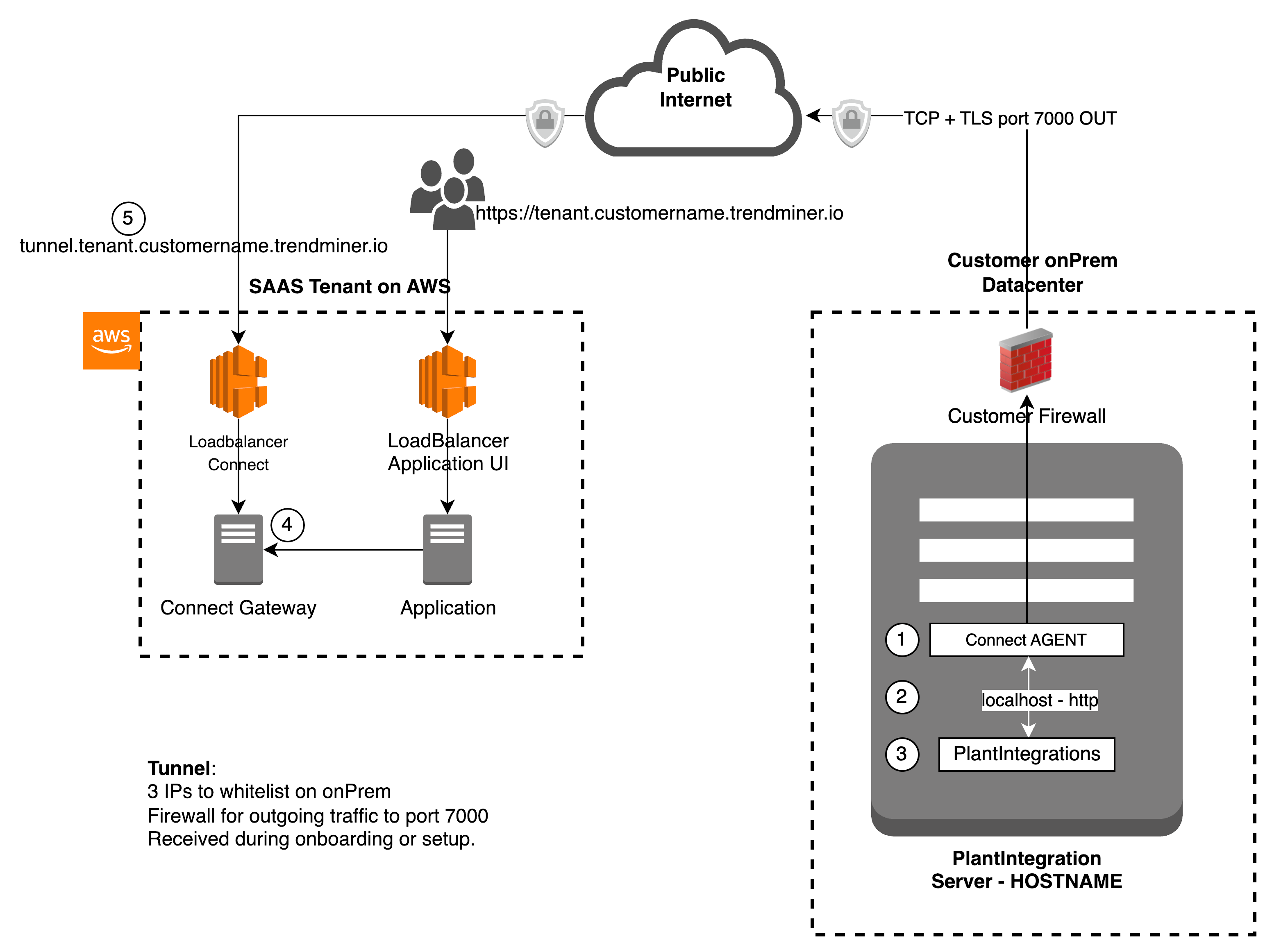

Simplified view of TrendMiner Connect communication flow (connection setup)

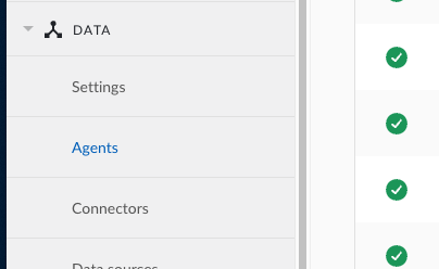

Login to Trendminer and open confighub (e.g. https://site.mycompany.trendminer.io/confighub)
click on Agents under the DATA sections of the menu at the left side:

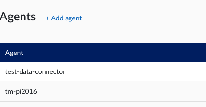

You will now see all configured agents or tenant connections you have activated. In below example there are 2 listed.

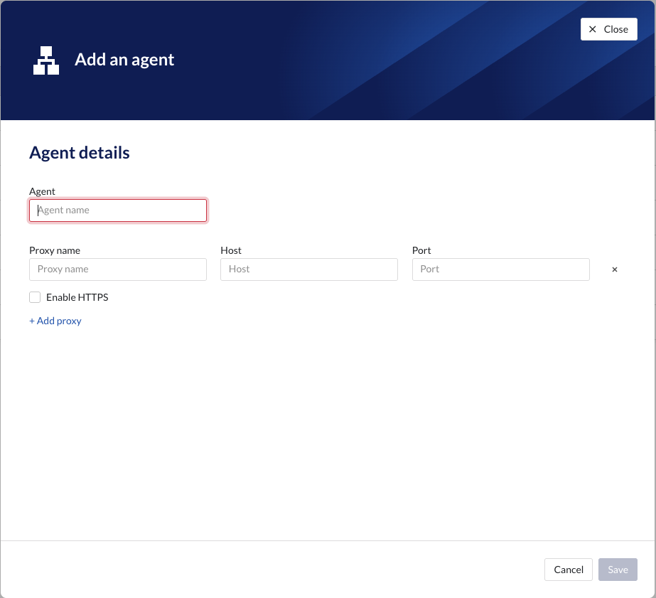

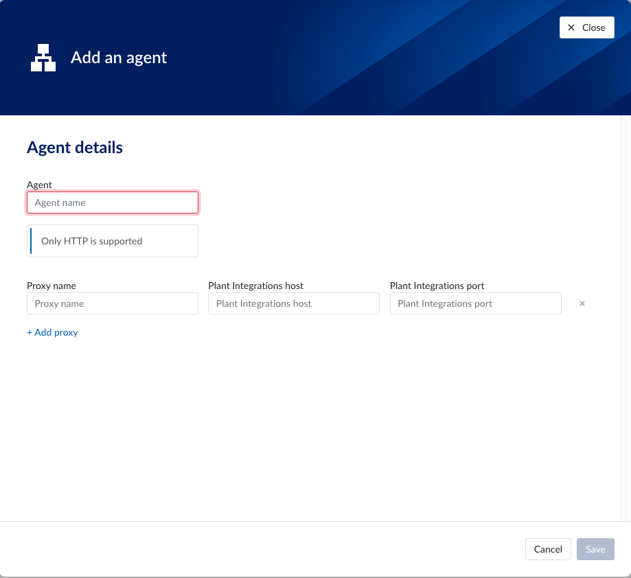

Click on “+ Add agent”
In this screen you need to specify the parameters required to access the plant-integration server(s).
This is a overview of the parameters and their values/limits:
Agent: it's the name of the agent. The name should be a valid DNS name. This is used when setting up the connector itself.
Proxy Name: This is the name that will be used when creating the connector. If the agent is running on the same server then the plant integration server, it's advised to use the same name. If not, you could specify the hostname of the server running the plant-integration.
Plant Integration host: please specify IP or hostname of this server.
Plant Integration port: please specify the port where the plant integration service will be reachable on.

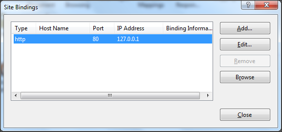

Configure IIS to only accept traffic from 127.0.0.1, so only processes running on the same server can connect. This can be configured as follows:
Open IIS Manager.
In the Connections pane, expand your server and select the target website.
In the Actions pane, click Bindings.
Edit the existing binding (or add a new one) and set the IP address to 127.0.0.1 instead of “All Unassigned”.
Click OK to save.

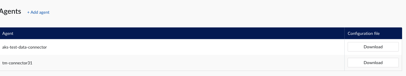

Ones the agent configuration is done, you need to download the config.zip file from the user interface by clicking on this button:

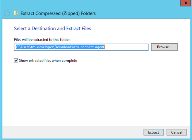

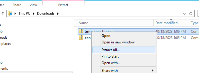

Extract tm-connect-agent.zip by right clicking on the zip file and clicking on “Extract All”
Click on Extract

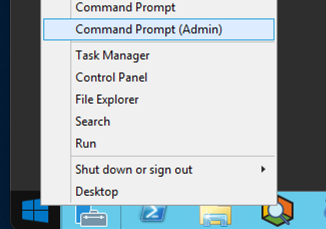

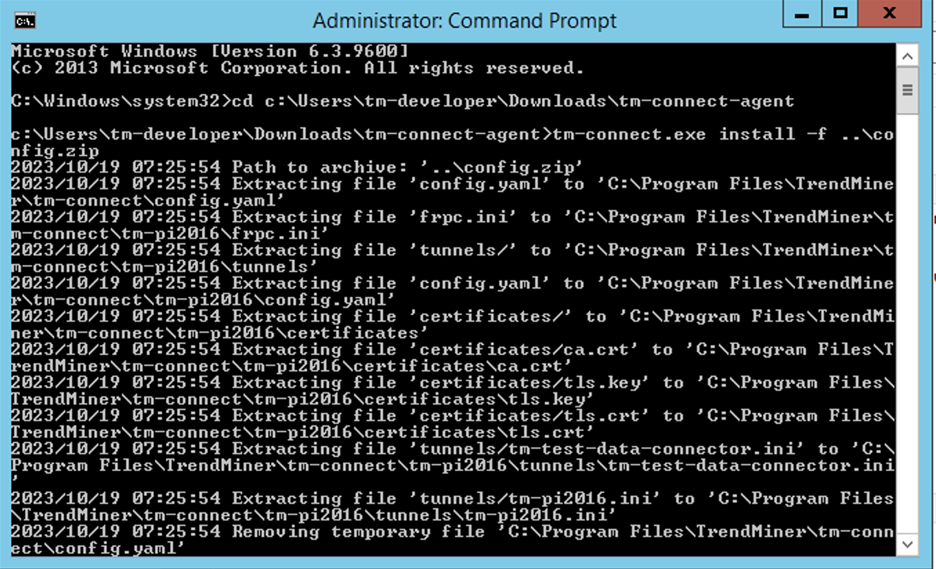

Open a command prompt as administrator
Change your directory to the directory where you have unzipped the files from tm-config-agent.zip
Run the following command to install the agent, with the received config.zip file
tm-connect.exe install -f ..\config.zip

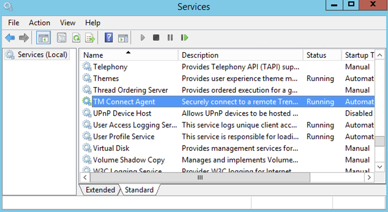

Ones everything is successfully installed, you will see the service running when you check running services (services.msc).

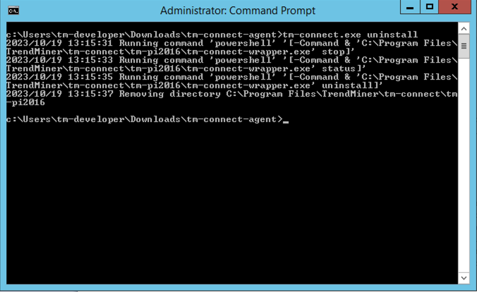

Uninstalling an Agent
Same procedure as a above except use the following command to uninstall the agent:
tm-connect uninstall

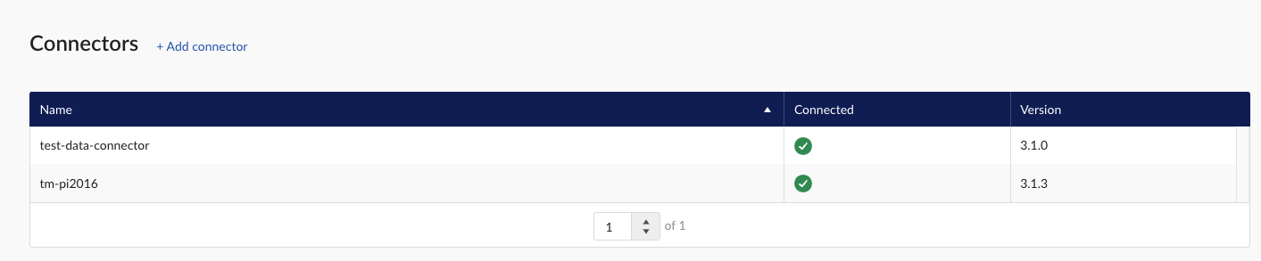

Validate the connection
Login to TrendMiner and open ConfigHub (e.g. https://site.mycompany.trendminer.io/confighub)
Navigate to Connectors, and validate the connection is properly running.

Simplified view of TM Connect communication flow (connection setup)
(1) Connect Agent service running on Windows server, and can be accessed by (3) plant integration service over a local port (2)
(1) Connect Agent initiates the connection to (4) Connect gateway to setup a bidirectional secure encrypted tunnel using (5) the url tunnel.tenant.customername.trendminer.io on port 7000
