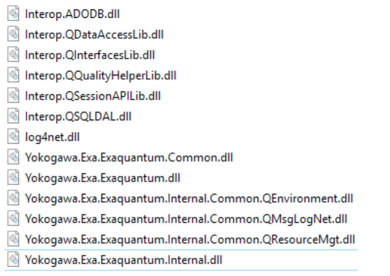

  4. Copy the following .dll files from Yokogawa Exaquantum server to the installation's bin folder. The default location would be: C:\inetpub\PlantIntegrations\bin
    AxInterop.QDataSelLib.dll
    AxInterop.VSFlex7U.dll
    Interop.ADODB.dll
    Interop.MXTimeDialogs.dll
    Interop.MXXLDataSelector.dll
    Interop.QClientProxyLib.dll
    Interop.QDataAccessLib.dll
    Interop.QDragDropLib.dll
    Interop.QGeneralSecurityLib.dll
    Interop.QInterfacesLib.dll
    Interop.QItemIDCacheLib.dll
    Interop.QOPCAEPump.dll
    Interop.QOPCDAMgr.dll
    Interop.QQualityHelperLib.dll
    Interop.QRecalcEngine.dll
    Interop.QServerAccess.dll
    Interop.QServerSecurityLib.dll
    Interop.QSessionAPILib.dll
    Interop.QSQLDAL.dll
    Interop.QuantumAutomationLib.dll
    Interop.QuantumLib.dll
    Interop.QWebSecurityLib.dll
    Interop.QZOPCAECatchup.dll
    Interop.QZOPCDACatchup.dll
    Interop.SQLDMO.dll
    Interop.SSActiveTreeView.dll
    Interop.StdType.dll
    Interop.TeeChart.dll
    Interop.VBA.dll
    Interop.WEBAuthoring.dll
    log4net.dll
    Yokogawa.Exa.Exaquantum.Common.dll
    Yokogawa.Exa.Exaquantum.Common.xml
    Yokogawa.Exa.Exaquantum.dll
    Yokogawa.Exa.Exaquantum.Internal.Common.QEnvironment.dll
    Yokogawa.Exa.Exaquantum.Internal.Common.QMsgLogNet.dll
    Yokogawa.Exa.Exaquantum.Internal.Common.QResourceMgt.dll
    Yokogawa.Exa.Exaquantum.Internal.Common.QSettingInitialize.exe
    Yokogawa.Exa.Exaquantum.Internal.dll
    Yokogawa.Exa.Exaquantum.xml
    Yokogawa.Exaquantum.CommonControls.dll
    Yokogawa.Exaquantum.Security.dll
    Yokogawa.Framework.Extensibility.Licensing.dll
    Yokogawa.Framework.Extensibility.Security.dll
