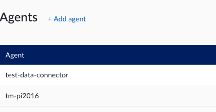

You will now see all configured agents or tenant connections you have activated. In below example there are 2 listed.
In case an Agent config is updated, you need to download a new config.zip file, and install it according to this tutorial.

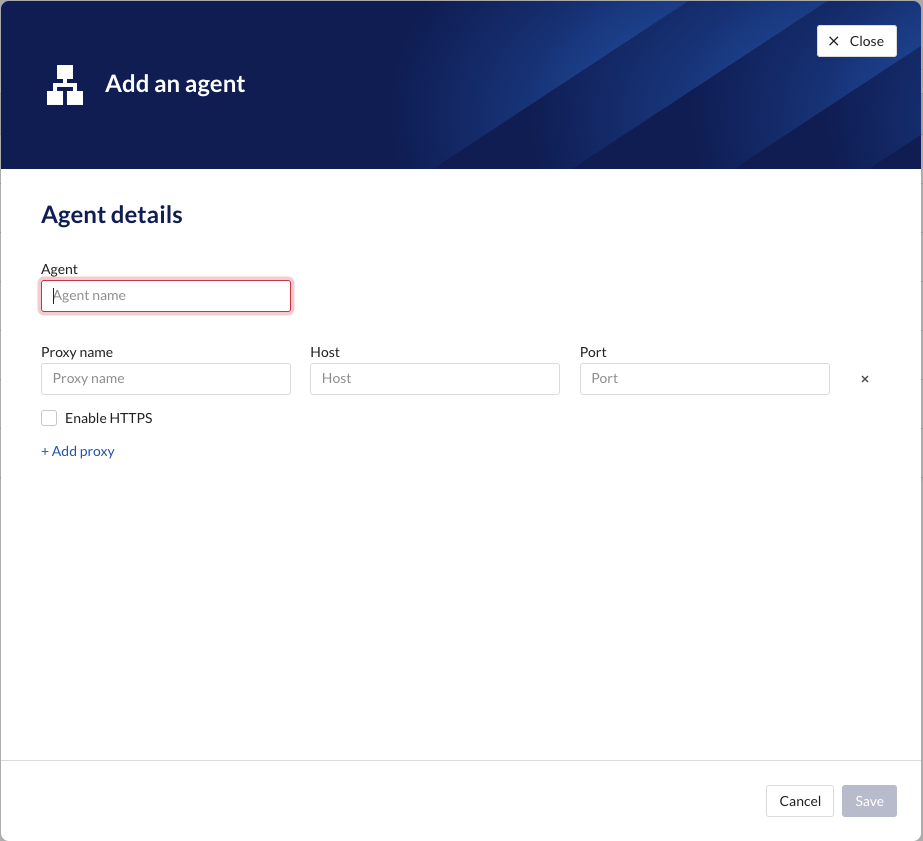

  • Click on “+ Add agent”
In this screen you need to specify the parameters required to access the plant-integration server(s) or other external datasources
This is a overview of the parameters and their values/limits:
  • Agent: it's the name of the agent. The name should be a valid DNS name. This is used when setting up the connector itself.
  • Proxy Name: This is the name that will be used when creating the connector. If the agent is running on the same server then the plant integration server, it's advised to use the same name. If not, you could specify the hostname of the server running the plant-integration.
  • Host: please specify IP or hostname of the server hosting PlantIntegration or the external datasource.
  • Port: please specify the port where the plant integration or other external datasource will be reachable on.
  • Enable HTTPS: in case you want to have the connection towards the server done over HTTPS please check this option

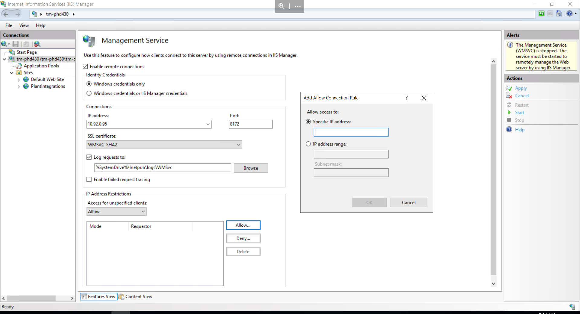

  • Configure IIS to only accept traffic from 127.0.0.1, so only processes running on the same server can connect. This can be configured as follows:
    • Open IIS Manager.
    • In the Connections pane, expand your server and select the target website.
    • In the Actions pane, click Bindings.
    • Edit the existing binding (or add a new one) and set the IP address to 127.0.0.1 instead of “All Unassigned”.
    • Click OK to save.
    As an alternative, configure the connector server to only allow connections from specific IPs:
  • if needed use hostnames to run multiple plant integration servers. they all should listen only on 127.0.0.1

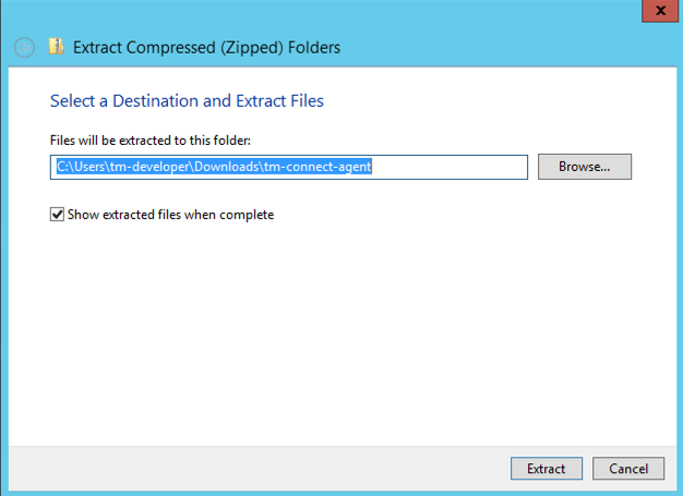

  • Download the config.zip and tm-connect-agent.zip and place it in easy to access folder, e.g. downloads
  • Extract tm-connect-agent.zip by right clicking on the zip file and clicking on “Extract All”
  • Click on Extract

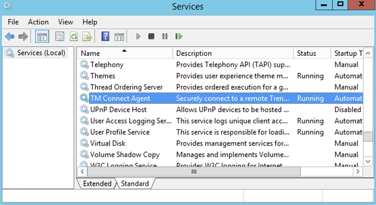

Ones everything is successfully installed, you will see the service running when you check running services (services.msc).

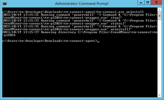

Same procedure as a above except use the following command to uninstall the agent:
tm-connect uninstall

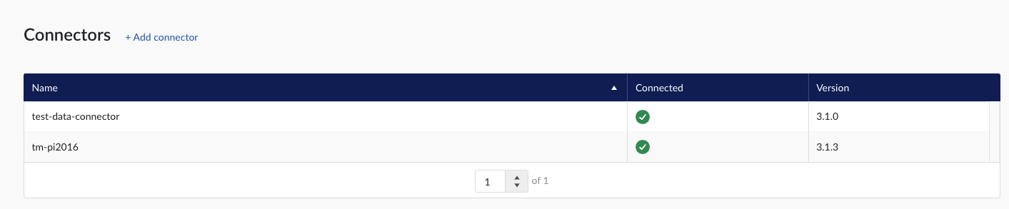

Login to TrendMiner and open ConfigHub (e.g. https://site.mycompany.trendminer.io/confighub)
Navigate to Connectors, and validate the connection is properly running.
