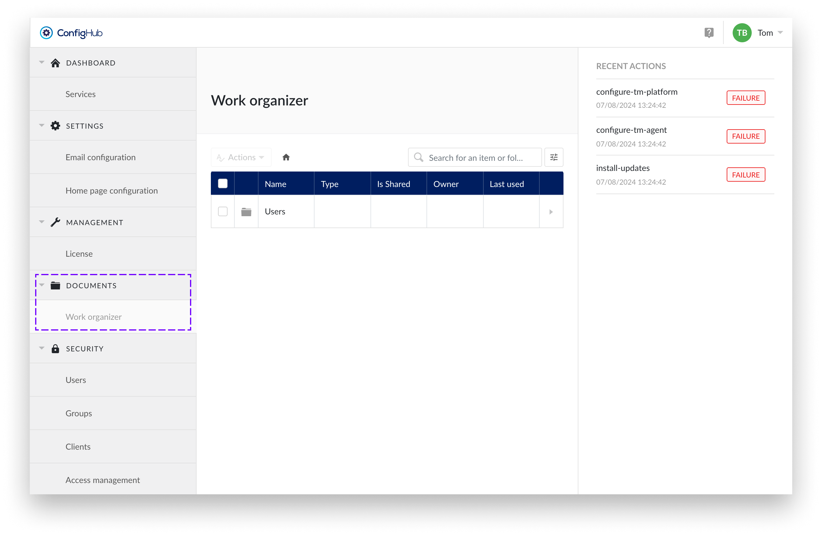

Work organizer
Work Organizer in ConfigHub gives you control over the entire Work Organizer structure. As a System Administrator, you essentially have access from the root, which is why it is also referred to as the Top Level Work Organizer (TLWO).
This access enables the management of users' home folders. It supports standard actions such as renaming, making copies, sharing items, moving items to a folder, deleting items, and creating subfolders within the same home folder.
You also have the option to transfer the entire contents of one home folder, along with all items shared with the home folder's owner, to another user's home folder.
Additionally, there is the option to delete home folders that are no longer active.

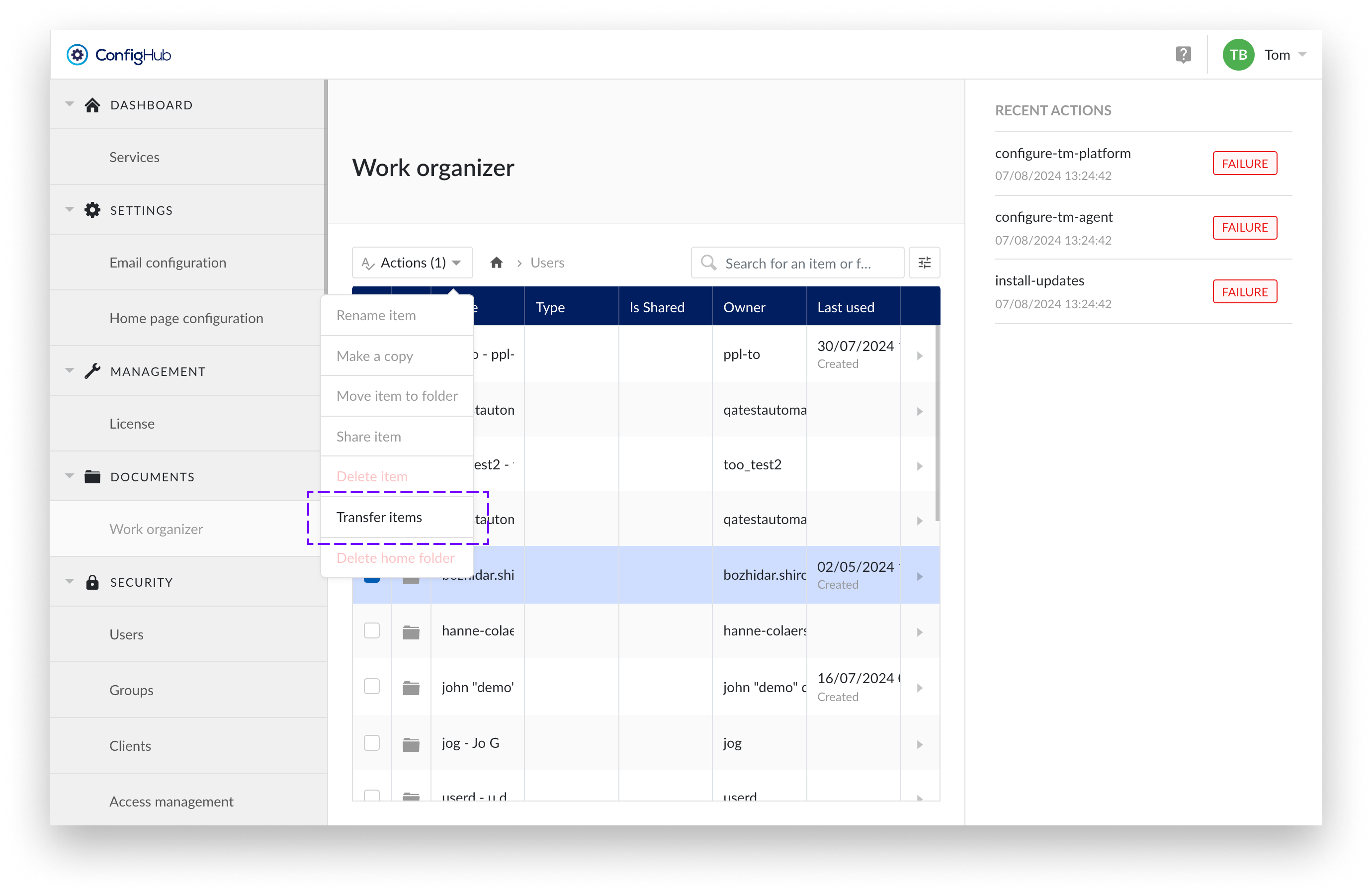

To transfer items from one user to another follow the steps below:
  1. Select the home Folder
    Choose the home folder you want to transfer

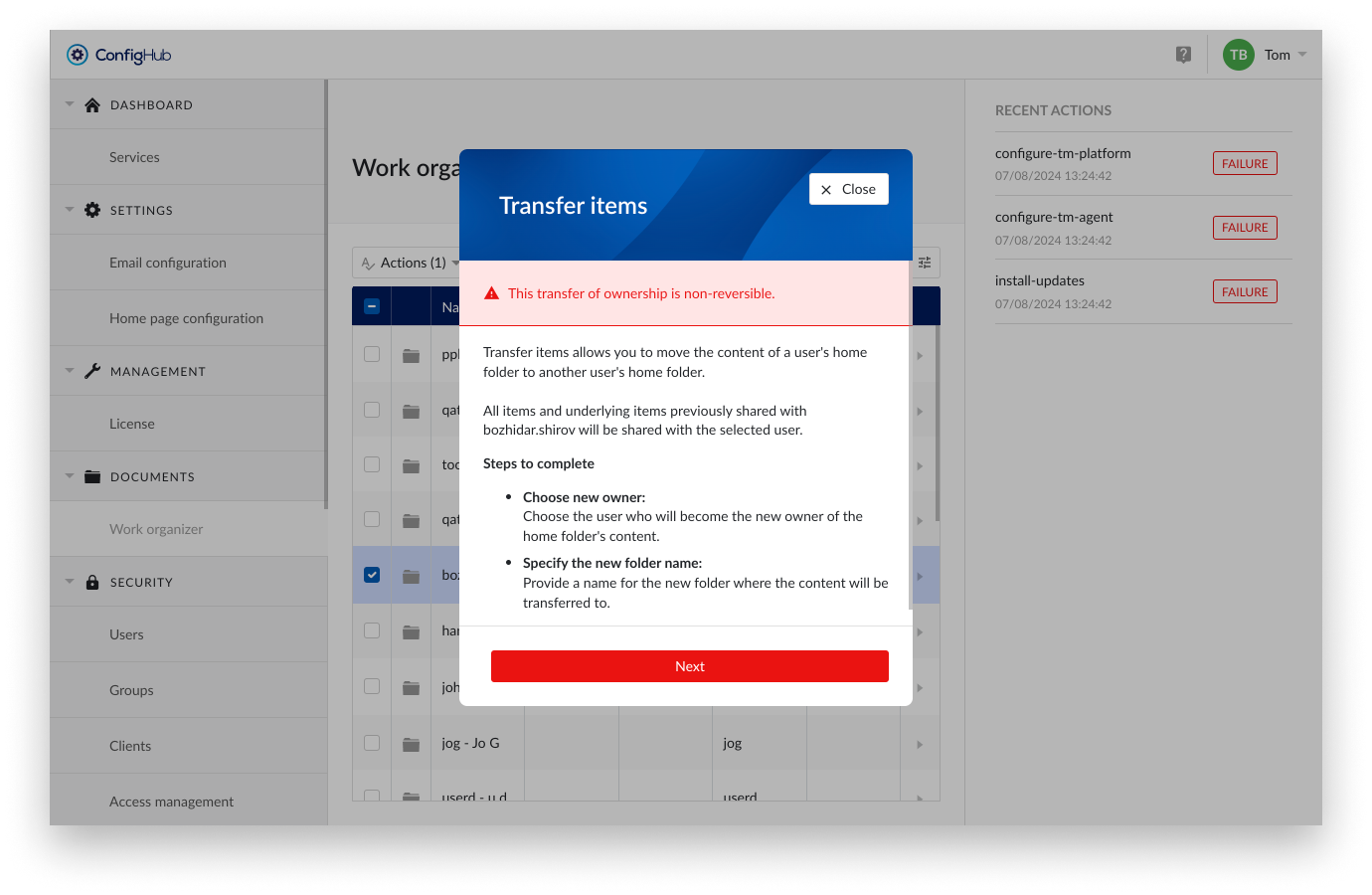

  2. Choose "Transfer items" from the actions dropdown
    Select the option “Transfer items”.
  3. Notification pane
    You will get an overview of the actions that will be performed. Review these carefully. Transfer of ownership is non-reversible without transferring the entire content of a home folder plus all items shared with the owner of the home folder.

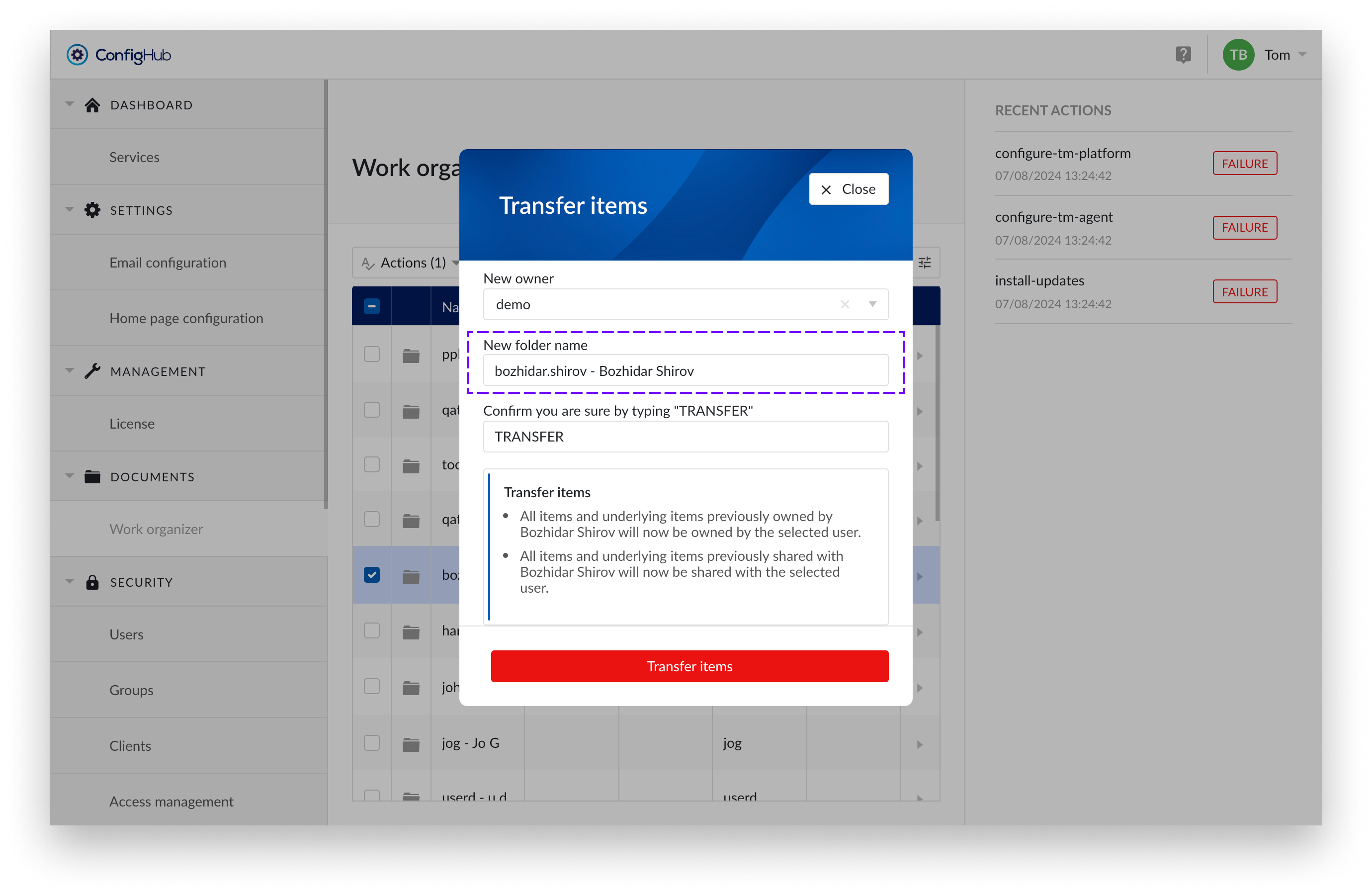

  4. New owner
    Select the user who will become the new owner.
  5. New folder Name
    Provide a clear and descriptive name for the folder. As a suggestion, we prefill the name with the username of the selected folder, but you are free to enter any other name you prefer. This folder will be created in the root of the home folder of the receiving user.
  6. Confirm you are sure by typing "TRANSFER"
    Double-check all input fields and the accompanying text. By typing "TRANSFER" in the input field, you agree to the actions that will follow.

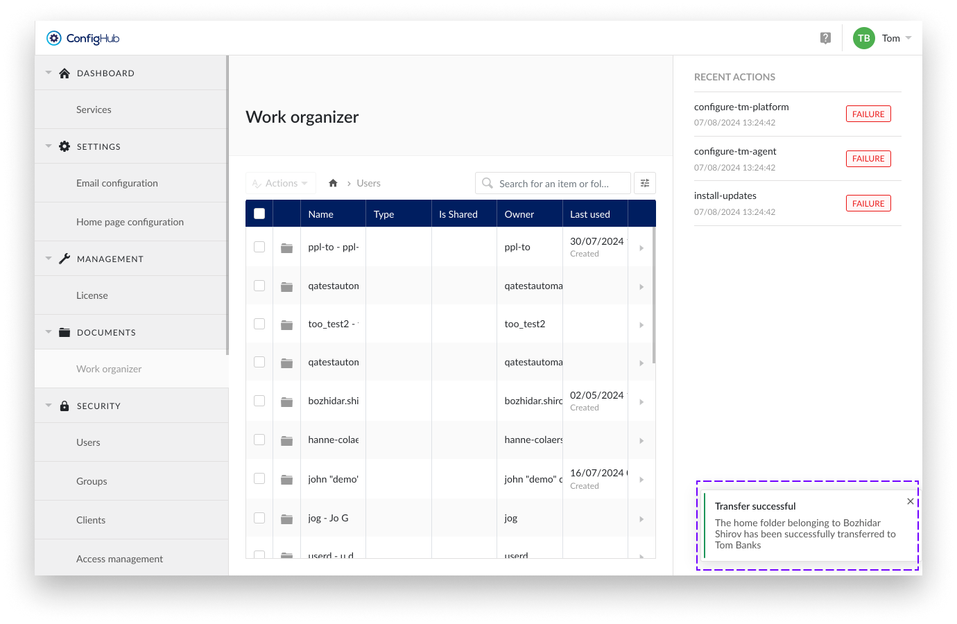

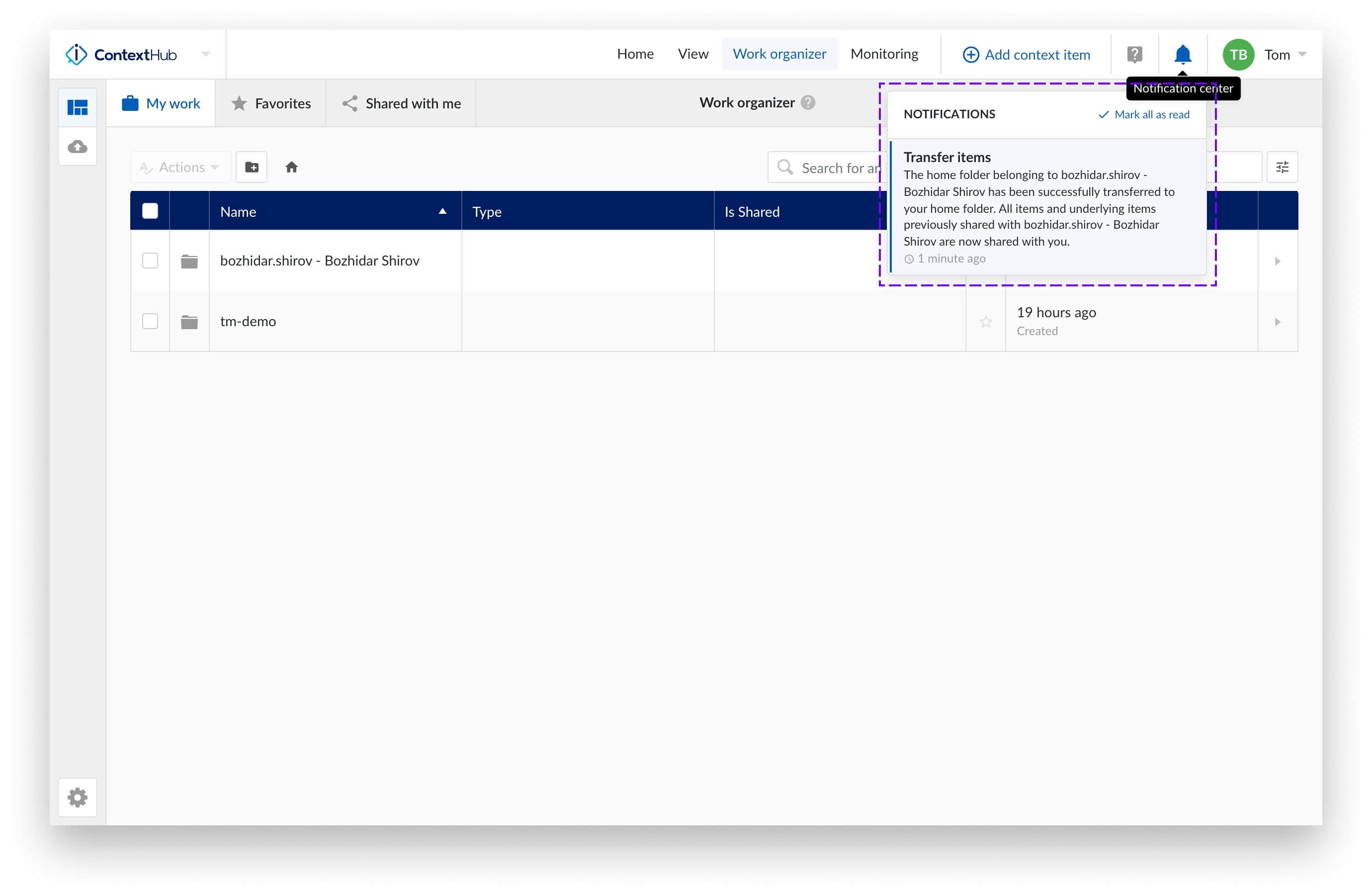

  7. Notifications
    After the transfer, the following notifications will be sent.
    Transfer successful
    • Confirmation in ConfigHub:
    • Confirmation original owner:
    • Confirmation transferee:

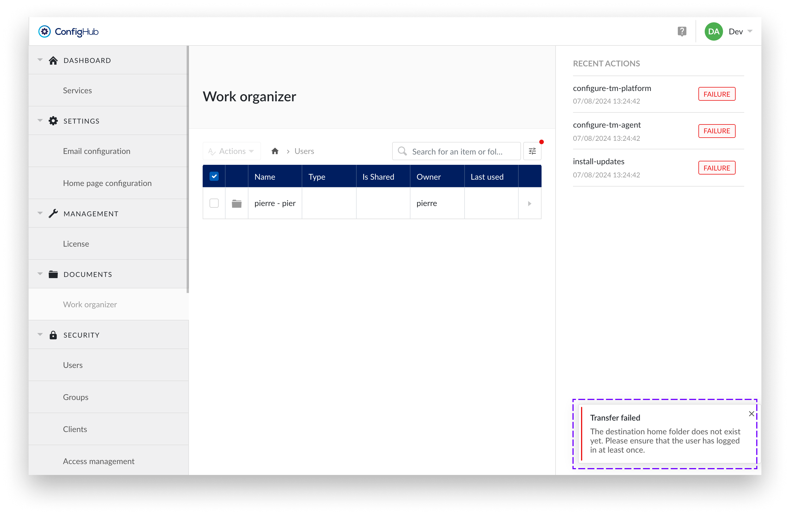

    Transfer failed
    If you attempt a transfer to a user who has not logged in before, it will fail because the home folder for this user has not yet been created.

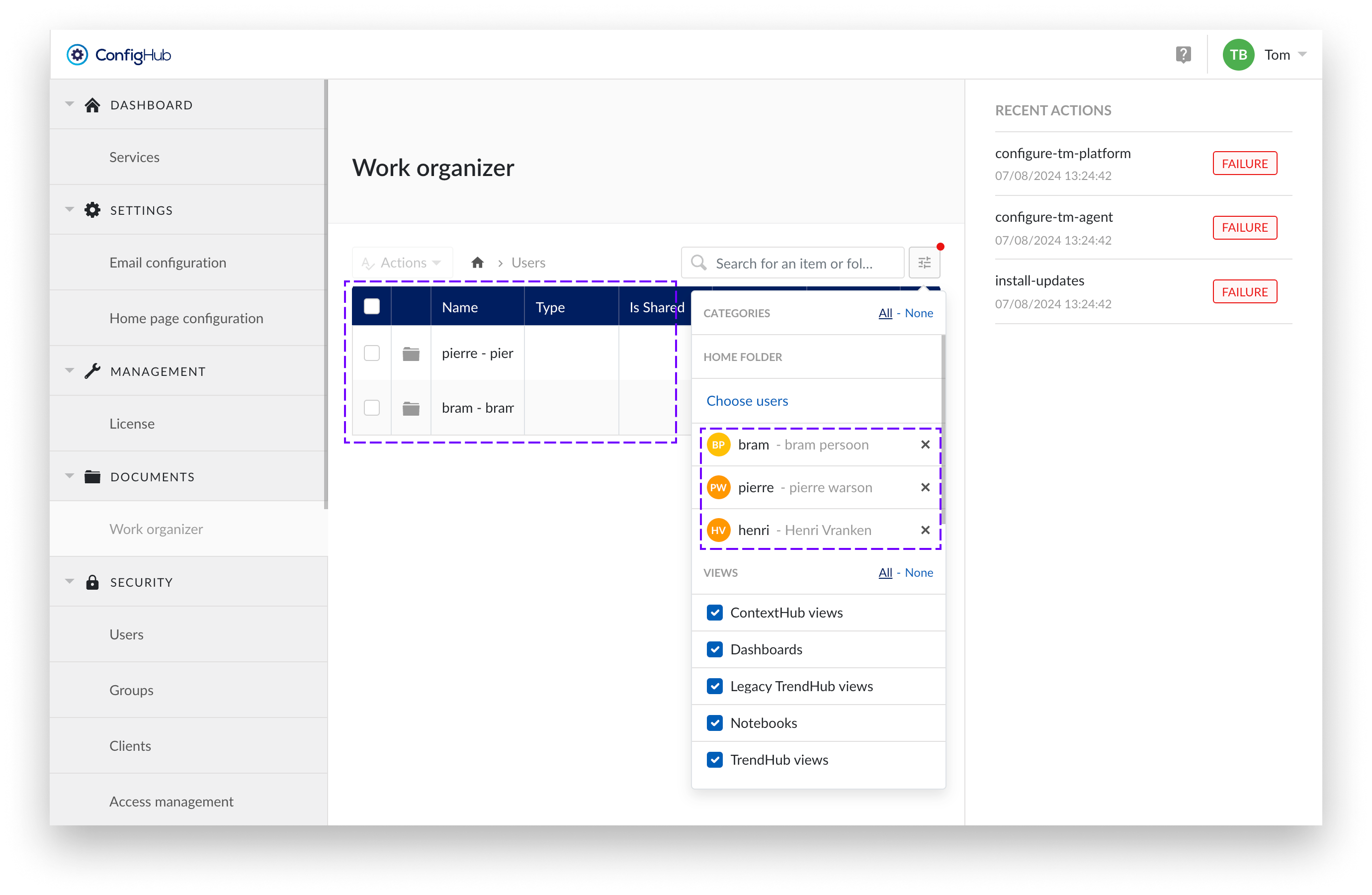

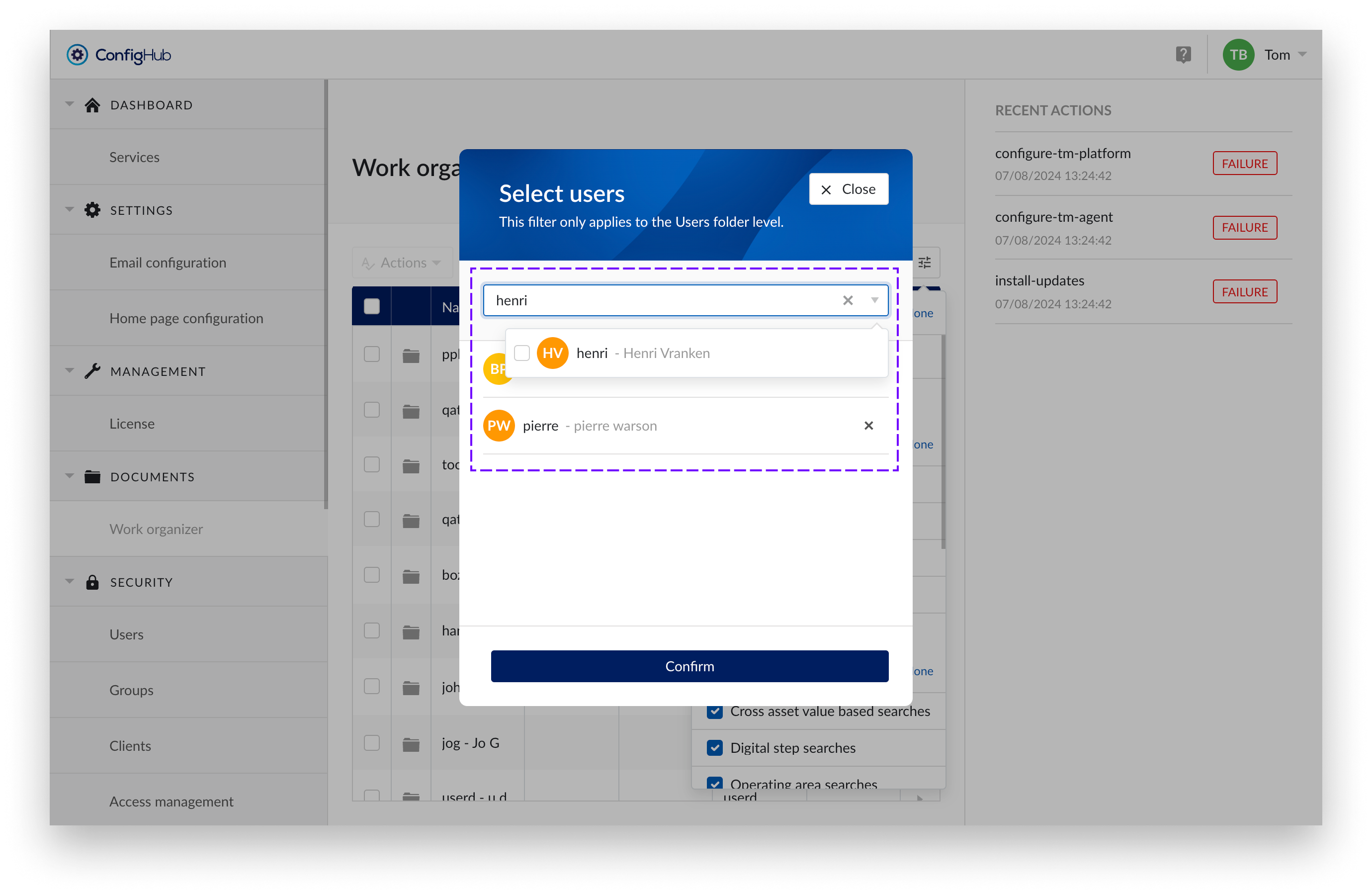

Home folder filter
A new filter has been added which is only available in the Top Level Work Organizer. This filter allows you to specifically search for a user's home folder.
The filter was added because the home folder list is not sortable or alphabetically arranged by the user's name. This is because TrendMiner separates personal data from the application and does not store it in the Work Organizer. To avoid scrolling through long lists of unsorted home folders, the home folder filter has been added.
The home folder filter is only applied at the level of Root > Users to avoid interfering with the behavior of the standard filters.
Steps:
  1. Open the filters and "Choose users"
    Access the filter options and select "Choose users" under HOME FOLDER.
  2. Search for Users
    Search for users. Both active and deleted users will be displayed. This helps you find the home folders of deleted users and transfer their contents to active users.
  3. Confirm
    Confirm your filter selection.
  4. Filter is applied
    Under the Users directory, only home folders that meet the filter criteria are displayed.

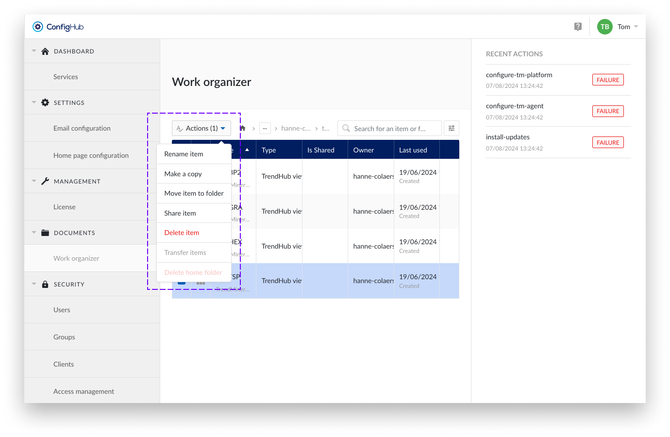

Available Actions :
To perform any of these actions, check an item or folder and then select the desired action from the Actions dropdown menu.
  • Rename item: rename an item or folder.
    Only one resource (item or folder) can be selected at a time.
    Steps:
    • Check the item or folder you want to rename.
    • Select Rename from the Actions dropdown.
    • Enter the new name and confirm with “Rename item”.
  • Make a Copy: create a copy of an item.
    This action is only applicable to items, not folders. Only one item can be selected at a time.
    Steps:
    • Check the item you want to copy.
    • Select Make a Copy from the Actions dropdown.
    • Enter the new name and confirm with “Copy item”.
  • Move Item(s) to folder: move resources within the same home folder.
    Moving to another home folder implies a transfer of ownership.
    Steps:
    • Check one or more items or folders you want to move.
    • Select Move Item(s) from the Actions dropdown.
    • Choose the destination within the same home folder.
    • Confirm with “Move”.
  • Share Item(s): share items with a user, providing read access.
    This action is only applicable to items, not folders. Multiple items can be shared in one action.
    Steps:
    • Check the items you want to share.
    • Select Share Item(s) from the Actions dropdown.
    • Add or remove the user(s) you want to grant Read access.
  • Delete Item(s): delete selected resources.
    Both items and folders can be deleted.
    Steps:
    • Check the items or folders you want to delete.
    • Select Delete Item(s) from the Actions dropdown.
    • Confirm the deletion.
  • Transfer Items: transfer ownership of the contents of one home folder to another user's home folder.
    Only one home folder can be selected at a time.
    Steps:
    • Select the home folder you want to transfer.
    • Choose Transfer Items from the Actions dropdown.
    • Follow the prompts to complete the transfer.
