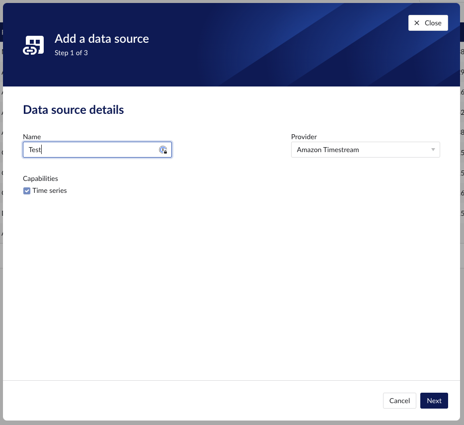

To add an Amazon Timestream data source, in ConfigHub go to Data in the left side menu, then Data sources, choose + Add data source.
Fill out 'Data source details' on the first step of the datasource creation wizard: type name of data source, select “Amazon Timestream” from the Provider dropdown. Time series capability will be checked by default.

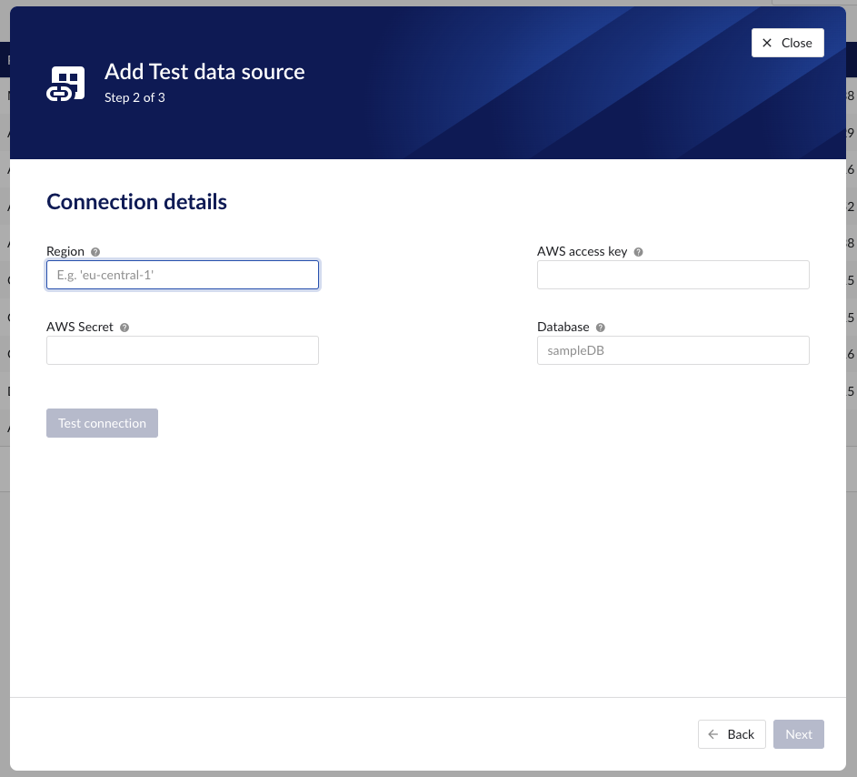

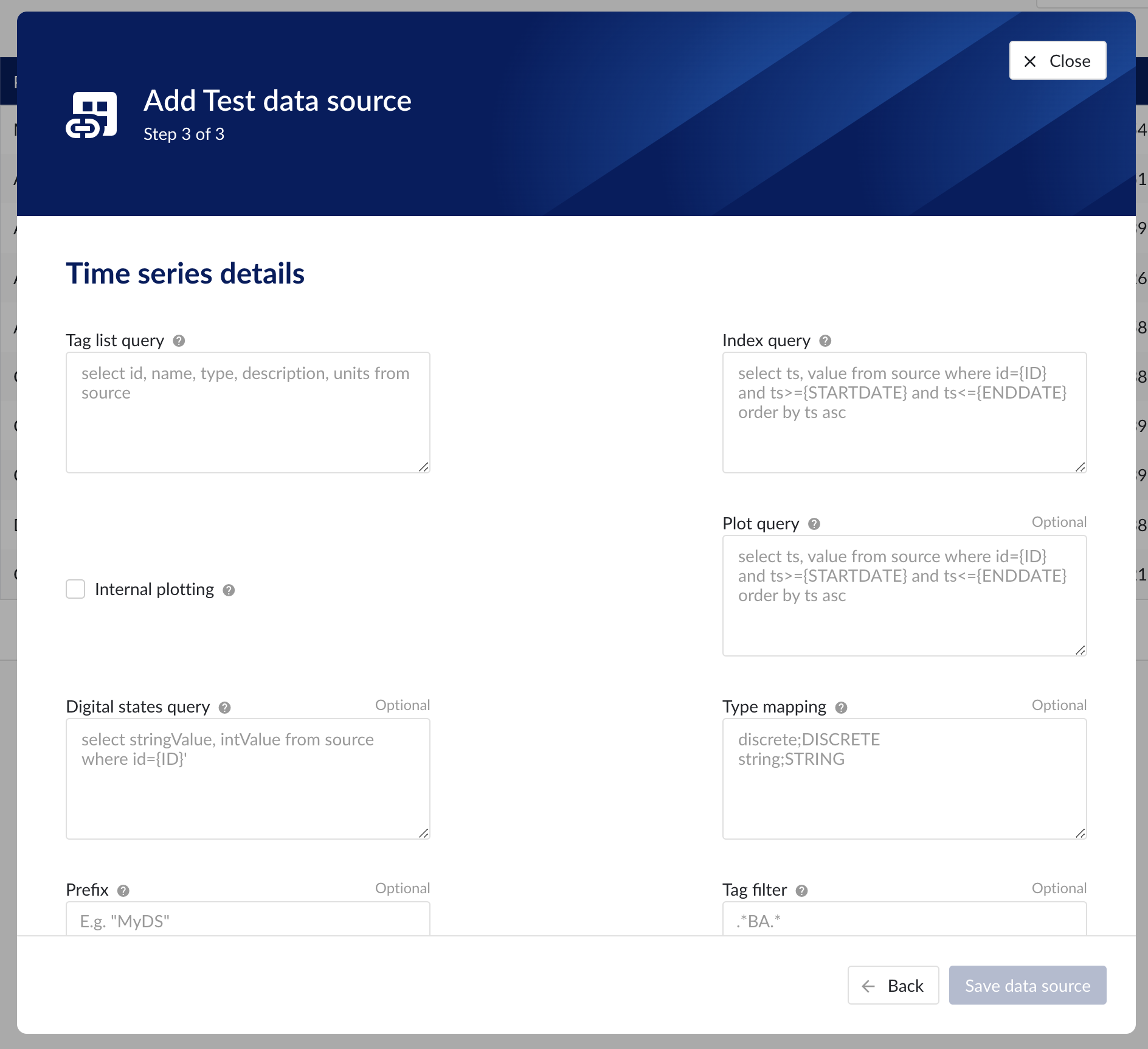

Fill out additional properties, grouped in following sections:
  • Connection details – lists properties related to the configuration of the connection that will be established with Amazon Timestream.
  • Time series details – lists properties relevant for the time series data.
  • "Region" – enter the availability zone region within AWS cloud in which the Amazon Timestream instance is configured. For more information, please consult the AWS Documentation.
  • "AWS access key" – enter the access key to authenticate. This is the access key id as created in AWS IAM.
  • "AWS Secret" – enter the secret to authenticate. This is the AWS secret as created in AWS IAM.
  • “Database” – enter the name of database in Amazon Timestream. This is primarily used to test the connection liveness from TrendMiner to Amazon Timestream.
  • “Index query” - a query used by TrendMiner to ingest timeseries data for a specific tag. The query is expected to return a ts (timestamp) and a value. The following variables are available to be used in the WHERE clause of this query. The variables will be substituted at query execution with values. There should not be any NULL values returned by the SELECT statement so including "IS NOT NULL" in the WHERE clause is strongly recommended.
    1. customTypeA;ANALOG
    2. customTypeB;DIGITAL
    3. customTypeC;DISCRETE
    4. customTypeD;STRING
