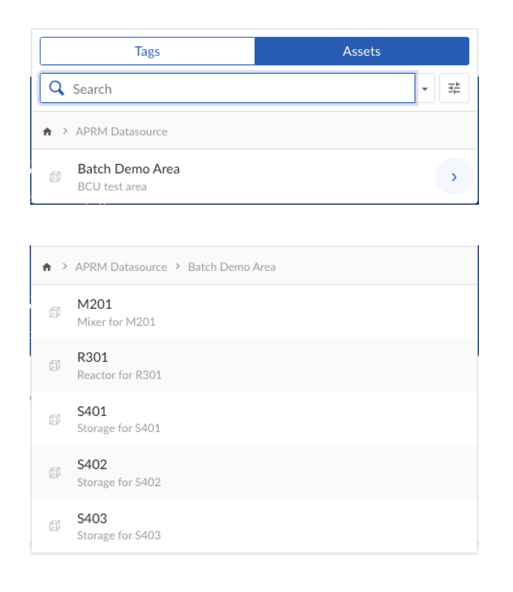

Asset capability

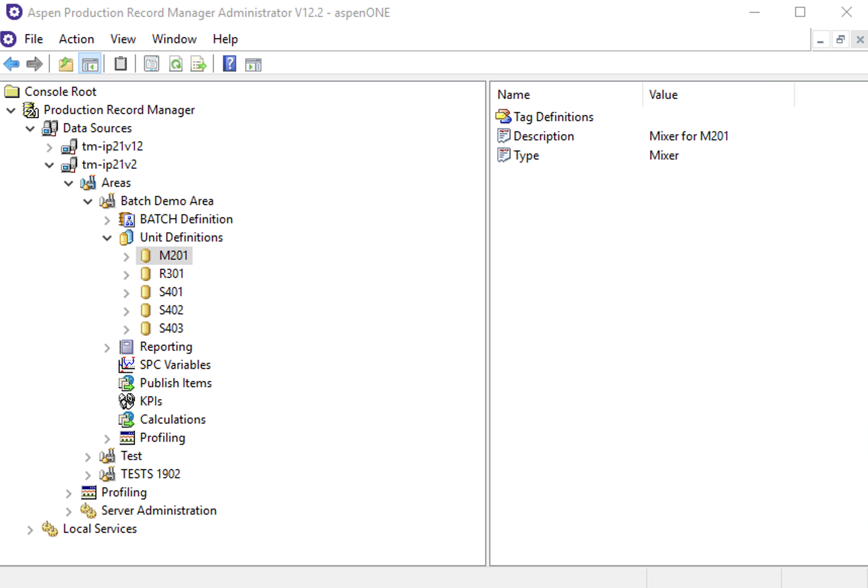

Our provider for Aspen Production Record Manager implements the asset capability and uses data from the area definition to populate the asset hierarchy in TrendMiner. The root node of the asset hierarchy is the area itself. The children nodes of an area node are created using “Unit Definitions".  The asset hierarchy has a fixed depth of two.
Area and Unit Definitions in Aspen Production Record Manager Administrator
Asset hierarchy in TrendMiner

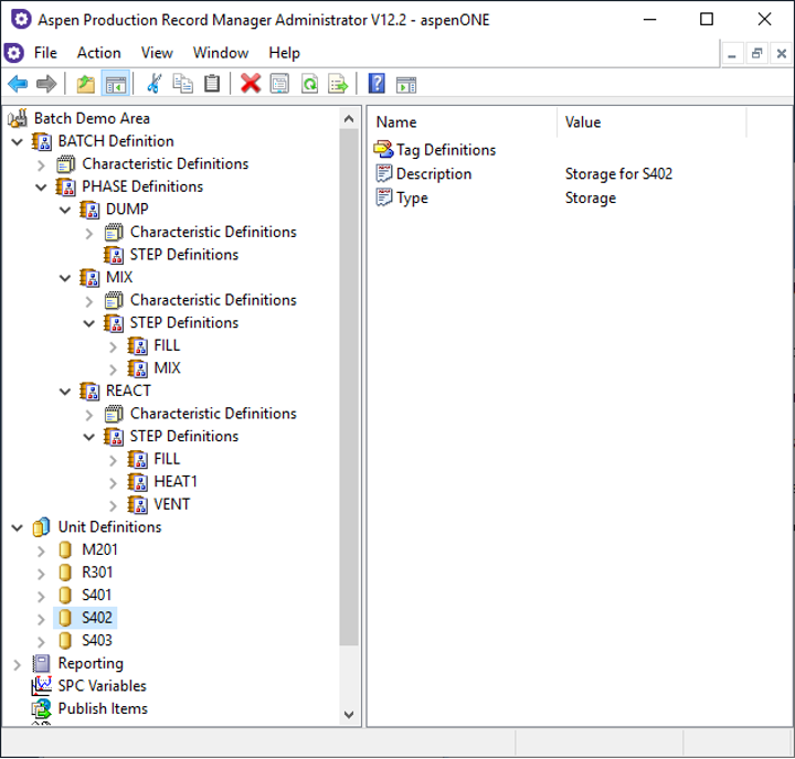

The provider will create Context Item Types for every subbatch definition in the area definition, and that type will be linked to the context items.

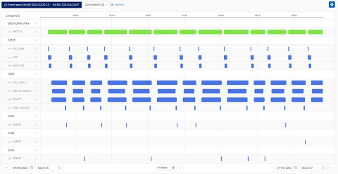

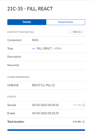

The link between the asset hierarchy and the context items is established using components in TrendMiner. The provider uses the Unit Characteristic from the subbatches of Aspen Production Record Manager to determine the component of a context item. The subbatch level where the Unit Characteristic is defined in Aspen Production Record Manager can be configured by the customer. Since a unit is generally a physical piece of process equipment, every child subbatch of the subbatch level which defines the Unit Characteristic is also conceptually linked to that unit. This is why the following logic is implemented in the provider:
  • If a unit characteristic is defined on the subbatch level of the subbatch, the context item of this subbatch will be assigned to a component that represents the unit.
  • If a unit characteristic is defined on a subbatch level lower than the subbatch - lower level means higher in the ancestor hierarchy, the unit characteristic is inherited from the unit of the ancestor.
  • If a unit characteristic is not defined on a subbatch level lower than the subbatch, the context item will be assigned to a component that represents the area.
This comes into play when the user starts visualizing multiple subbatch levels at once. Together with the possibility to include the children of a component during filtering it would render the following Gantt, without the users knowing which units belong to the area.
Gantt

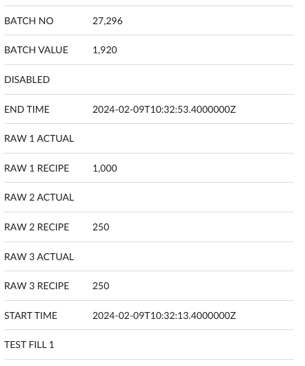

The provider generates Context Item Fields based on the string, numeric, boolean and time characteristics that are available on the subbatches of Aspen Production Record Manager. The existence of characteristics and the level on which they are defined is completely dependent on the configuration of the Subbatch Definition implemented in the environment of the the customer.
Context item fields
Designators

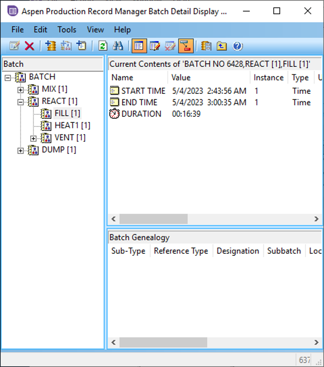

Designators are characteristics that uniquely identify a batch. These characteristics reside on a batch level but the provider makes these characteristics available on every level in the subbatch hierarchy. If ”BATCH NO” is the designator, all the subbatches will also receive “BATCH NO“ as a field.

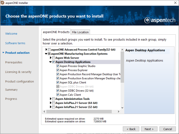

Batch Detail Tool
How to deploy?
AtBatch21ApplicationInterface

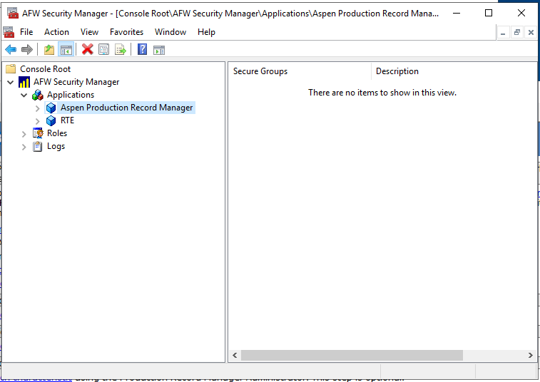

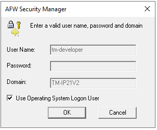

  1. Open Application and Sign-in
    1. Open Windows Start menu and search AFW Security Manager
    2. Fill the User and Password or Use Operating System Logon User by checking the checkbox

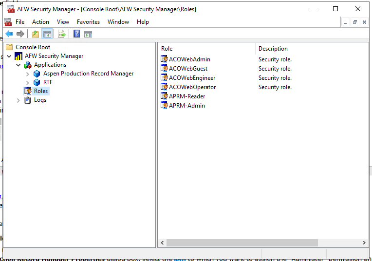

  2. Install role-based security for APRM

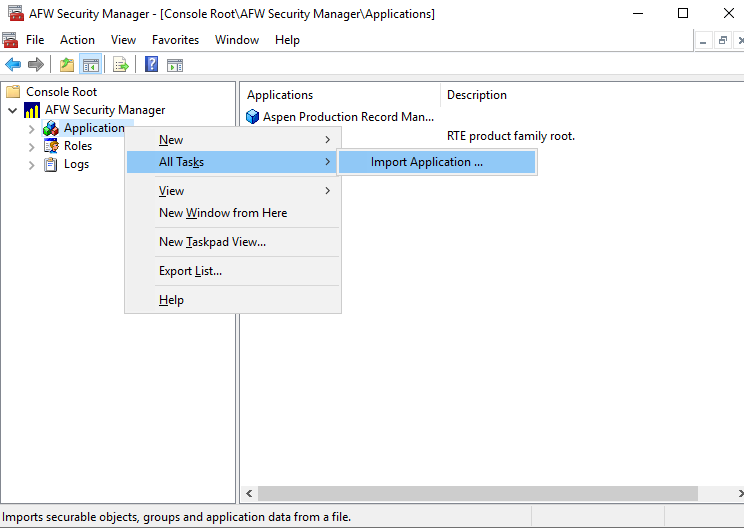

    1. Right-click Application in the left pane of AFW Security Manager and click All Tasks > Import Application
    2. Open Batch21.xml found in C:\Program Files\AspenTech\Batch.21\Server\Setup and APRM is now visible in Applications
      Notice
      The file might be found in a different location. E.g. “C:\Program Files\AspenTech\Production Record Manager\Server\Setup”.
      To add the application manually, please follow the instructions found on APRM documentation in section “Configuring Role-Based Security”.

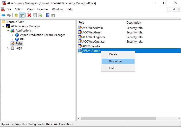

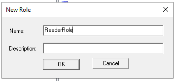

  3. Create Roles

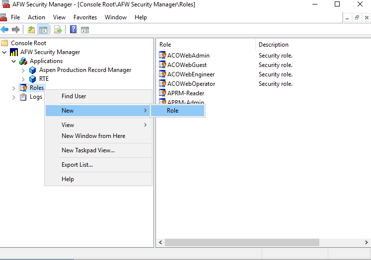

    1. Right-click Roles in the left pane of AFW Security Manager and click New > Role
    2. Fill the desire Name for the role and click Ok
  4. Assign Users to Roles
    1. Click Roles in the left pane of AFW Security Manager and all existing roles should be visible in the content window

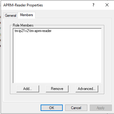

    2. Right-click the role to which to assign the users and click Properties
    3. Navigate to Members tab and click Add to assign users to role
    4. Choose the desired user and click Ok

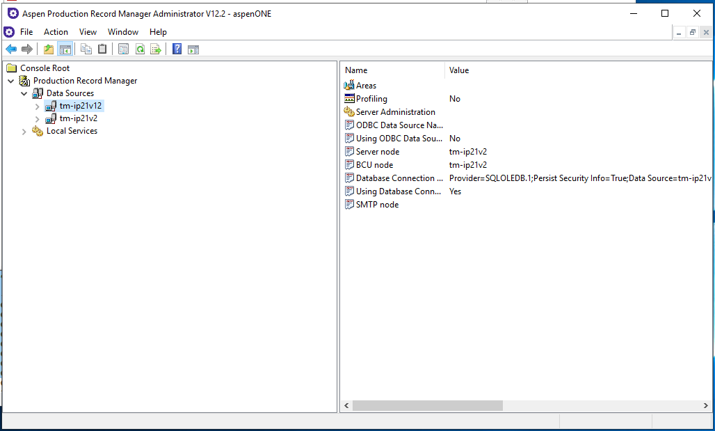

Notice
In case the TrendMiner connector is running on a separate server (not the APRM server) the following steps should be executed on the APRM server.
  1. Open Application
    1. Open Windows Start menu and search Aspen Production Record Manager Administrator

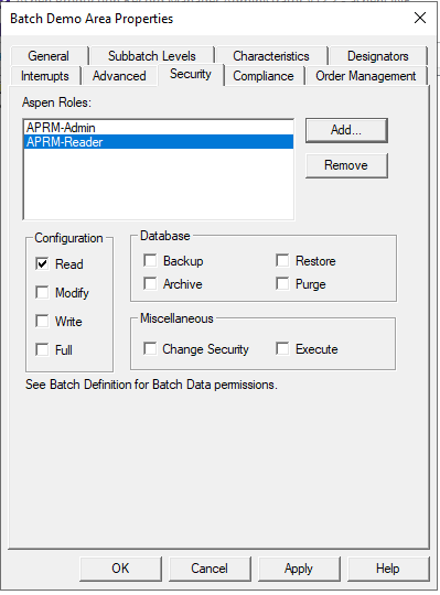

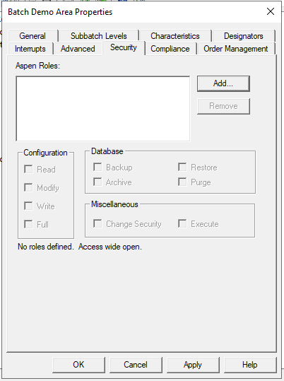

  2. Configure Permissions
    To configure permissions at any level Batch/Subbatch/Characteristic/Report, the method is the same.
    1. Right-click on the level to which to set permissions and click Properties
    2. Navigate to Security tab and click Add to assign a role
    3. Choose the desired role and click Ok
    4. Check the checkbox's of the permissions to assign to the role and click Ok
    At least one role with Change Security permission is mandatory. The members of this role will be able to change security for the current level

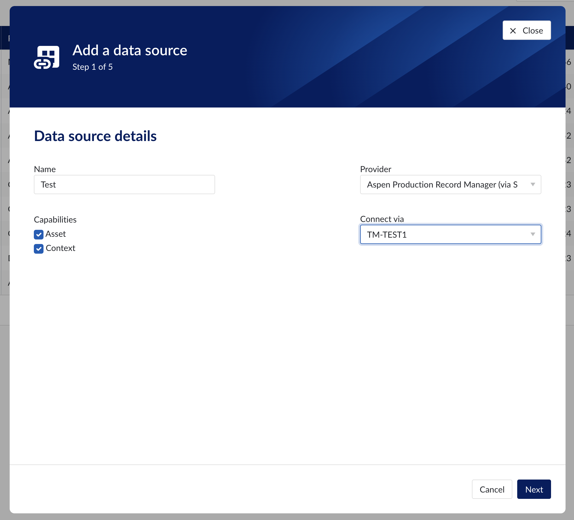

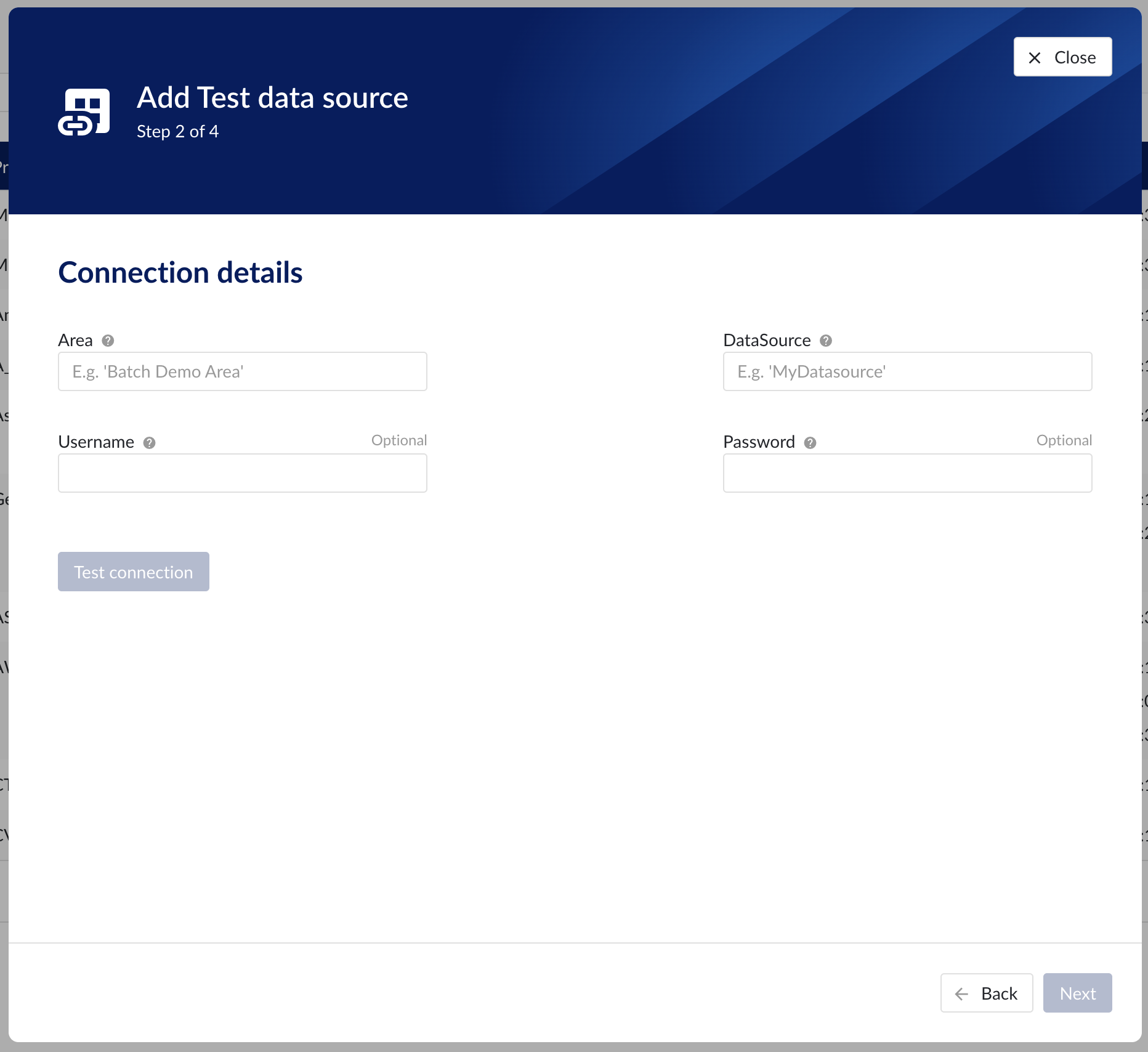

In ConfigHub go to Data in the left side menu, then Data sources, choose + Add data source. Fill out 'Data source details' on the first step of datasource creation wizard: type the name of a data source, select “Aspen Production Record Manager (via SDK)" from Provider dropdown, then select the configured connector from Connect via dropdown.
Connection details
To establish a connection, 4 provider properties need to be filled in:
Property
Required?
Description
Area
true
Name of the area inside a specified DataSource where the provider reads its data.
DataSource
true
Data source used by this provider. The AspenTech Production Record Manager can store multiple data sources on one server instance.
Username
false
Optional convenience field to enter the username used to establish a connection.
Password
false
Optional convenience field to enter the password used to establish a connection.

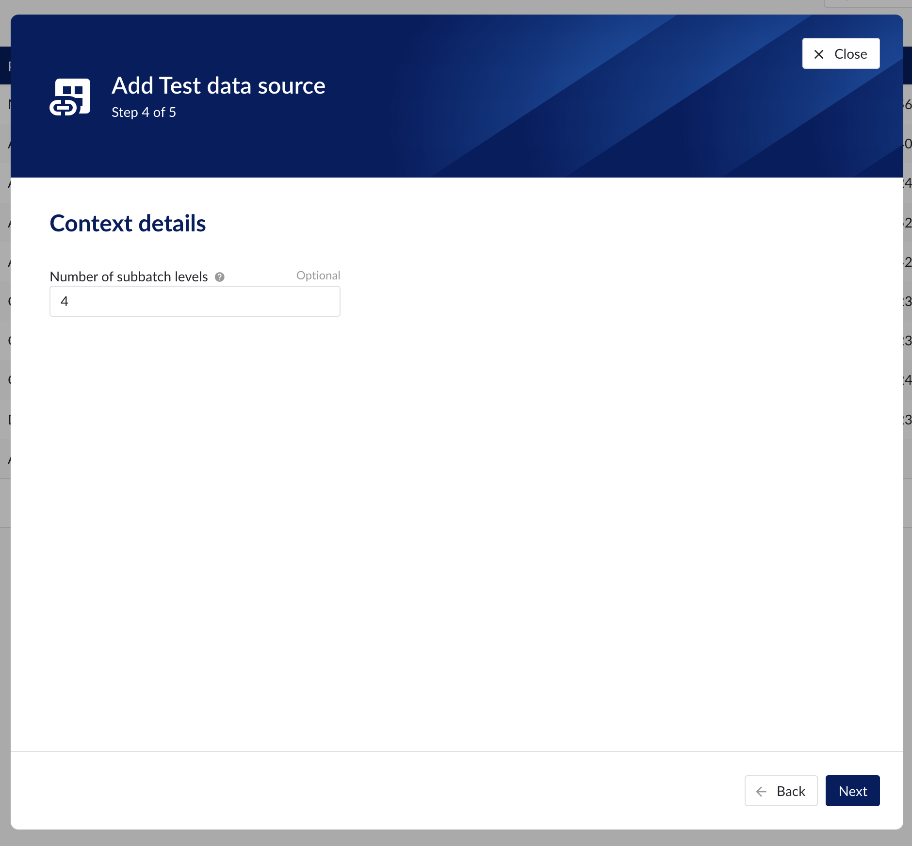

The asset capability does not require any additional properties to be configured. The context capability has following optional property to configure:
Property
Required?
Description
Number of subbatch levels
false
Override the number of subbatches to read from the area. This must be a number between (inclusive) 1 and 5. By leaving this property empty, all the levels defined in the area are included (APRM has a limit of 5 levels).
Context details step in datasource creation wizard
