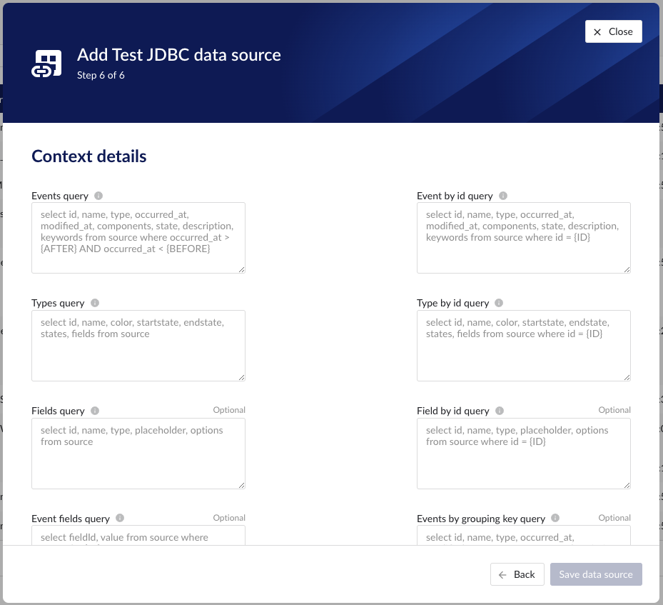

Following properties need to be entered to enable context capability:
  • "Events query" - this query is responsible for returning events from the source database. Context items will be generated based on these events. {AFTER} and {BEFORE} placeholders can be used in the query. They will be replaced with values received in the API call. Additional Event fields query will be executed to populate custom field values for a specific event. The order of the columns in the result needs to be:
    • id. Required, unique identifier for this event record.
    • name. Required, name for this event record.
    • type. Required, event type id. Full information about event type will be fetched in Type by id query.
    • occurred_at. Required, timestamp when the event has occurred.
    • modified_at. Required,  timestamp when the event was modified.
    • components. Required, list of component (asset) ids separated by the Delimiter (',' by default).
    • state. Optional, state for this event record.
    • description. Optional, description for this event record.
    • keywords. Optional, list of keywords separated by the Delimiter (',' by default).
  • "Event by id query" - this query is responsible for returning a specific event from the source database. {ID} placeholder can be used in the query. It will be replaced with the value received in the API call.  Additional Event fields query will be executed to populate custom field values for specific event. The order of the columns in the result needs to be:
  • "Types query" - this query is responsible for returning a list of possible event types from the source database. The order of the columns in the result needs to be:
    • color. Optional, color for this event type record. It will be used in the Gantt chart view of the ContextHub.
    • startstate. Optional, name of the start state.
    • endstate. Optional, name of the end state.
    • states. Optional, list of possible states separated by the Delimiter (',' by default).
    • fields. Optional, list of custom field definition ids for this event record separated by the Delimiter (',' by default).
  • "Type by id query" - this query is responsible for returning an event type from the source database. {ID} placeholder can be used in the query. It will be replaced with the value received in the API call. The order of the columns in the result needs to be:
    • name. Required, unique identifier for this event record.
  • "Fields query" - this query is responsible for returning a list of possible custom fields from the source database. The order of the columns in the result needs to be:
    • id. Required, unique identifier for this field record.
    • name. Required, name for this field record.
    • type. Required, possible values:
      • STRING
      • NUMERIC
      • ENUMERATION
    • placeholder. Optional, placeholder will be displayed in the ContextHub event creation form.
    • options. Optional, if type is ENUMERATION this value is required. A list of possible values separated by the Delimiter (',' by default).
  • "Field by id query" - this query is responsible for returning a custom field from the source database. {ID} placeholder can be used in the query. It will be replaced with the value received in the API call.  The order of the columns in the result needs to be:
      • STRING
      • NUMERIC
      • ENUMERATION
  • "Event fields query" - this query is responsible for returning custom field values for specific event. {ID} placeholder can be used in the query. It represents an event id and will be replaced with the value received in the API call.  The order of the columns in the result needs to be:
    • fieldId. Required, unique identifier of custom field definition (provided in the Fields query).
    • value. Required, field value.
  • "Events by grouping key query" - this query is responsible for returning event(s) with the same grouping key from the source database . {GROUPINGKEY} placeholder can be used in the query. It will be replaced with values received in the API call. The order of the columns in the result needs to be:
  • "Events Sort column" - column name that will be used for sorting and paging of the events. If value is not  set, "id” column will be used by default.
  • "Events sort column DataType"  - the data type of Events sort column. Possible values are: Text, Numeric, DateTime. If value is not set, 'Text' value will be used by default.
  • "Events id column DataType"  - the data type of Events id column (used in Event by id query). Possible values are: Text, Numeric, DateTime. If value is not set, 'Text' value will be used by default.

Context capability
Events query
select id, name, type, occurred_at, modified_at, components, state, description, keywords from source where occurred_at > STR_TO_DATE({AFTER}, '%Y-%m-%d %H:%i:%S') and occurred_at < STR_TO_DATE({BEFORE}, '%Y-%m-%d %H:%i:%S')
Event by id query
select id, name, type, occurred_at, modified_at, components, state, description, keywords from source where id = {ID}
Event types query
select id, name, color, startstate, endstate, states, fields from source
Event type by id query
select id,name, color, startstate, endstate, states, fields from source where id = {ID}
Fields query
select id, name, type, placeholder, options from source
Field by id query
select id, name, type, placeholder, options from source where id = {ID}
Event fields linked to event query
select id, name, type, occurred_at, modified_at, components, state, description, keywords, grouping_key from source where grouping_key = {GROUPINGKEY}
