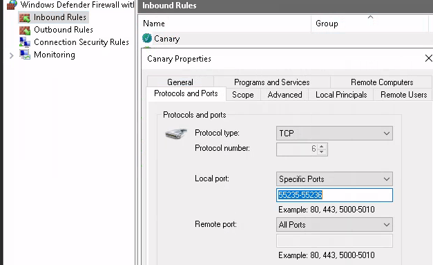

Extra configuration rules for the firewall on the windows server needed:
Rule "File and Printer Sharing (Echo Request - ICMPv4-In)" enabled, this allows the server to be pinged
New Rule with the name "Canary", that allows TCP on port 55236

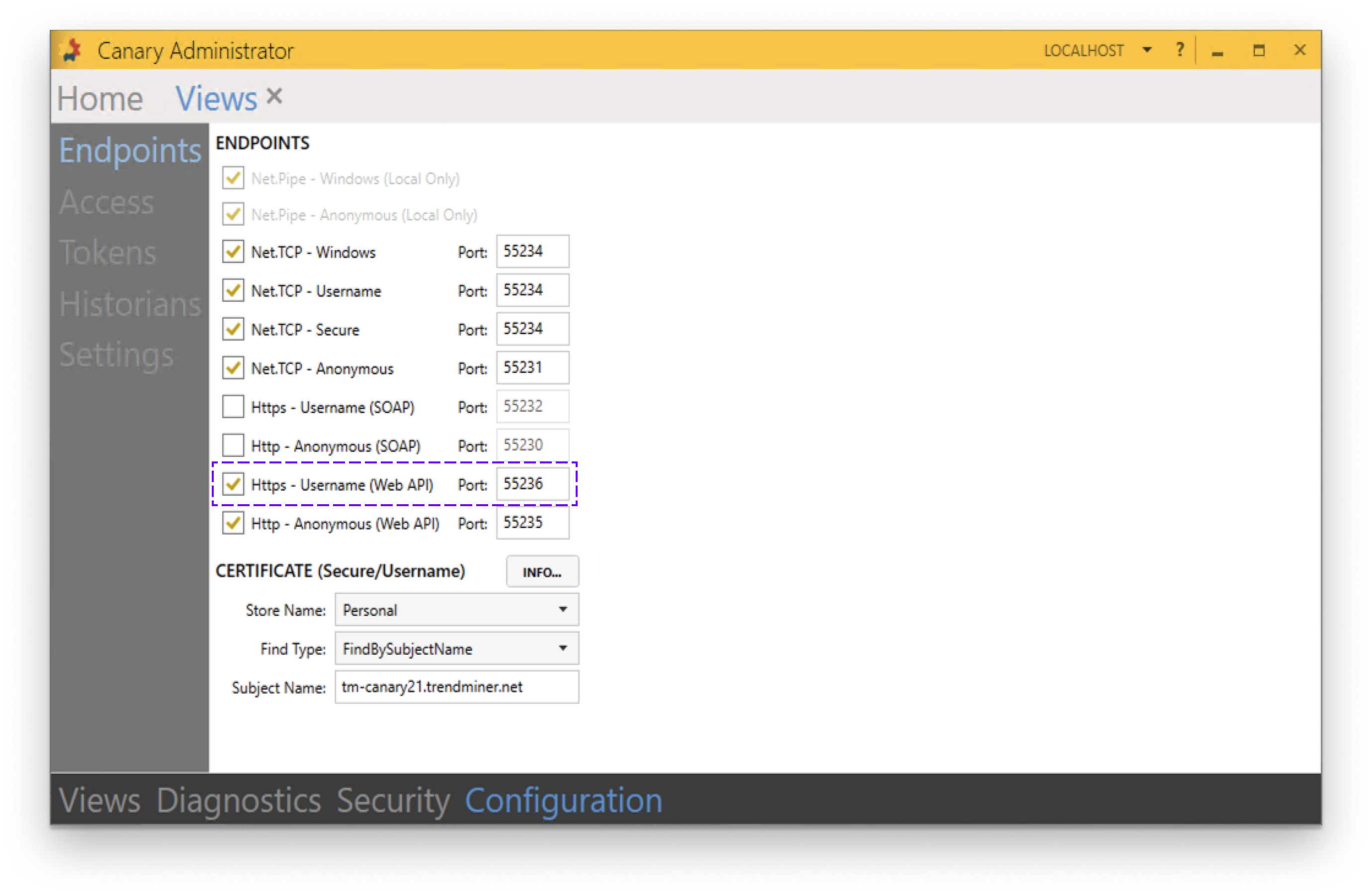

Configure Canary port
Before the API is reachable, the port needs to be opened under the Views section of the Canary admin. In Canary Administrator go to Views (Configuration tab) → Endpoints

To export the certificate in Canary Administrator go to Views (Configuration tab) → Endpoints → CERTIFICATE [INFO…] (button)
Make sure the Subject Name matches the DNS name, otherwise you will get runtime exceptions when using the certificate later on
Do not export private key
Select Base-64 encoded X.509 format

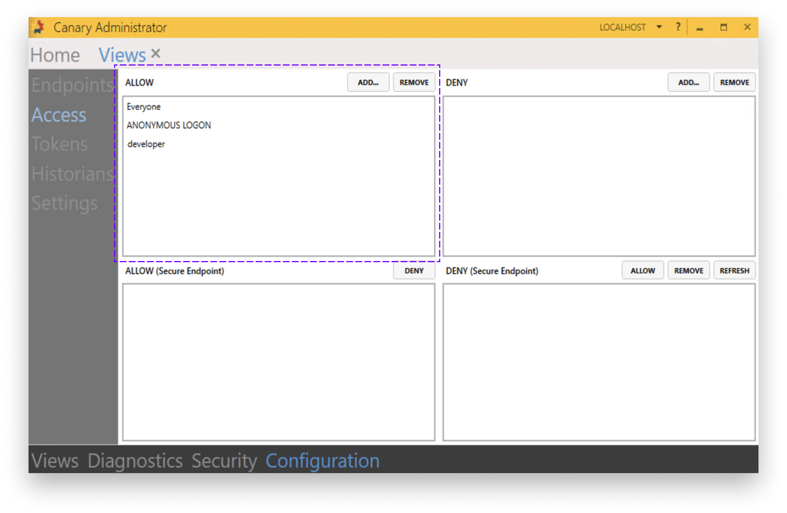

Add your API user to Canary Access tab
To add an API user in Canary Administrator go to Views (Configuration tab) → Access → ALLOW tile → ADD… (button)
