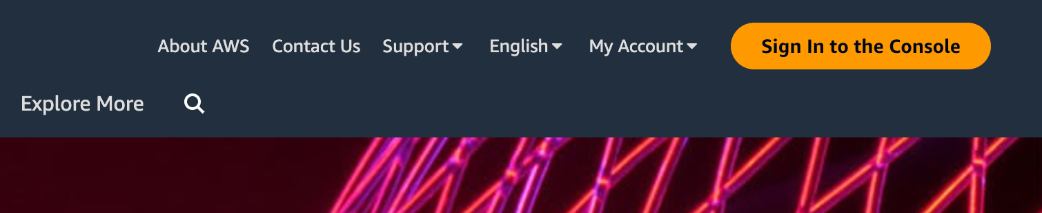

login to your AWS account (https://aws.amazon.com)
Click on “sign in to the Console”

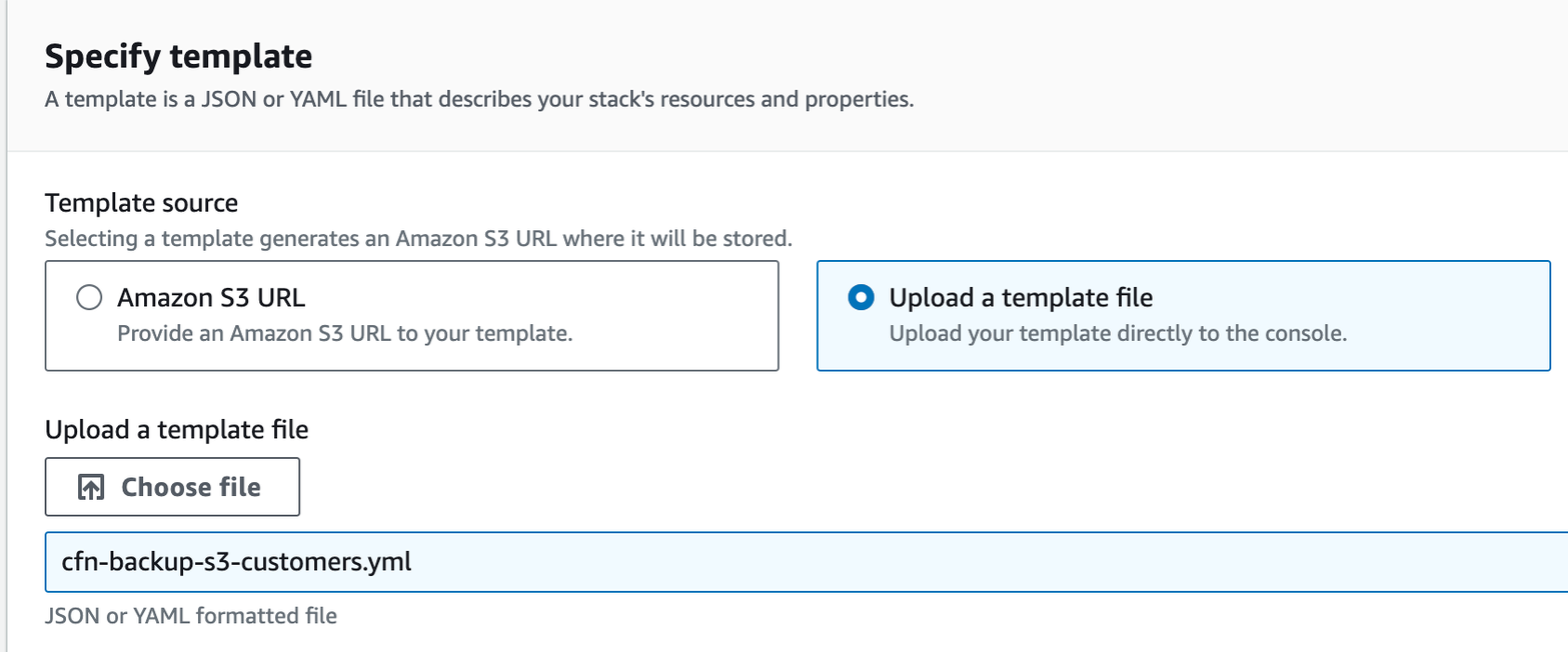

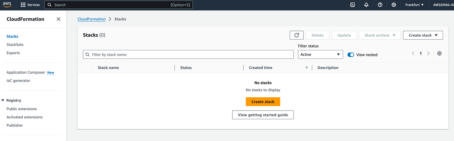

Open CloudFormation, and click on “Create Stack”
Click on “Upload a template file” , then choose the file you have downloaded in the prerequisite step
Click Next

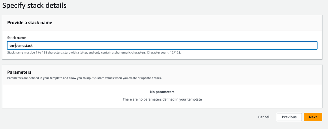

On the “Specify stack details” page fill in the Stack Name
the stack name is used to create the S3 storage and credentials. Please use something meaningful, that you can easily find back like tm-s3backup. The Stackname will also be the name of your bucket. This you will need when configuring Trendminer.

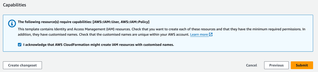

On the “Review and create”
scroll down, read & accept the terms
Click Submit

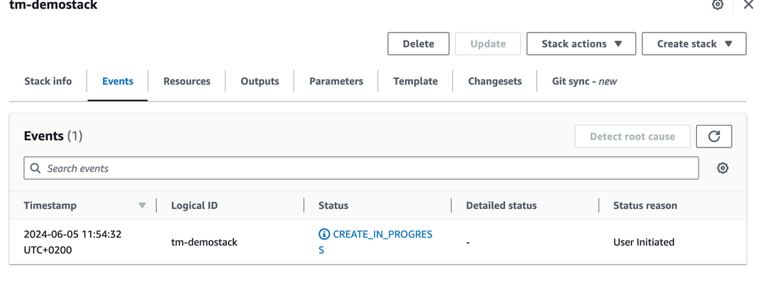

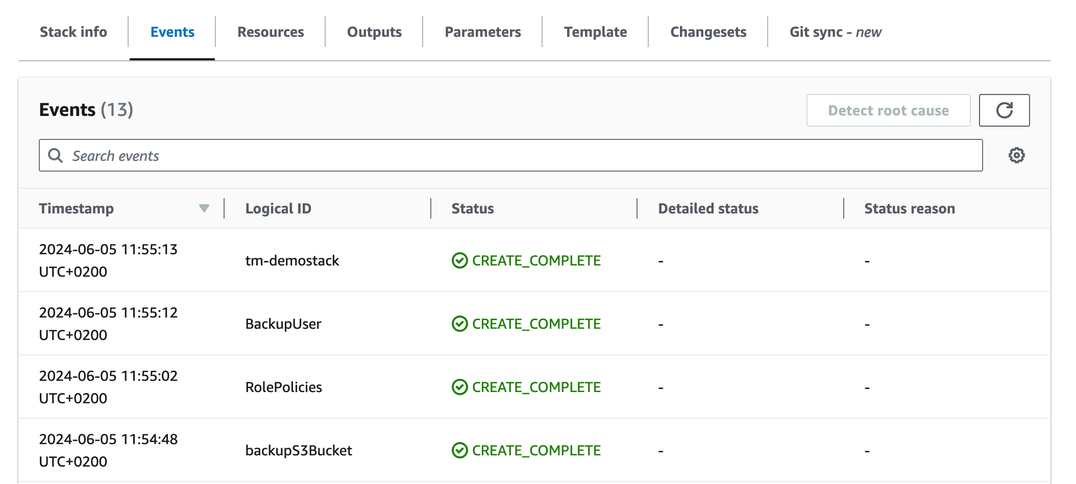

Wait until the Stack is created
you might need to click on the refresh icon, to see the status change.

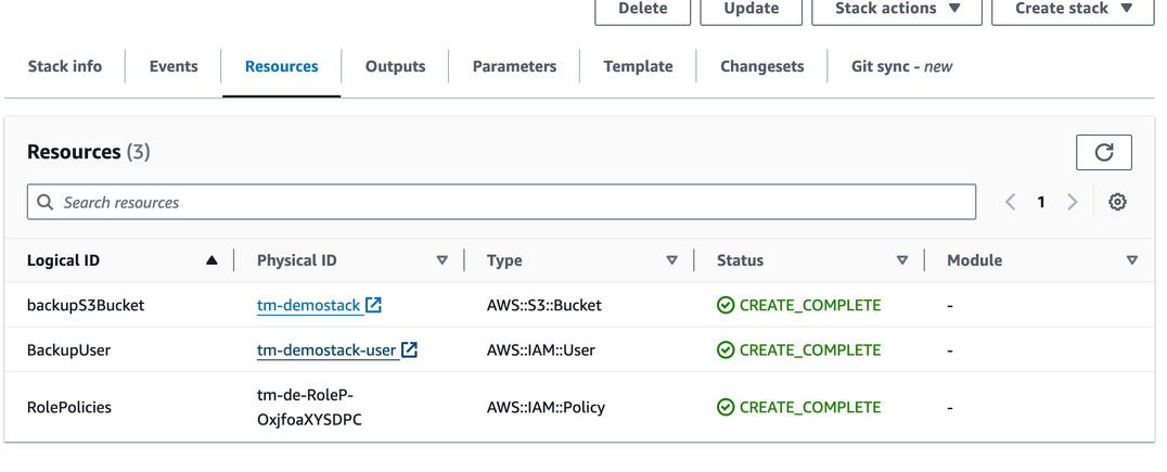

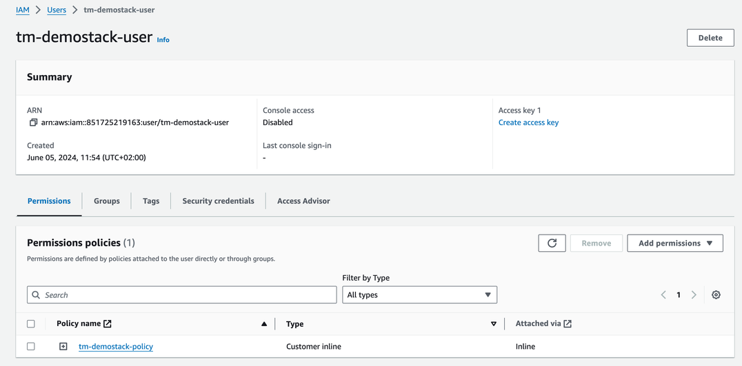

To get your S3 access credentials navigate to Resources and then click on the physical ID link next to BackupUser to open the user details and configure access credentials
you should have been redirected to the IAM User section.

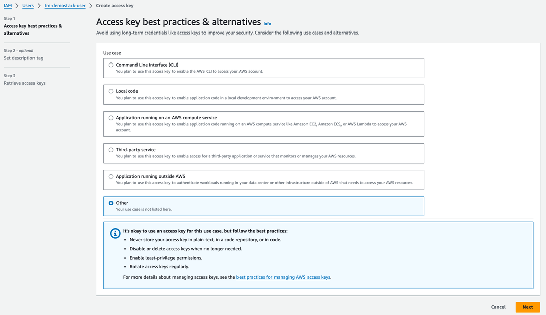

Please create an access key under the "User summary" by clicking on "Create access key" on the right-hand side.
Select Other
Click Next

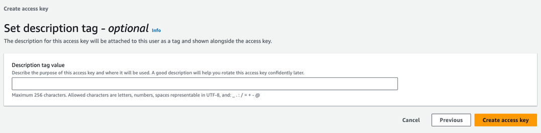

on the “Set description tag” you can optionally specify a tag. After that click “Create access key”
The access key is now visible on the screen. Save the access key information displayed on the screen to a secure location, either by storing it manually or downloading the CSV file and securing it accordingly.

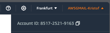

AWS account ID. This information is located in the upper right corner when clicking on your account name, example:

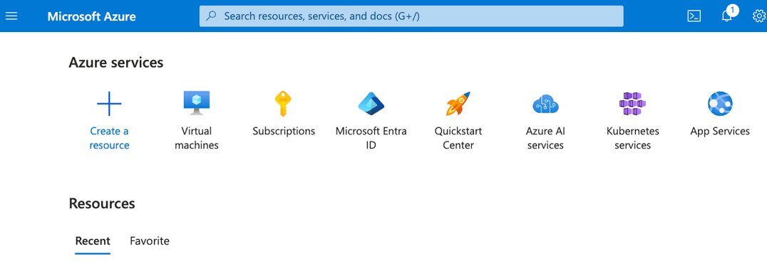

Login to Azure (https://portal.azure.com)
after login, you shall be arriving at the dashboard page, that could look like this:

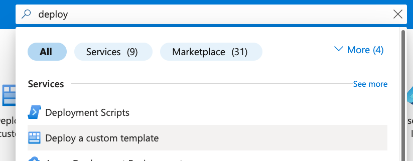

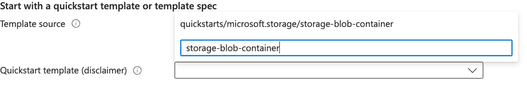

Search for “deploy” in the microsoft search bar, and select “Deploy a custom template” service

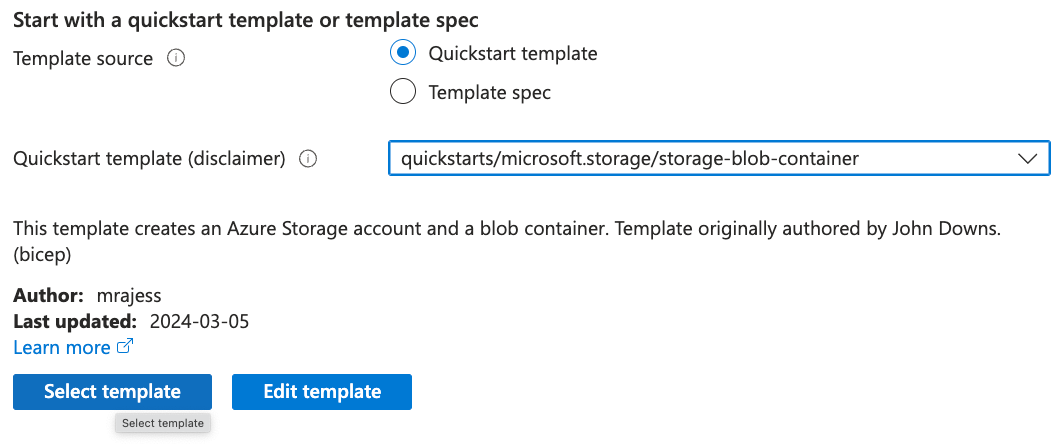

Scroll down and search for the quick start template called “storage-blob-container”
Click on “Select template”

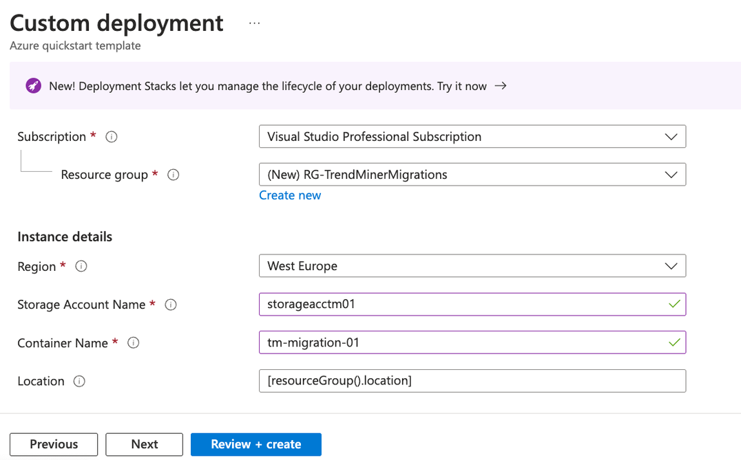

On the Custom Deployment screen, fill in the following information
- Resource group: select a existing one, or create a new one (Take Note for later use)
- Region: select the region where the files need to be saved in. This is best as close as possible to your TrendMiner installation to avoid any delays.
- Storage Account Name: specify a self generated name, that you can easily find back later (Take Note for later use)
- Container Name: Suggest you are using the name of the server you are migrating here. But this field is also open to pick a generic name. (Take Note for later use)
If done, click Review + Create

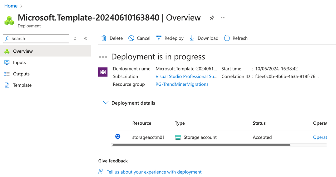

On the last screen (review changes), Click “Create”

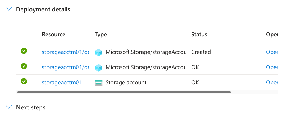

Wait until all actions are done

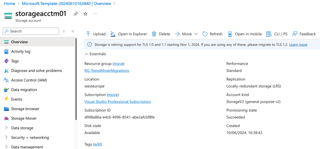

Click open the ‘Deployments details’ and find back the Storage Account.
Click the link left from “Storage account” Type
In this case “storageacctm01”
On the overview page, make note of the “Subscription ID”

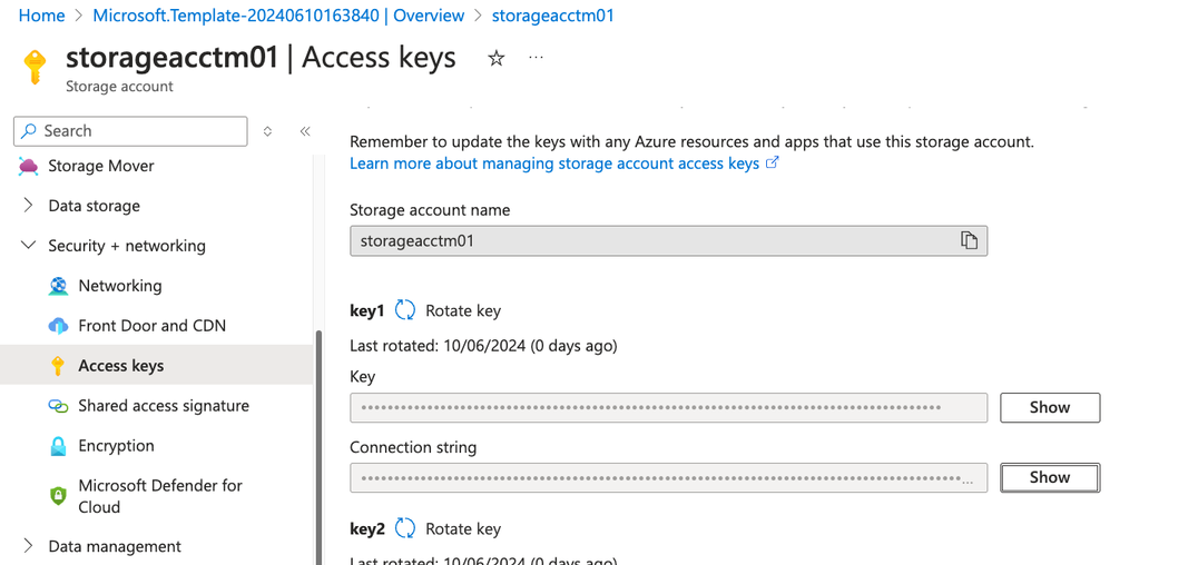

Open Security + Network menu
In the menu at the left of the screen, click on “Security + Networking” and click on “Access Keys”
Retrieve your Access Key by clicking on Show button next to the “Key” Field.
If you plan on rotating your access keys, do not forget to update the TrendMiner Installation with the new access key

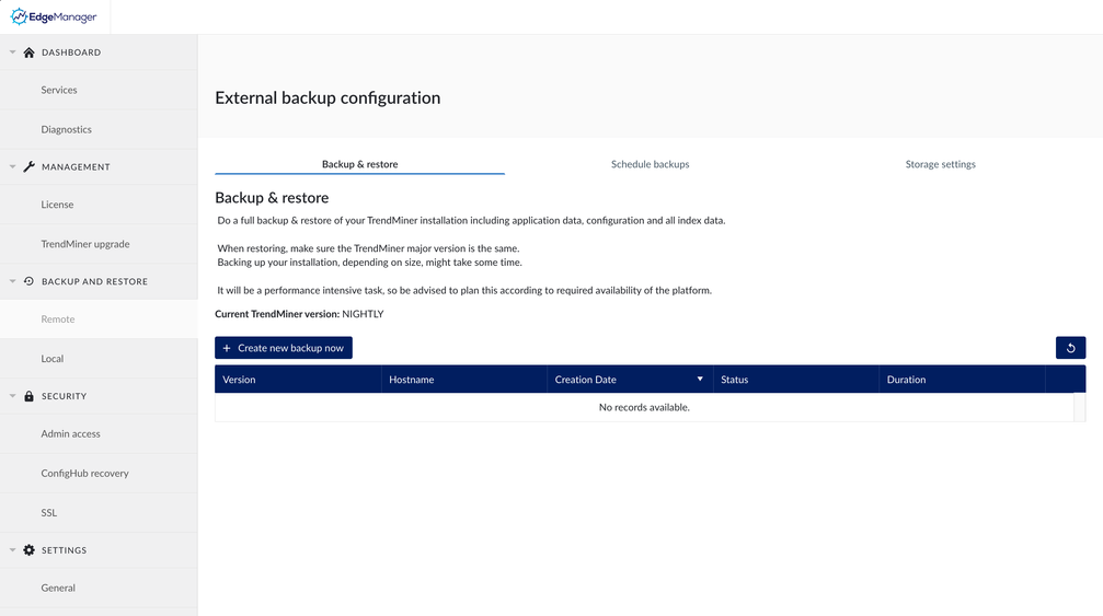

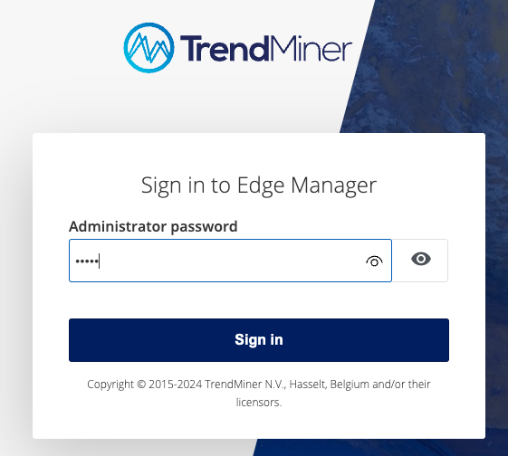

Login to TrendMiner EdgeManager
https://url/edge or http://url:8080 (in case no valid certificate is installed)
Click “Sign In”

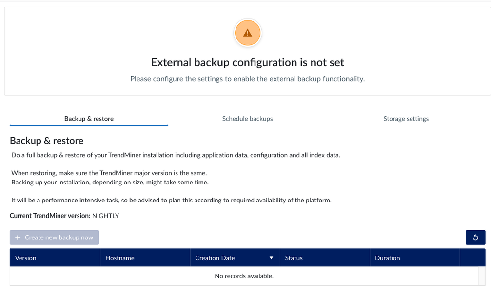

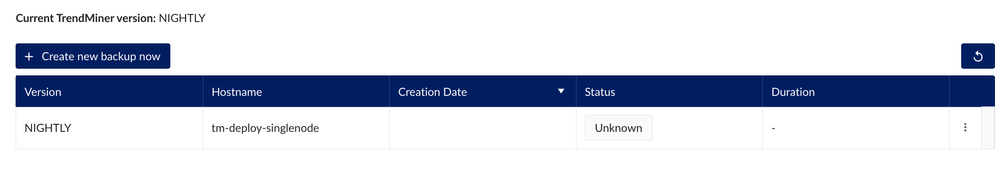

Navigate to “BACKUP AND RESTORE” -> Full
Click on Full

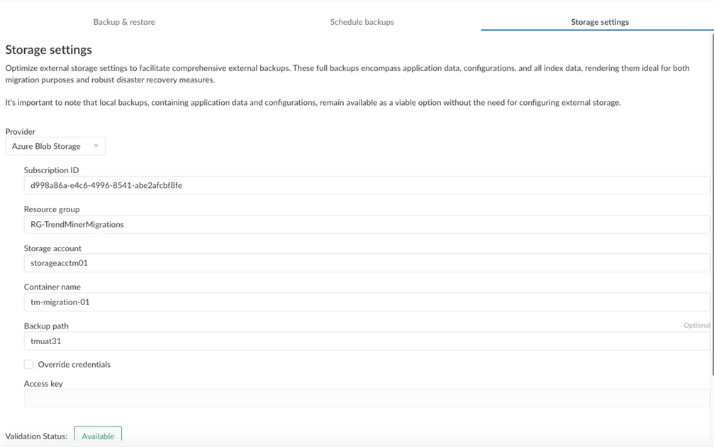

Click on Storage Settings
In this procedure we use Azure Blob Storage, after selecting this, fill in all information required
You should have captured the data from the procedure on how to create a Azure Blob Storage account, except the backup Path.
You can choose a backup path yourself. E.G. name of the server that your are backing up.
One storage account, can be used for multiple TrendMiner Installations, however, it is advised to use at least another backup path to be able to use the same storage account.
There are 4 reasons for this recommendation:
It simplifies backup management for each environment.
It ensures that backups for each environment remain separate, minimising the risk of accidentally restoring from one environment with backups from another.
It streamlines the process of deleting backups specific to an environment.
It prevents scheduled backups from interfering with each other if they are executed simultaneously.
When restoring to a new server, make sure to use the same backup path on the destination server
The configured bucket needs to be empty
Click Save
Wait until storage location is validated
you can click on Storage Settings tab, to refresh the page
The status should say Available before continuing with the next steps.
In case the status is as following

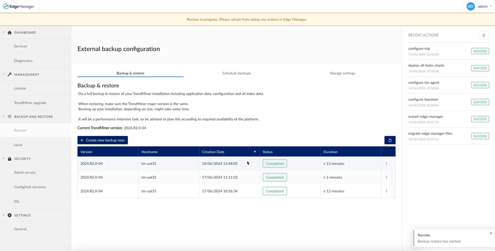

Navigate to “BACKUP AND RESTORE” -> Remote

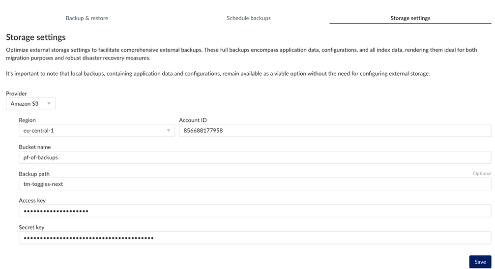

In this procedure we use Amazon S3 (default). After selecting the storage provide you need to fill in all information required, as shown in the screenshot below.
You should be able to fill in all information from the procedure to create the S3 bucket, except for the backup path.
One storage account, can be used for multiple TrendMiner installations, however, it is advised to use at least another backup path to be able to use the same storage account.

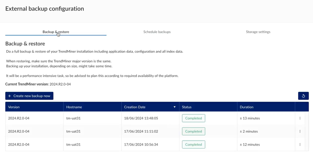

Click Save

Browse to https://url/edge or http://url:8080 (in case no valid certificate is installed)
replace “url” with the url of your TrendMiner installation
Click “Sign In”
Navigate to “BACKUP AND RESTORE”->Remote
A backup will store all your TrendMiner data and settings to be able to recover on the same or another server.
It is advised to run these backups during off peek hours of your TrendMiner installation, as it could result in performance degradation or inform your staff, about potential performance issues. In case needed, the scheduling functionality can be used to plan it accordingly.
A backup will take some time, especially the initial backup, as this will be a full backup. Any backup taken after the initial backup, will be increments from the previous backup, and will be more risk free related to potential performance degradations (depends on the data differences between 2 weeks).
Manual backups time out after 48 hours. Successive incremental backups time out after 4 hours. When a backup process times out the status will be set to 'PartiallyFailed'. In case you run into a timeout please try a manual backup. If that still fails, please contact TrendMiner support.

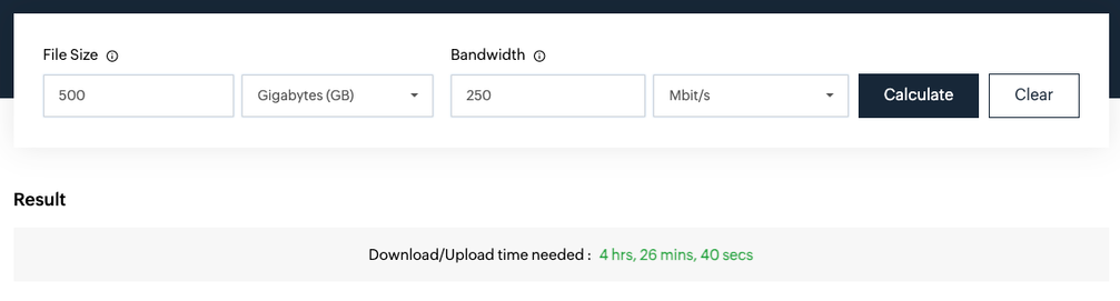

Depending on the size of the backup, and the network upload link to internet, the time it takes can differ.
A quick calculator for this can be found here: Free Download/Upload Time Calculator | Site24x7 Tools
This will not be 100% correct, as there are many other factors involved in uploading to the internet, these can be:
The specified upload speed (bandwidth) below in screenshots 50Mbit/s and 250Mbit/s are most of the time shared with other servers on your network.
Disk performance. If the disks are slow.
Other overhead on the network speed like meta data traffic from the Storage Provider.
some examples can be found here:

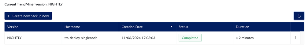

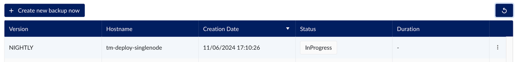

Click on “Create new backup now”
You will see a notification popup in the bottom right corner, that a backup is started.
and you will also see the backup information been triggered, as following:
Click the refresh button
You can see the backup is in progress
after some time, you will see the status change to “Completed” and you can see the time it took, to make the backup.

The setup of the remote storage is completed, and identical to the source server. See here for more info
If you migrate between 2 servers, it is important that the parameters from the source server are exactly the same as on the destination server, to make sure backups can be found back. You can change the backup path later to the new name.
The storage configuration page should look similar to this one, and the validation status should be “Available”

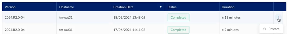

Click on Backup & Restore tab, and you should see the backups taken from the source server here, as in the example below:

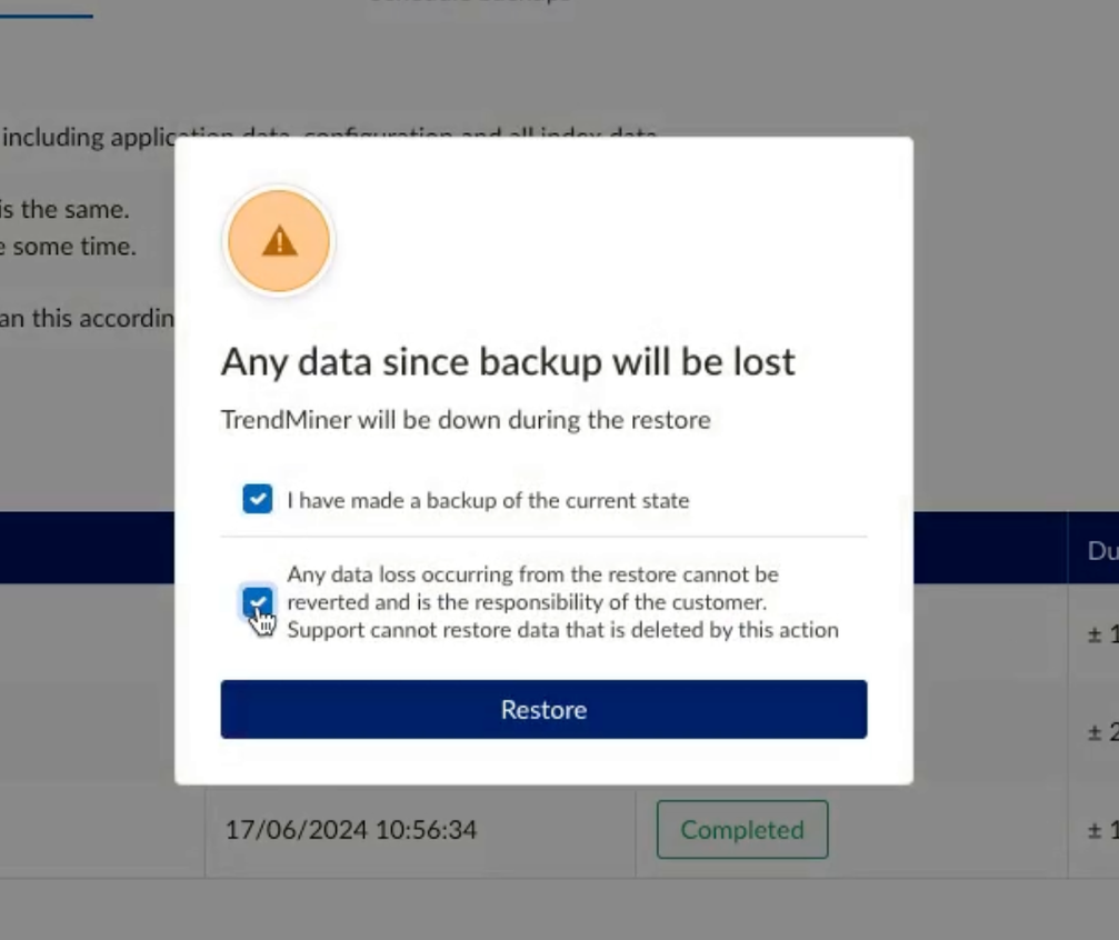

To initiate the restore, click on the 3 dots on the line of the backup you want to restore and then click on Restore:
A popup window will show, warning you about the impact of this restore
As mentioned in the prerequisites, you shall have already taken a backup of the current state using VM snapshot tools.
Click on Restore
Danger
Remember that the restore will wipe any existing data and configurations, and restores it back from the backup.
The status in EdgeManager is changing to Restore in progress.
