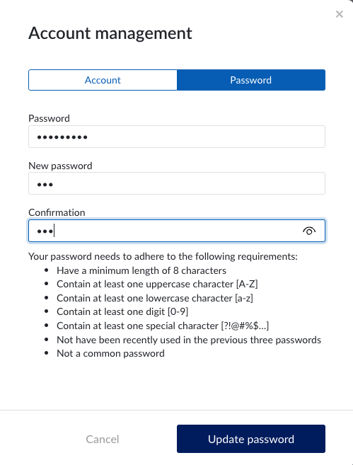

Each user can update his/her password by logging in in any hub and accessing the account management menu in the profile dropdown on the top right:
To update the password select the 'Password' tab in the account management menu:
