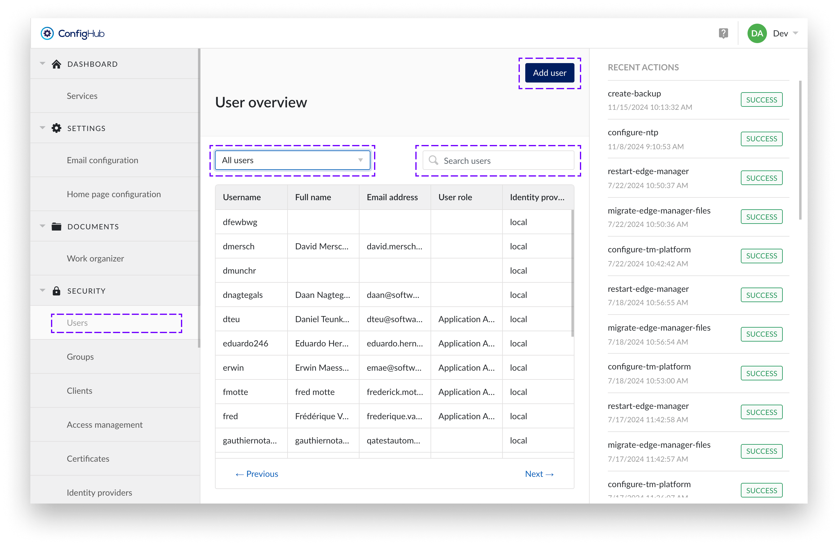

TrendMiner users can either exist locally or via an external Identity Provider. An overview of all users can be found under the "Security" section in ConfigHub.
The user overview displays the username, full name, email address, and identity provider for each user. To find specific users, you can use the search bar. There is also a User Role dropdown filter for narrowing down the list based on roles. It is important to note that you cannot use the search bar and the dropdown filter at the same time.
Creating users
Only local users can be created via ConfigHub. In the case of an external Identity Provider (IdP), the users are synced instead and should be managed via the IdP.
To create users you will need to go to the user-menu under the "security" section. From there users can be added via the "+add user"-button.
You can review a list of user roles to each specific user using the “User role” column in the table.

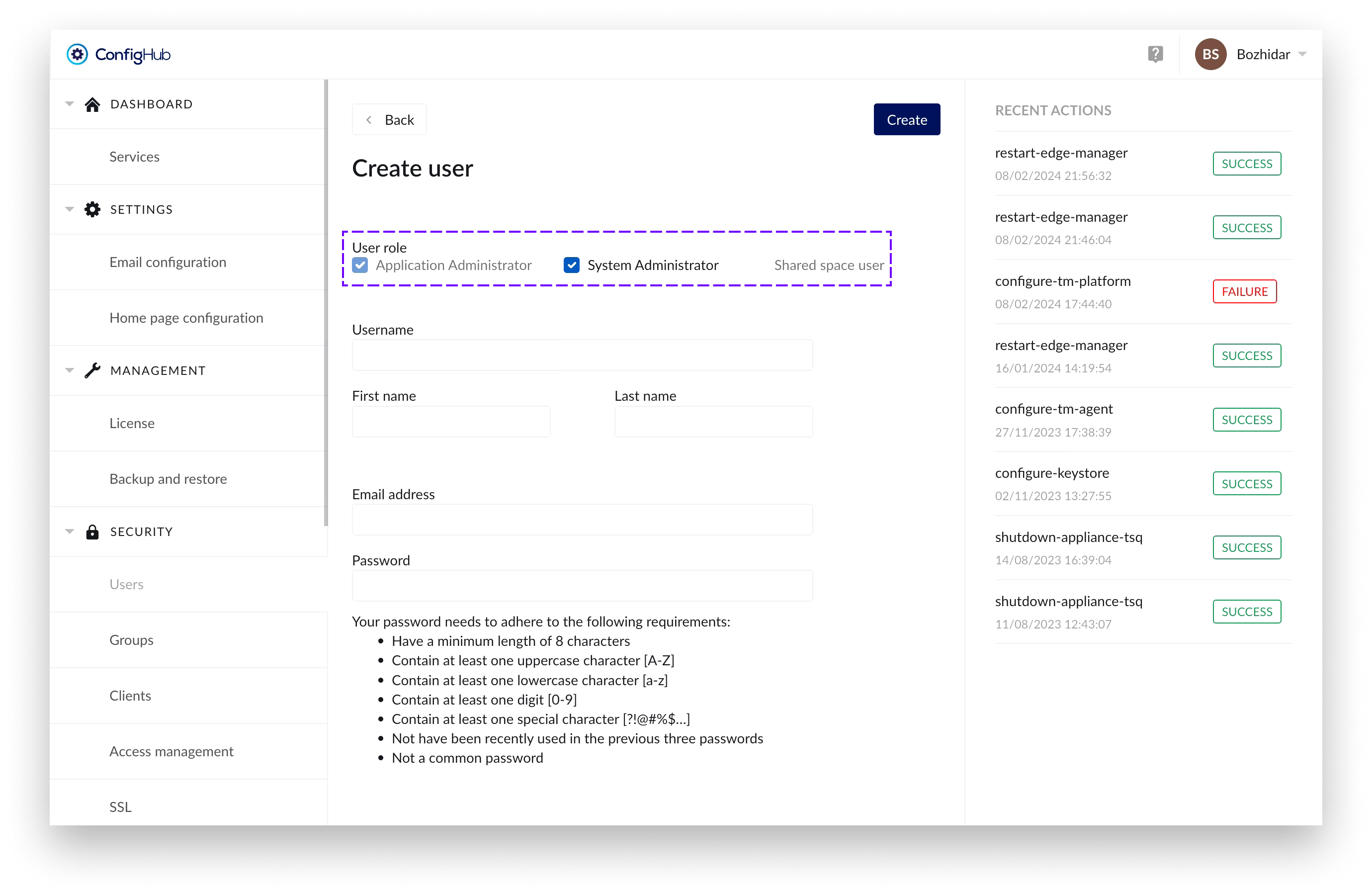

3 roles are available:
Application Administrator: can perform application administrator tasks such as deleting tag indexes or configure asset permissions in ContextHub.
System Administrator: has all permissions an application admin has + can access ConfigHub

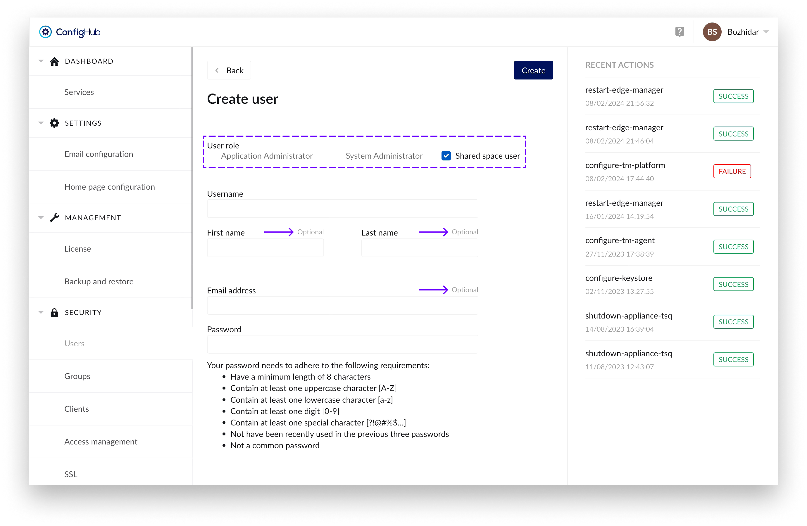

Shared space user:
User with an extended login timeout of 1 year to ensure their usability in shared spaces for displaying dashboards and other content for prolonged periods of time.
Users with this role have the following fields as optional: “First name”, “Last name” and “Email address”.
For security reasons - assigning “Shared space user” role to a specific user would prevent you of assigning any administration role in combination with it.

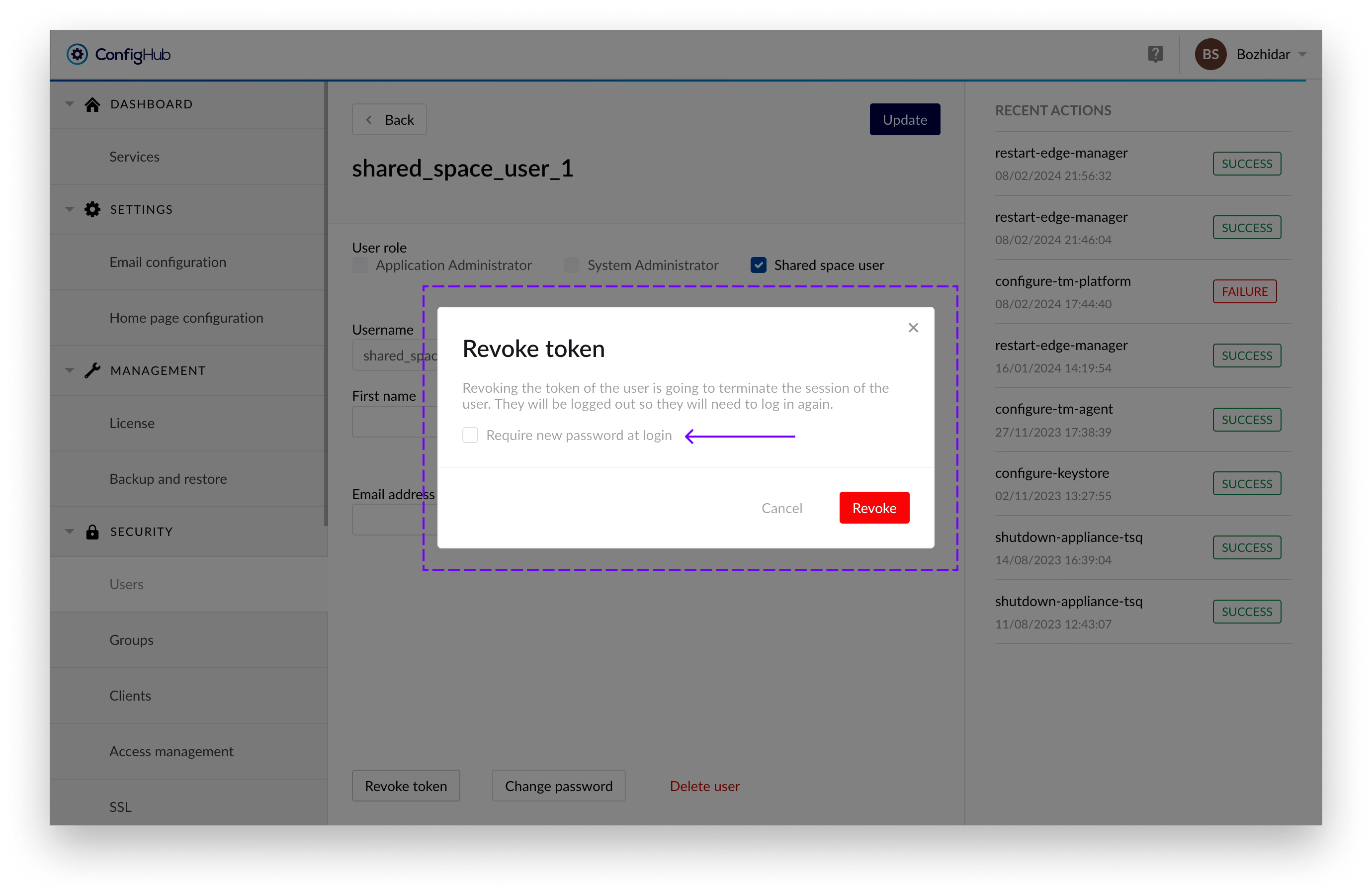

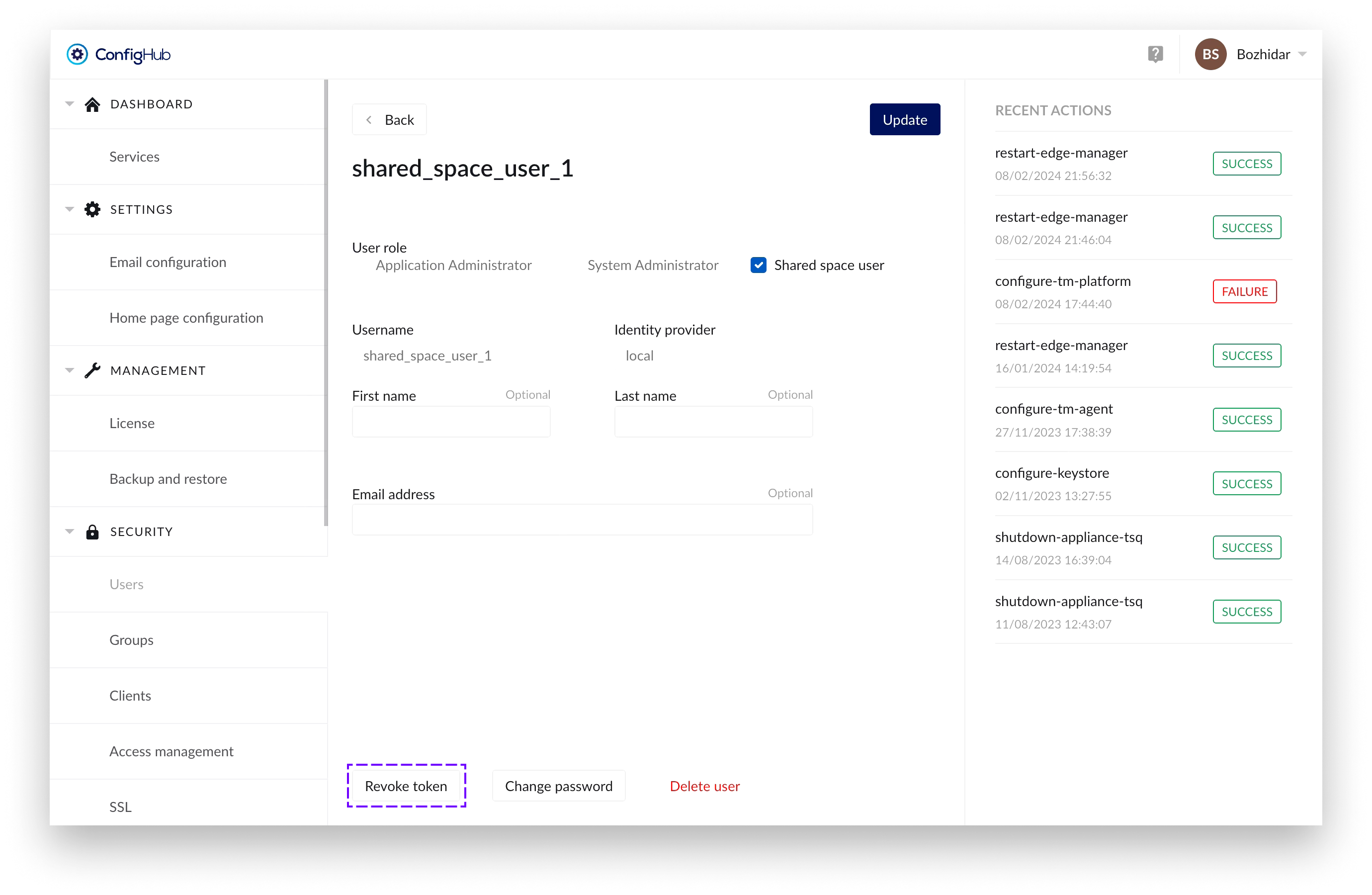

A forceful logout of such users can be initiated by clicking on the “Revoke token” in the “User edit” screen (to which you can navigate by clicking on an already created user in the table):
Once that's done a confirmation dialogue would appear, from where you can also select for the user to have to update his password on next login:
The user can remain logged in for a maximum of 5 minutes after the process has been initiated, after which he will be forcefully logged out.

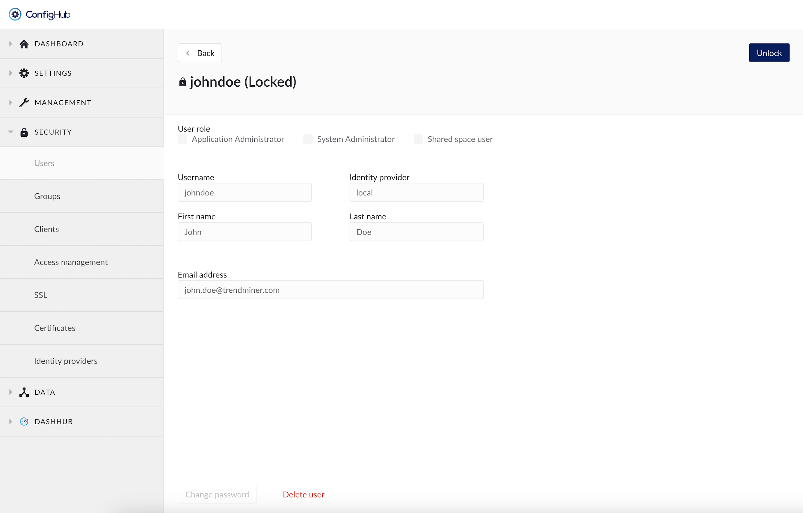

A user account is automatically locked after 10 login attempts using the wrong password. The user itself will not be able to see the difference between entering a wrong password or the access being denied because of a locked account. In both cases a generic error message is shown on the login page: "Invalid username, password or locked account". This is by design for security reasons.
Only users with the system administrator role can access ConfigHub and look up the user account to check if the account is indeed locked. A locked account can be recognised as follows:
A little lock icon in front and the word "Locked" behind the username
An "Unlock" button in the top right
No option to edit the user details or change the password as long as the account is locked
To unlock a user account simply click the "Unlock" button on the top right.
