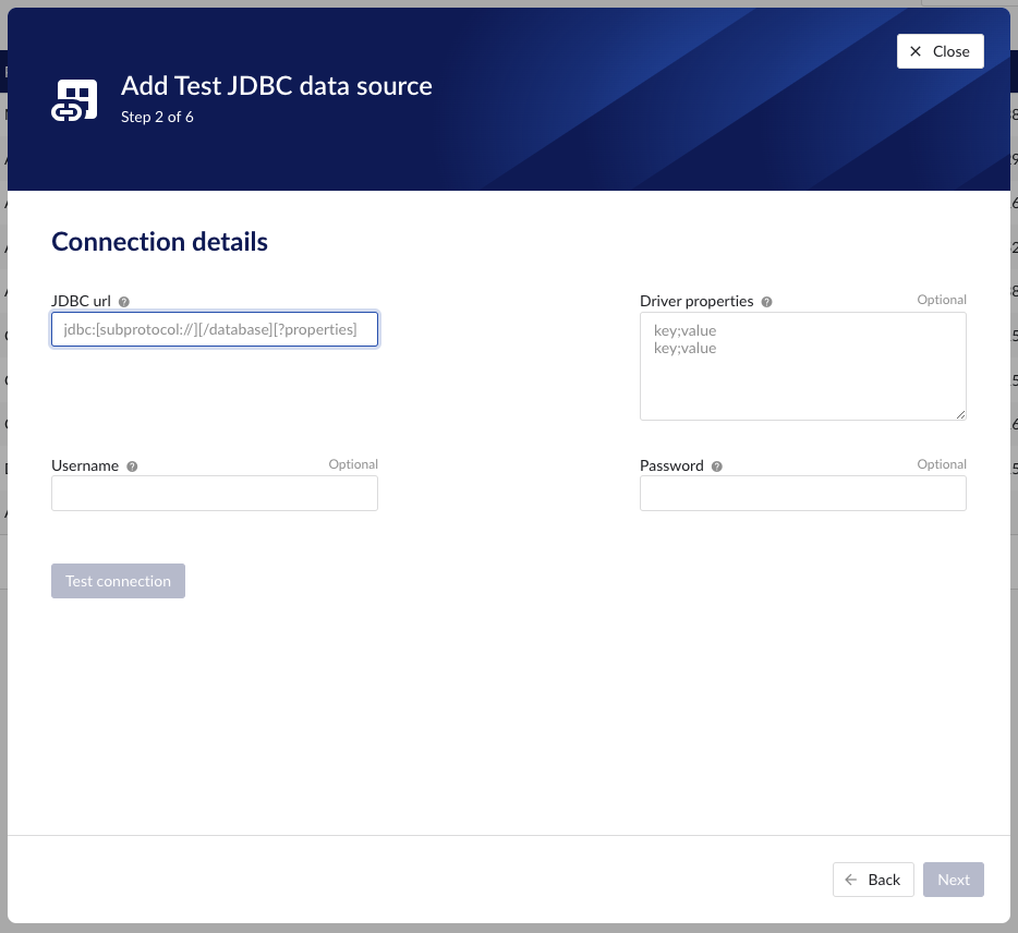

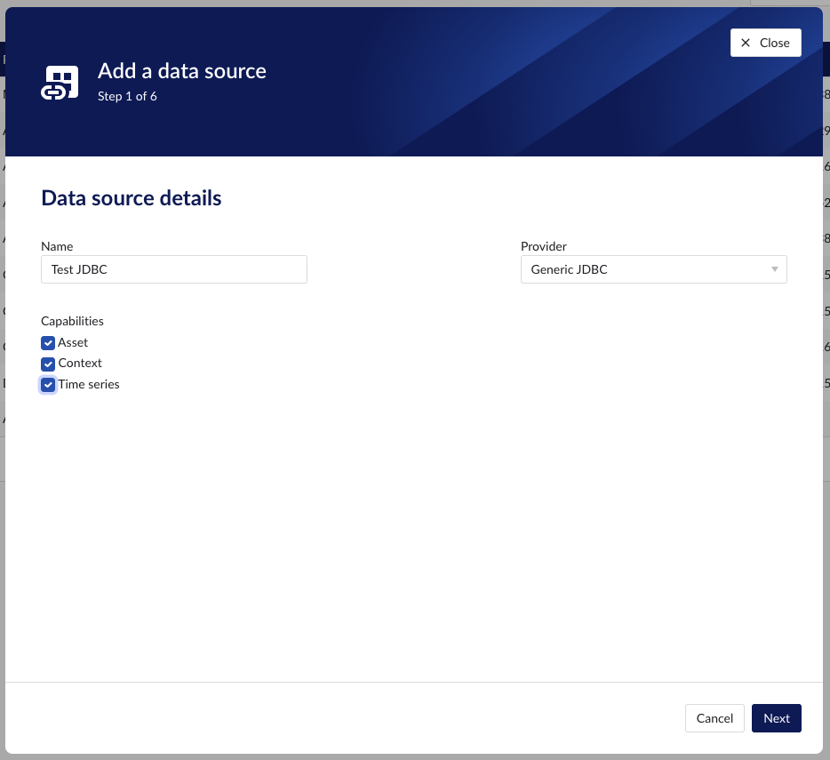

Following properties need to be populated to establish the connection to the JDBC provider:
  • "Provider" - select the option "Generic JDBC" from the dropdown.
  • "Capabilities" - the Generic JDBC provider supports the Time series, Asset and Context capabilities.
  • "JDBC url" - a mandatory JDBC url to establish a connection to.
  • "Driver properties" - additional  optional driver specific properties can be configured here as key;value, where key is the name of driver specific property and value the desired value for this property. Please consult the documentation of the specific JDBC driver for more information.
  • "Username" - optional convenience field to enter the username used to establish a database connection. As an alternative this information can be entered through the driver properties.
  • "Password" - optional convenience field to enter the password used to establish a database connection. As an alternative this information can be entered through the driver properties.

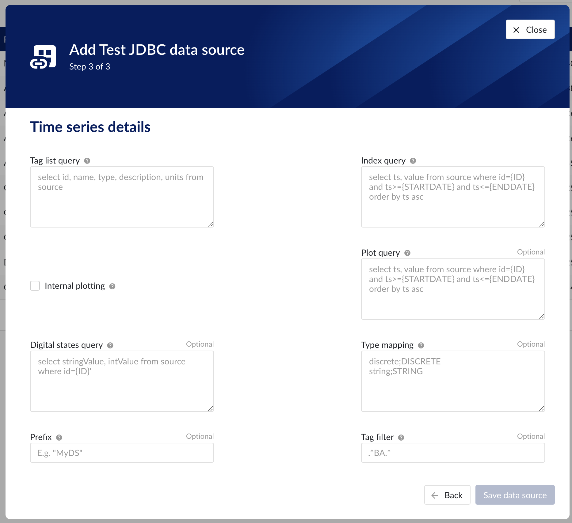

Following properties need to be entered to enable time series capability:
  • “Index query” - a query used by TrendMiner to ingest timeseries data for a specific tag. The query is expected to return a ts (timestamp) and a value. The following variables are available to be used in the WHERE clause of this query. The variables will be substituted at query execution with values. There should not be any NULL values returned by the SELECT statement so including "IS NOT NULL" in the WHERE clause is strongly recommended.
  • “Internal plotting” - if this option is selected TrendMiner will use interpolation if needed to plot the timeseries on the chart on specific time ranges. If this value is not selected and no plot query was provided, TrendMiner will plot directly from the index.
  • “Plot query” – a query used by TrendMiner to plot timeseries data for a specific tag. The query is expected to return a ts (timestamp) and a value. The following variables are available to be used in the WHERE clause of this query. The variables will be substituted at query execution with values. There should not be any NULL values returned by the SELECT statement so including "IS NOT NULL" in the WHERE clause is strongly recommended.
    • {STARTDATE}. TrendMiner will plot data per intervals of time. This denotes the start of such an interval.
    • {ENDDATE}. TrendMiner will plot data per intervals of time. This denotes the end of such an interval.
    1. customTypeA;ANALOG
    2. customTypeB;DIGITAL
    3. customTypeC;DISCRETE
    4. customTypeD;STRING
  • "Datetime format" - optional format your time series data are stored in.
  • "Timezone" – optional timezone your times series data are stored in. Default is "UTC". The format of the timezone is as defined in the IANA time zone database. Valid timezone examples are:
    • "Europe/Brussels"
    • "America/Chicago"
    • "Asia/Kuala_Lumpur"

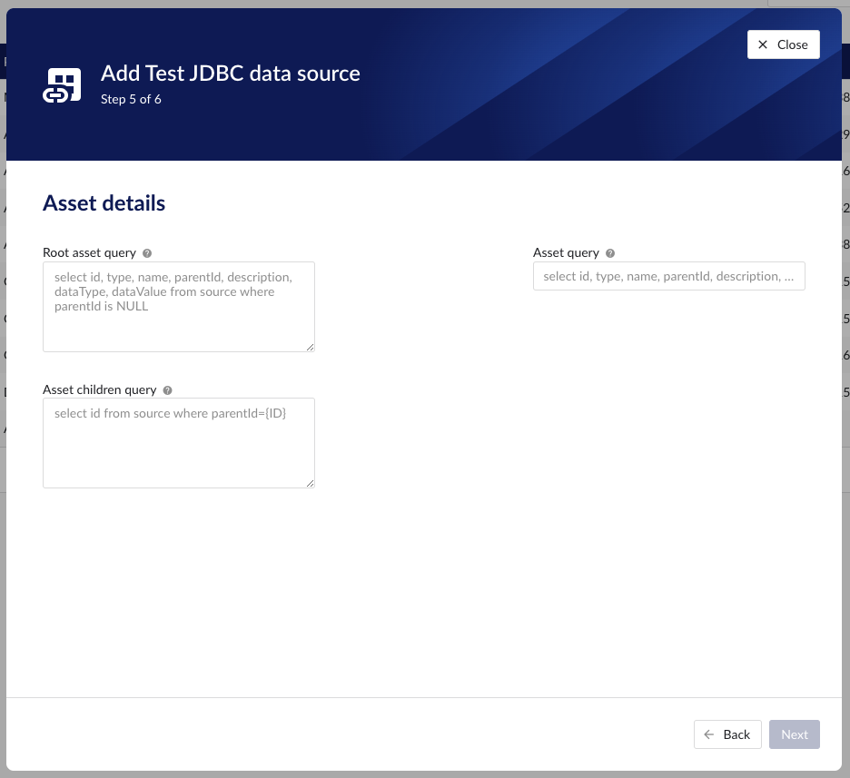

Following properties need to be entered to enable asset capability:
  • "Root asset query" - this query is responsible for returning all top level elements from the asset tree structure. It will be used to traverse further down the tree using to queries below. The order of the columns in the result needs to be:
    • id. Required, unique identifier for this asset record.
    • type. Required, TrendMiner can handle asset of type ASSET or ATTRIBUTE. This column must be one of these two values.
    • name. Required, name for this asset record.
    • description. Optional, description for this asset record.
    • data type. Optional, TrendMiner can ingest 4 different types of data in case the asset is of type ATTRIBUTE. This column will impact on how the data value column will be interpreted:
      • STRING data value is interpreted as text
      • STRING_ARRAY comma delimited string
      • NUMERIC
      • DATA_REFERENCE
    • data value. Optional, this column will either be interpreted as text (STRING), a collection of text (STRING_ARRAY), a number (NUMERIC), or a reference to a tag (DATA_REFERENCE).
  • "Asset query" - this query returns details for a specific asset record. The following variables are available to be used in the where clause of this query. The variables will be substituted at query execution with values:
    • {ID}. The id as the unique asset identification.
      • NUMERIC
      • DATA_REFERENCE
  • "Asset children query" - this query returns the ids of the direct descendants of the asset. The id passed is the parent, the records returned are its child nodes.  The following variables are available to be used in the where clause of this query. The variables will be substituted at query execution with values:

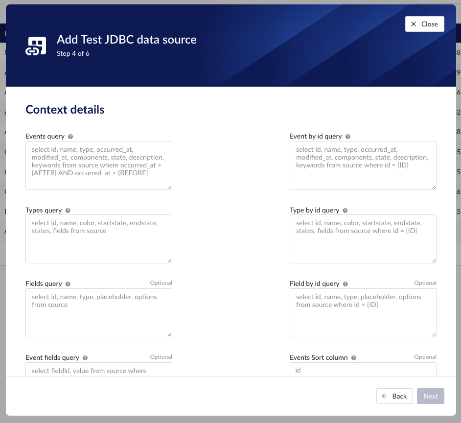

Following properties need to be entered to enable context capability:
  • "Events query" - this query is responsible for returning events from the source database. Context items will be generated based on these events. {AFTER} and {BEFORE} placeholders can be used in the query. They will be replaced with values received in the API call. Additional Event fields query will be executed to populate custom field values for a specific event. The order of the columns in the result needs to be:
    • id. Required, unique identifier for this event record.
    • name. Required, name for this event record.
    • type. Required, event type id. Full information about event type will be fetched in Type by id query.
    • occurred_at. Required, timestamp when the event has occurred.
    • modified_at. Required,  timestamp when the event was modified.
    • components. Required, list of component (asset) ids separated by the Delimiter (',' by default).
    • state. Optional, state for this event record.
    • description. Optional, description for this event record.
    • keywords. Optional, list of keywords separated by the Delimiter (',' by default).
  • "Event by id query" - this query is responsible for returning a specific event from the source database. {ID} placeholder can be used in the query. It will be replaced with the value received in the API call.  Additional Event fields query will be executed to populate custom field values for specific event. The order of the columns in the result needs to be:
    • occured_at. Required, timestamp when the event has occurred.
  • "Types query" - this query is responsible for returning a list of possible event types from the source database. The order of the columns in the result needs to be:
    • color. Optional, color for this event type record. It will be used in the Gantt chart view of the ContextHub.
    • startstate. Optional, name of the start state.
    • endstate. Optional, name of the end state.
    • states. Optional, list of possible states separated by the Delimiter (',' by default).
    • fields. Optional, list of custom field definition ids for this event record separated by the Delimiter (',' by default).
  • "Type by id query" - this query is responsible for returning an event type from the source database. {ID} placeholder can be used in the query. It will be replaced with the value received in the API call. The order of the columns in the result needs to be:
    • name. Required, unique identifier for this event record.
  • "Fields query" - this query is responsible for returning a list of possible custom fields from the source database. The order of the columns in the result needs to be:
    • id. Required, unique identifier for this field record.
    • name. Required, name for this field record.
    • type. Required, possible values:
      • STRING
      • NUMERIC
      • ENUMERATION
    • placeholder. Optional, placeholder will be displayed in the ContextHub event creation form.
    • options. Optional, if type is ENUMERATION this value is required. A list of possible values separated by the Delimiter (',' by default).
  • "Field by id query" - this query is responsible for returning a custom field from the source database. {ID} placeholder can be used in the query. It will be replaced with the value received in the API call.  The order of the columns in the result needs to be:
      • STRING
      • NUMERIC
      • ENUMERATION
  • "Event fields query" - this query is responsible for returning custom field values for specific event. {ID} placeholder can be used in the query. It represents an event id and will be replaced with the value received in the API call.  The order of the columns in the result needs to be:
    • fieldId. Required, unique identifier of custom field definition (provided in the Fields query).
    • value. Required, field value.
  • "Events Sort column" - column name that will be used for sorting and paging of the events. If value is not  set, "id” column will be used by default.
  • "Events sort column DataType"  - the data type of Events sort column. Possible values are: Text, Numeric, DateTime. If value is not set, 'Text' value will be used by default.
  • "Events id column DataType"  - the data type of Events id column (used in Event by id query). Possible values are: Text, Numeric, DateTime. If value is not set, 'Text' value will be used by default.
