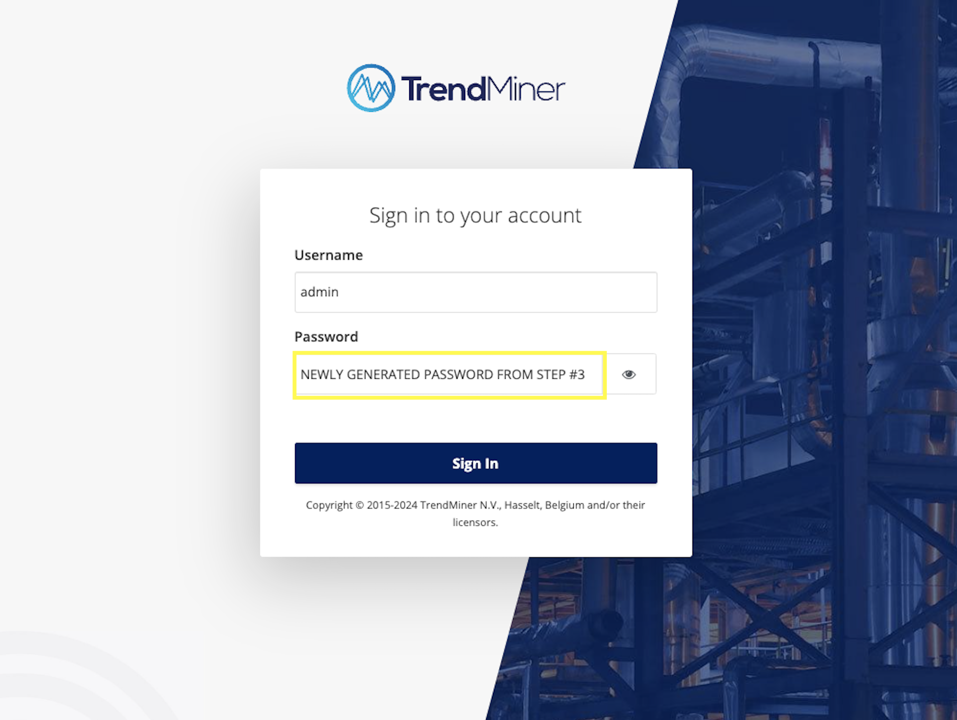

  5. Log in with user 'admin' and the newly generated password you copied from Edge Manager.

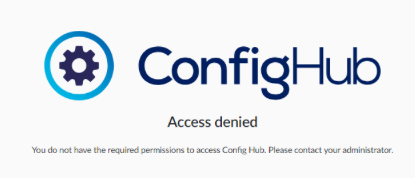

    In case you see an error "ConfigHub - Access denied" this might be because you already logged in with your personal account in TrendHub and your account does not have ConfigHub access permissions yet. If this occurs, please go back to TrendHub and log out and navigate back to ConfigHub to retry.

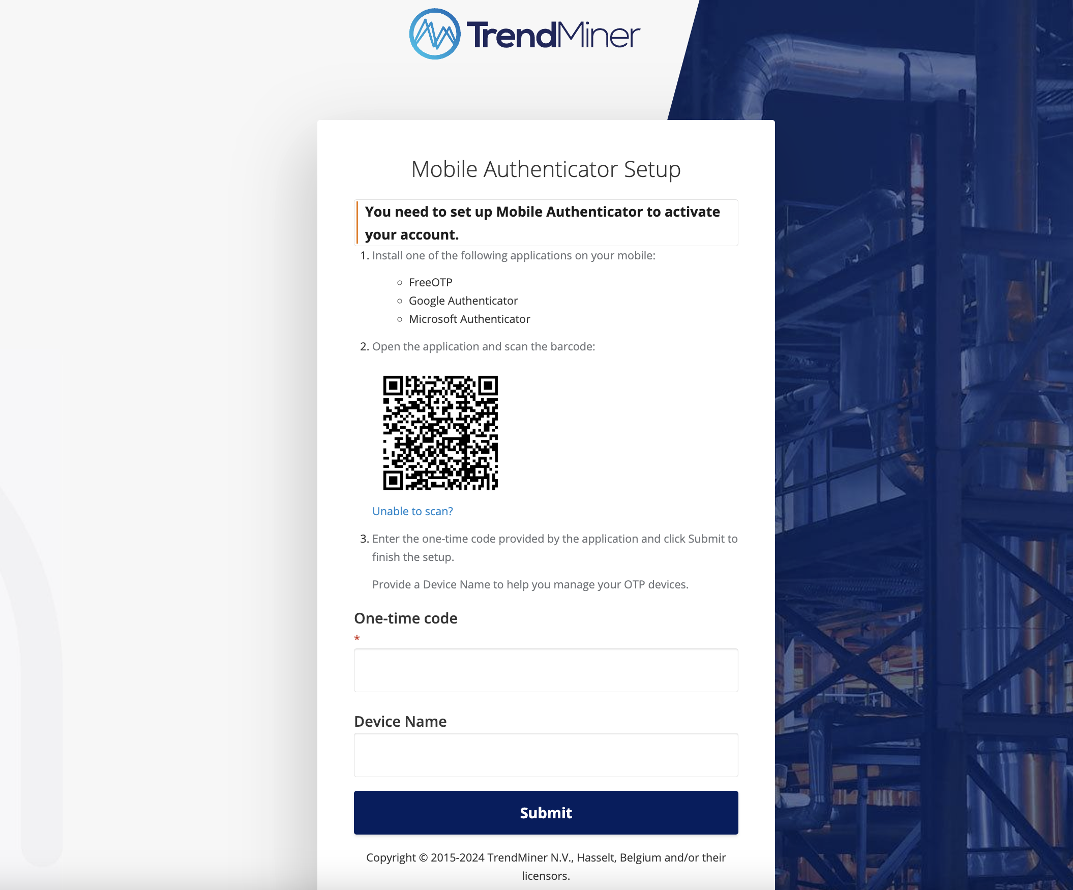

  6. Configure 2FA for access to ConfigHub with the 'admin' user.
    If you have multiple TrendMiner installation for which you manage the 2FA admin access scanning a second 2FA code might overwrite the first one.
    Some authenticators (e.g. Google Authenticator) allow you to edit the name of the entry. We would advise you to rename the authenticator entries to meaningful names, e.g. 'Trendminer: admin - Production' and 'Trendminer: admin - Test' for clarity and to avoid accidentally overwriting entries.
    1. Install or open an authenticator app (FreeOTP, Google Authenticator, Microsoft Authenticator)
    2. Scan the QR code shown to add the 'TrendMiner: admin' entry to the authenticator app
    3. Enter the generated one-time code as generated by the authenticator app
    4. Enter a device name (free to choose), E.g. "John's phone"

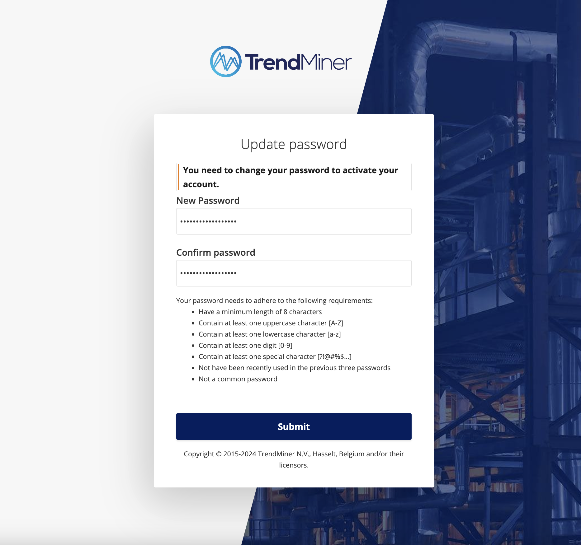

  7. Choose a new ConfigHub password which meets the listed requirements.

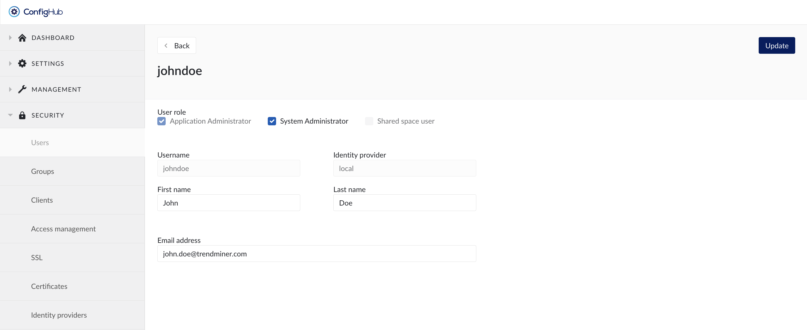

  8. Assign the 'System admin' role to all TrendMiner users who need access to ConfigHub, including yourself.
