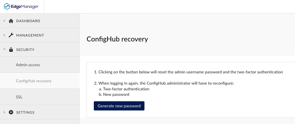

login to EdgeManager using the known procedure, and click on “ConfigHub recovery”
Click on “Generate new password”

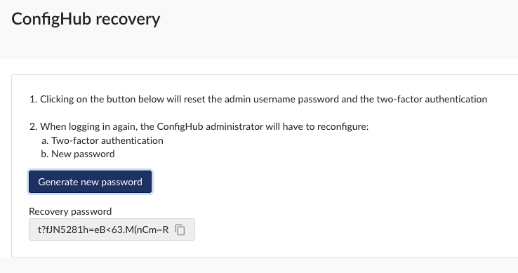

With the new password generated, you will be able to logon to ConfigHub again.
Notice
Do notice that this is only a temporary password. You will need to provide a new permanent password during login of ConfigHub (admin), including a newly to setup 2 factor authentication.
Once you log in again in ConfigHub a new 2FA code will have to be generated as well.
