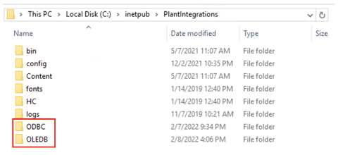

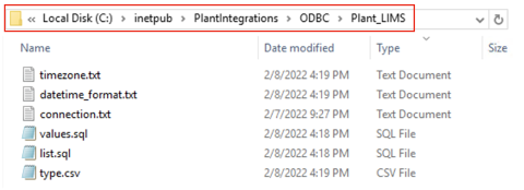

- First step is to browse to the Plant Integration folder you have created during installation. This folder will most likely reside inside the inetpub folder on the c drive of your connector server, which is the default location: - c:/inetpub/PlantIntegrations
- Create a folder (not case sensitive) that will host all your ODBC/OLEDB/SQLite configuration files. All configuration files for ODBC connections will go into the ODBC folder, for OLEDB connections into the OLEDB folder and so on.
- Create a subfolder for each data source you want to configure inside the correct ODBC/OLEDB/SQLite folder, depending on which connection type you are using. In the following example we will configure an ODBC data source called “Plant_LIMS”, so we create the "Plant_LIMS" subfolder in the recently created "ODBC" folder.
Create Configuration files

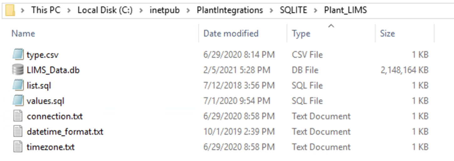

- Create the following configuration files needed to configure the generic data sources. - For ODBC/OLEDB:  - For SQLite:  - File name and type - Description - Required / Optional - sqlite.db (only for SQLite) - This is the sqlite.db file created that contains the data. - Required - connection.txt - Will contain the necessary information (e.g. full connection string) to establish the connection with the data source. - Required - list.sql - Query select statement that returns the list of tags with additional metadata. - Required - values.sql - Query select statement that returns the timestamps and values for a given tag. - Required - values-STRING.sql - Query select statement that returns the timestamps and values for a given string tag. Only include if necessary. If any string tags are not in the same database, you could use the query here or decide to join with your values.sql query. - Optional - type.csv - Specifies information for mapping all tag types available in the data source to those recognized by TrendMiner. - Required - datetime_format.txt - Specifies the date-time format of the timestamps returned by the values query - Optional - timezone.txt - Specifies the timezome associated to the timestamps if not already in UTC. - Optional

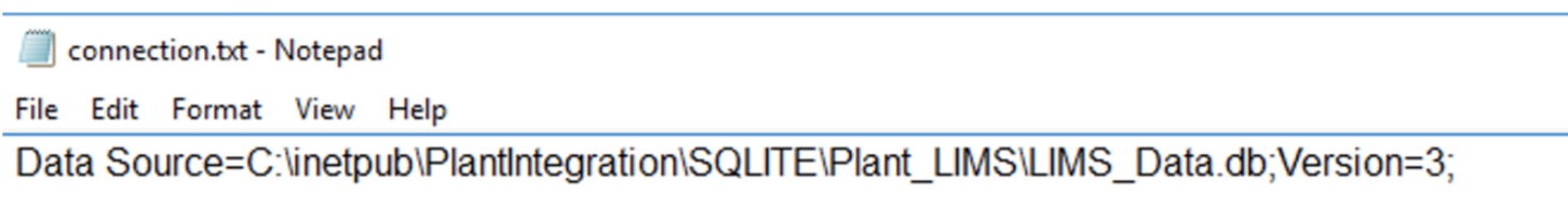

Connection.txt file
ODBC example:
Driver={ODBC Driver 13 for SQL Server};Server=<ipAddress,port>;Database=<database_name>;Uid=<myUsername>;Pwd=<myPassword>;Encrypt=yes;TrustServerCertificate=no;Connection Timeout=30;As a minimum requirement, you shall specify the Server, Database, Uid, and Pwd.
OLEDB example:
SQLite example:

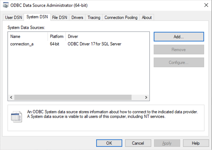

- Set up a new System Data Source using the corresponding SQL Server driver. - Note- Make sure the username being used to access the SQL database has read access.
- Once the System Data Source is configured, create a “connection.txt” file and make reference to the System Data Source as shown below. - Note- The username and password must be included in the file.

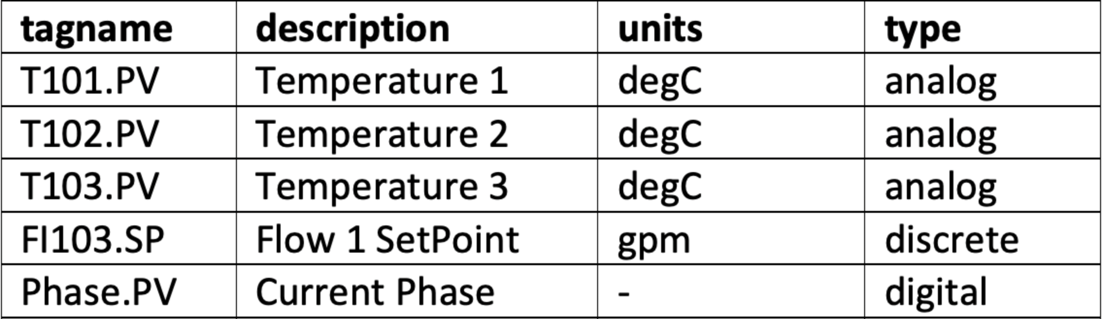

- The first step is a query that will return unique tagnames (to identify the time series), its datatype, and optional metadata such as description and units. This query goes into the list.sql file.

SELECT tagname, description, units, "analog" as type FROM Table_1

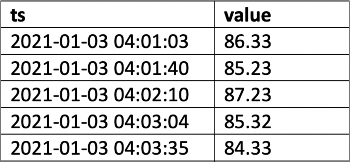

- The columns returned should be named "ts" (for the timestamp) and "value". Timestamps should be in ascending chronological order, meaning oldest first, newest last.
- All timestamps that are returned should fall inside the requested time interval. If they don't, then indexing will fail later on.

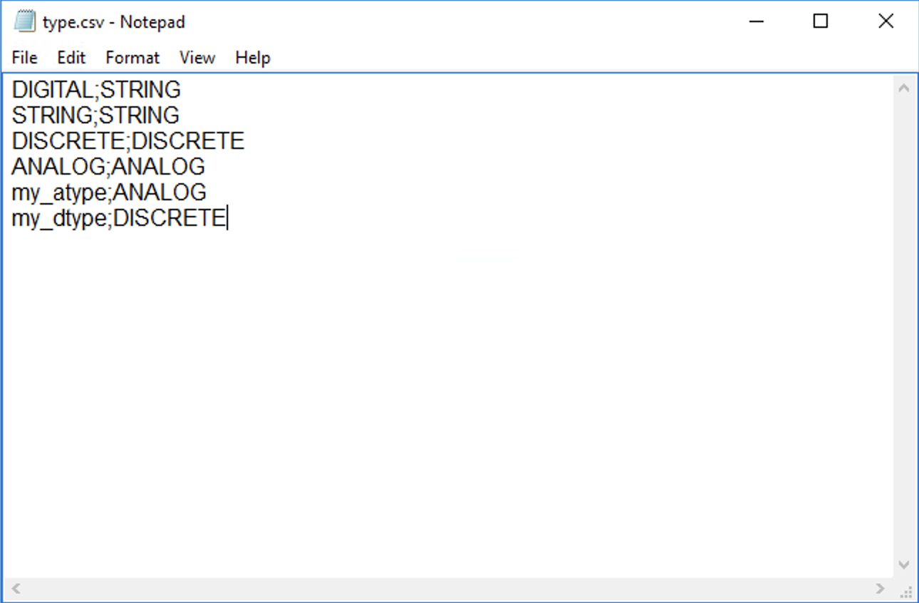

In the type.csv file, create one line per data type, with the output of the list.sql types as the first value, followed by a semicolon (";"), followed by one of the supported datatypes in TrendMiner. The example below ensures the results are returned in the right case, and a DIGITAL result is explicitly returned as a STRING result.

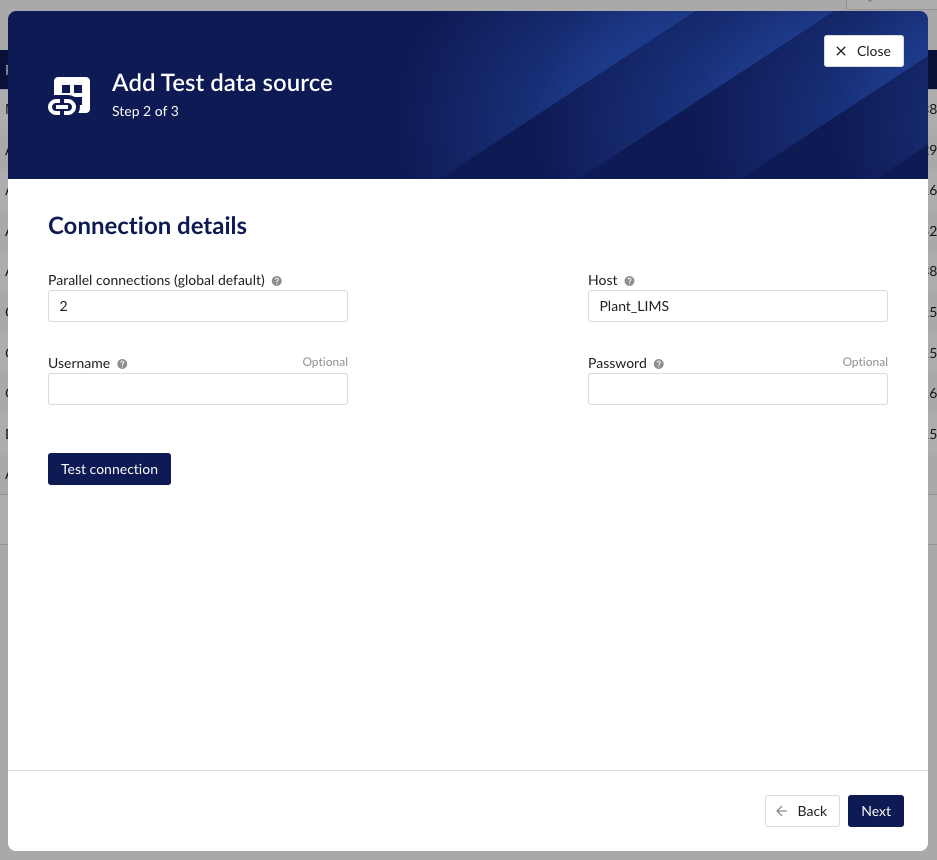

- The “Host” name will be the name of the folder previously created containing all the configuration files as in the example below. The data source name is free to choose.
- TrendMiner will consider the username and password provided in the “connection.txt” file and not the one provided through the interface. You do not need to provide the username and password here.
