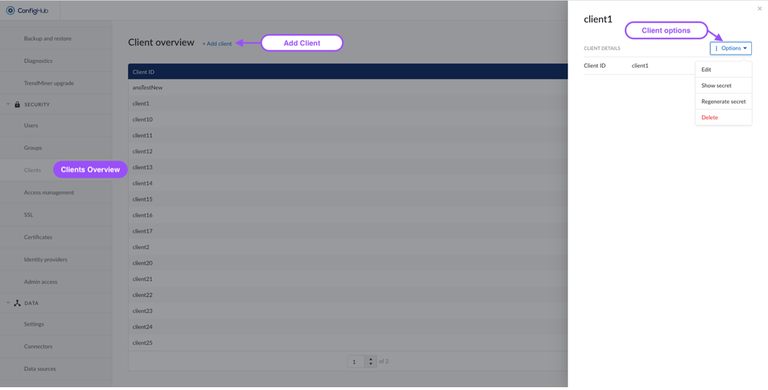

Creating Clients
TrendMiner allows the creation of a client and secret in order to generate a token to be used in external API calls.
To create a new client you will need to go to the clients-menu under the "security" section. From there clients can be created via the "+add client"-button.
You will be asked to enter a name (client ID) for your client which will be used for external references. Once the client is created you can click on it to:
  • Edit the client ID
  • Show the secret of the client
  • Generate a new secret
  • Delete the client
Regenerating a secret will invalidate your old secret and tokens. This action cannot be undone.
Clients need to be added to a domain/entity in the Access management menu just as users/groups to allow access to the data.

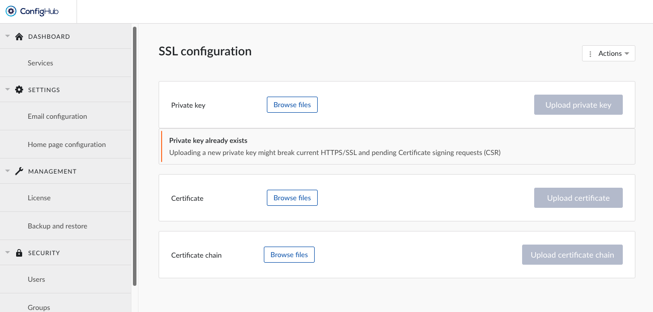

  • Private key
  • CSR for that private key
  • Certificate chain
TrendMiner only supports PEM certificates. OpenSSL can be used to convert certificates in a different format to PEM.
Once these prerequisites are fulfilled, HTTPS can be enabled via the "Action" menu on the top right.
When uploading new trusted certificates via Security - Certificates and HTTPS is enabled, SSL can be reloaded by selecting “Reload SSL” in the Actions menu of the screen.

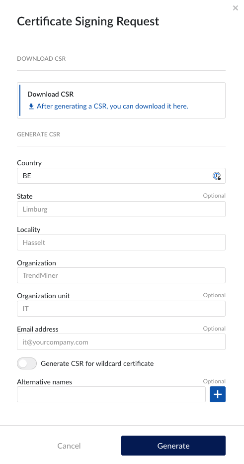

Certificate signing request (CSR)
Via ConfigHub a CSR can be generated.
To start, clicking the Actions menu and select “Certificate signing request”. A side panel will open to download or generate the CSR.
At the top of the side panel, you can download the CSR when it is generated on the server.
Below this section, information to generate the CSR can be provided. There are 2 options to generate a CSR, using
  • Alternative names
    With this option, it is allowed to provide alternative fully qualified domain names to be protected using the certificate. These are optional, the server name of the installation is the primary domain used.
  • Wildcard
    This options allow for HTTPS on all subdomains of the provided wildcard domain. This domain is required.
When no private key is available yet, one will be generated. Uploading a new private key, might break current HTTPS/SSL and pending Certificate signing requests (CSR).
