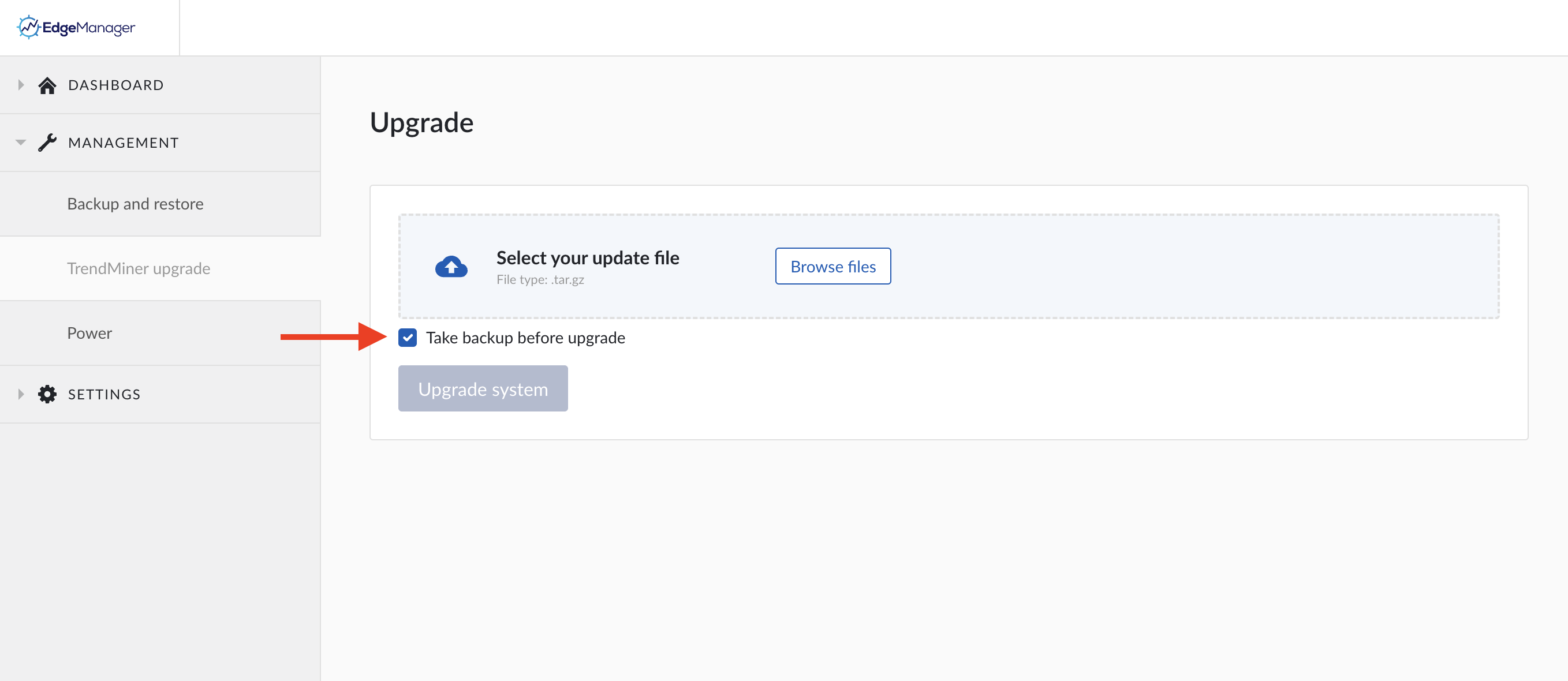

Uncheck the "Take backup before upgrade" checkbox when upgrading TrendMiner:
