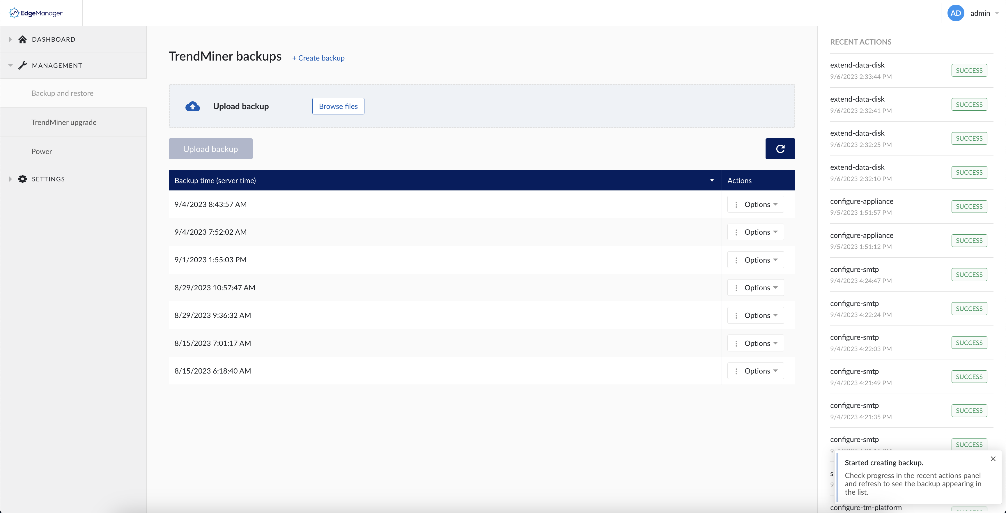

- Click on 'Create backup

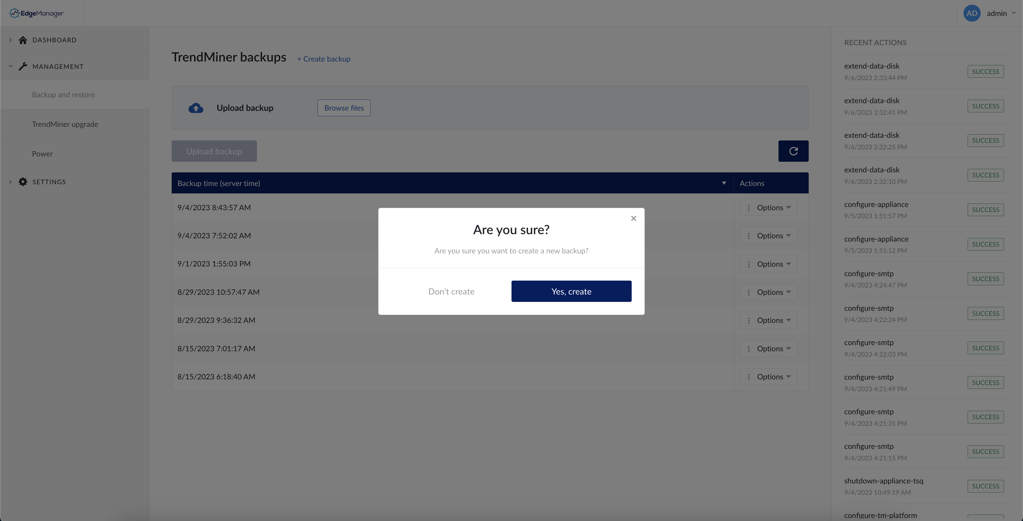

- Confirm the backup creation. A notification is shown on the bottom right to confirm that backup creation has started.

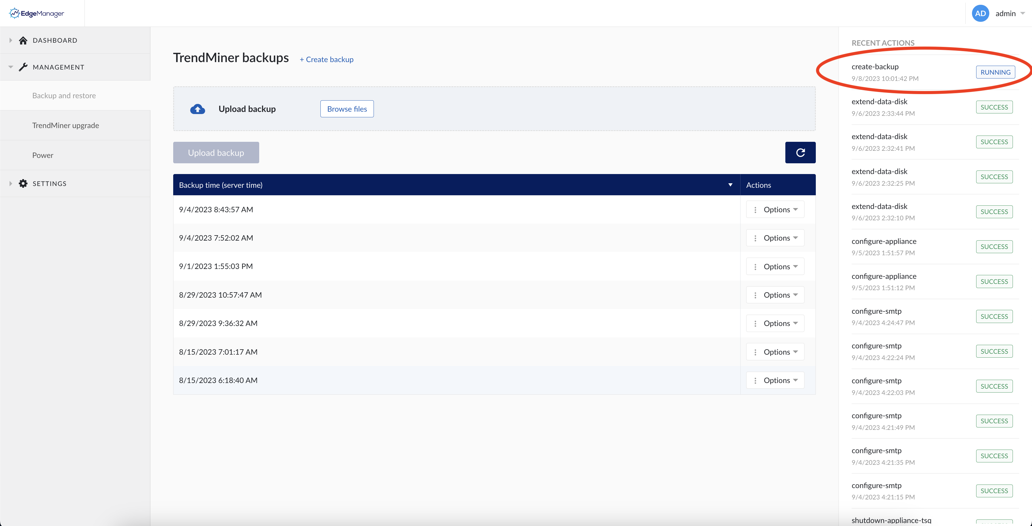

- Wait until the backup creation is finished. This can take from a few minutes to an hour or more, depending on the speed of the disk and the amount of data which needs to be backed up.
- When the backup creation is finished and the task is on 'success' refresh the page to show the newly created backup in the list of backups.

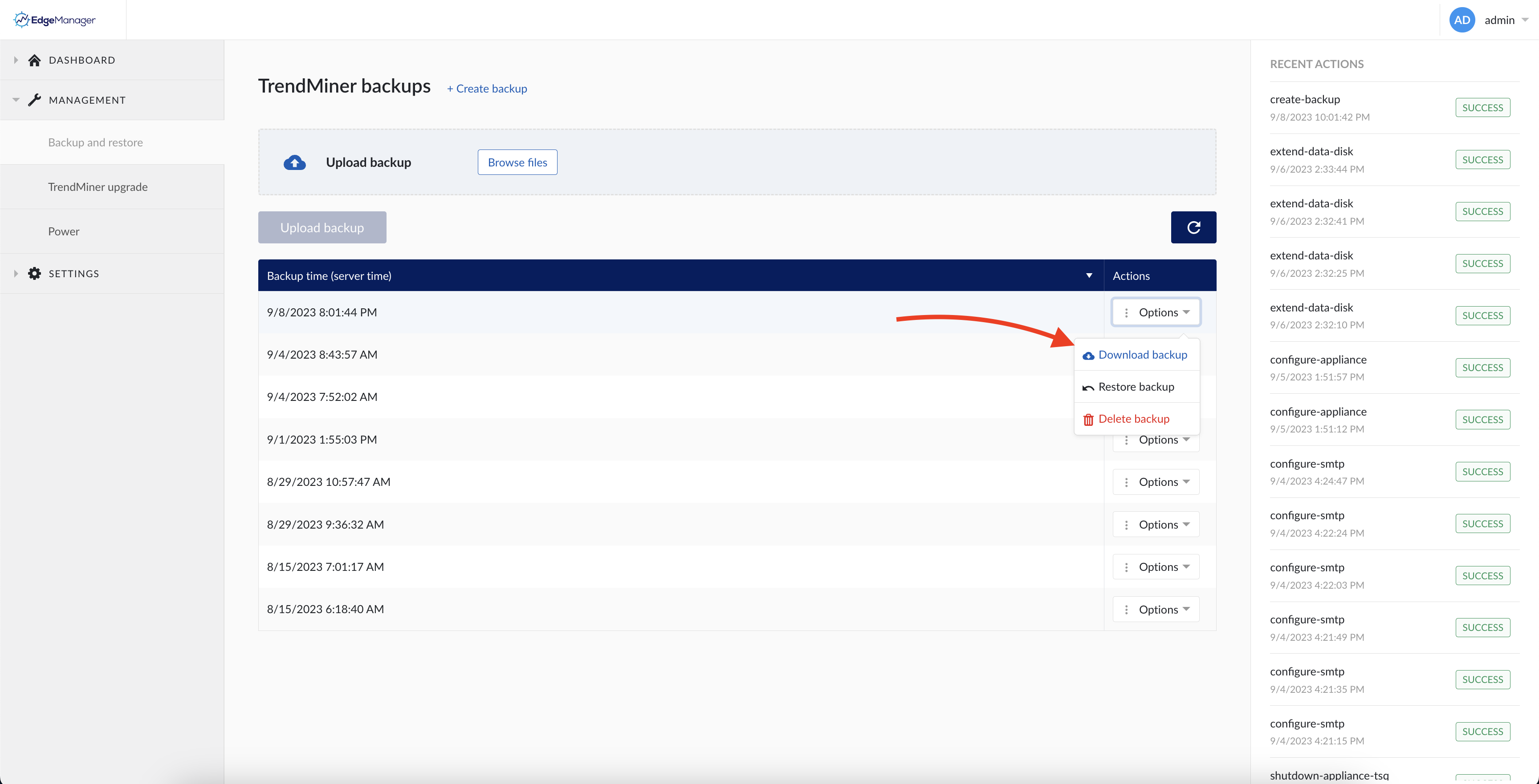

- To download the backup to your computer, click the options button of the created backup and select 'Download backup'.
