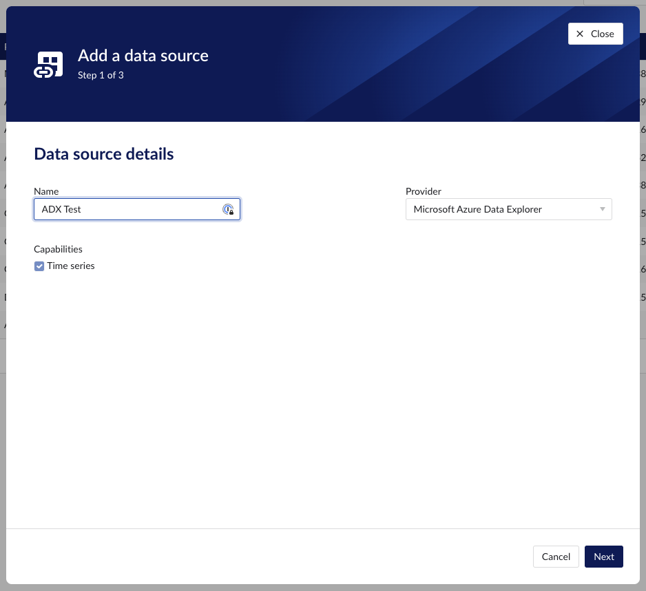

Fill out 'Data source details' on the first step of the datasource creation wizard: type name of data source, select “Microsoft Azure Data Explorer” from the Provider dropdown. Time series capability will be checked by default.

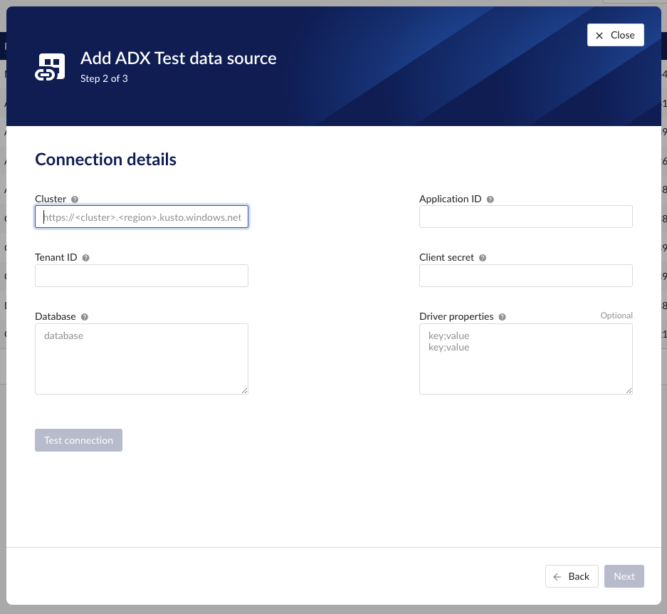

- Connection details – lists properties related to the configuration of the connection that will be established with Microsoft Azure Data Explorer.

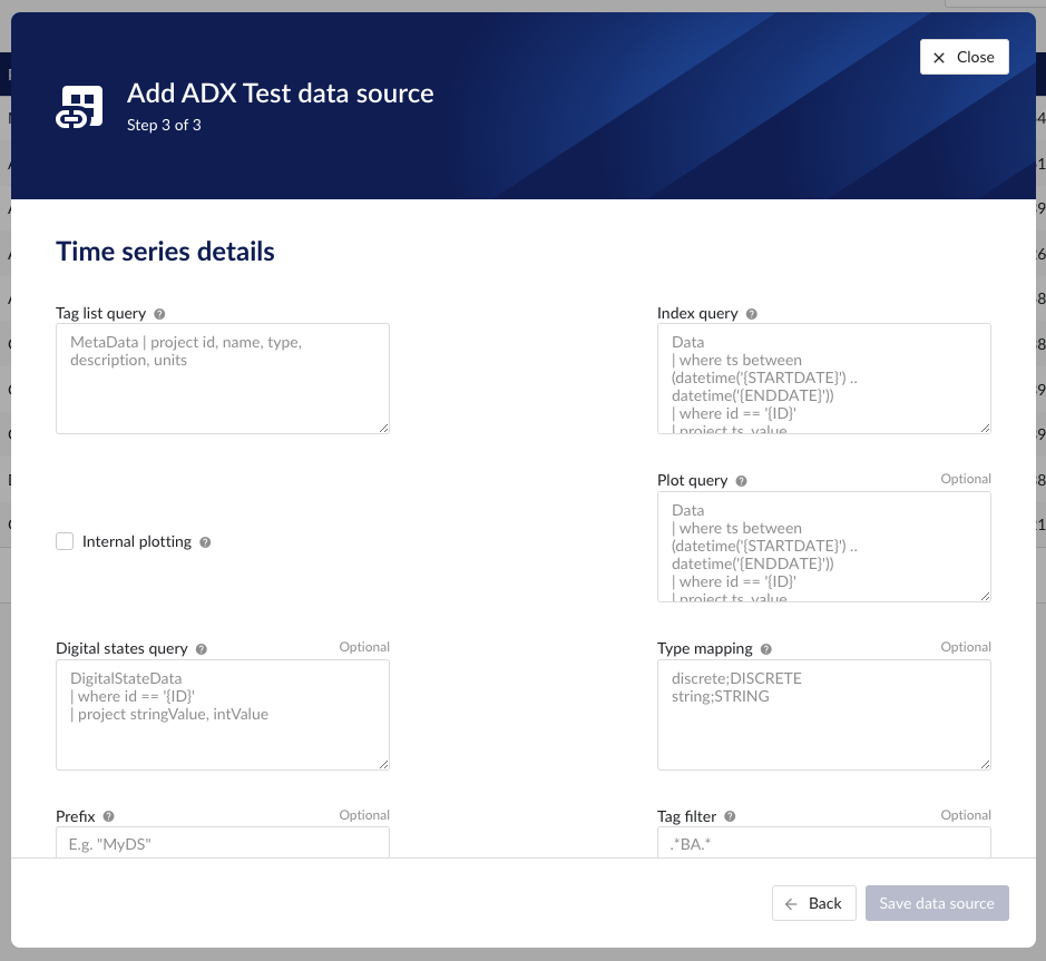

- Time series details – lists properties relevant for the time series data.
- “Name“ - а mandatory name needs to be specified.
- “Provider” - select the option Microsoft Azure Data Explorer from the dropdown.
- “Capabilities” - the only capability supported is the Time series capability. It will be selected by default.
- “Prefix” - optional text can be entered here that will be used to prefix the tag names in TrendMiner, if a value is entered. Warning: this cannot be changed. The datasource can however be deleted and you can start the configuration over again.
- "Cluster" - to be mapped with value of the cluster URI. - https://<cluster>.<region>.kusto.windows.net
- "Application ID" - a mandatory application id. In Azure a new application “TrendMiner” needs to be registered. After completion of this registration the application id will be available. For more info please refer to Azure Active Directory application registration or consult with the Azure Data Explorer documentation.
- "Tenant ID" - a mandatory tenant id. In Azure a new application "TrendMiner"needs to be registered. After completion of this registration the tenant id is available.
- "Client secret" - after registration of the TrendMiner application in Azure a client id and a secret need to be generated in order to get application access. The client secret for this access needs to be entered here.
- "Database" – to be mapped with the name of the ADX database holding the time series data to be pulled.
- "Driver properties" - additional optional driver specific properties can be configured here as key;value, where key is the name of driver specific property and value the desired value for this property.
- “Tag list query” - a query used by TrendMiner to create tags. A query needs to be provided that given the database schema and tables used will return the following columns: - id - this is mandatory and must have a unique value for each row returned by the query.
- name - this is mandatory and must have a value.
- type - an optional type indication. If the type column is not in the query, TrendMiner will use the default type which is ANALOG. Custom types can be returned here not known to TrendMiner but then a type mapping must be added as well. See also type mapping below. Without additional type mapping it must be one of the following TrendMiner tag types: ANALOG, DIGITAL, DISCRETE, STRING
- description - an optional description to describe the tag. Can return an empty value or null.
- units - an optional indication of the units of measurement for this tag. Can return an empty value or null.
 - The order of the columns in the query needs to be: id, name, type, description, units
- “Index query” - a query used by TrendMiner to ingest timeseries data for a specific tag. The query is expected to return a ts (timestamp) and a value. The following variables are available to be used in the WHERE clause of this query. The variables will be substituted at query execution with values. There should not be any NULL values returned by the SELECT statement so including "IS NOT NULL" in the WHERE clause is strongly recommended. - {ID}. The id as returned by the tag list query.
- {STARTDATE} TrendMiner will ingest data per intervals of time. This denotes the start of such an interval.
- {ENDDATE} TrendMiner will ingest data per intervals of time. This denotes the end of such an interval.
- {INTERPOLATION}: Interpolation type of a tag, which can be one of two values: LINEAR or STEPPED.
- {INDEXRESOLUTION}: Index resolution in seconds. It can be used to optimise a query to return the expected number of points.
- “Internal plotting” - if this option is selected TrendMiner will use interpolation if needed to plot the timeseries on the chart on specific time ranges. If this value is not selected and no plot query was provided, TrendMiner will plot directly from the index.
- “Plot query” – a query used by TrendMiner to plot timeseries data for a specific tag. The query is expected to return a ts (timestamp) and a value. The following variables are available to be used in the WHERE clause of this query. The variables will be substituted at query execution with values. There should not be any NULL values returned by the SELECT statement so including "IS NOT NULL" in the WHERE clause is strongly recommended. - {ID}. The id as returned by the tag list query.
- {STARTDATE}. TrendMiner will plot data per intervals of time. This denotes the start of such an interval.
- {ENDDATE}. TrendMiner will plot data per intervals of time. This denotes the end of such an interval.
- “Digital states query” - if tags of type DIGITAL are returned by the tag list query, TrendMiner will use this query to ask for the {stringValue, intValue} pairs for a specific tag to match a label with a number. The query expects to return a stringValue and an intValue and can make use of the {ID} variable in the where clause. The variable will be substituted at query execution with a value.
- “Tag filter” - an optional regular expression to be entered. Only tags with names that match this regex will be retained when creating tags (using the tag list query).
- “Type mapping” - if types differ from what TrendMiner uses and one wants to avoid overcomplicating the query, a type mapping can be entered here. It can contain multiple lines and expect per line the value to be representing a custom type followed by a ; and a TrendMiner type. During the execution of the tag list query TrendMiner will then use this mapping to map the custom values returned in the query to TrendMiner tag types. - customTypeA;ANALOG
- customTypeB;DIGITAL
- customTypeC;DISCRETE
- customTypeD;STRING
