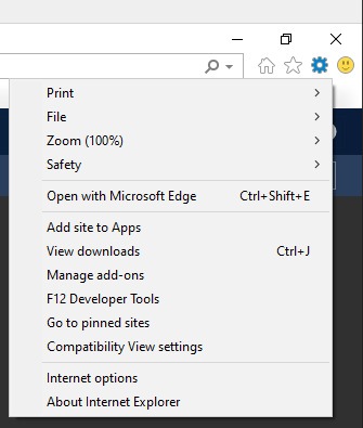

Internet Explorer 11
Left-click on the cogwheel in the top right of the browser window and click on 'F12 Developer Tools'.
This will open the developer tools:

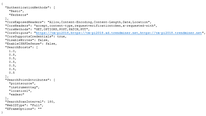

When visiting this URL, a response will be shown including the 'CorsOrigins' (see following figure).
The 'CorsOrigins' list should contain the 'origin' on which PI Vision is visited.
E.g. http://tm-pi2018.ad.trendminer.net/PIVision is used, the 'origin' in this case is 'http://tm-pi2018.ad.trendminer.net', which is not in the list of 'CorsOrigins'. However 'https://tm-pi2018.ad.trendminer.net' is in the list of 'CorsOrigins'.
