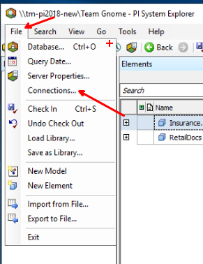

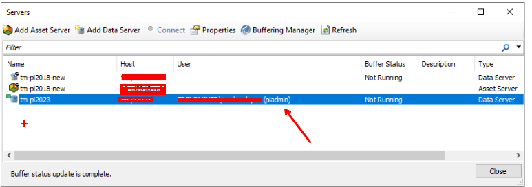

    2. Start the PI System Explorer application. Navigate to File -> Connections

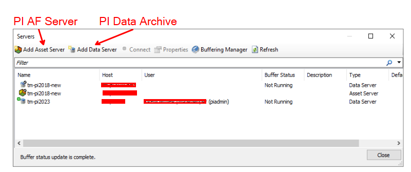

    3. Add a desired PI Data Archive connection or verify that the server is in the list. Click "Add Data Server" button and specify the hostname, ip address or FQDN for the PI Data Archive.

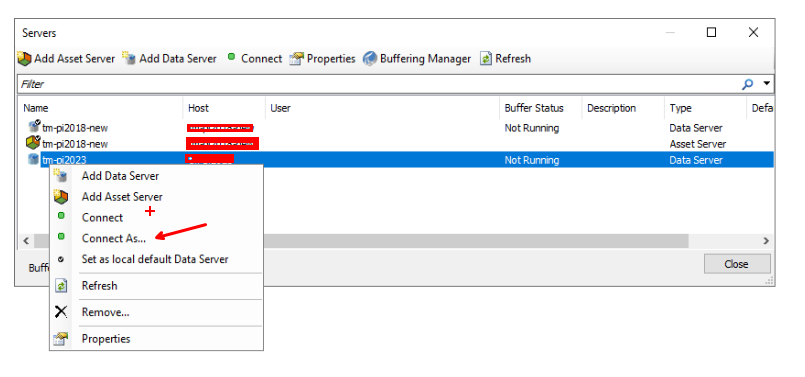

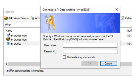

    4. If you are planning to use Service Domain Account, you can try to connect with this account by doing the right click on the desired PI Data Archive entry and using "Connect as..." option.
    5. After entering the credentials, you will be able to see the permissions in the User column.

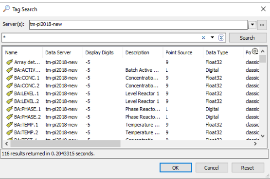

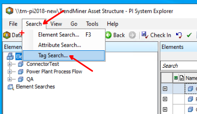

    6. Once the connection is established, you can verify which tags are accessible on the PI Data Archive. Navigate to Search -> Tag Search...
    7. Pick the correct PI Data Archive, use *(asterisk) as a filter and click Search button. The list of all available tags for the current user will be shown.
