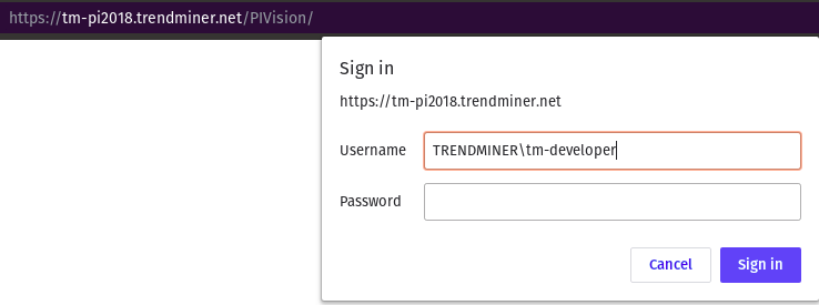

Login
Visit https://[THE URL]/PIVision/#/
Replace [THE URL] with the actual URL/domain on which PI Vision is installed. E.g. https://tm-pi2018.trendminer.net/PIVision/#/
Login with the credentials for a domain user that has access to the server on which PI Vision is installed.
The URL, domain and user will be different compared to this image

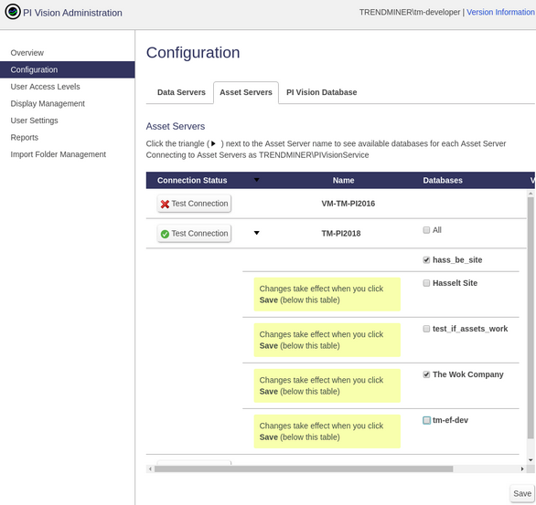

Go to https://[THE URL]/PIVision/Admin and login
Replace [THE URL] with the actual URL/domain on which PI Vision is installed. E.g. https://tm-pi2018.trendminer.net/PIVision/Admin

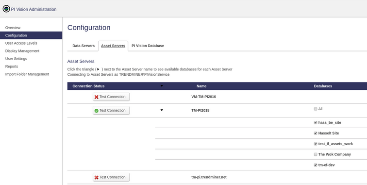

In the left panel, click on 'Configuration'.
Choose the 'Asset Servers' tab.
In the 'Databases' column, toggle on the databases you want to be visible in PI Vision and hit Save (bottom right).

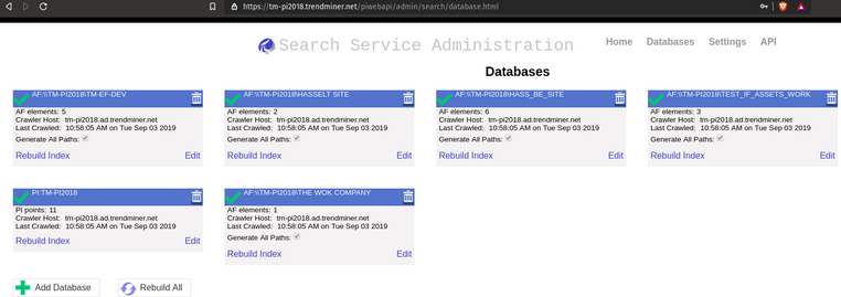

1. Go to https://[THE URL]/piwebapi/admin/search/database.html and login.
Replace [THE URL] with the actual URL/domain on which PI Vision is installed. E.g. https://tm-pi2018.trendminer.net/piwebapi/admin/search/database.html
Click on 'Rebuild Index' of the database and wait until it has a green check mark again, this can take a while.
The AF elements did not change, because in this scenario I added 2 extra attribute/tags and 0 assets.

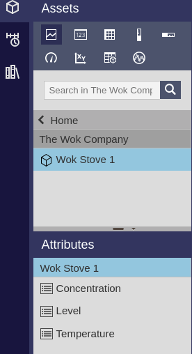

Navigate in the database.
Select the asset, this will now show the indexed attributes.

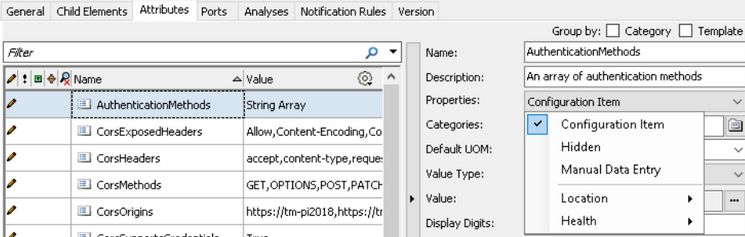

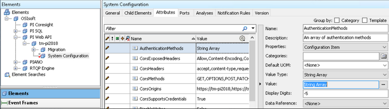

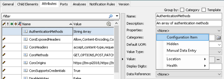

PI System Explorer - Attributes must be of type 'Configuration Item'

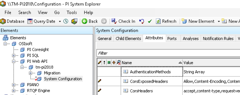

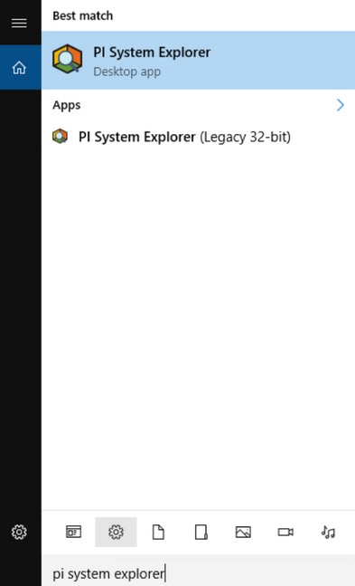

Open PI System Explorer and drill down to the System Configuration in the left panel.
Open the Attributes tab and check that all the attributes are a 'Configuration Item' in the right side panel.
WRONG (Properties has the value '<None>')
RIGHT (Properties has the value 'Configuration Item'.

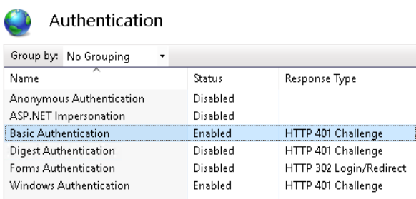

IIS Manager - Verify Authentication settings

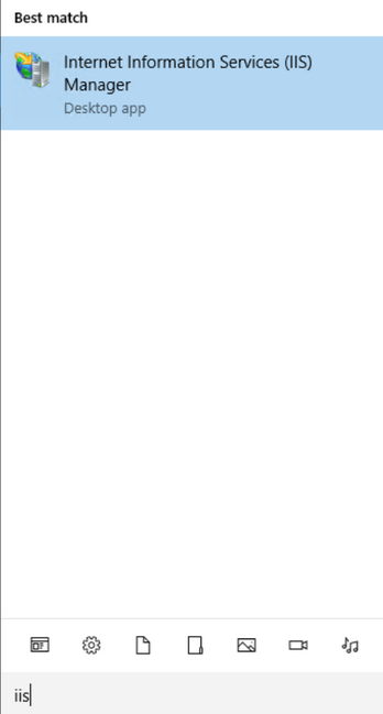

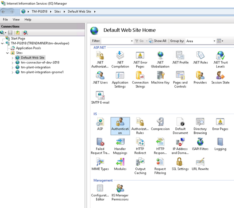

Open IIS Manager and in the left panel drill down to 'Default Web Site' and double click on 'Authentication' in the right side.
Verify that both Windows Authentication and Basic Authentication are Enabled.
To set the status to 'Enabled', right click on 'Disabled' and click on 'Enabled'.

Open PI System Explorer, drill down to the System Configuration in the left panel. Select the 'Attributes' tab.

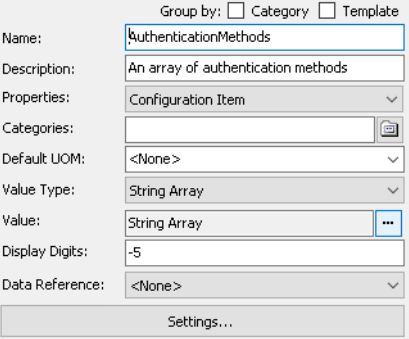

In the right side panel click on
at the end of the 'Value' property.

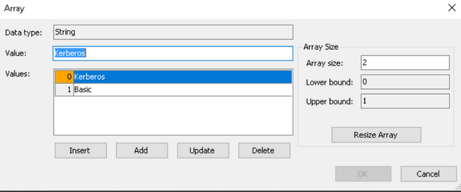

Verify that both Kerberos and Basic are in Values.
Kerberos must always be in here!
If Basic is not in here, click on 'Add' and change the Value in the field next to 'Value'.
Check In your changes!

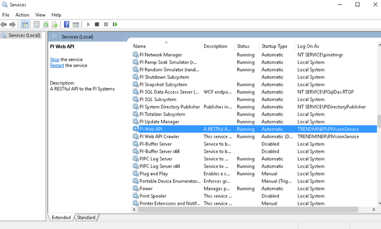

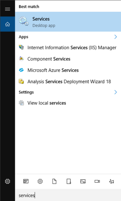

Open Services.

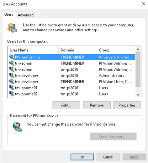

Verify that the user in the 'Log On As' column, is a Domain User, for both the PI Web Crawler as well as the PI Web API.

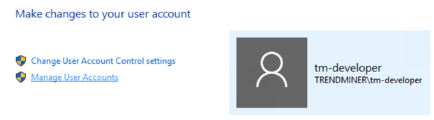

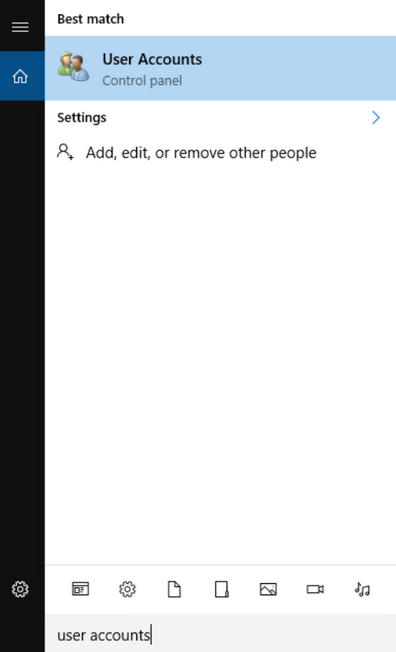

Open up User Accounts and click on 'Manage User Accounts'.
Confirm that the user has the following icon, this means it is a Domain User.
The following image is the icon for a Local User:
For this example, we can see that TRENDMINER\PIVisionService is the user attached to both the PI Web Crawler and PI Web API and that it is a Domain User.

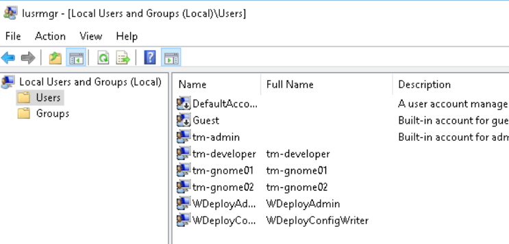

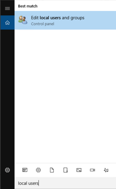

Alternative way is to open 'Edit local users and groups', click on 'Users' and confirm that the user (e.g. TRENDMINER\PIVisionService) is NOT in this list.

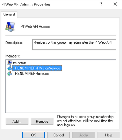

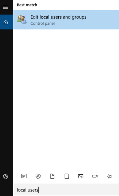

Open 'Edit local users and groups' and click on 'Groups'.

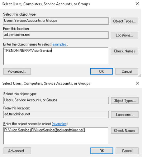

Double click on 'PI Web API Admins' and confirm that the user is in the 'Members' list.
If this is not the case, click on 'Add...', type in the name of the user and click on 'Check Names', then click 'OK'.
Do step 2. for PI Vision Admins as well (not sure if necessary, but in the current configuration this is the case).
