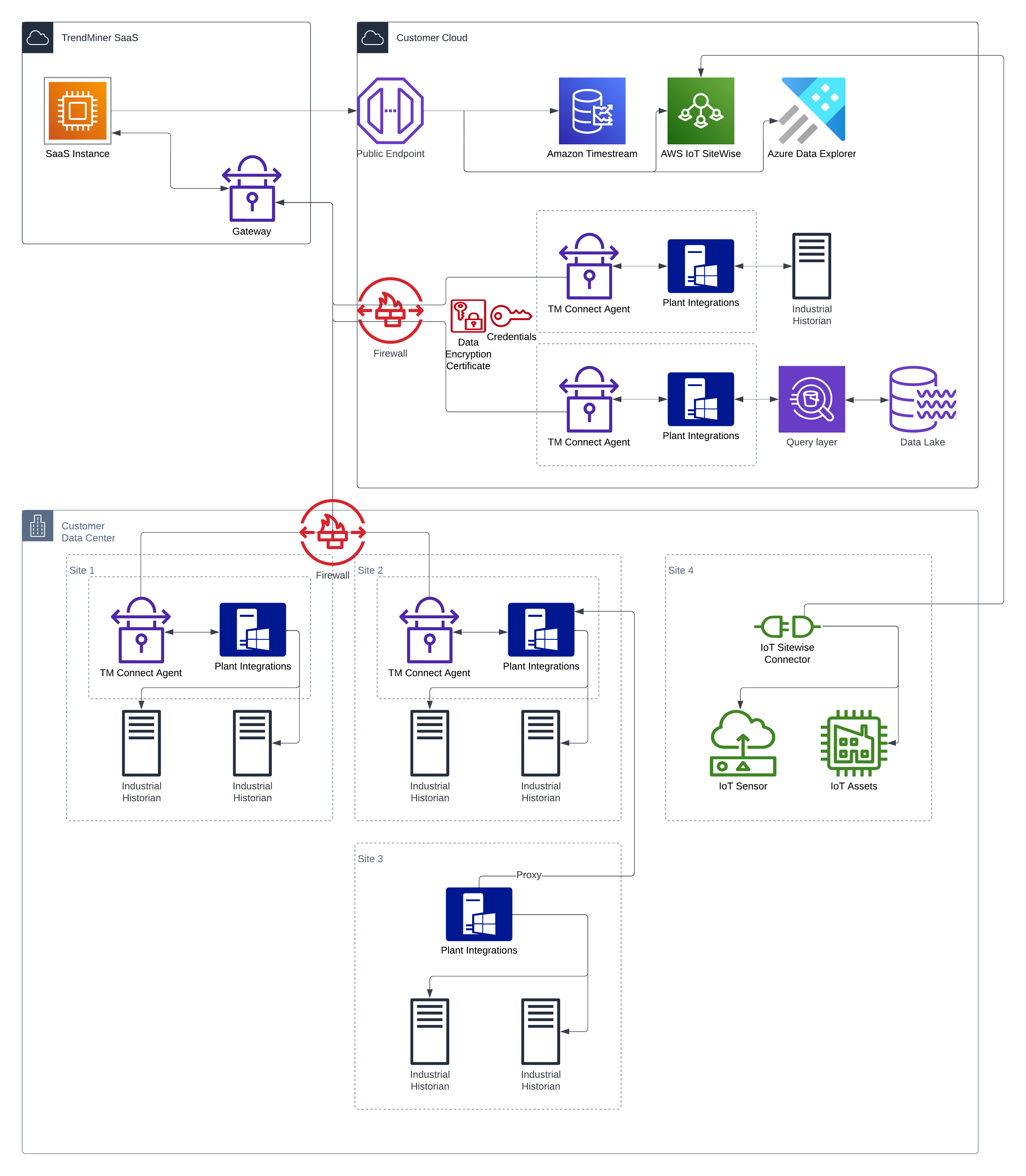

TrendMiner SaaS with hybrid data source
In this more complex scenario, a secure connection needs to be established between the TrendMiner SaaS platform hosted in the cloud and data sources, hosted both on-premise and in the cloud.
Architecture schema
Reference architecture for TrendMiner SaaS with hybrid data source integration
