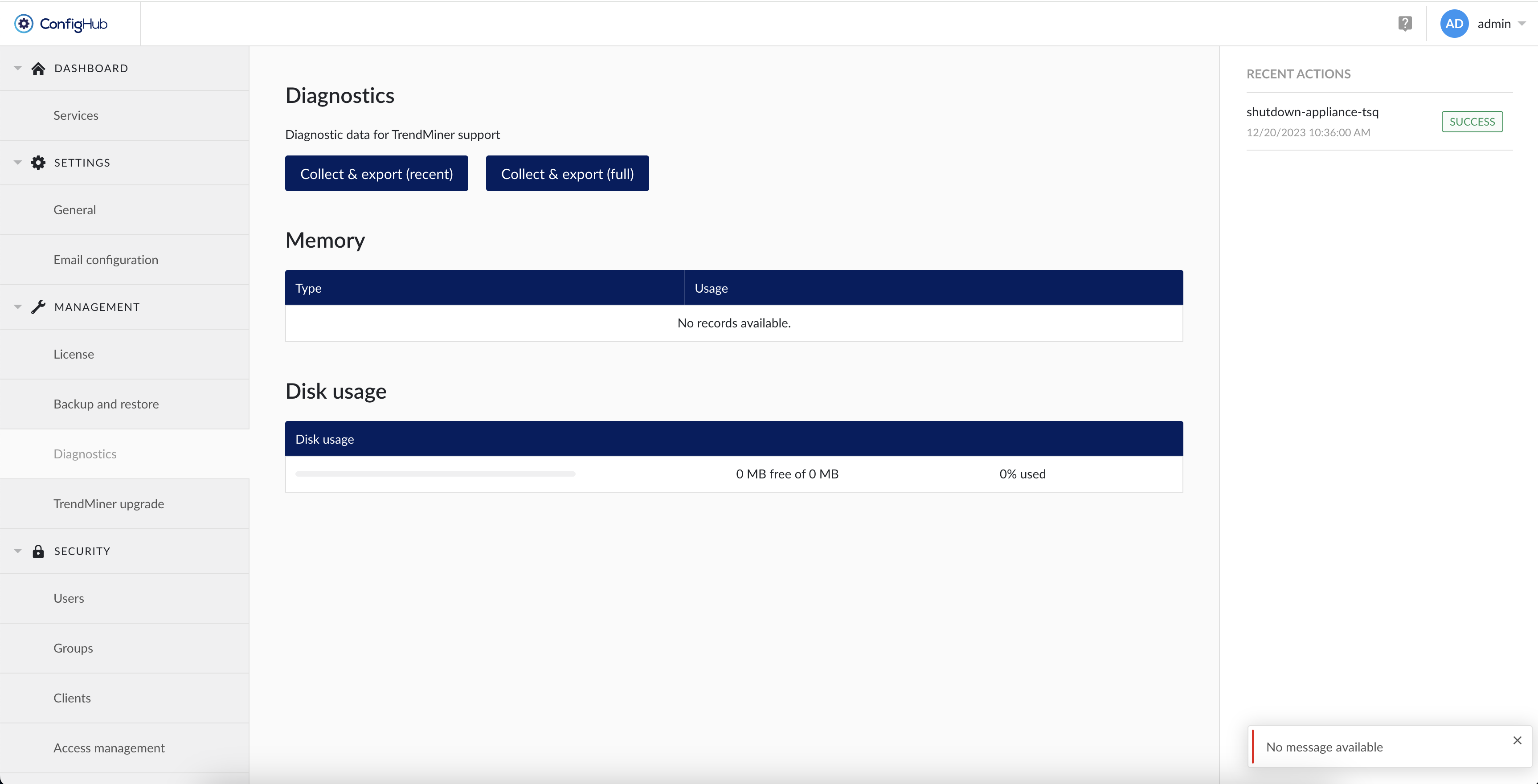

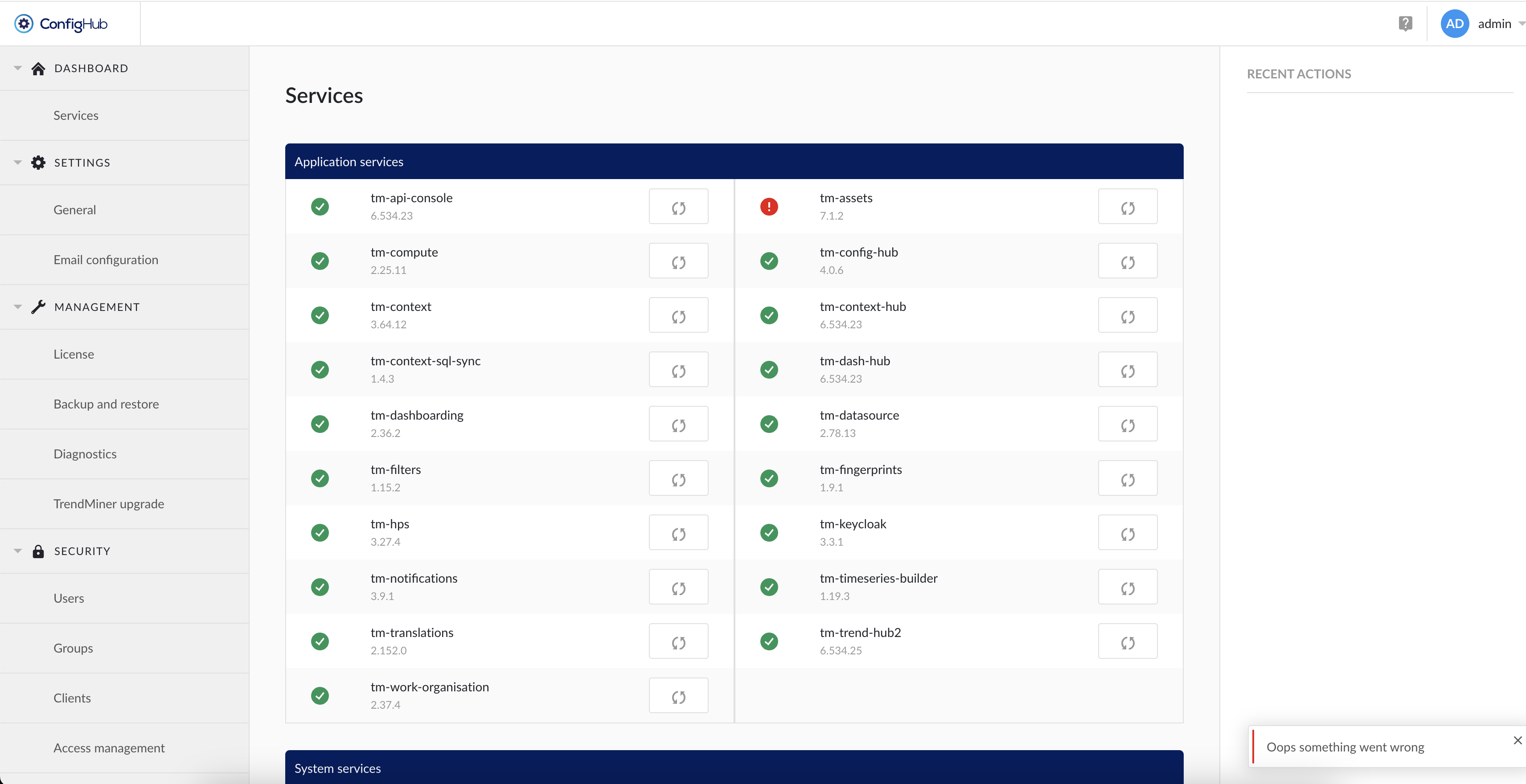

After the upgrade to 2023.R3.0 you might experience errors messages like "Oops something went wrong" or "No message available" and other unexpected behaviour in ConfigHub. This is most likely related to browser caching of ConfigHub. As a result ConfigHub might still refer to old functionality and endpoints which can cause these errors.
Please try clearing your browser cache or try using incognito mode/in-private browsing to see if this resolves the errors. If the errors persist, please contact support.
