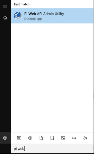

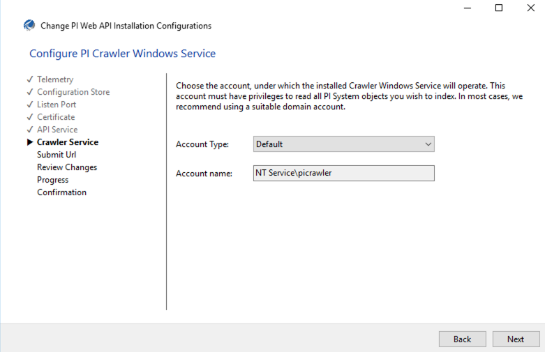

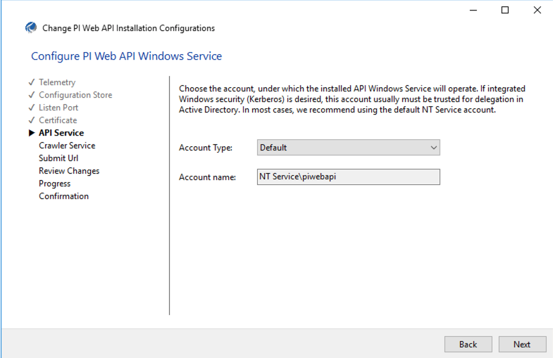

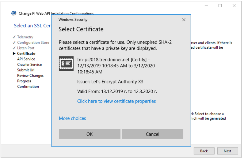

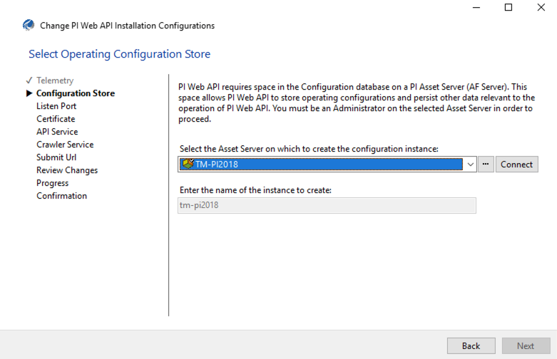

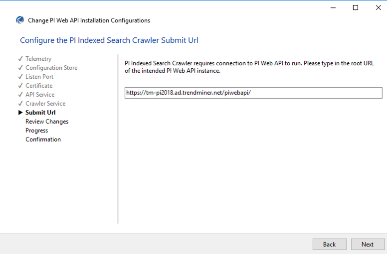

Most important steps with screenshots:
The URL in this screenshot is also the URL that has to be configured in the 'PI Web API url' field of the 'open in TrendHub' custom symbol.
